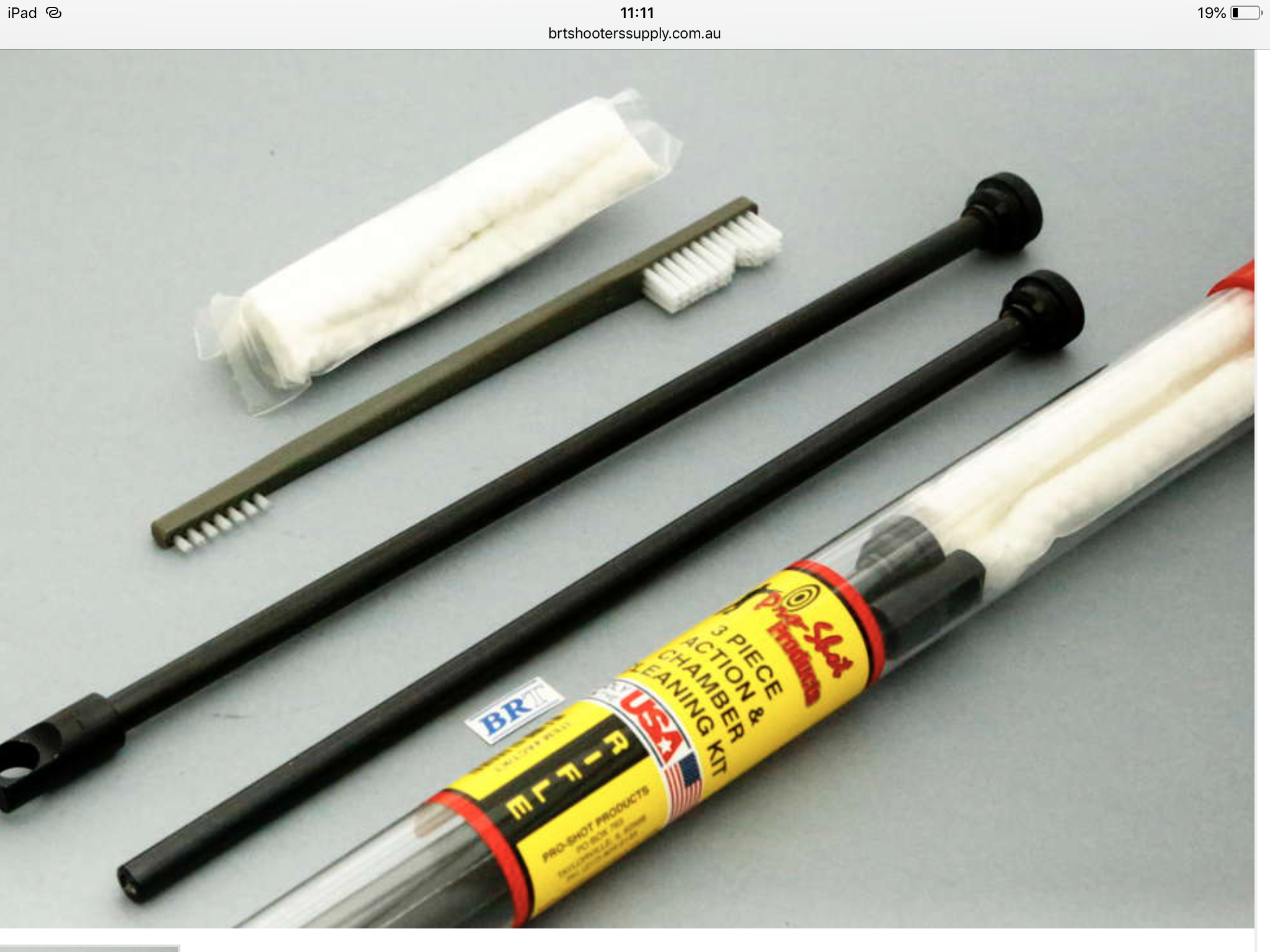

Sounds like you had some JB in the chamber . I dont clean much , except in the big magnums which
run quite dirty . When I clean , I use the Pro Shot action cleaning kit to get any solvent out of chamber
and bolt lug recesses . There is this tampon wad thing that the kit has , which is perfect for getting into
most lug recesses . There’s also a stick you can screw a mop onto for neck and leade cleaning .
I use a little automotive brake cleaner on the tampon and mop , to ensure traces of solvent or JB are
removed from action , after doing this a little brake cleaner goes on a patch down the bore , followed
by a dry patch . Result is squeaky clean gun guts ready to go . Brake cleaner will evaporate in 30 - 60
seconds .
seconds . View attachment 6930084View attachment 6930084
So I have one of these, not the exact brand but a non rotating short rod that takes some tampon looking patches that are supposed to go into lug area. I used that and mopped up as much as I could.
