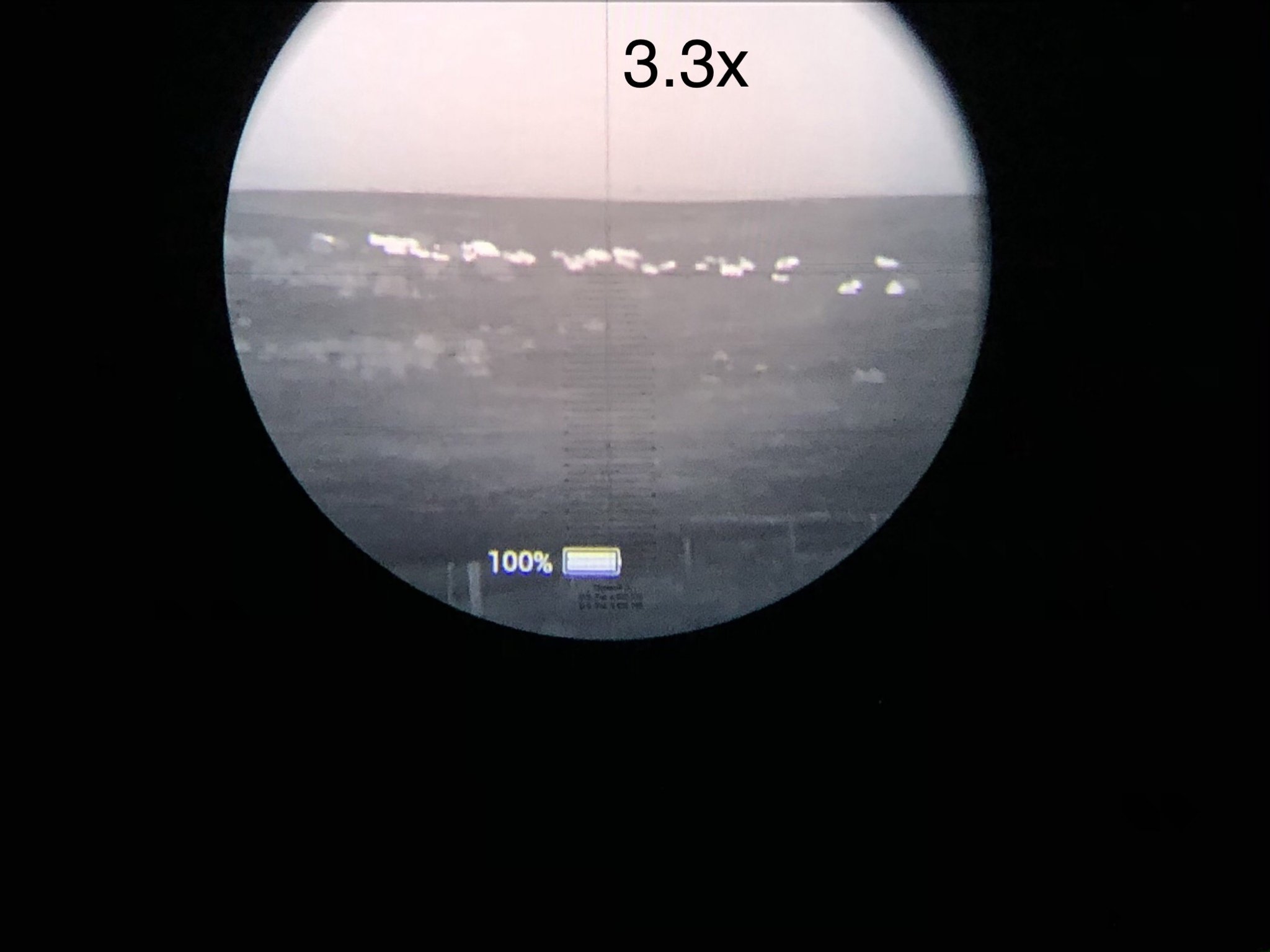

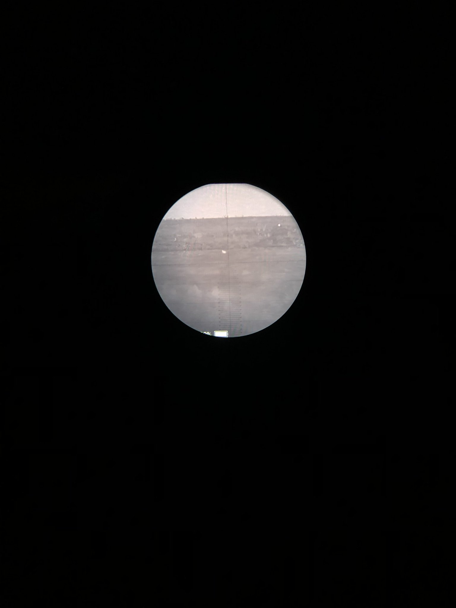

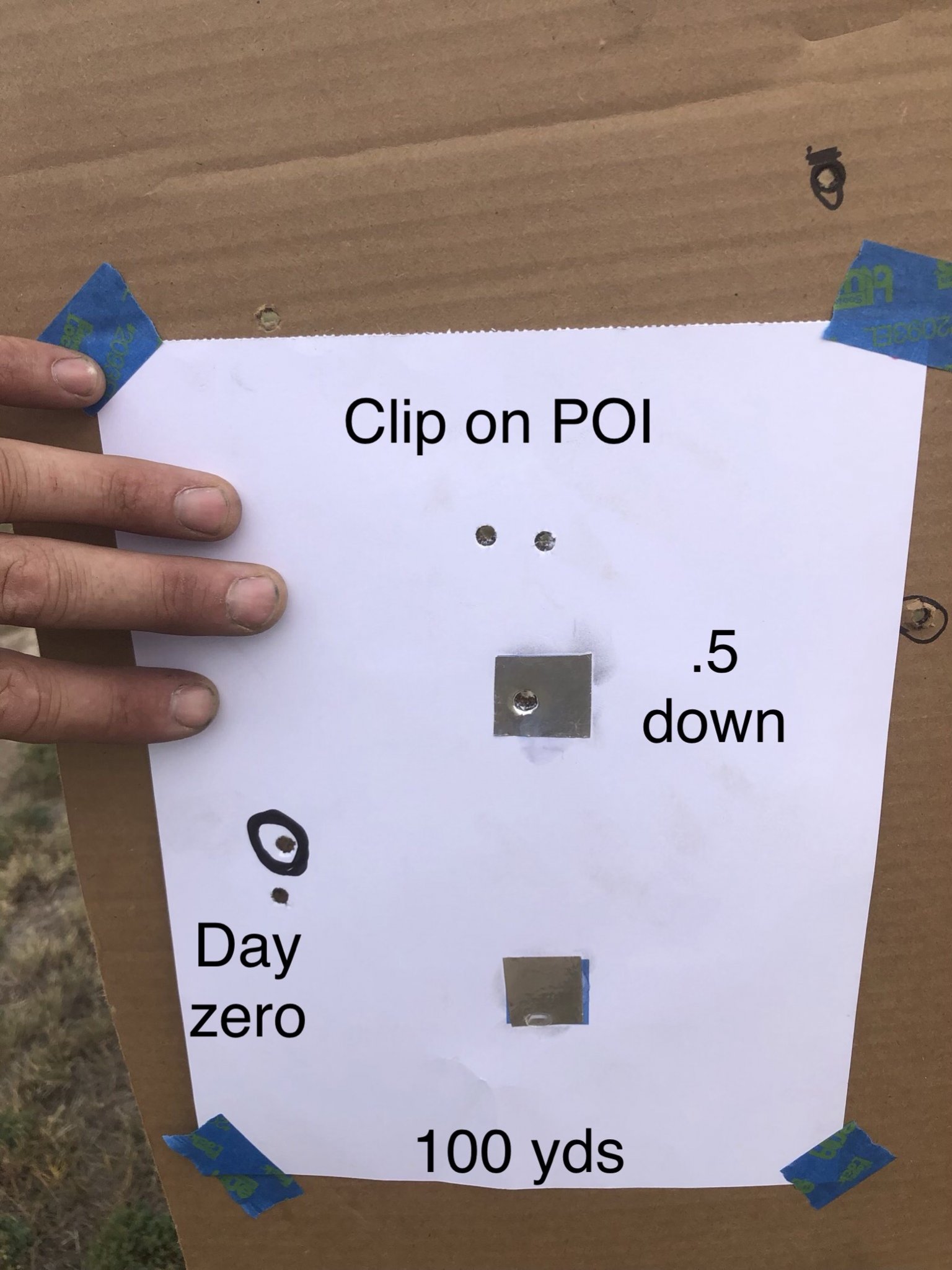

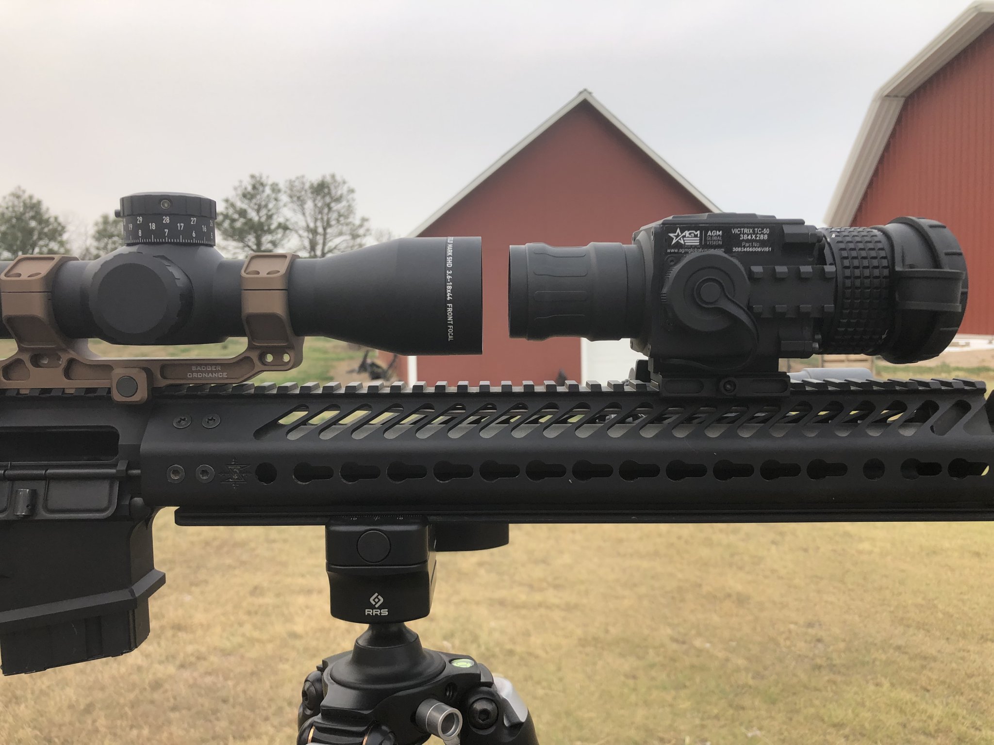

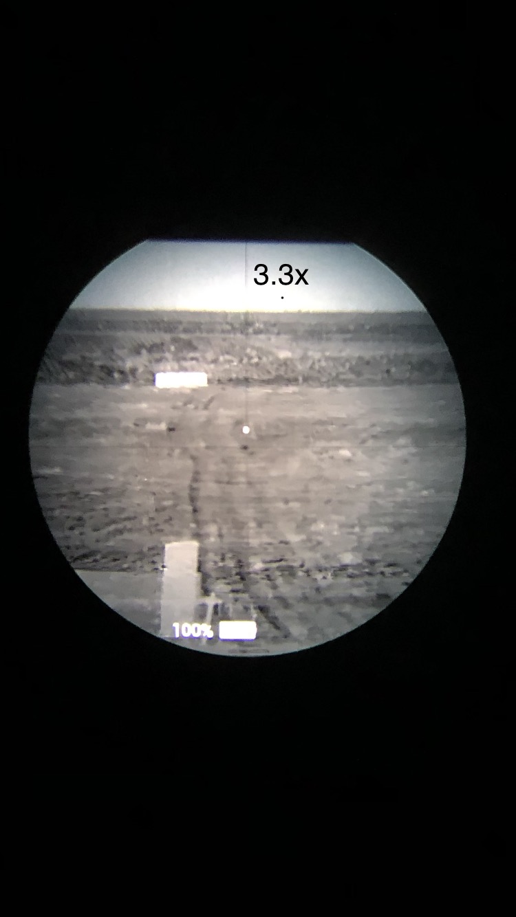

Picked up an AGM Victrix from @DownRangeThermal. Got my day scope
(leupold mk5 3.3-18 mounted in a badger C1 1.54” mount) zero’d today and had a few minutes to mess with the victrix this evening. So far I’m pretty impressed with it. I have had experience with a couple Trijicon reaps so that is what I have to compare to. At first glance it’s no reap as far as sharpness and detail but it’s no slouch considering the spec differences between it and a reap. The focus is fairly touchy but seems to stay put with the recoil from a 224 Valkyrie(fired about 30rds so far). Controls are easy to use and the menu is very straightforward. 3.3x-8x seems to be the best range for magnification. Found myself on 3.3x-5x usually.
My main reason for trying this unit out was I want a more repeatable and precise way to engage coyotes at 300-400yds. I could never really get that done with the reap. Although I really liked the reap and had a hard time trading it I feel like the clipon thermal is going to accomplish my goal. I was able to go 4/4 at 365yds on a 8” plate off of a tripod easily. Made one hit at 410yds but then the wind really picked up from a storm outflow moving by. Hopefully I’ll get some more rds through it over the next few evenings and get some better pictures up.
The through the scope picture shows a heated up coyote plate at 240yds and the 8” plate at 365yds

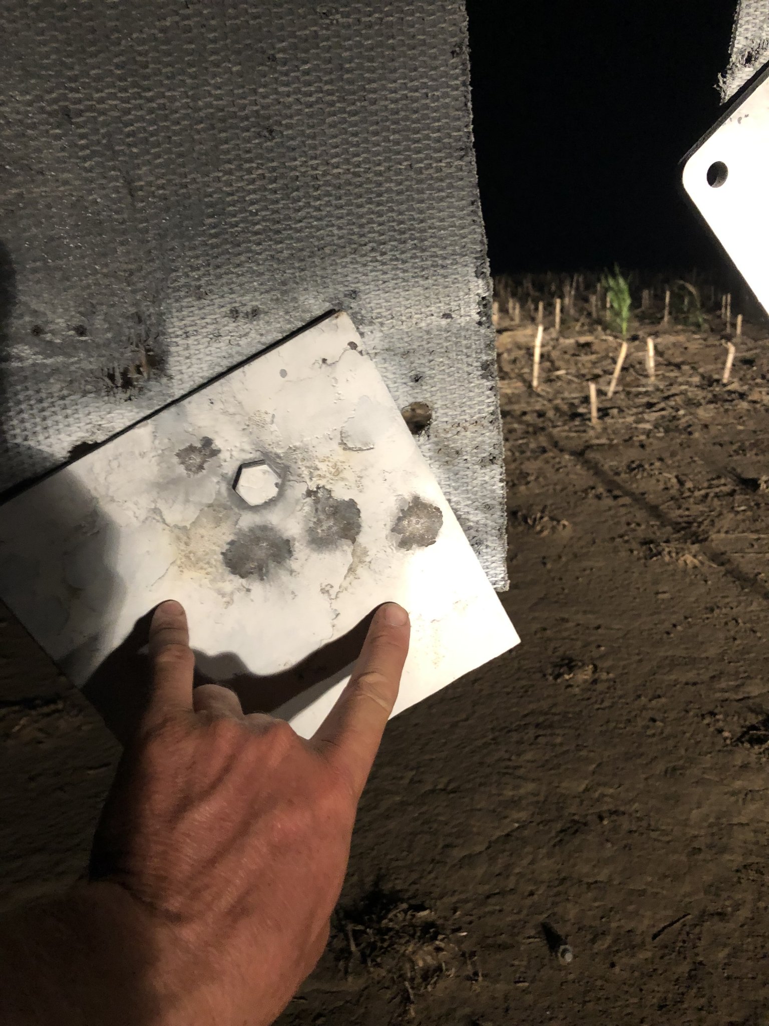

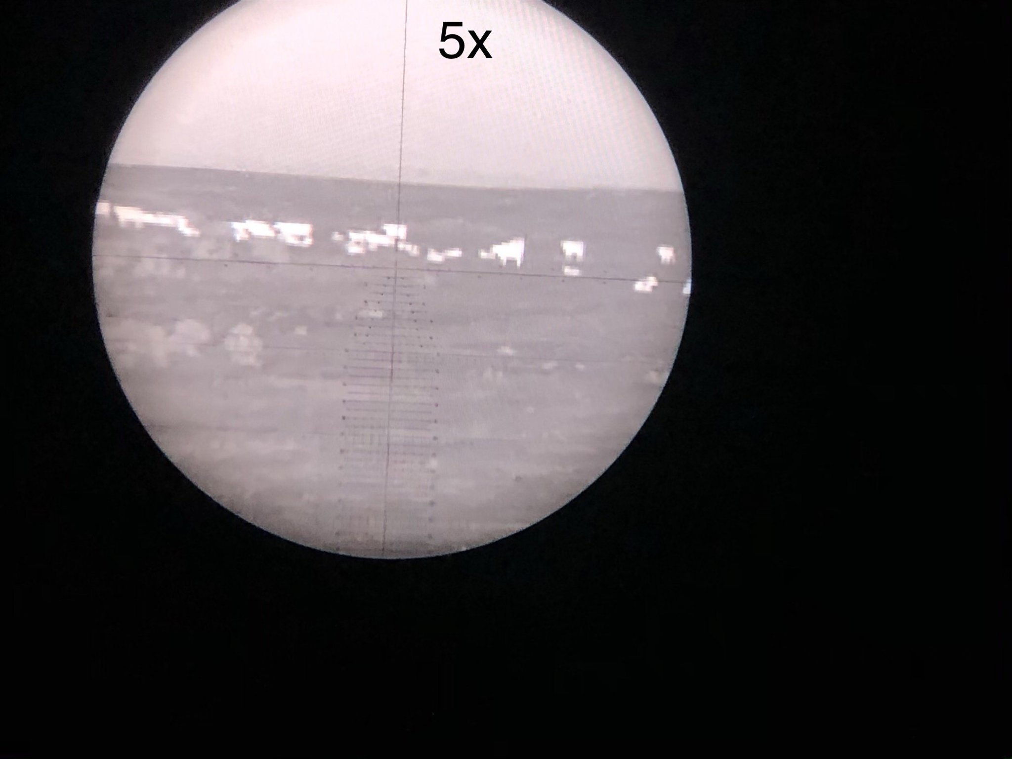

Few pictures from tonight. Bounced through the pasture on an ATV with the rifle on my lap and zero still seems solid and made a first round hit at 365 and a 2nd round hit at 380 (needed a bit more wind)
Cows are 561yds out
6” plate is 380yds

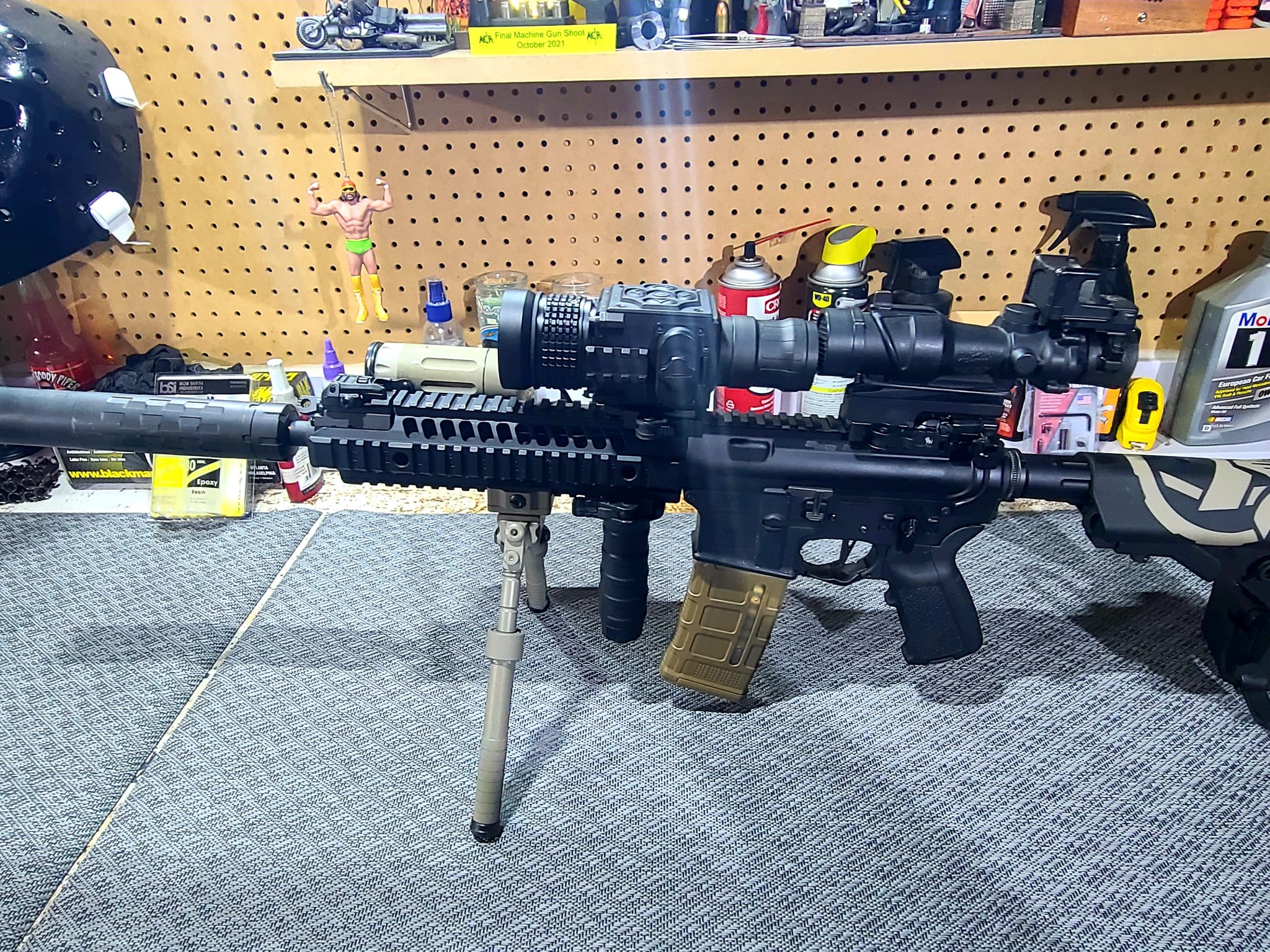

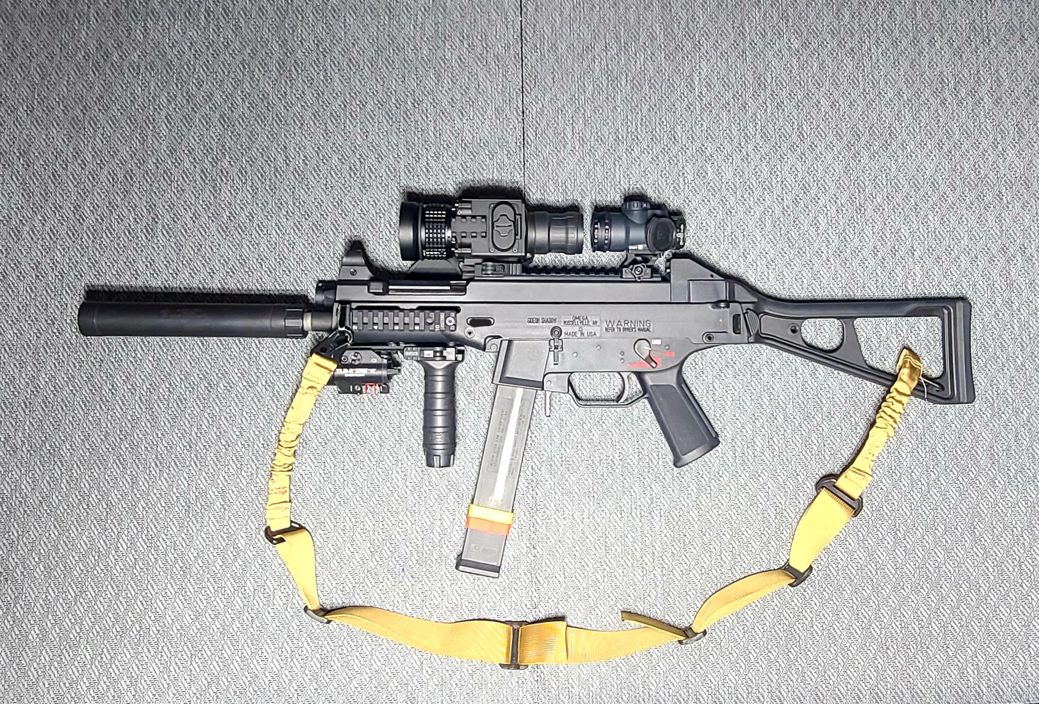

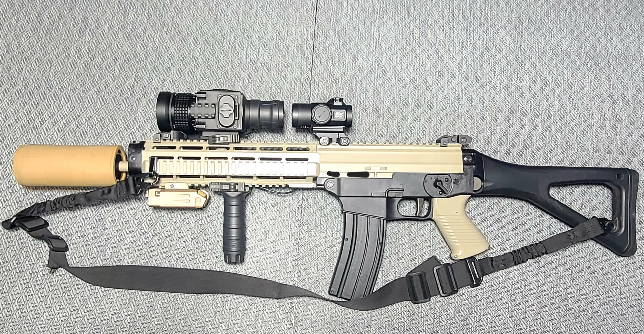

Got mine today. For 3k it's too much a deal to pass on. Thanks to all that posted pics in this thread very little info to be found. Appreciate it.

It comes with the eye pieces, see my pics above. So yeah you could use it as a spotter if you wanted to but it is bigger than a spotter / handheld so.....much heavier than a small handheld.
It is beefy for sure and getting a 50 vs a 35 is nice as well.
Ordered dirext took about a week
I agree with you I don't care about the WiFi and the HD video stuff either so this was east choice for me. Taking pics through it is much harder tho and people will ask lol.....The pics through the ACOG DO NOT do justice. Taking pics with my phone through the optic is a complete pain. They look much better to the eye than these horrible pics
Being a clip on is great because now I can move it around so much easier to boot
