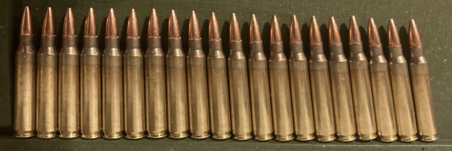

are these the sierra or new production? Looking at the pics it seems that the OAL are all over the place.
These are the 77 OTM with the aac bullet.
OAL for a box of 20 were as follows.
1x 2.227
2x 2.232
1x 2.234
3x 2.236
4x 2.238
7x 2.239
2x 2.241
Also most had a pretty good mark on the rim.

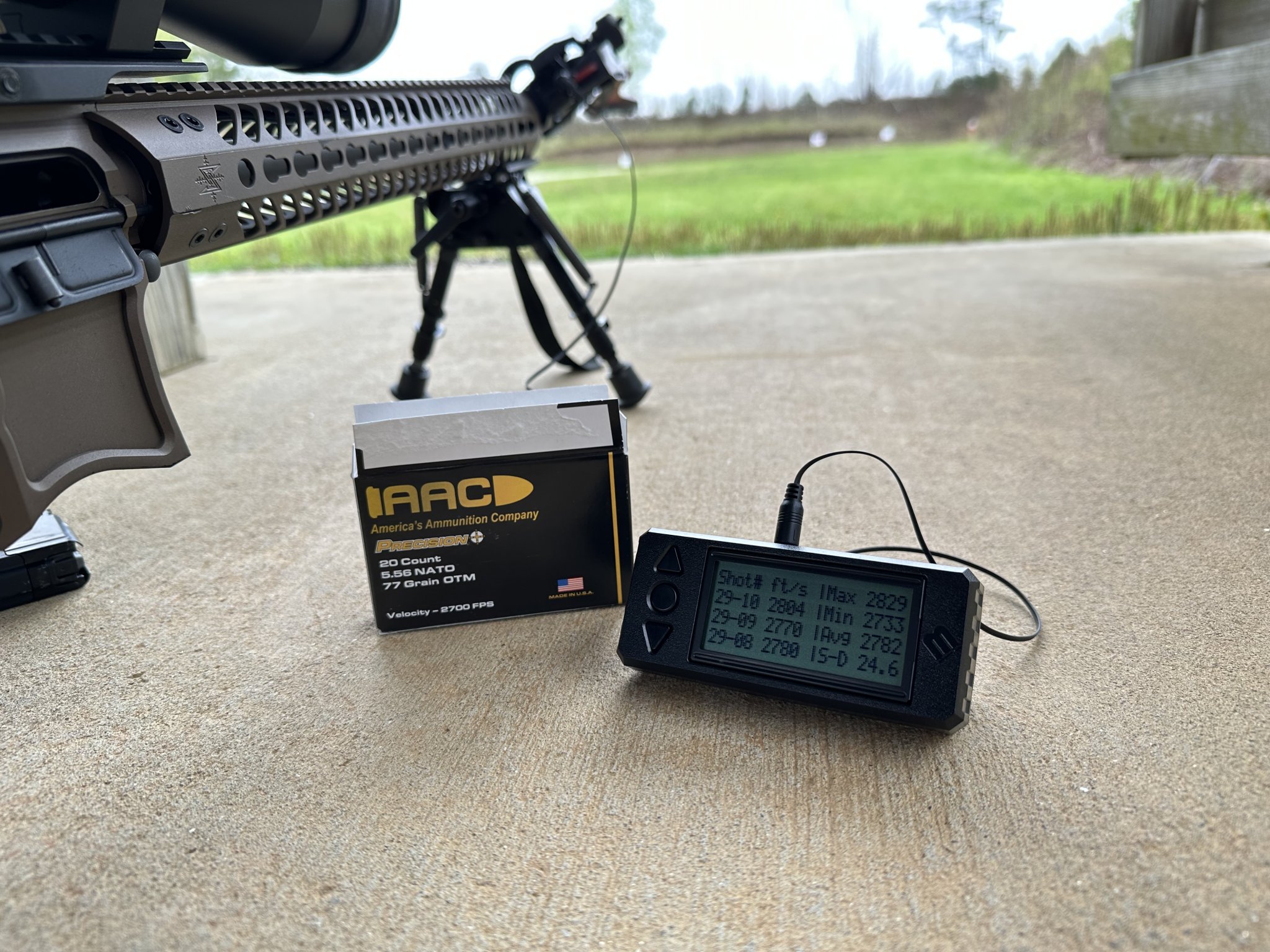

Avg 2782 S-D 24.6
ES 96
Series Shot Speed
29 1 2774 ft/s
29 2 2781 ft/s
29 3 2789 ft/s
29 4 2777 ft/s
29 5 2792 ft/s
29 6 2829 ft/s
29 7 2733 ft/s
29 8 2780 ft/s
29 9 2770 ft/s
29 10 2804 ft/s
If one were to remove shot 7, the Std. goes to 18.39 and ES drops to 59fps.
Avg 2782 S-D 24.6
ES 96
Series Shot Speed
29 1 2774 ft/s
29 2 2781 ft/s
29 3 2789 ft/s
29 4 2777 ft/s
29 5 2792 ft/s
29 6 2829 ft/s
29 7 2733 ft/s
29 8 2780 ft/s
29 9 2770 ft/s
29 10 2804 ft/s

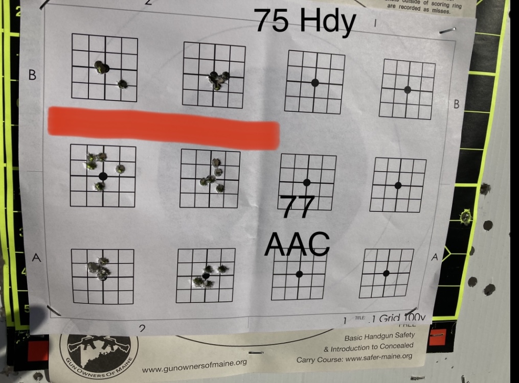

Just got home and measured the above target.
Biggest 77AAC OTM group was .894-.224=.670
Smallest 77AAC OTM group was
.552-.224=.328
I only shot what you see today. Cold clean bore was substantially off for the Hornady load. The AAC load seemed to start settling down after the first 10 shots.
Either way, it was better than expected.
