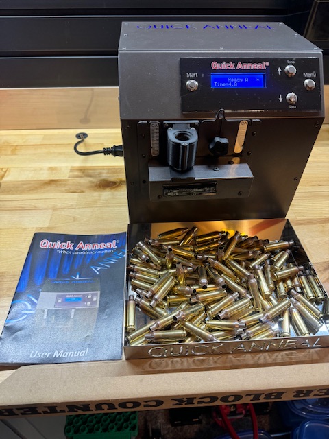

Understand all the AMP love being a AMP thread. Little surprised no one’s mentioned the Quick Anneal. I’d thought I’d read the Quick Anneal was giving AMP for its money.
QA is $1000
Unproven company & machine
Guesswork settings like a flame
induction fast
Automatic case drop fast
Automation w case feed possible tho I have seen no videos of a full automated setup working through a large batch of cases with no user assistance

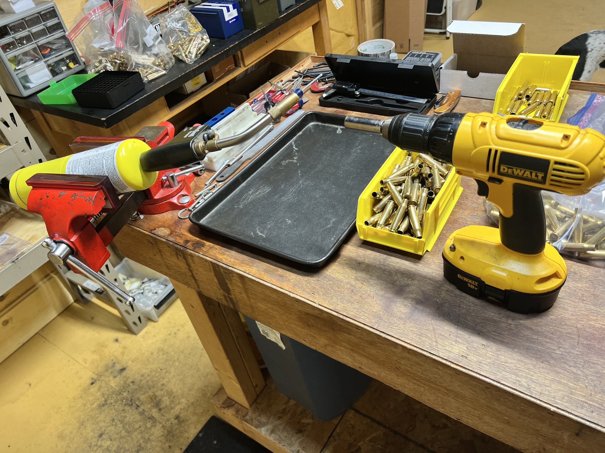

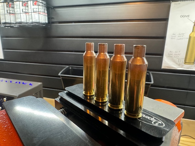

All the benefits people report getting with the $1500 AMP, I get with a drill that was a B-day present, and a $17 map pro bottle from ACE. I can knock out a couple hundred cases with not much strain. Don't have to sit in the dark, can see the anneal line form just under the shoulder in the light. Seating force maintains consistent, and I pin my seating depths CBTO by .0005 either way. I certainly can't shoot the difference of .0005 seating depth variance.
I guess I could add up the cost of map pro bottles to casings and see if over the years the AMP would balance out. :ROFLMAO: Then again, I think I can still throttle through the annealing process faster with my technique.
MacGyver would be proud of that setup ... all it's missing is the bailing twine and bubble gum.

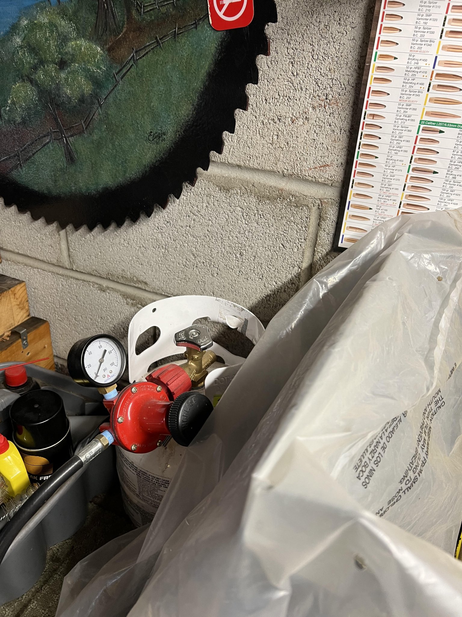

I do think having a regulator setup markedly improves the repeatability of your settings. Set it at say, 20 PSI, 7.2 seconds, and if that's dialed one day it will get the same or close the next. Other reason I won't sell mine is with this regulator and tank and the machine and all the disks including some custom 375 disks, I probably have $750+ invested and I refuse to lose my ass on it when everybody is on the AMP bandwagon

I believe the quick anneal is a great alternative. I have no previous annealing experience and just annealed my first 100 6.5Creed 5x prime cases one hour ago. Very easy to do. I don’t know how to get a video on here but it isn’t really necessary since there are enough videos on YouTube.
That said, the Annie does what I need it to do.
Until it doesn't. I have an Annie sitting on the shelf that had an audible pop one day and then stopped being consistent. I could have sent it in for repairs, but I've seen enough stories about extended return times that I didn't want to wait.
