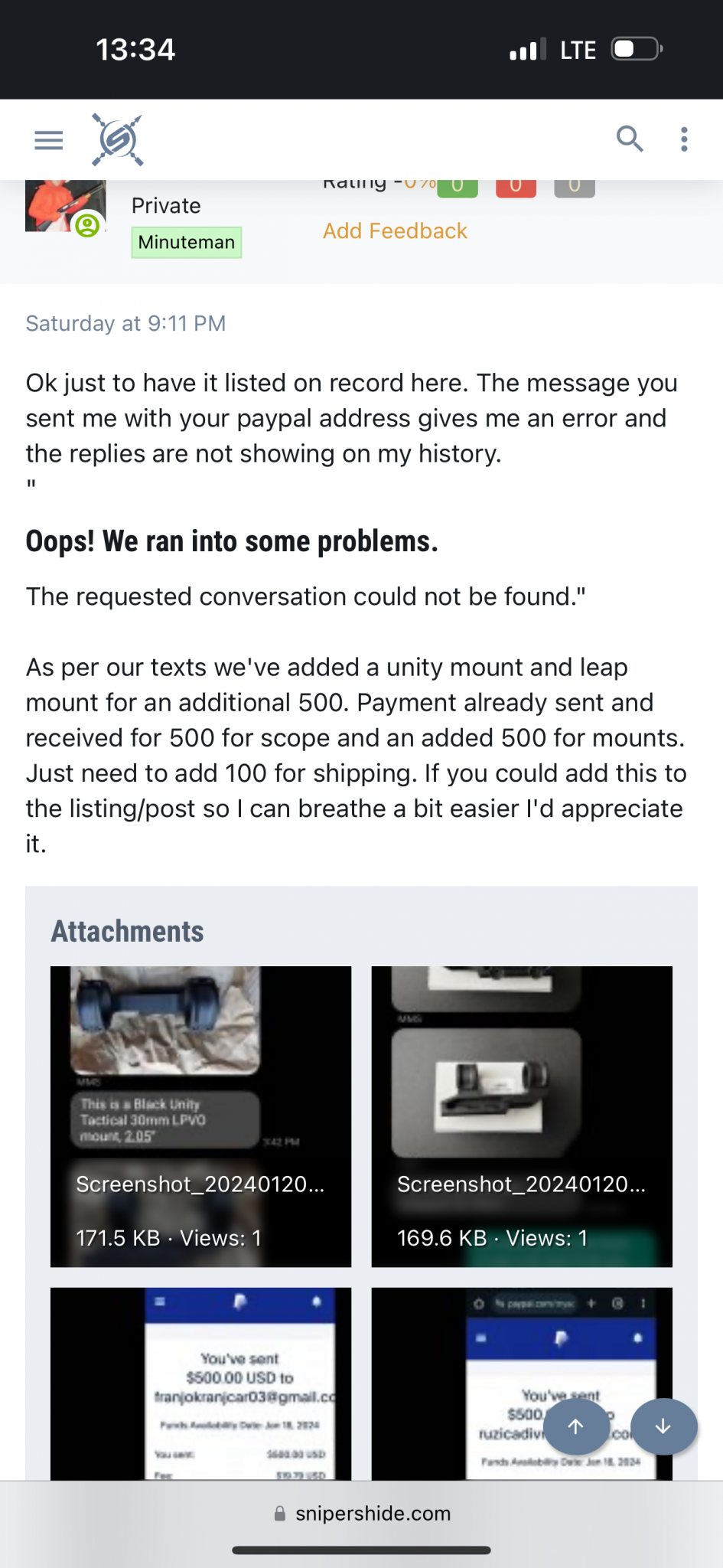

@Maurygold
Might want to swing over to this thread and clear this misunderstanding up.
@Maurygold
You’re a moron. These are scammers with no history. But good deflection
I love that you went after me personally instead of the science I’m asking about in this thread. What a low down approach to life.
WTF are you talking about? I let you know so they were over there dragging your name through the mud. Hence why I said clear up the misunderstanding.
Next time, I'll just let them continue making accusations without you knowing.
Reactions: Baron23
WTF are you talking about? I let you know so they weren't over there dragging your name through the mud. Hence why I said clear up the misunderstanding.
You’d have done it in a pm if you weren’t trying to embarrass me. Facts.
You went searching through my history and found that. You were trying to find something and used it and now you look like an asshole.
No, actually I got a text from someone who knew them. And said they had tried to get ahold of you in PM and you haven't answered. They posted the pic of the PM's that had been sent directly to you and you didn't respond.
I knew you were active in this thread so I tagged you as it seemed you weren't getting the PM's or responding to the thread.
The rest you're just being paranoid and making up. I couldn't care less of your opinion on an AMP or not. Definitely not enough to go searching for something to embarrass you.
