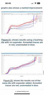

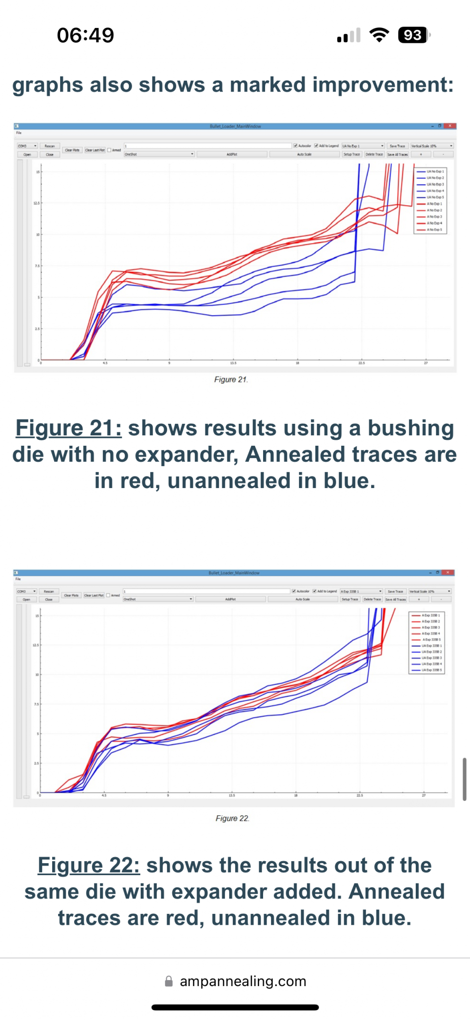

They definitely showed a lower and more consistent seating force after annealing. Other than Lou (who created the product) there doesn’t seem to be research confirming that would translate to improved sd/es/ accuracy. In my own testing I did not find lower seating forces or grouping by force to translate.
Maybe it's you. Maybe you just suck.
So maybe you should do more reading and less telling people what they should or shouldn’t talk about.

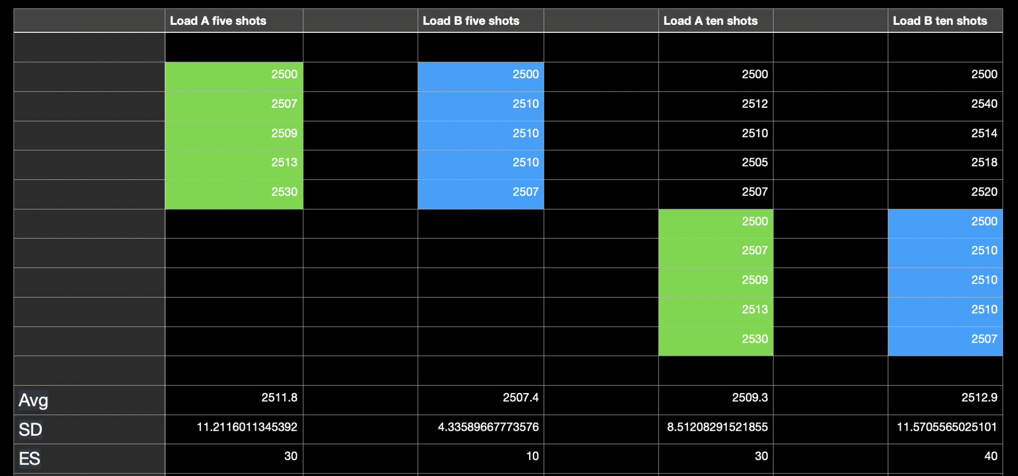

Also, FWIW for anyone looking to understand more.....it's not whether or not you can have an high ES and small SD in a small sample size that matters. It's the incorrect use of the ES combined with small samples that makes it almost worthless.
Here's a simple example that happens quite often. The green and blue highlighted velocities represent the exact same numbers from the corresponding groups. Illustrating how easy it is to make conclusions using small samples and/or ES to make your decisions.
