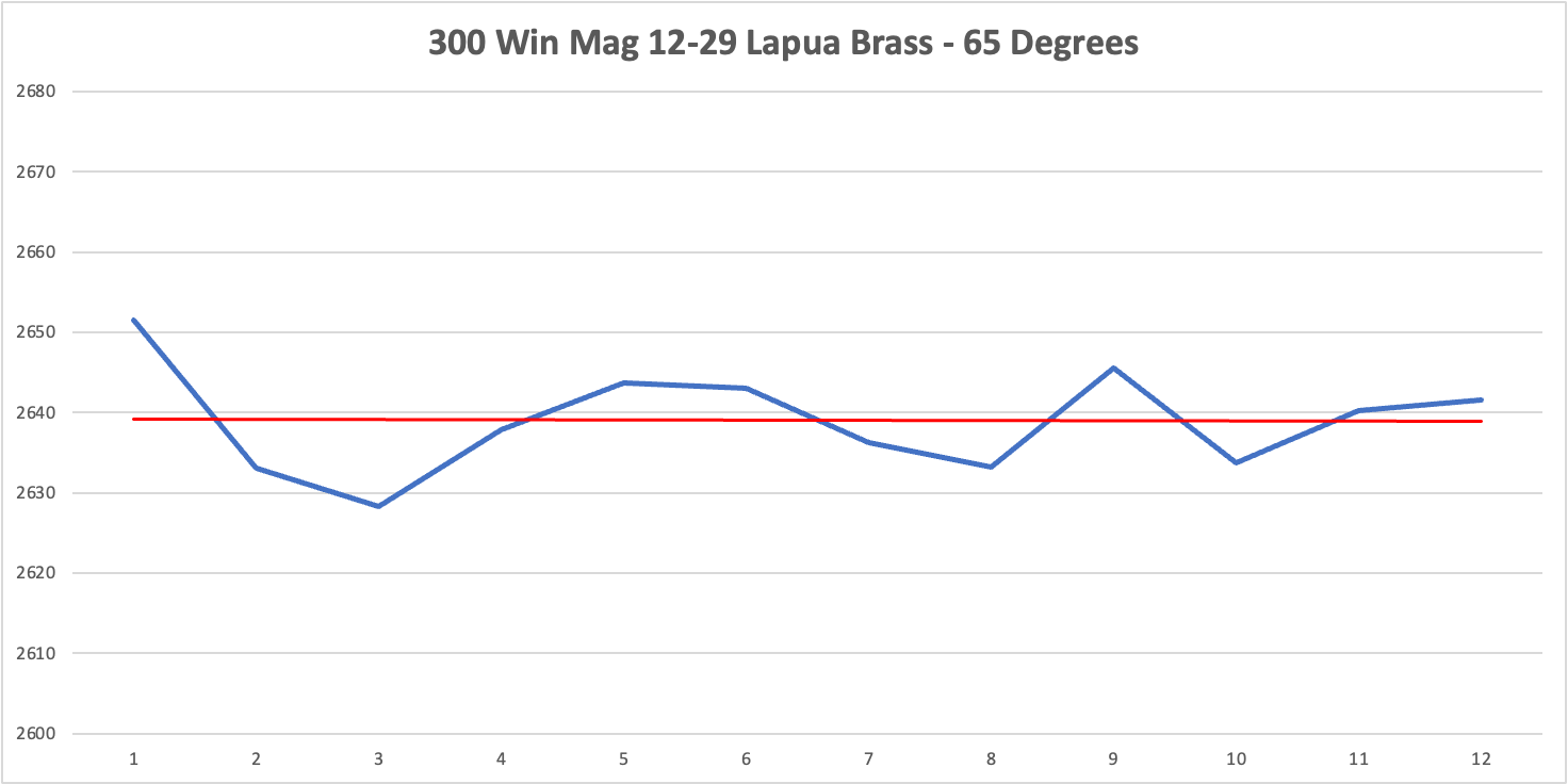

This is my last outing with my 300 win mag - 5x fired lapua brass never annealed.
12 shots (including cold bore):
Avg: 2639
SD: 6.2
ES: 23

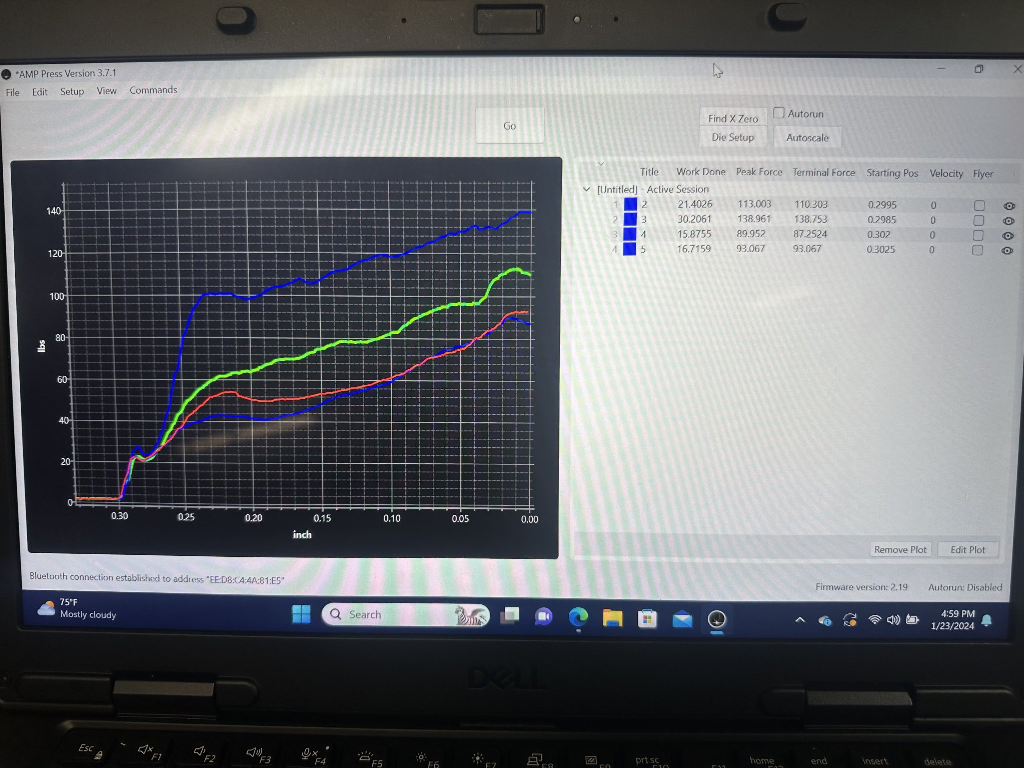

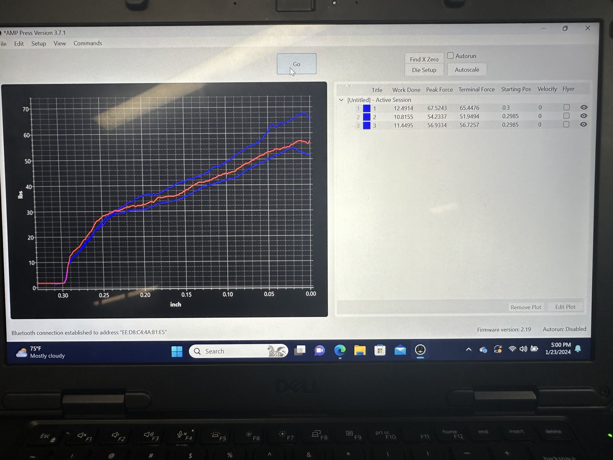

Here is a comparison of Peterson 7prc. Both are virgin brass and both have been put through the same mandrel/size/trim process. The only difference is one is the factory anneal and the other has been run through an amp. It's a very small sample size. But have seen this trend with most any virgin brass.....the factory anneal isn't consistent.
Now, the conversation becomes "does that matter" which requires much more data to come to a conclusion.

That group is on my 300 win mag proof barrel. But I was shooting a lot of f class at the time I was testing seating force so 25 round groups (I was averaging 5-8 SD)

You could also get the sd of these groups if you really wanted since they gave you es and avg so you know the speeds.
I didn't see anywhere in there that said who decided to use ES. Though I might have missed it. Typically in tests like this, they decide to use a metric like ES because so many shooters use it. It's far easier to just use a metric shooters believe they understand, then to attempt to properly change their understanding.....when the point is to show your product works and to sell said product.
And you definitely need to revise your understanding of how SD and ES work.
I can show you examples of two 100 shot strings where both have 5-7sd. One will have an 80es and the other will have a 40es and the 80es is more consistent ammunition. Using small sample size + ES is a very good way to not actually know what's going on.
(there's a reason you don't see anyone in any other industry using ES)
okay a couple issues here:
1. the author chose the plots because he created them from the raw data he had available (as I stated above could have easily used SD since he had the velocities)
2. you just said you don't see anyone in the industry use ES (but also said many shooters use ES - that does not make sense)
3. Unless you are using very large samples sd does have a relationship with ES
4. SD is great when looking at large samples - ES is best for these small comparison groups because we are looking at culling outliers (why your example required a 100 shot size group to hide the ES)
5. Regardless of you trying to argue outlier stats you can't show me ANY testing where annealed brass consistently performed better than non-annealed brass, can you? (SD or ES)
Ah....actually, I think you can. LARGE data set....all data points identical except for two....one to the high side and one low side. Going to have great SD with crap for ES.
I'm not an f-class shooter, I claim no particular expertise, but SD seems to be a far, far more valid and valuable metric to determine quality/consistency of ammunition
it does - in large sample sets. here we are trying to compare several small sample sets so the outliers are more important to me than the sd.

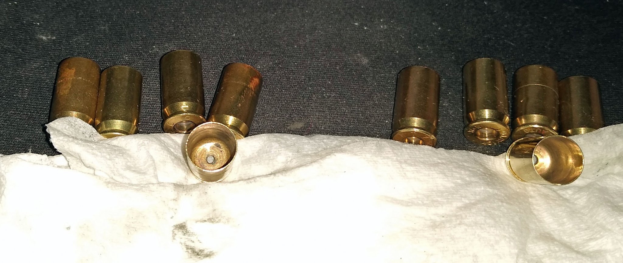

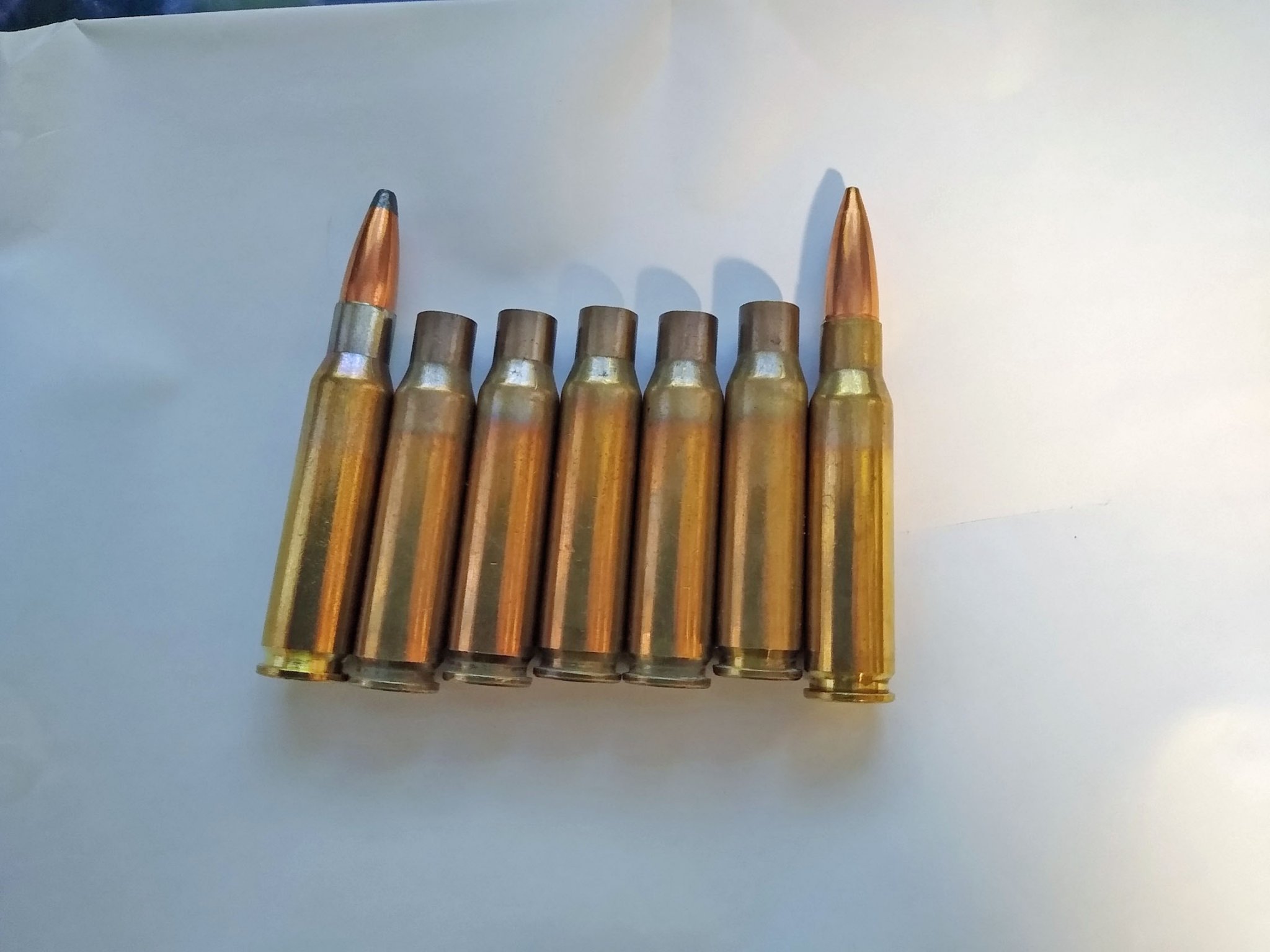

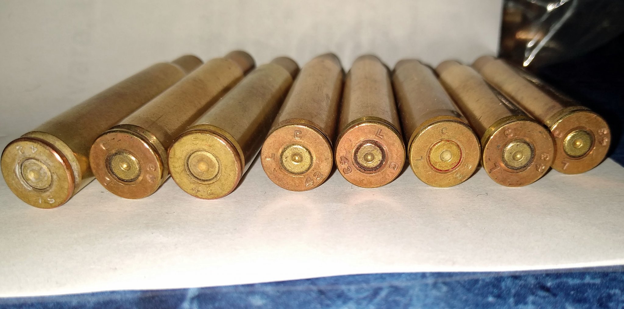

Yo , What the hell do I know I'm still using original once fired 1942-68 recycled LC and SL .30 Cal. in My Garands . Original 1942 cases reloaded now have #28 firings without a single case loss . All loaded within 1 grain Max charge . Annealed every #3 Rd. firing . :cool:
Everyone is entitled to opinion and expenditure . Mine runs cases perfectly as well as automatically ,set for particular case rack and stack ,fire up and move along doing other prep while it runs . I did make several adjustments and modifications to mine ,as the stock unit didn't suit my needs or ease of operation . Each to there own and as we are only restoring ductility to the case neck and shoulder ,it makes zero difference too the case which method one chooses . One can't tell by looking which are Lapua and which are Lake City ,as the witness marks are identical 0.591" from case mouth down shoulder . Is exactly WHY I tweaked MY anneal-er ,so as to match ductility as closely as possible . Mine is repeatable on all CF Rile cartridges I reload for and that's more than #12 . Now whether using propane ,acetylene or Mapp gas , torch selection is crucial as is angle as well as distance flame engages case shoulder out towards neck . I don't do 90 Deg. engagement more like 60 Deg. as it keeps heat in upper portion of the case ,rather than allowing body dissipation . My Bases Never exceed 225 Deg. F and necks see 1K-1200 Deg. F.
Also why I choose ultrasonic cleaning ( on the right ) over pin tumbling or vibratory polishing , because it WORKS Better and is far quicker .
Bottom line as long as one is annealing or restoring ductility ,matters little on how it's done ,induction or flame Your choice .

And others have reported they have been able to correlate SD and precision to seating force from AMP
I've done so with permutations of lube/no lube, mandrel/no mandrel, and there was a correlation between seating force SD and muzzle velocity SD.
I'll be doing more testing at some point, but it's a bit tedious.
By the way, interesting comparison of factory annealing. I'm happy to do the same with a larger sample size, given I've got a crap-ton of forming coming up where I just don't care about performance. First run I'll be doing 100 total 6 BR >> 6 BRA and probably 50 300 PRC cases, so that's a decent enough sample size for each. I'll chrono everything too, though all of this will be through new barrels, so that screws with stuff a bit.
