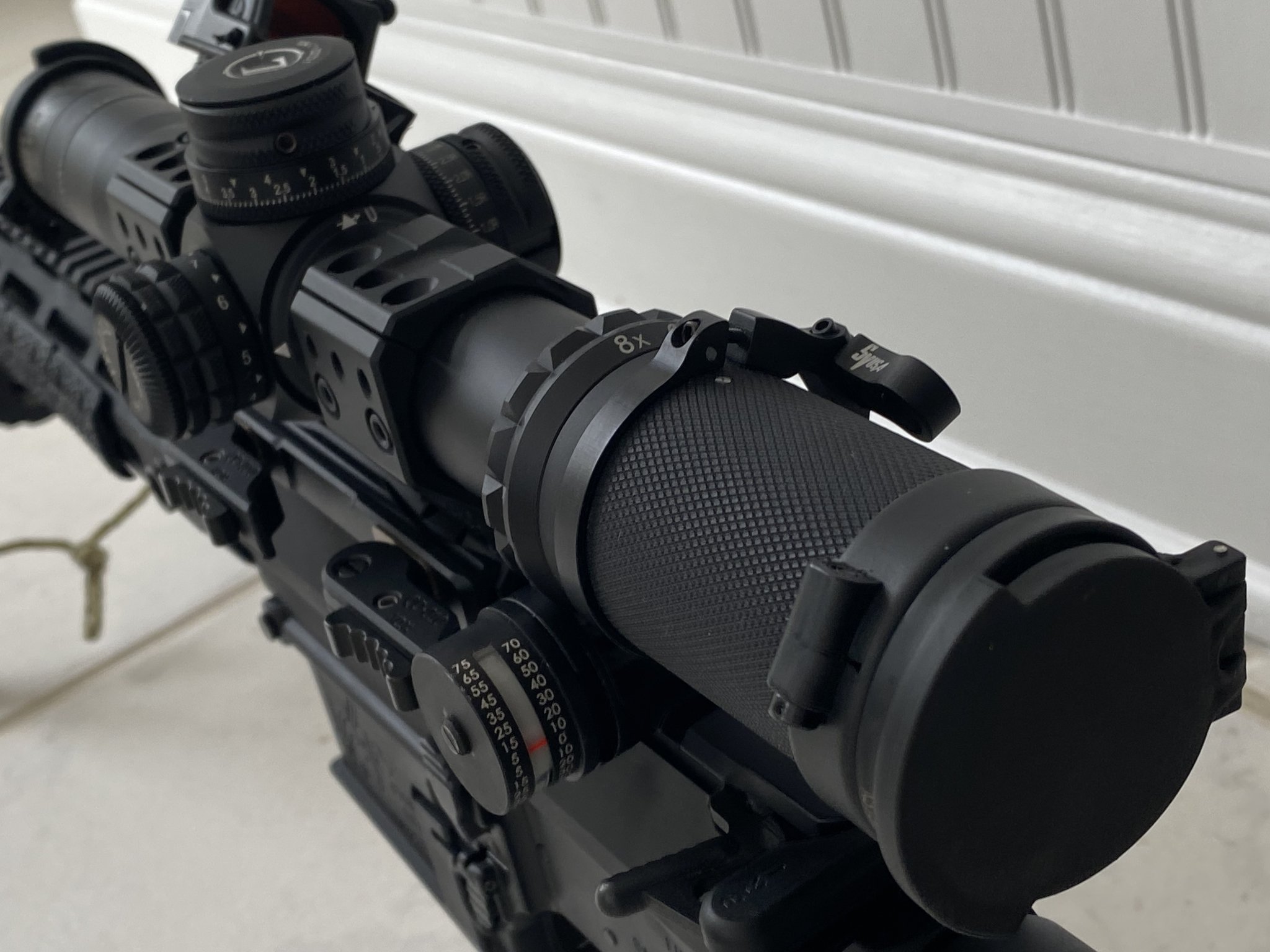

How do you find your inclination when calculating range? I have been looking for something simple that can be mounted to the scope or rifle but either coming up empty or getting results for things that seem wildly over priced for what they are ($200+), so far the best option I have found is also the clunkiest, an app on my phone that measures the angle the phone is at, basically I would have to lay the phone sideways along the barrel like a carpenters level and then take note of the angle.
It seems like there should be a simple low tech and low cost solution, that is not so clunky and cumbersome. What do you do?
I did see one option, a ball level thing that attaches to the scope but the only place I found one affordable only carries it in 30mm, everywhere else has it for $200+.

You could probably find a way to attach this to your pic rail......lots of adapters out there, something should work.
Be hella accurate but you'd have to peek around to view it.

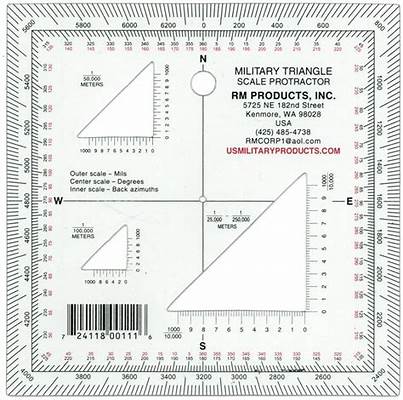

It is hyper accurate and it is cheap.
Just thinking outside the box fer ya :)
Buy ewe won of these and tie some 550 gut to the middle hole with some small nut or washer on it. Squint to read little numbers

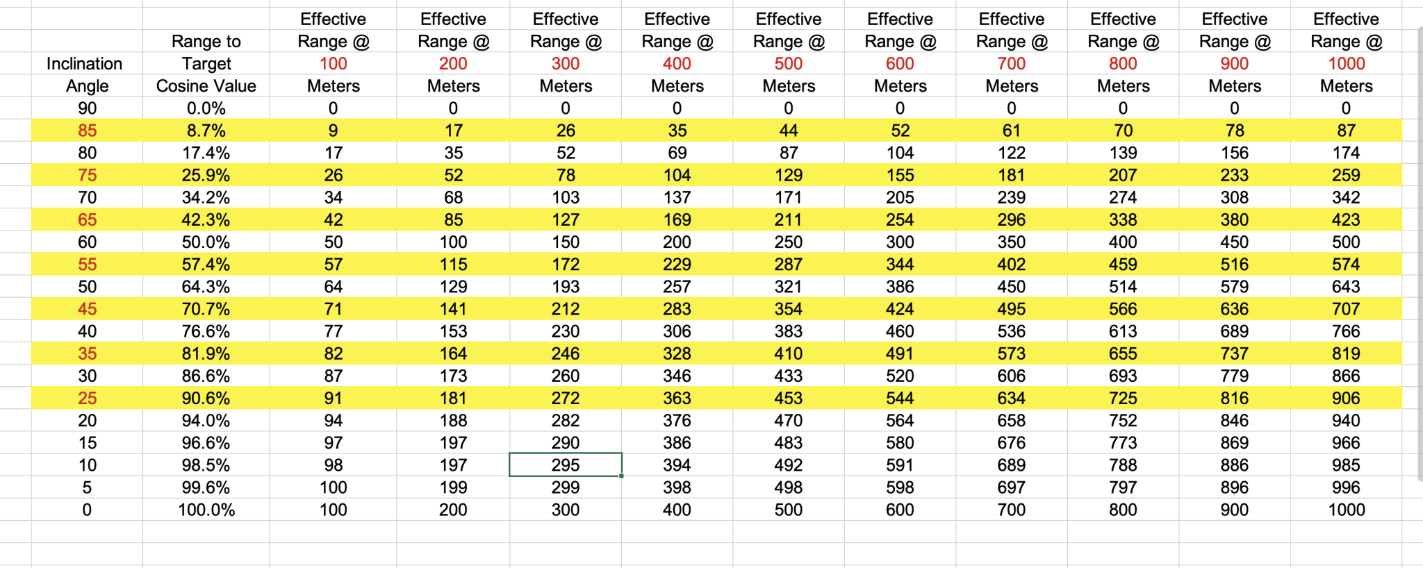

At 1 mile with a 338 Lapua, changing the slope by 5° changes the point of impact by one click (.1mrad)
You can almost always guess the angle to within 5 degrees and if you are shooting at a mile, you have time to put your phone on the top of your scope and you are almost assuredly not going to be changing the angle of your shot from shot to shot at a mile by more than 5 degrees
My point is everybody always talks about all of these variables, and how you need to account for them, but many of them impact the firing solution, no pun intended, too little to really matter
