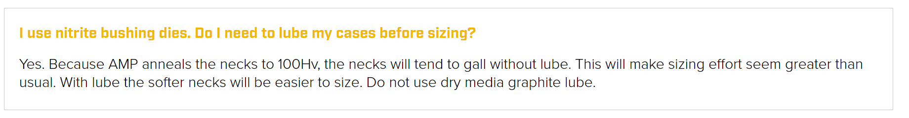

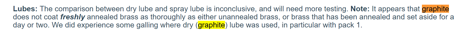

Graphite is specifically not recommended by AMP because it won’t stay on an annealed neck.
https://www.ampannealing.com/faq/
https://www.ampannealing.com/articles/42/annealing-under-the-microscope/

There's no grabbing or galling for two reasons:
1. Due to the die being reamed where the amount of work the mandrel has to do in small for not much pressure on the interior neck wall.
2. The tumbling with rice leaves a very, very small coating on the inside of the neck that's not sticky and acts as a lube; making for smooth consistent seating.

I’ve been thinking about getting into annealing, but after reading your post I’ve had more to think about. I’ve been using 99% alcohol and lanolin spray for Lube also getting a quick spray across all the brass in the necks before sizing. I’ve tried tumbling and I’ve tried just cleaning the outside with 99% alcohol and a rag. I could definitely see a pretty consistent residue inside the necks after tumbling because the dust stuck to the Lube. But I’d like to skip the tumble step. I’m wondering if I anneal then spray Lube and then size if my necks would have enough Lube?
Just change your lube make up and then you can clean it off with warm water and dry em and be done.
I use 99% alcohol and rcbs lube mixed just like you do with lanolin. The rcbs is water based so it will come right off with water and works really really well sprayed when dissolved in 99%alcohol. This is the way.
Reactions: Ronn and Haney
Carb cleaner on a qtip applied to the inside of the neck will leave a super thin film of oil on the surface. Then graphite will stick to the neck.
This makes sense - I've found the same when I don't fully wash off the cleaning solution I use in my ultrasonic. But now I've found the joy of dipping cases in Neo Lube #2.
