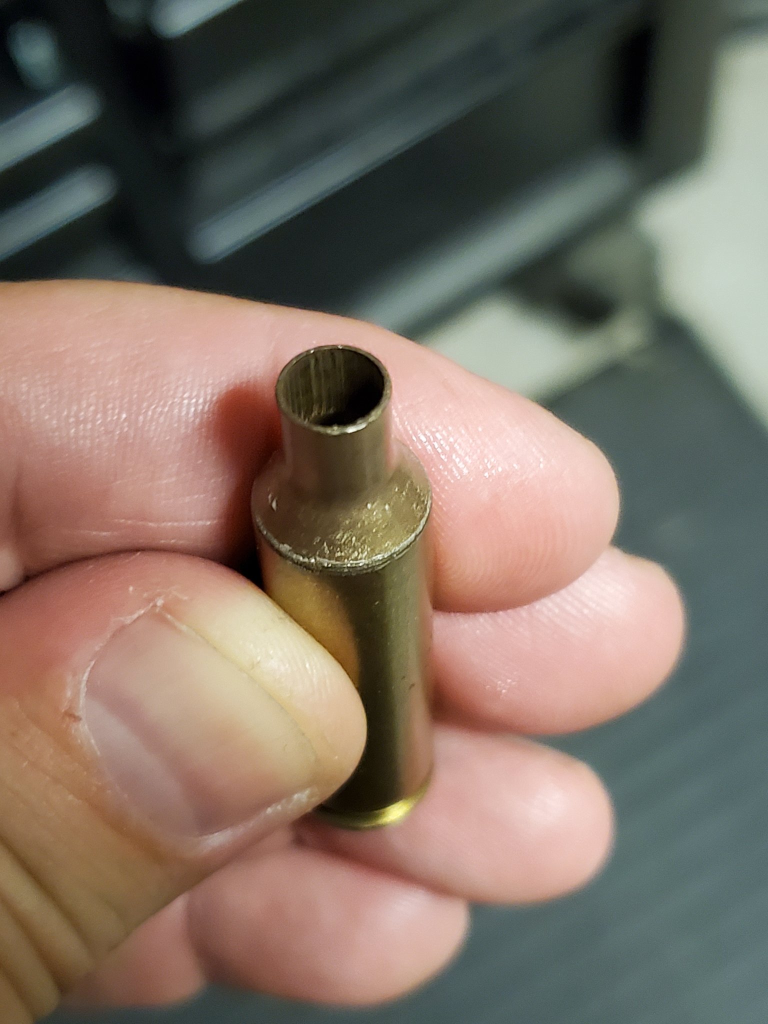

In another recent thread there was a discussion over carbon being baked on the ID if the case neck during annealing. This was new info for me but I have always noticed that my expander buttons got black gunk on them and came out of the case kind of rough.
Today while sizing some brass I paid attention specifically to this. I am finding that the ID of the brass gets axial scratching while sizing. See below
I confirmed that this was caused by the sizing process. Is this normal or how do I fix it?
Prior to sizing, the case was tumbled with SS media, dawn dish soap, and a bit of Frankford Arsenal Brass Polish for 2 hr, dried in a dehydrator, then annealed with an Amp in Aztec mode. The brass was lubed usimg a plastic tub and lanolin/alcohol. Nothing was done to the ID of the case.
It's not so much the carbon being baked on, but just as much its about any residue (like any film left on the surface face from cleaning or polishing solutions or the minerals just from plain water or particularly hard water) will get burnt on leaving a surface that produces a lot of friction. This is why annealing is best done before cleaning. Note too that wet tumbling with SS pins/media will clean the carbon off of the neck surface making the surface such that it will not be as smooth running as when the carbon is left on, but not as bad as when annealed.
In order to keep from getting the inside of the case necks galled by the expander button, you need to make sure you lube inside the neck. That should take care of the galling, and. . . it should help keep your necks concentric.
I don't use n expander button in my sizing die. When the die sizes the neck down, I then used an expander mandrel to expand the neck to the diameter that gives me the neck tension I'm after. And I'm leaving the carbon coating in the neck by cleaning my brass with a vibrator tumbler with medium grain rise, which cleaning the outside of the brass very nicely, AND. . . the rice adds a little bit of coating that adds a little additional lubrication.
A little confused here, you say " Nothing was done to the ID of the case " and " my expander buttons got black gunk on them"
Are you expanding the neck?
Also the edges are peened over from the steel pins you need to chamfer the neck.
So sounds like 2 options then:
1) take expander button out of die then tumble w SS again to remove residue, then mandrel, or
2) tumble w SS after annealing and use the button/mandrel.
I'll try it. Thanks!
Any time you remove the carbon coating that's left inside after firing, it's a good idea to lube the inside of the neck. Though if your expander mandrel is made of carbide instead of the usual steel, it's probably not necessary.
Sorry for the confusion.
I mean I am not lubing or brushing the neck ID after annealing. I lube the case with lanolin and size with the expander button in. Then I would wipe off excess lube and chamfer.
Here is my current workflow:
  1. Shoot 6CM and pick up brass
  2. Decap
  3. Tumble w SS, dish soap, and polish - I also have a vib tumbler that could be used if better.
  4. Anneal
  5. Lube cases with Lanolin/alcohol spray (no lube inside necks besides overspray)
  6. FL size - Up to this point, I have had good luck with the expander buttons on the dies but do have all mandrels (0.2435, 0.243, 0.242, 0.241)
  7. Wipe lube off all cases
  8. OD/ID chamfer
  9. Prime brass
  10. Lube case necks with Imperial dry lube using application media
  11. Charge
  12. Seat bullets
  13. Wipe excess neck lube off
I started using the dry lube for seating bullets because they seemed to seat rough. I suppose this is because of the same issues I am seeing with sizing. What would y'all recommend changing? I have almost all gadgets to do about anything.

Maybe the expander ball needs to be polished and sanded to me. Also if there is carbon in the neck before annealing it will harden and when you run it thru your die this could happen. I always use a copper brush I had left over out of my cleaning kit, and I use it on the neck of the casing before I tumble my brass. Also if using a mandrel, always use lube. I know they make them with coating now that say you need no lube, but you really need it regardless. I also FL size without the expander in place with my Redding dies with only with the neck bushings. Then run it thru a mandrel to get proper neck tension.

What issues are brought up by annealing? On another note, I messed up my usual order on a batch just yesterday, I deprimed,wet tumbled cleaned, then I forgot to anneal with my AMP and I sprayed One Shot on cases. So I wiped cases down with alcohol and a towel but the inside still has some lube I am sure. Can I just anneal? or do I need to tumble them again? Thanks
The amp causes a crust to form on the ID of the neck and I was getting some galling inside the necks by the expander button on my FL sizer (see original pics).
Are you using pins or just wet tumbling?
You can just anneal without having to tumble again, but you really should use some lube on the inside of the neck when you resize or when you go to seat your bullets.
Cleaning after annealing helps with the issues annealing brings. Pins only get the brass shiny and pretty. They don’t do anything functional.
Hmmm?? I'm not so sure about that. The pins will work on the inside surface of the neck and remove not only the burnt on residue from annealing, but also the carbon layer from firing. And, the pins will do a good job of getting into the primer pockets to clean. Without pins, those areas don't get touch, though the chemicals used to clean (like Lemon Shine) help with that cleaning, as does very hot water.
