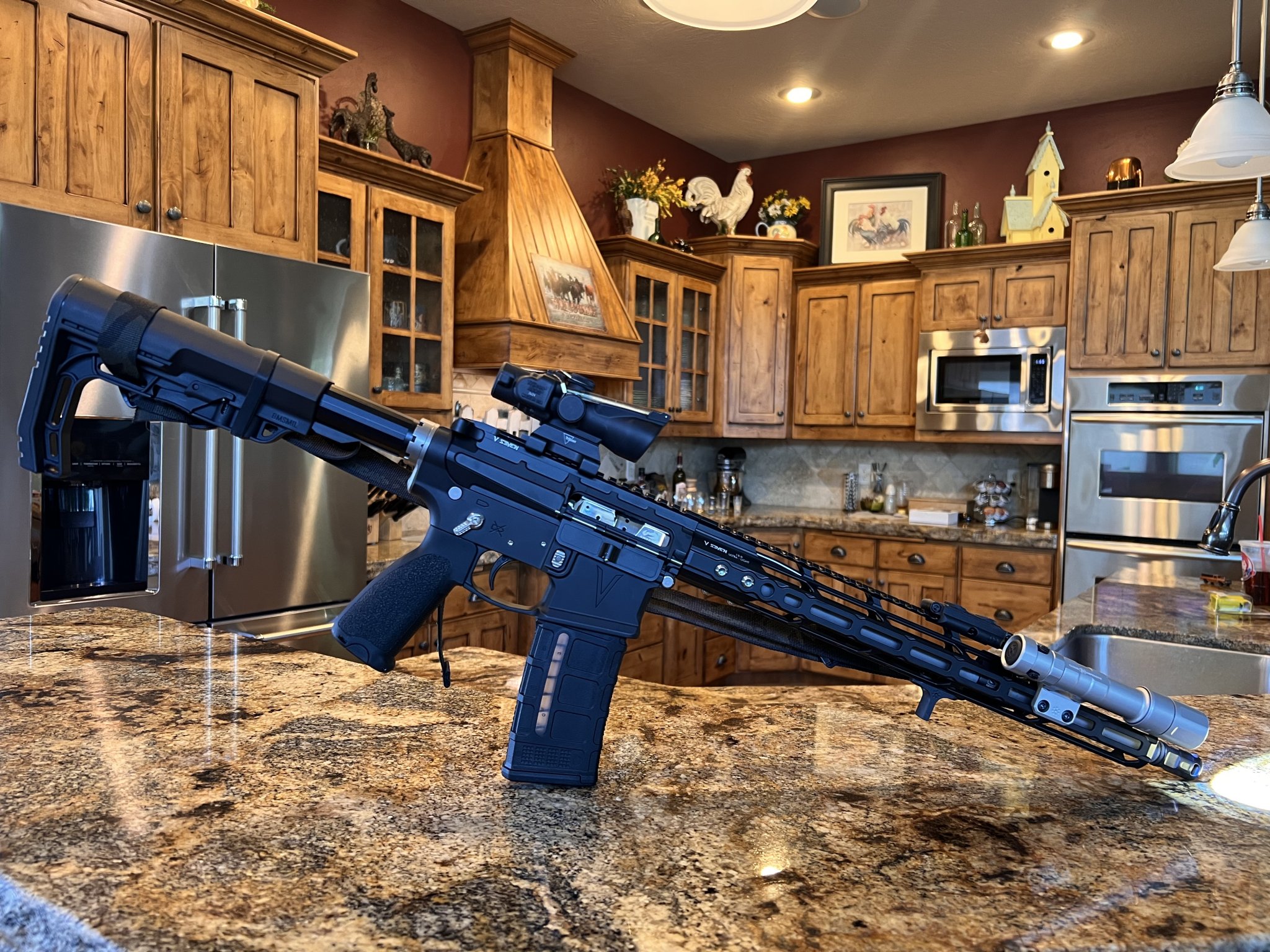

I own a V7 complete build in 223 wylde the Enlightened Rifle. I have also talked to Joel on the phone. I know this thread was originally for the AR10. I wanted to be helpful and speak about my experience with this rifle. In short, It has a nickname (Little Evil), because I put a delta point pro on top and it weighs nothing, and its accurate as hell. I zeroed it 36 yards (see Shawn Ryans you tube video on 36 yard zero) I can still bust clays for skeet shooting at 300 yards. A bit tricky with a red dot but within two to 3 rounds it was easy. As far as durability, I have only shot it at the range and I have had ZERO issues with function or feeding or accuracy. I am not a war fighter and typically don't abuse my stuff but from what i have experienced, I would not hesitate to take this rifle on a hog hunt, which i plan to do in February. If you want to abuse the shit out of your rifle then I might suggest a PWS as an owner, they are heavy. Pick your poison. But If you take care of this rifle, im sure it will stand up to Ur needs. I highly recommend either. I love my V7!!
