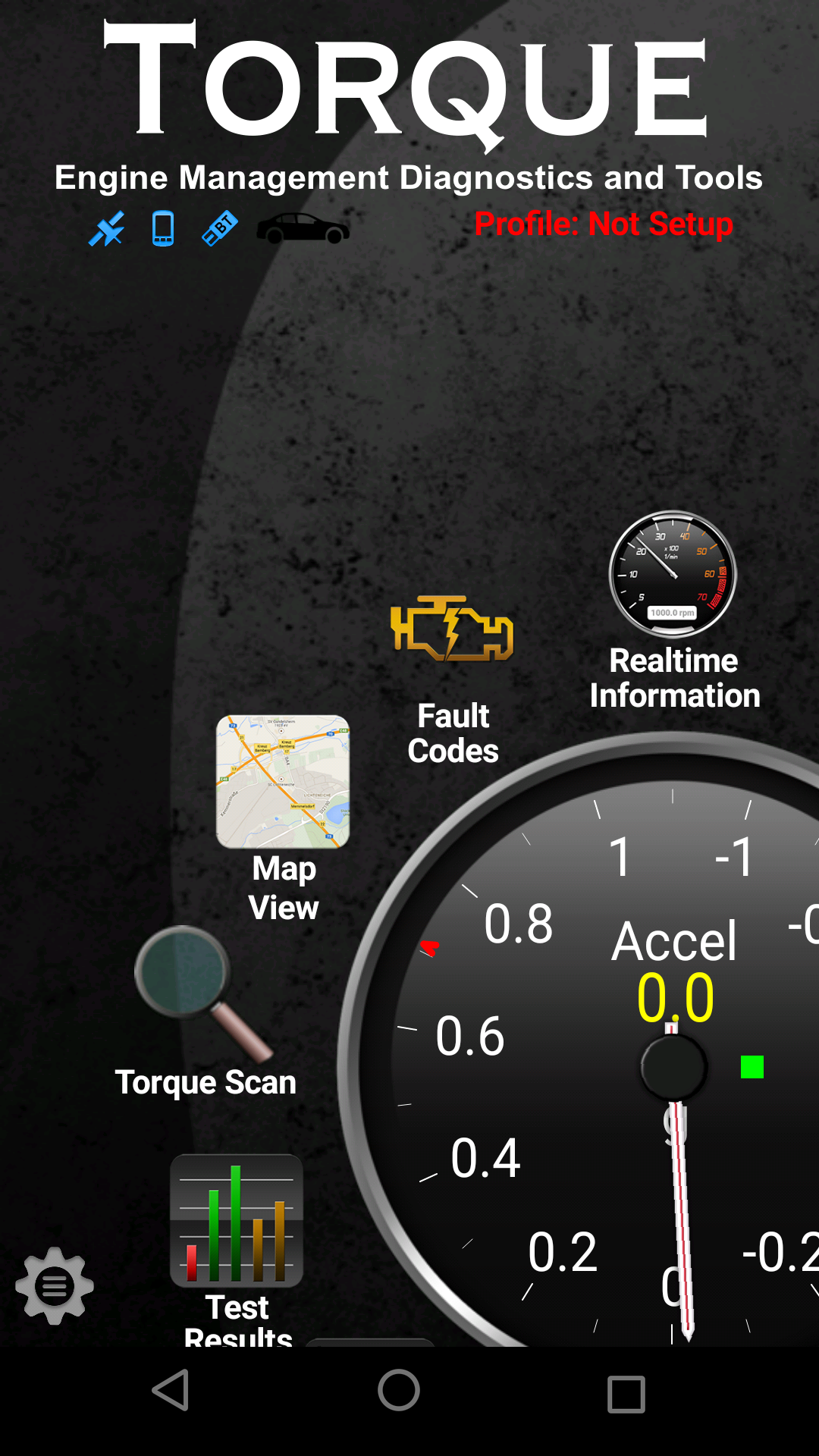

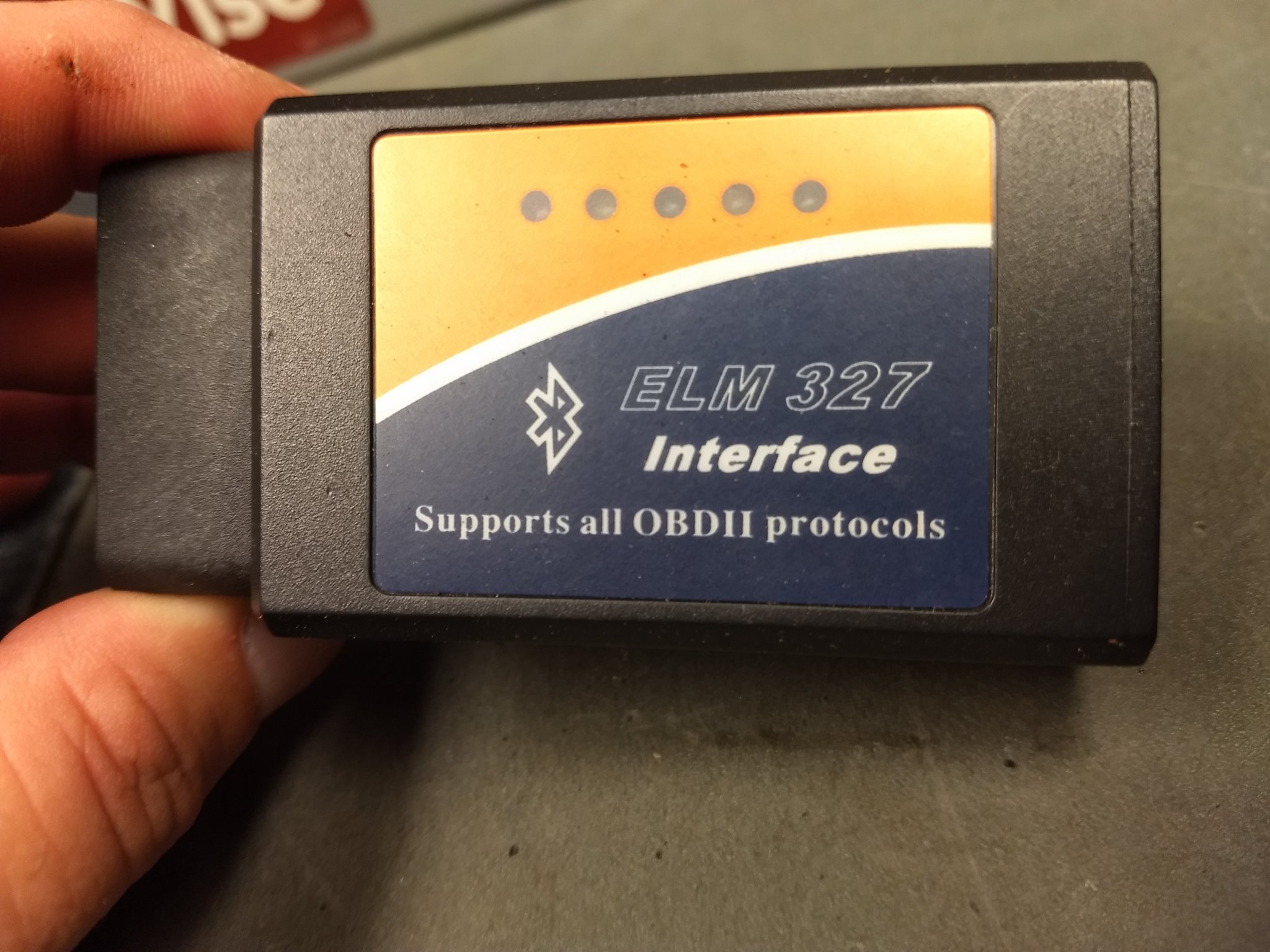

You can buy the scanner on ebay it's a elm327 for cheap like $13 the down load tourqs app for $5 or so and you can read and clear the codes. Shoote a call tomorrow if any questions. I use to build LS motors and this was an easy way to figure things out with out charging 500 to run it thru the laptop programers I used hp tuners
View attachment 7142352View attachment 7142353
2nd this option. I picked up a bluetooth module for $8 on Amazon and use the Torque Pro app and it's done exactly what it's supposed to do. Spits the code out and shows basically every bit of data going through the computer.
