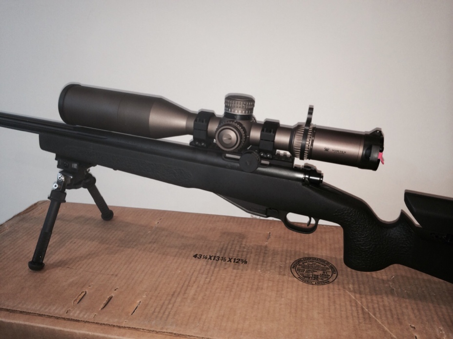

Yep Win70 type work very well, here is a couple from Dave Lauck DL Sports.
First one is a PDC Custom Chassis with .308 Montana Rifle Company Model 1999 Action, still Win 70 based with some small changes.
Second one is same chassis but with LA Win70 .300WM.
Next build with Dave already in the works using ARC M5 action, should be getting DLC Coating very soon.
