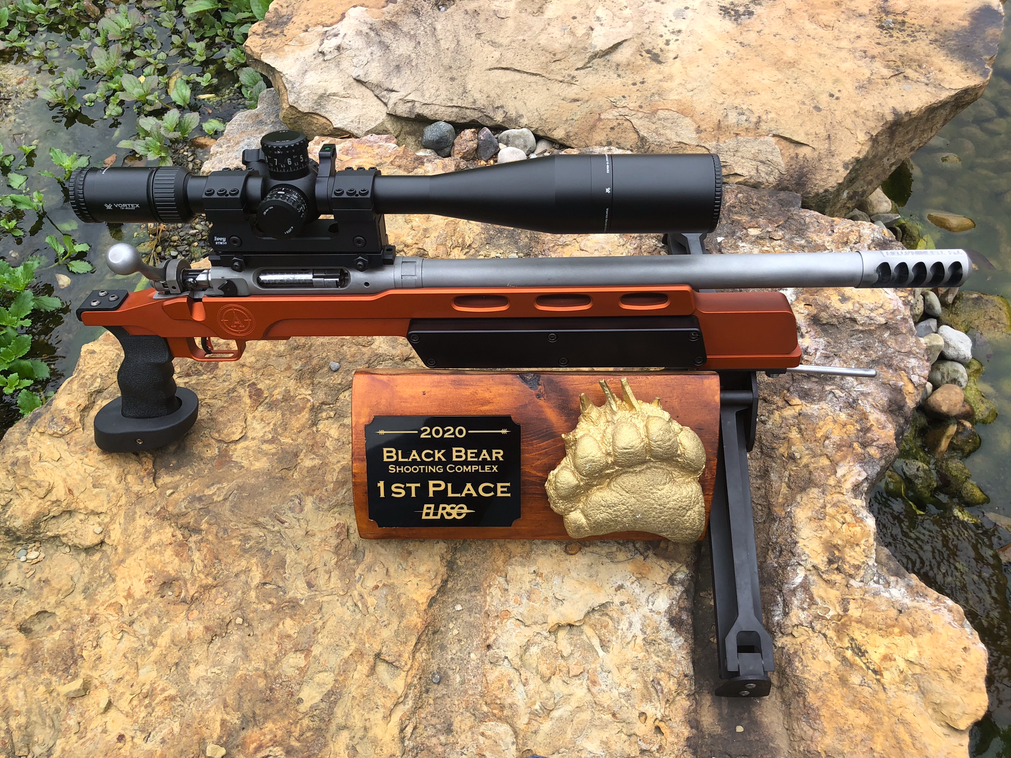

I’ve been shooting ELR competitions with a handgun against rifles for several years now and can tell you the only disadvantage is velocity. The Nosler cartridges were the answer to being competitive against rifles for me. I started with the 28 Nosler then switched to the 33 Nosler. I have also competed in 22 Rimfire ELR Rifle Matches with a handgun and done very well.

I’ve been shooting ELR competitions with a handgun against rifles for several years now and can tell you the only disadvantage is velocity. The Nosler cartridges were the answer to being competitive against rifles for me. I started with the 28 Nosler then switched to the 33 Nosler. I have also competed in 22 Rimfire ELR Rifle Matches with a handgun and done very well.View attachment 8226934View attachment 8226935

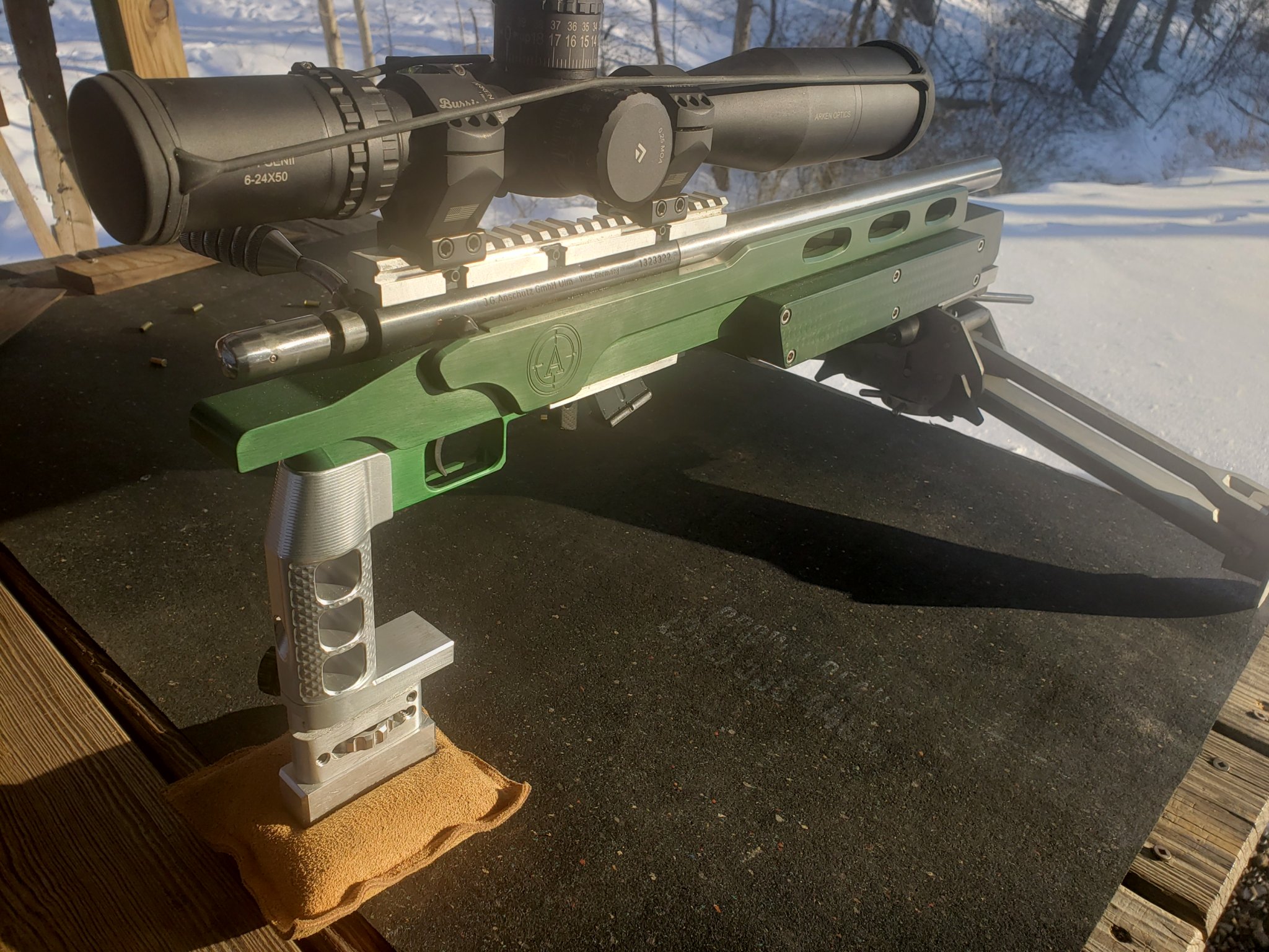

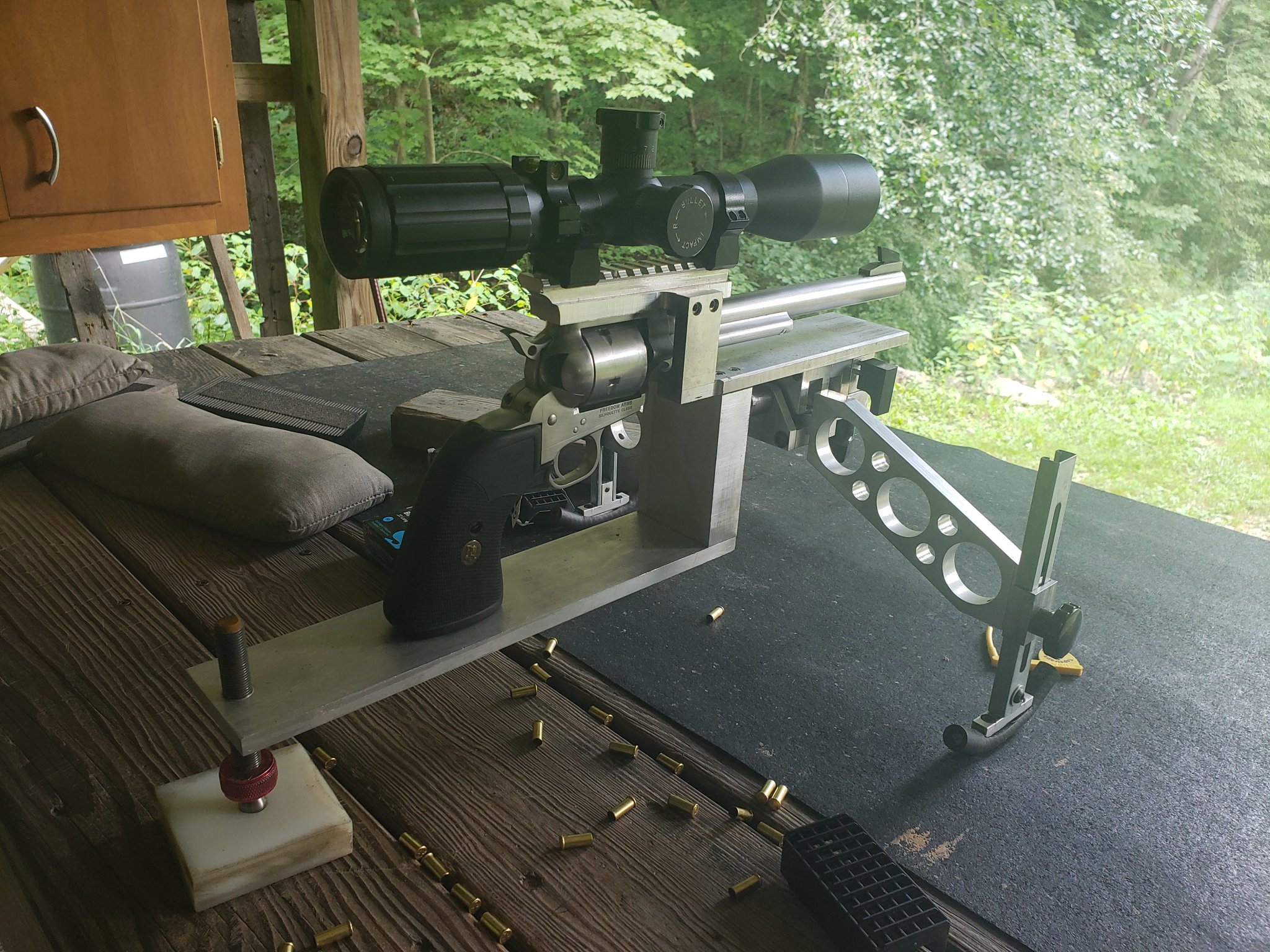

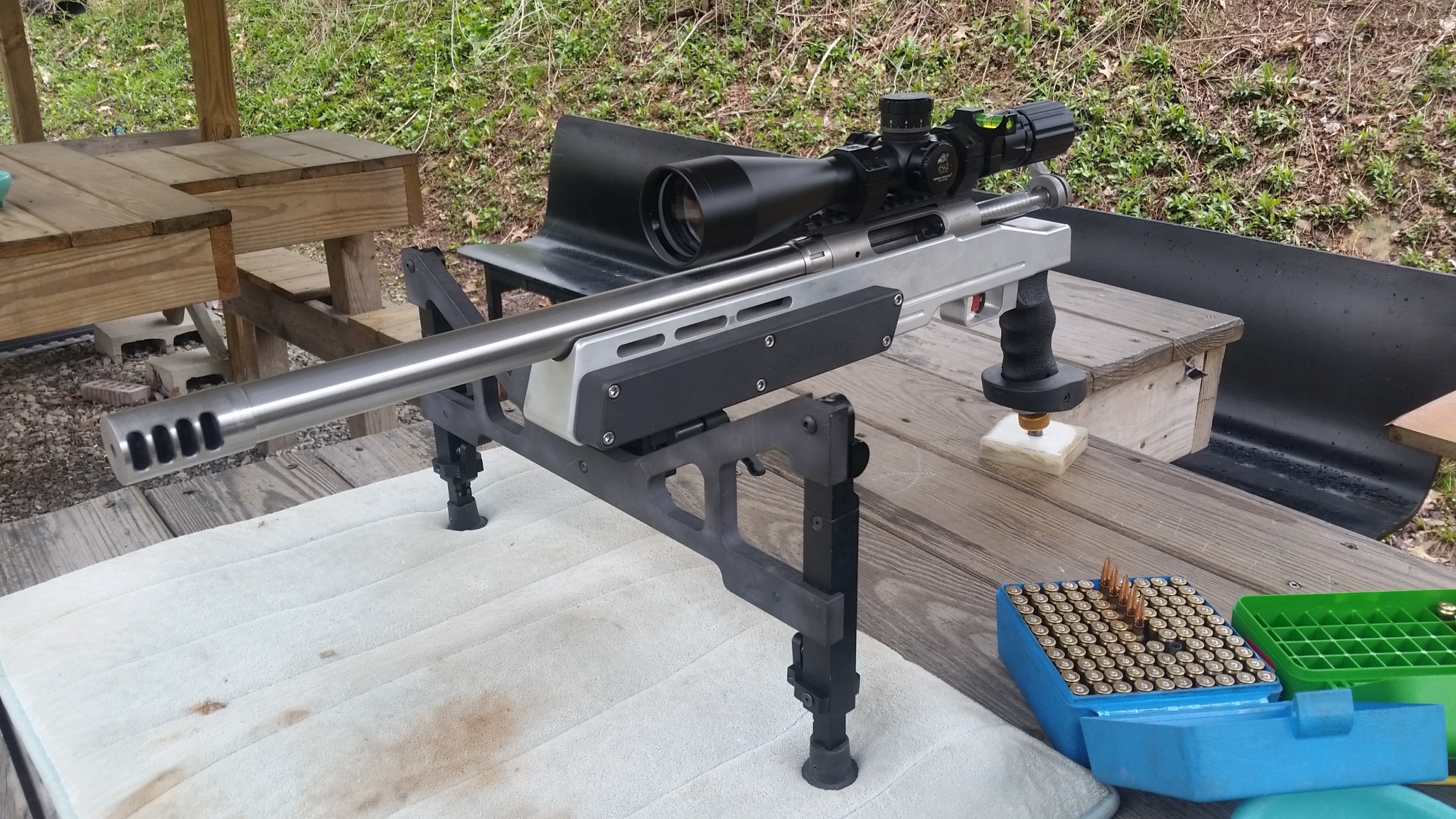

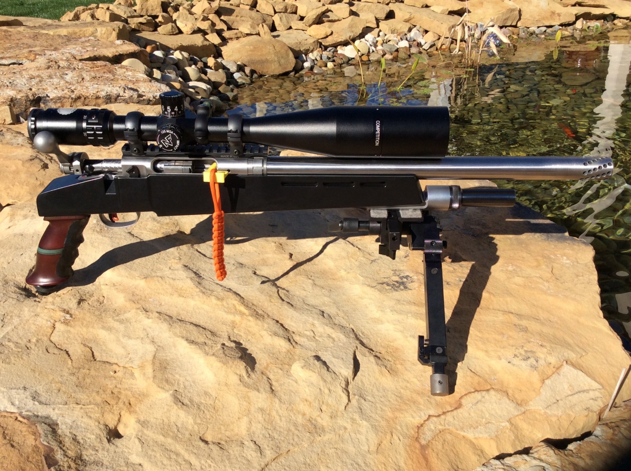

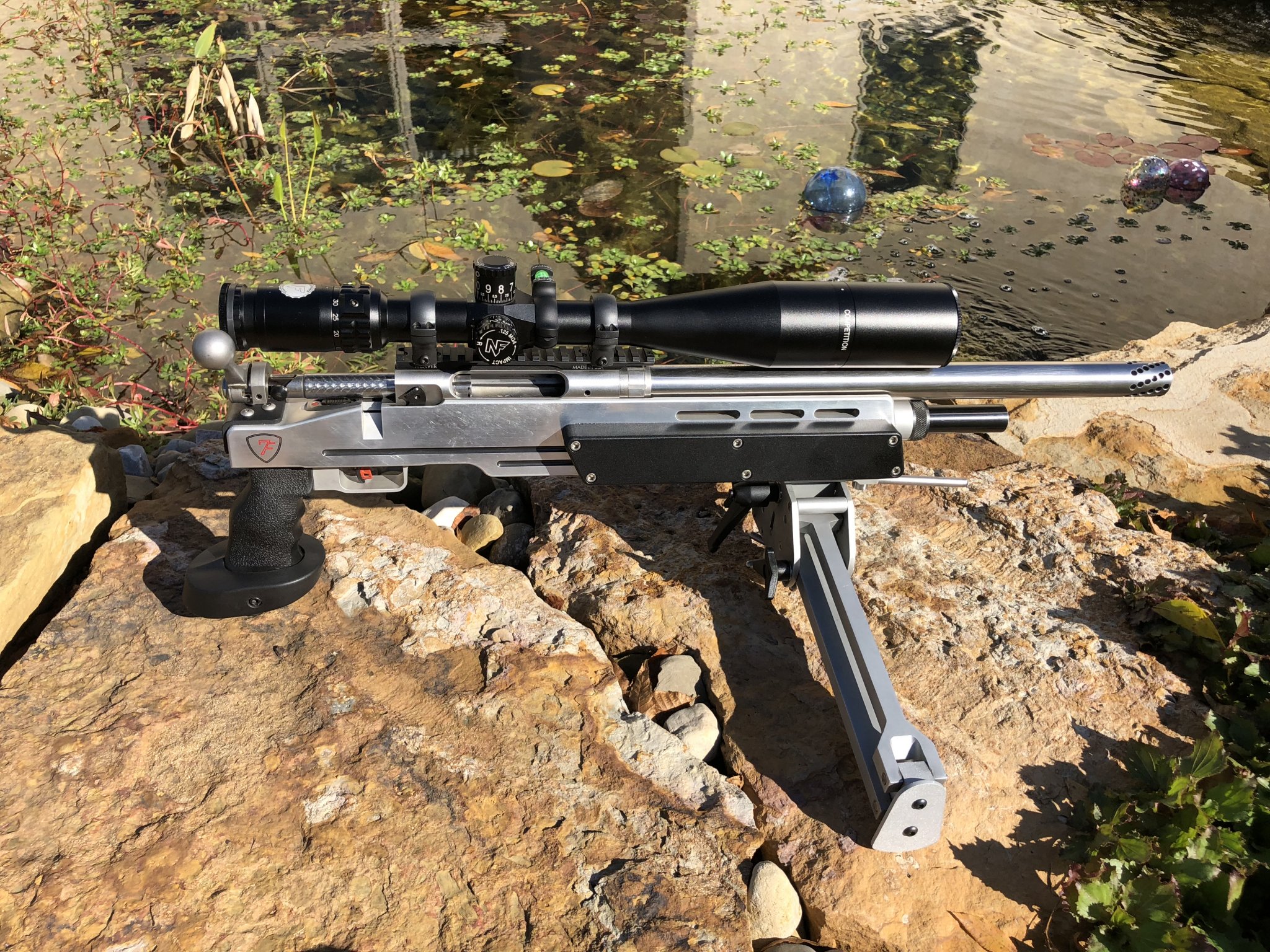

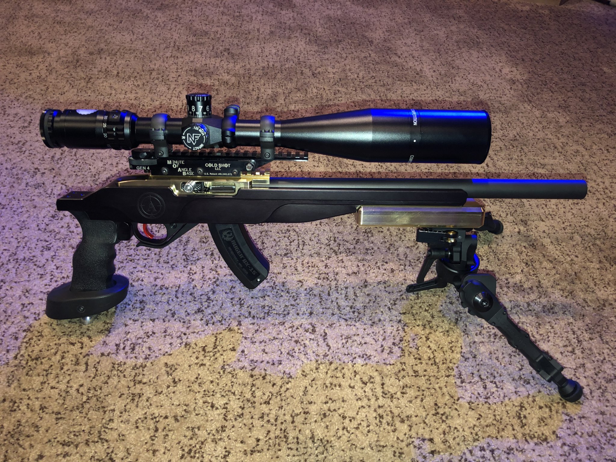

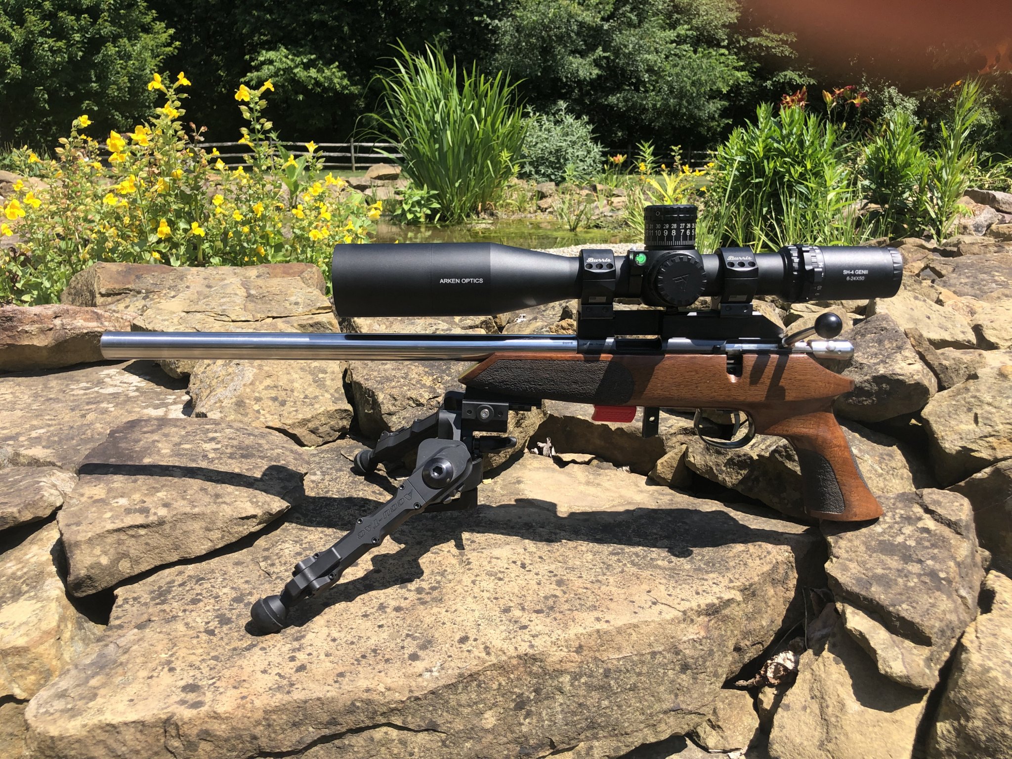

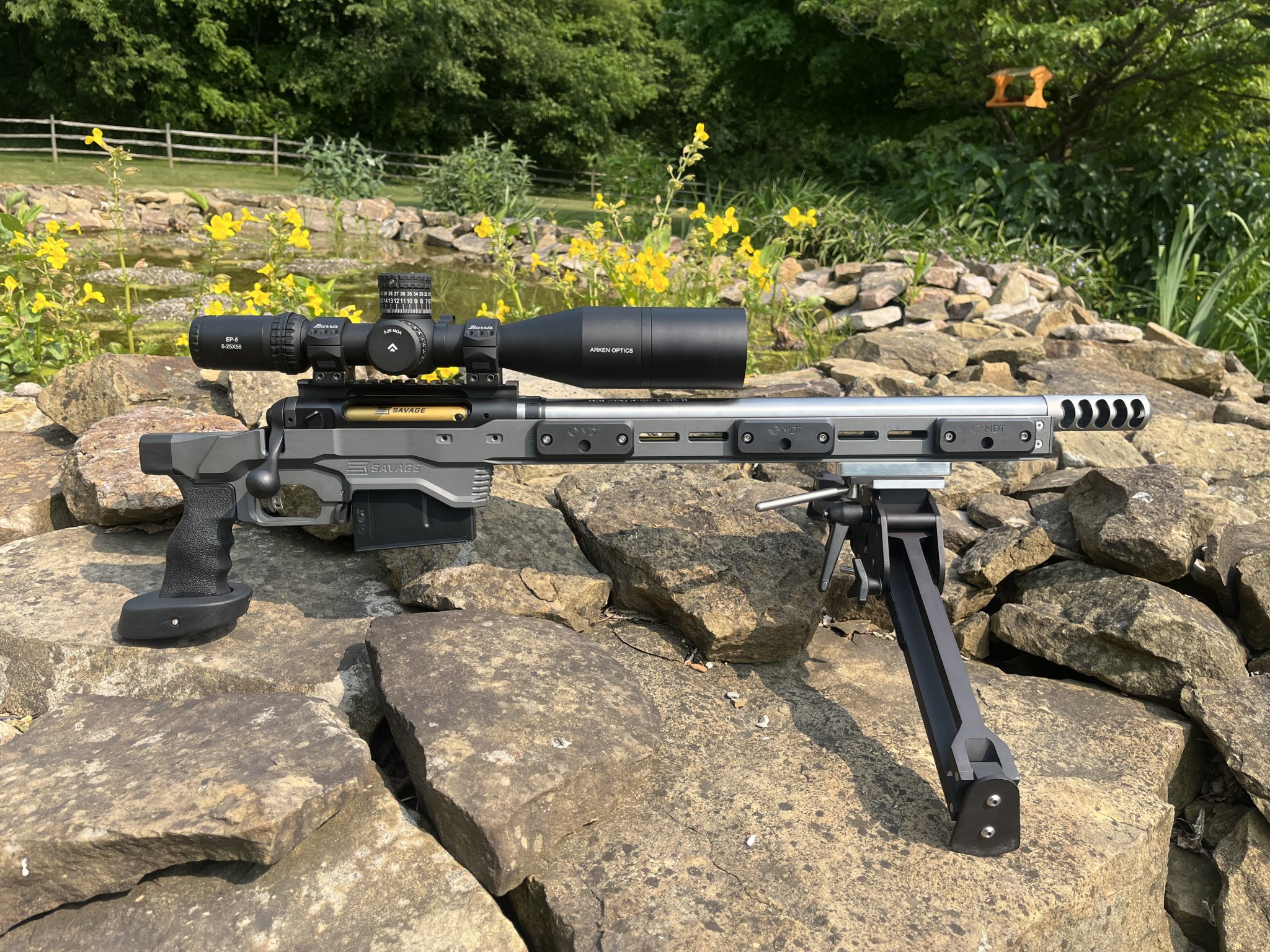

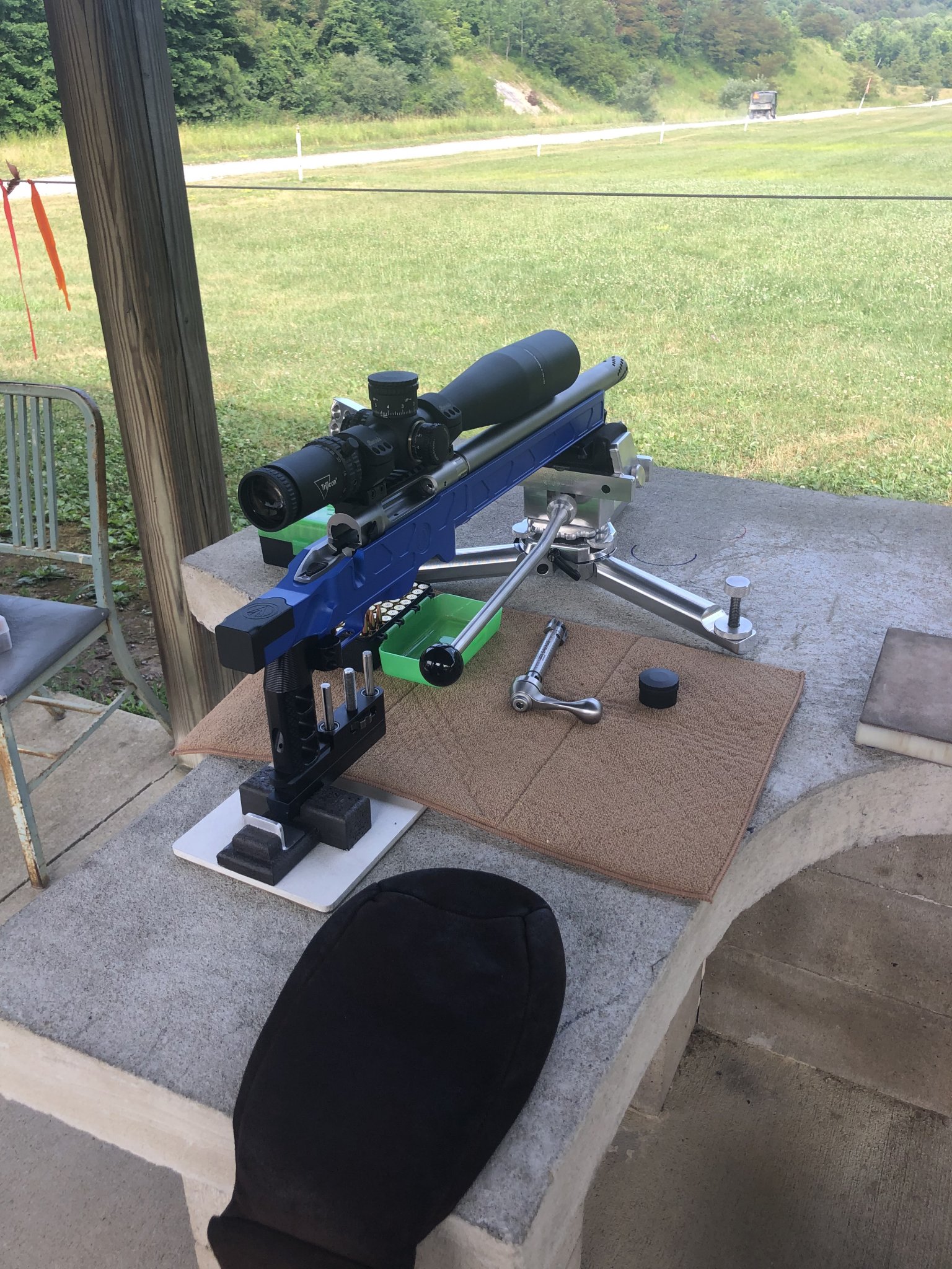

All of my handguns have been built with undesignated actions, a good muzzle brake tames the recoil and makes it tolerable. I use rifle scopes on all of my handguns.
Here are a few of my handguns.
