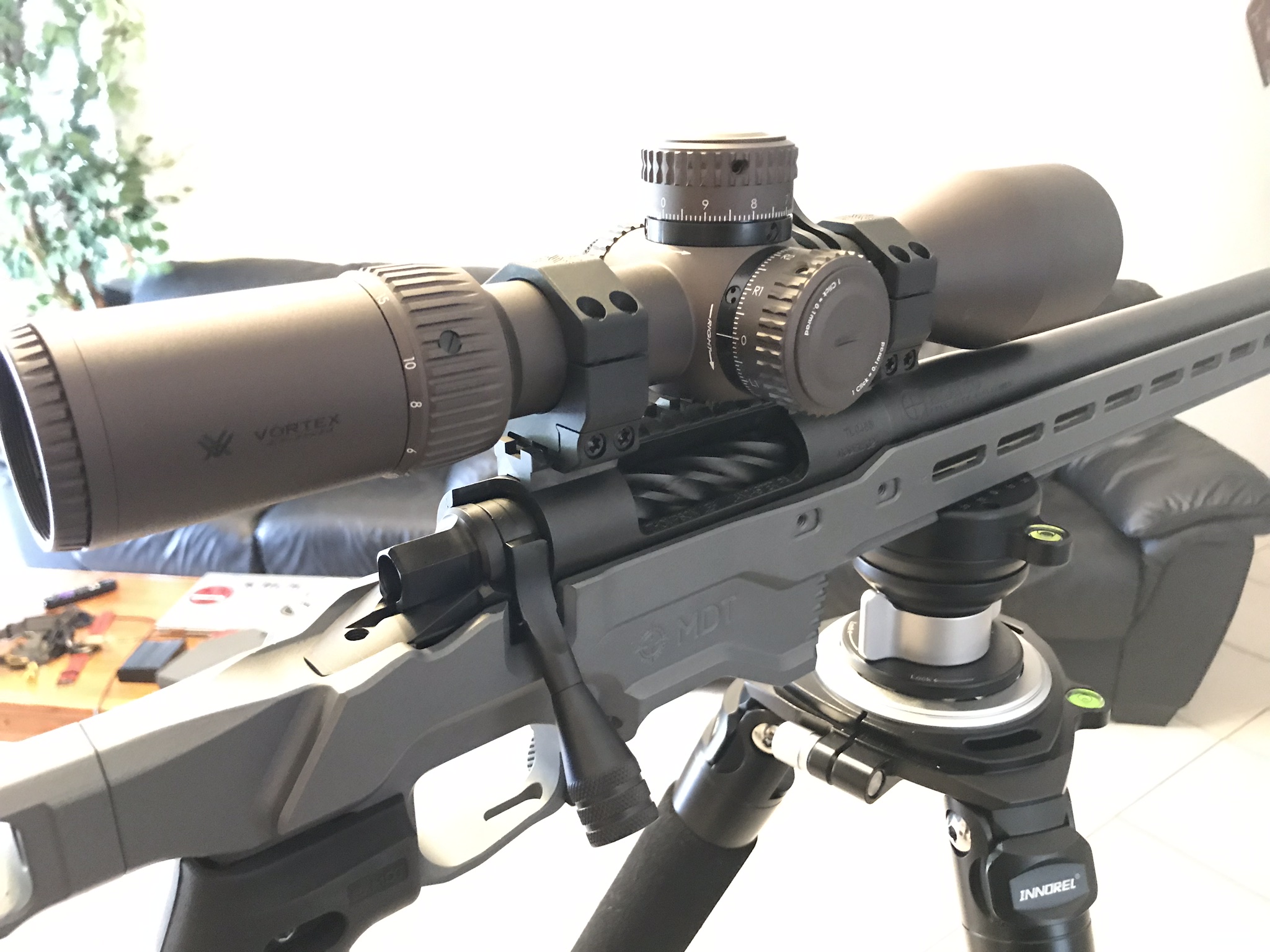

I received mine a few months ago and just matted with a criterion barrel and nut. The action is smooth and I've cycled a bunch of rounds through it with the firing pin removed. Seems to work flawlessly if I run the bolt quickly. Its jammed up a few times when I've run the bolt really slow, but this could be do to my magazine setup.
Still trying to decide on a trigger. Was going to go with a super 700 but it seems people are having problems. Thinking of maybe going with a Bix'n Andy 2 Stage
