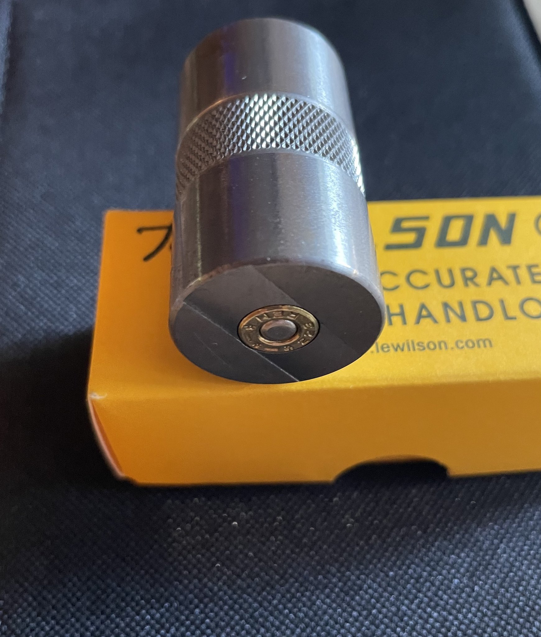

OP, Wilson case gage (their spelling) is your friend. I discovered the hard way (similar to your experience) that my reloaded rounds were out of spec in not one but two different-caliber firearms:
  • I had been reloading 9mm range brass for a long time, and it all functioned flawlessly in my Sig and Glock pistols. Then my son and I bought CZ pistols, and my handloads jammed them both tight. The case webs swell in generously-sized service pistol chambers, and Dillon said standard dies wouldn't resize the case web (this was many years ago).
  • Same thing happened with ARs in 5.56x45. Ammo fed fine in one well-used cheap AR but jammed in a new one built with higher-quality components.
Basically, one drops a loaded round into these Wilson "gages;" if case dimensions/headspace are out of SAAMI spec, you see it instantly. I found the AR reloads were only a few thousandths too fat for the newer rifle, and just running the size die in another fraction of a turn cured the issue. With the 9mm, I just run every loaded round through the "gage" and ones that don't drop all the way in go into a "glock jar" - Glocks will eat anything.
This statement is false for the Wilson gage that you posted a link to. The gage that you linked to is not a "case" gage in the typical sense of the word. That gage is intended to be used for adjusting the sizing die and trim length, not for checking the final overall dimensions of cases.
From LE Wilson's website: "Does not measure body diameters. This gage is intended to be used with fired cases to determine a basis for full length sizing and trimming."
For determining if sized cases meet the SAAMI specs, you need the Wilson minimum chamber gage.
From LE Wilson: "Does not measure body diameters. This gage is intended to be used with fired cases to determine a basis for full length sizing and trimming."

This video might help clear up the differences between the two gauges mentioned:
ETA: The point is somewhat moot, since Wilson doesn't make a min dimension gauge in 224 Valkyrie.

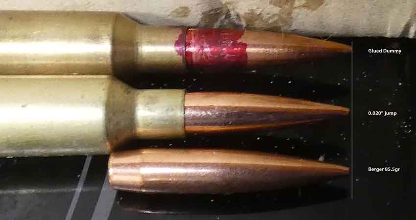

Make a dummy round at the exact same length (measured at the ogive not the tip)and neck tension you are making loaded rounds. Drop it in and see if it falls out. Then put it in a mag and slam the bolt on it and see if it gets stuck. You can color the bullet with sharpie to see if you’re jamming the lands and/or unseating the bullet when the bolt closes. My guess is you’re jamming into the lands.

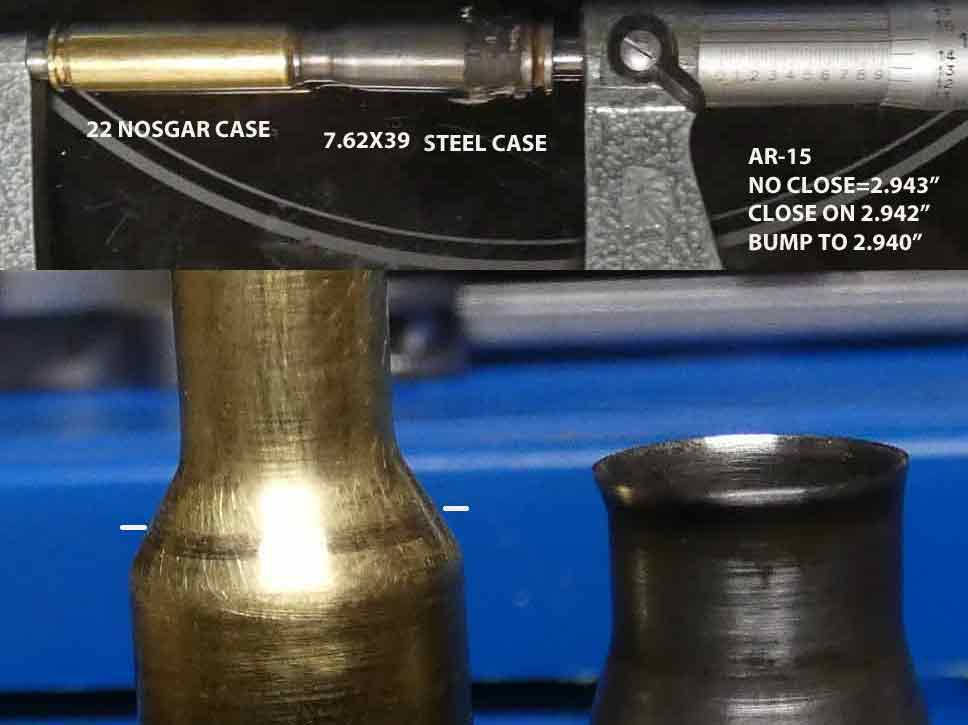

I take fired cases, with the datum to base expanded by firing and won't chamber without force, and bump them until they just barely fit.
I fit check several in the chamber by setting the case into the extractor and feeding the case forward into the chamber (slowly) feeling for a click to lock. Then bump 0.001" to 0.002" more. With a size to stop press, not a cam over type. Lock down the die setting and size.
I use a 7.62x39 case, belled, for .223 size necks (5.56/224V/22Nolser) to measure as fired and as sized cases (even fits over bullets).
I have made OAL dummies, Zero jump for the bullets I load (85.5, 88, and 95). Loose neck tension, Epoxy on the inside of the neck, chambered for jam, allowed to cure muzzle down. I load for desired jump based on these.

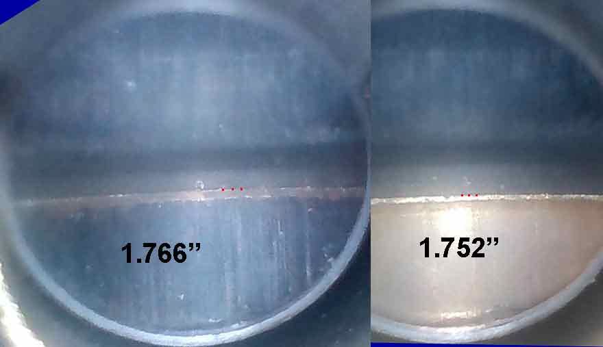

I know where my chamber neck is with a borescope.

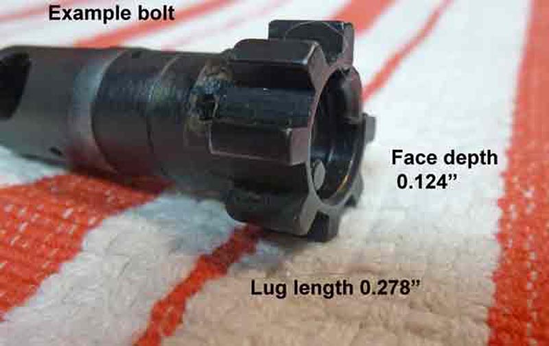

I know the headspace determining dimensions of the bolts I use.
Even after all this, I don't know what my actual chamber length is. That would take a Go gage and shims. My datum to base measurement is arbitrary based on a nice fitting X39 case.
I know my bolts are in spec in case I need to swap in another. I assume the headspace of new factory 22 Nosler rounds are about 0.004" (datum to base) short as well as case length. The NOSGAR rounds are 6mm HAGAR cases bumped to the chamber.
I'm setting my reloaded cases to the actual chamber dimension with about 0.002" headspace. They fit and eject.
This would be my next step as well. Coloring the bullet with a sharpie is going to tell you if it’s hitting the lands and if it’s getting pushed back into the case.

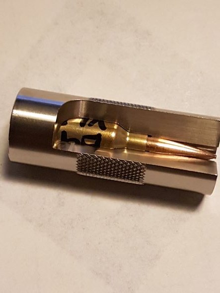

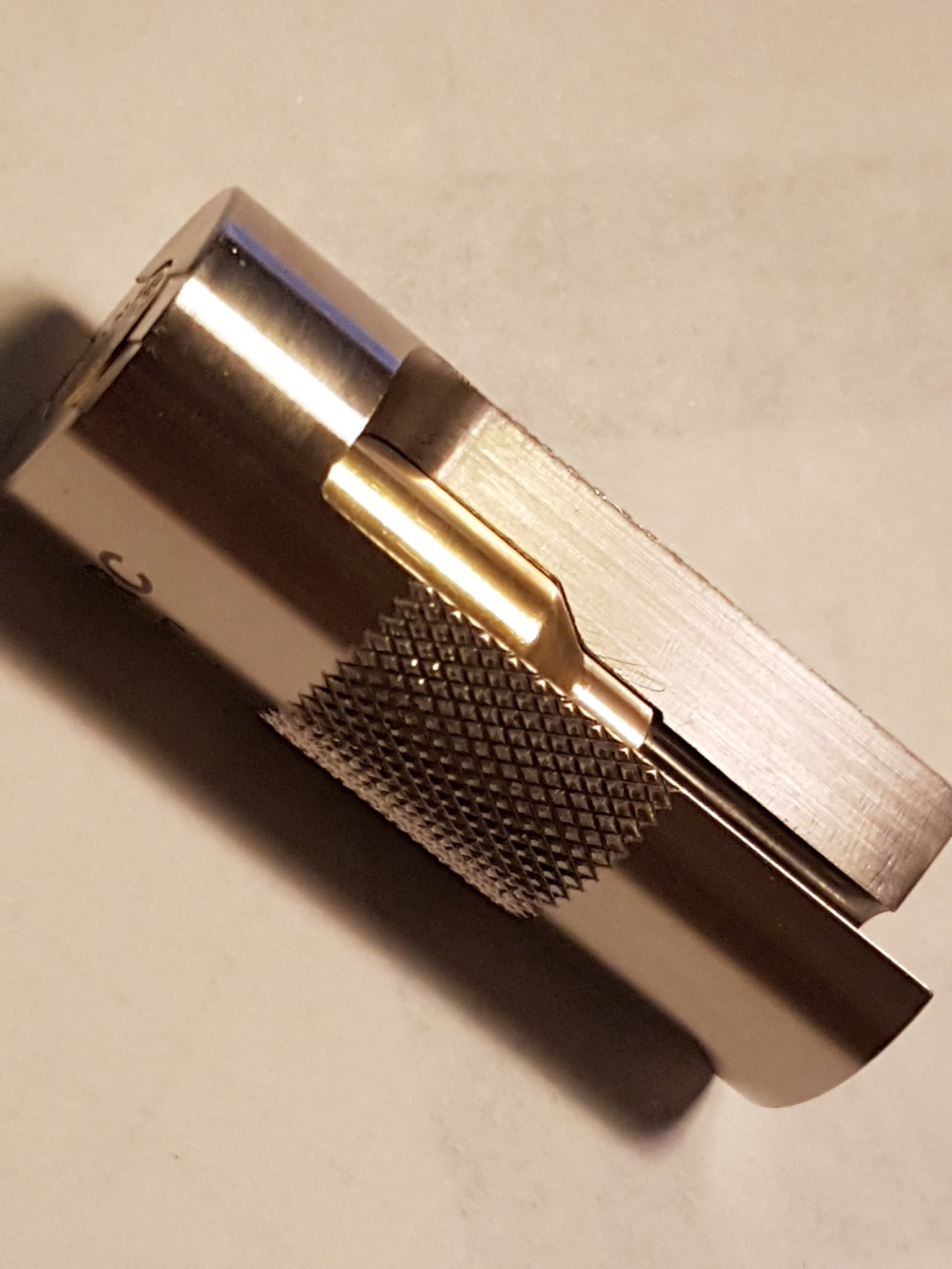

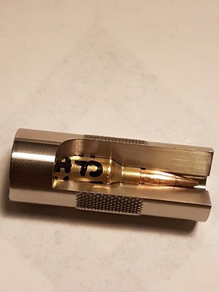

....if you're going to start investing in reloading tools, you may want to check out Sheridan's slotted gauges. At a glance you can see if it's a shoulder bump, case web sizing or bullet seating issue. All three of those individually can cause the problems you encountered, more so if more than 1 of those conditions exist compounding the issue.
Reactions: mtrmn
The Sheridan slotted gauge looks interesting.
But, $75 including tax and shipping.
"machined to the SAAMI minimum chamber spec"
...the gauges are cut with a chamber reamer, yes, to SAAMI minimum. If your loaded round fits in the gauge (and drops out), it will fit in (and drop out of) ANY chamber that is SAAMI spec'ed. The utility of the slotted gauge is multiple in that it can tell you if your sizing die is set up properly to resize the case web sufficiently, if the shoulder bump is sufficient, if the case trim length is appropriate, if the bullet seating depth is appropriate due it's ogive shape/type (secant -vs- tangent), all in a single glance. Tangent bullets ogives are "blunter", for lack of a better word, than secant ogives, and contact the leade/lands "sooner" than a secant bullet does for the same COAL measurement. Their pricing is in line with the great majority of gauges on the market.
...it's just a suggestion for a tool that will save you invaluable time, and conversely, components.
Edited: And yes, I do use them....for .308Win, .223/556, 300BLK, 6.5 CM, 6 ARC, & .45 ACP ;)(y) added a couple pix of my 6ARC gauge when converting 6.5 Grendel cases to 6ARC. The pix show 2 Berger 95 grain bullets, a "tangent" and "Secant", the 95 Classic Hunter & 95 VLD Hunter, note the differences in the COAL between the 2. The other pix is my converted case showing the shoulder bump and trim length are within spec.

One problem with the OP's issue is the range of as fired length measurements and how much bump is needed to get cases to fit.
With really long case length results, the 10.5" AR, suppressed may be distorting cases like
excessive length, blown out case (@ the 0.200" location).

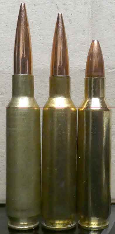

I'm loading for a new barrel for the wife, minimum gas 22 NOSGAR, and a no gas 22 Nosler for me.
Have two sizing dies I set separately to match chamber and desired headspace.
She is now learning some of the reloading steps and chamber checks her own ammo.
22N for my old barrel, 22N for the new barrel (both sized for about 0.002" head space), 22N Factory round about 0.005" headspace).
I check each chamber for neck length with a borescope. I trim stretched cases to less than 1.765". Factory cases are about 1.755"
