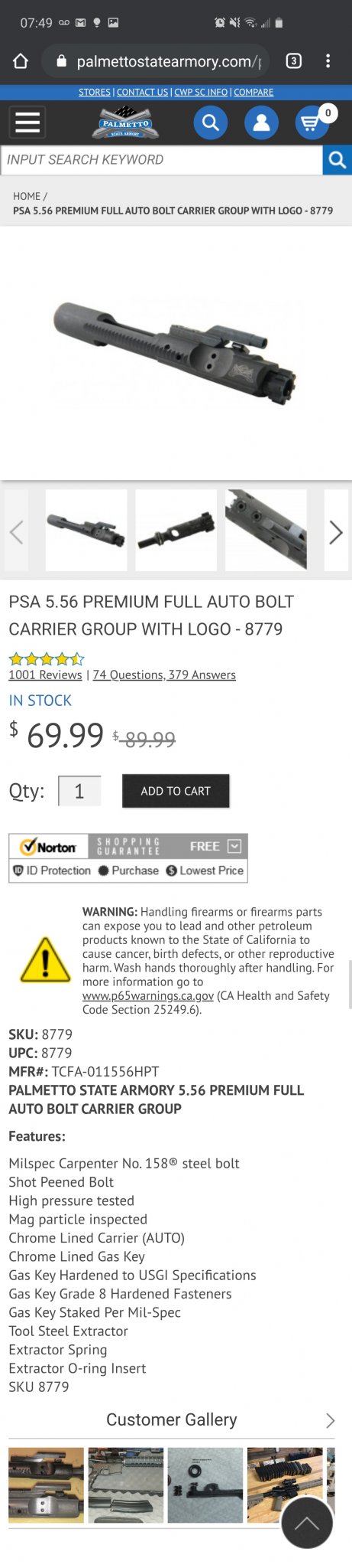

Checked out the PSA / Toolcraft NiB BCG and the specs say that the bolt is shot peened and MPI but doesn't mention HPT. Are they actually HPT or does Toolcraft skip that step?
I went to their website and it only states MPI
Edit: I looked at BCM BCGs and some others over at primary arms, they all state MPI. However, non off the ones I looked at had HPT. Does the military not require the high pressure test for bolt carriers?

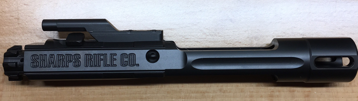

2. Sharps Rifle Company XPB BCG purchased directly from Sharps (currently on sale for $169.00 + 15% off)
  • Cost wise, these have a lot of features for the $
  • DLC coating, I think Sharps was the first to offer this on a BCG
  • Beveled bolt lugs. I have no proof, but it seems logical to me that this profile would have no down side & likely to run better/longer under extreme conditions.
  • Bolt, carrier, ejector, & extractor pin are S7 tool steel. These S-7 parts under go a 24 hour thermal cycle heat treat before DLC. FYI...S-7 tool steel is not only stronger, it's an ideal base metal for DLC.
  • Gas key is attached with quality grade 8 fasteners and correctly staked.
  • Bearing surface is increased. See pictures below. The bearing area adjacent to the gas key has been widened.
  • Tail section is slightly enlarged to better center in the buffer tube (less rock)
  • I have head spaced 2 of these 1 x 223 Wylde & 1 x 300 BO both were on the money
  • Gas ring is mil spec and friction is also in spec with the DLC bore. The test for this is to stand the assembled BCG on the bolt face while it is extended and the weight of the carrier should not push it in.
  • I gauged one of these thoroughly. One area is not mil spec. It is the bolt tail hole at the back of the carrier body, it's oversize from mil spec by .002-.003. FWIW - I saw a JP BCG fully guage inspected and it was loose in this same spot. Probably intentional by Sharps & JP considering how precise everything else was, but they do not provide rational. I suspected the only negative is a little more gas leakage out the back, therefor these BCG's are a little less gas efficient. This is not a bearing surface but if a close fit (mil spec), and it carbons up it could cause issues.
  • I've since watched a video review (on Sharps home page) where they describe a little extra gas in their face on short barreled suppressed. The oversize bolt tail hole no doubt. The other interesting side affect was when they took an over gassed 5.56 (launching brass @1-2 o'clock) and then screwed a can on. I figured it would over ride the mag, but instead the brass ejection actually came back around to 2-3 o'clock. Maybe the oversize hole is acting as a pressure release when suppressed.
I have 2 of these running and a 3rd build in the works. I think they are one of the best values in BCG out there right now.
  • Sharps XPB Low mass in a 223 Wylde 16" mid gas non adjustable gas block with VLTOR A5 buffer (Std. weight). I'm right at 1000 rounds in this so far and it has not malfunctioned once. It is a little over gassed, but shoots so well I haven't bothered to put an adjustable block on it. A couple times I've been at the range and someones AR wouldn't cycle well (shitty ammo suspected), so they handed me a mag with there crap steel Tull and some other crappy stuff to try. It's eaten everything tried so far. I recently used it for a 200 round unconventional shooting position combat carbine class. Most of the drills started laying down, on your back, side etc. It was fucking raining cats and dogs and I have an obnoxious 3 port Coda break that was blowing mud and grass everywhere (lesson learned). Gun was filthy, but ran flawless.
  • Sharps XPB std. weight in a 300 BO, 9" barrel, pistol length gas, Maxim CQB brace with JP silent capture heavy buffer, and adjustable GB. I have the gas wide open and probably need to lighten the buffer weight to get in the adjustment range of the GB. It has almost no recoil. So far I only have about 150 rounds through it with Winchester white box 125 grain & reloads with 125 grain SST's.

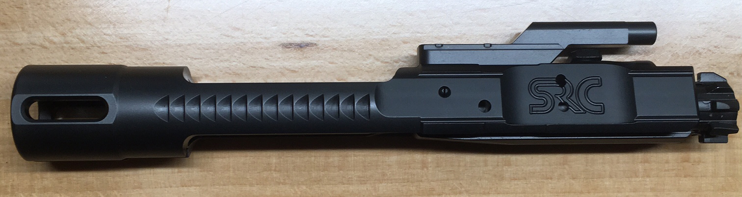

Pictures of Std weight Sharps XPB/DLC BCG
