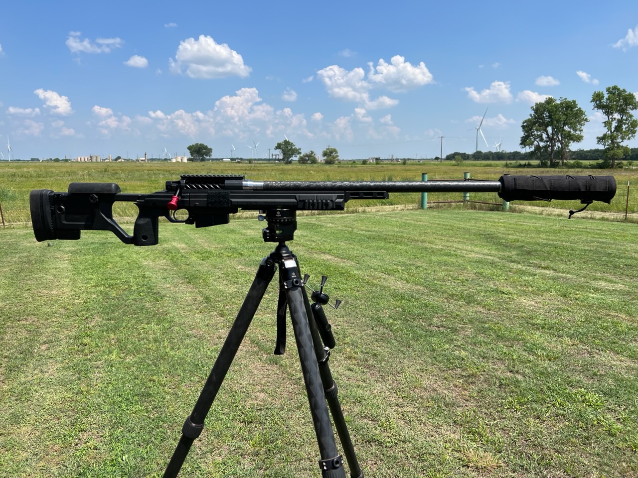

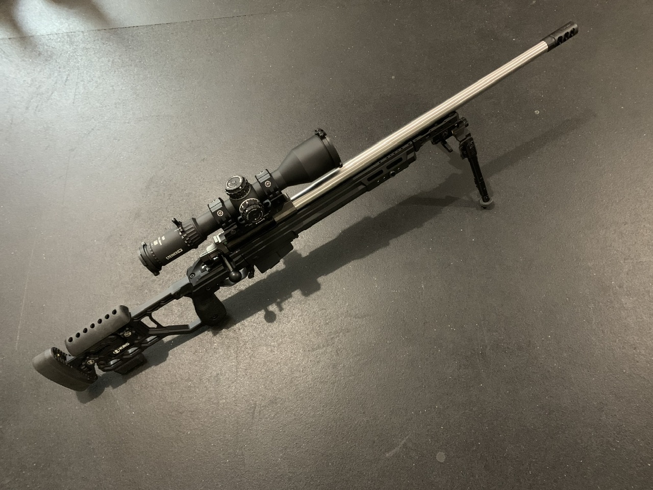

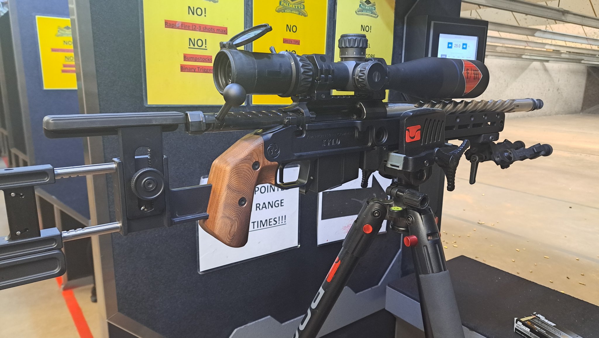

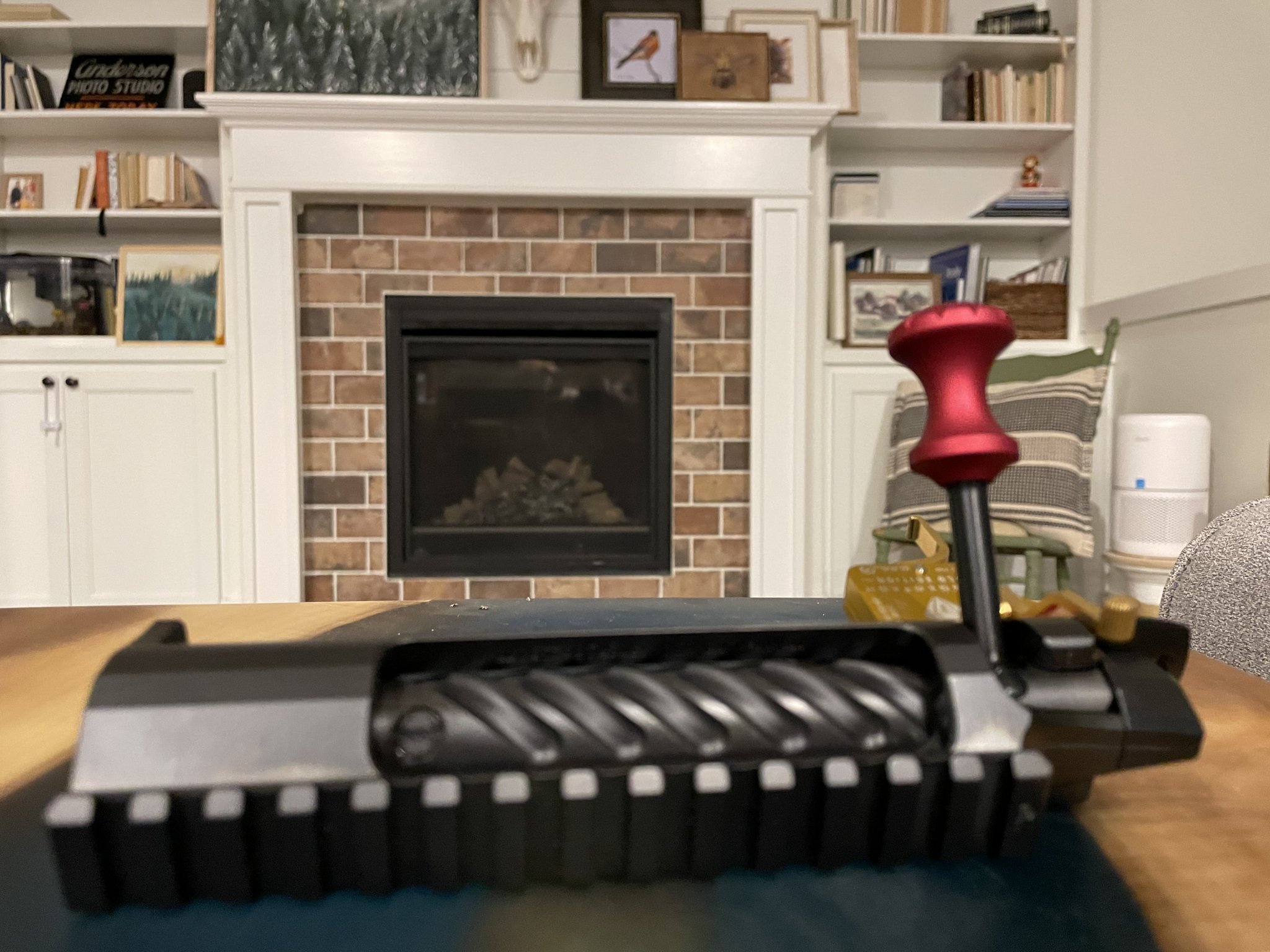

Here it is, ready to take its first shots.

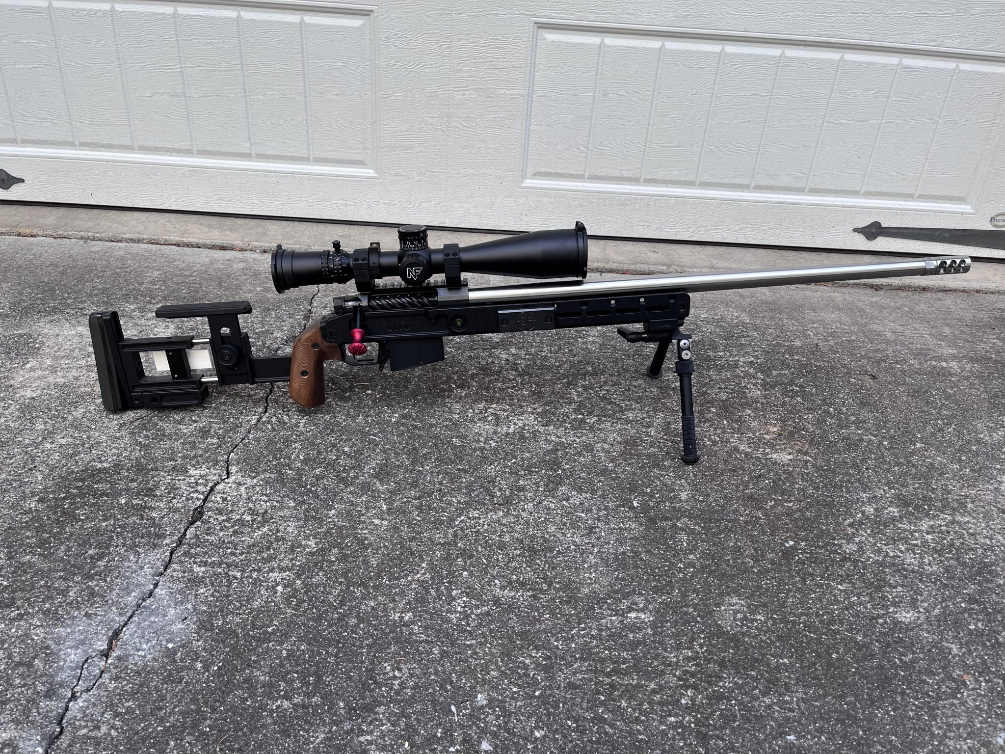

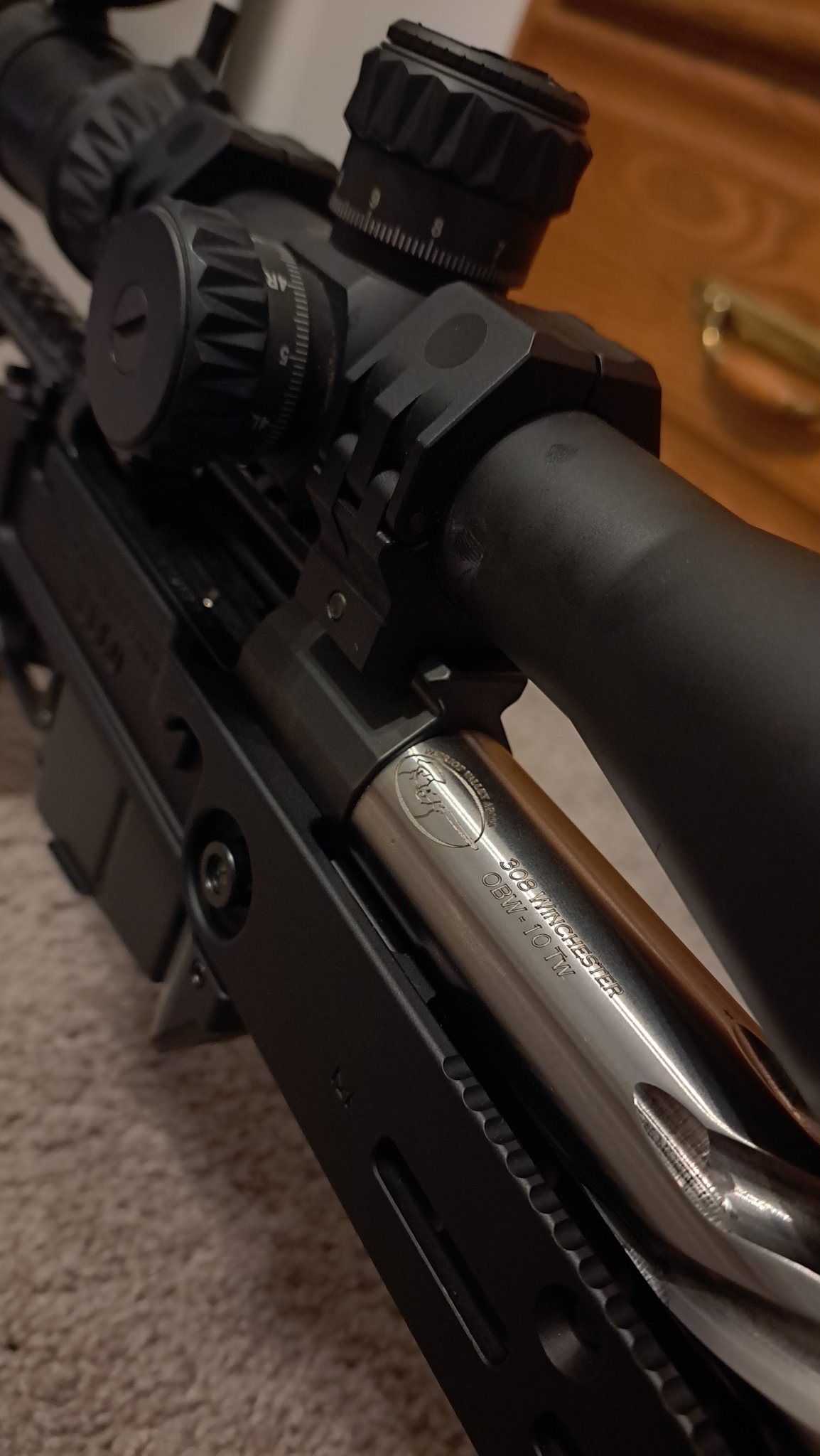

Is the 1.26" M-Brace a good fit for a 56mm objective with the Xylo chassis?
You can use the Medium 1.10 and have a 1/4" of space between the objective with scope cap and bull barrel. I have mediums on a 60mm objective bull barrel and 1/8" of space with scope cap. I have lows on 50mm obj with scope caps and 1/4" space.
I am currently using the Low (0.98") height and it fits a 56mm scope with a proof competition contour barrel. It's pretty close but it isn't touching.

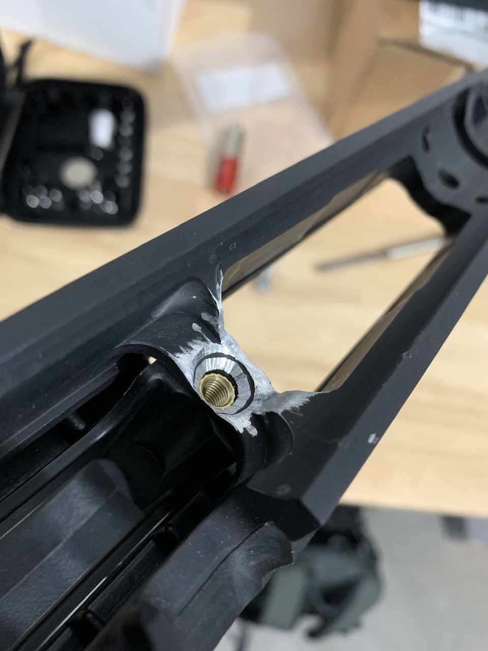

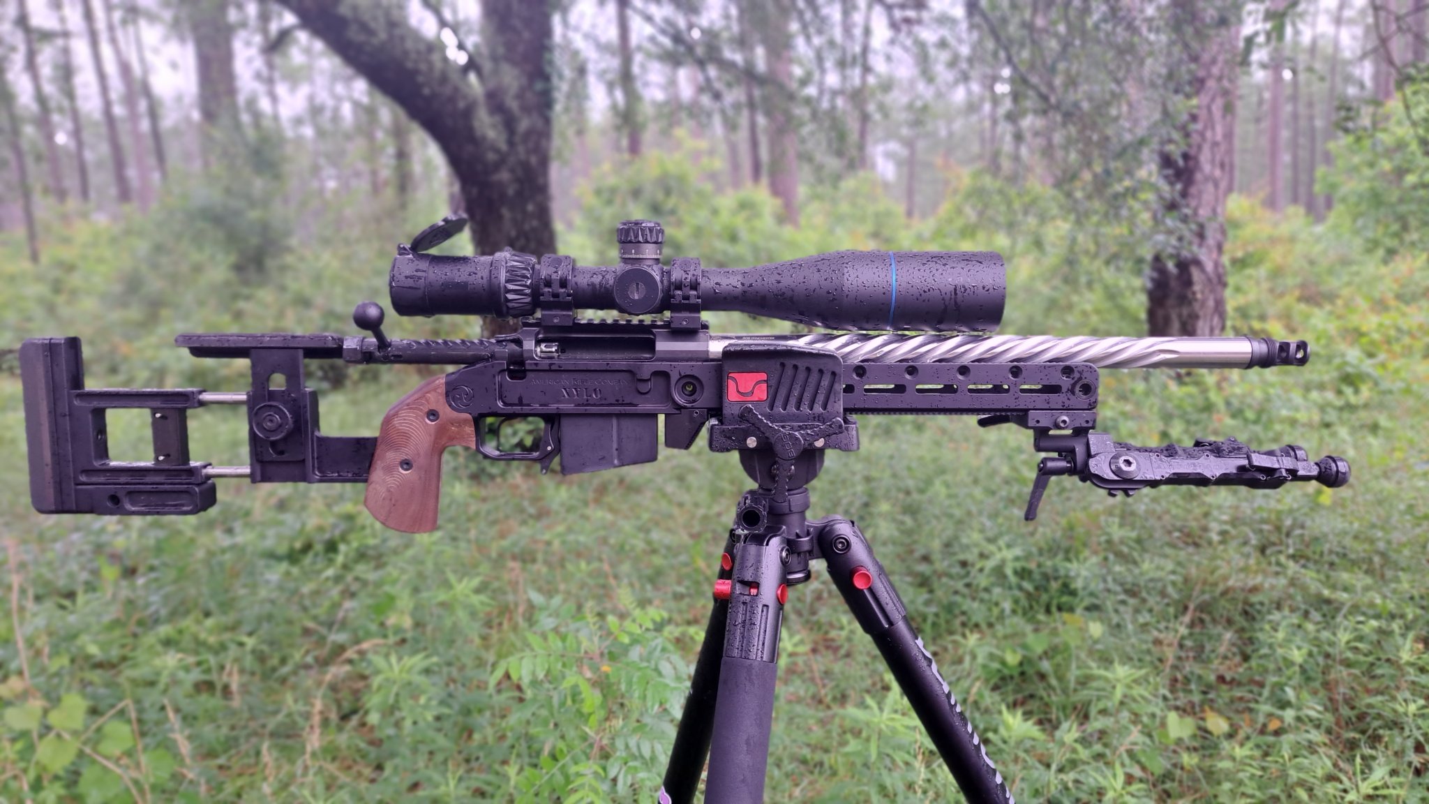

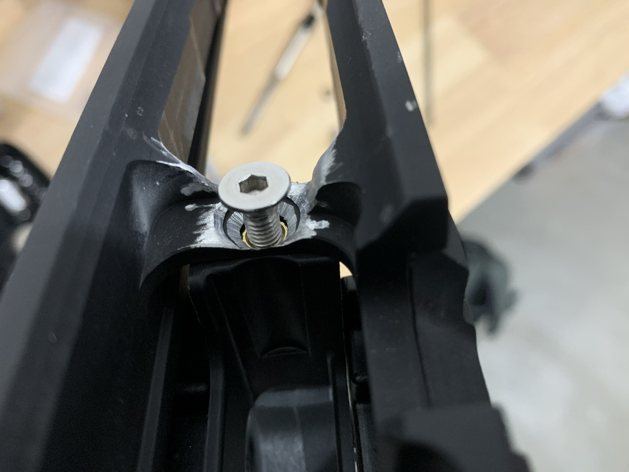

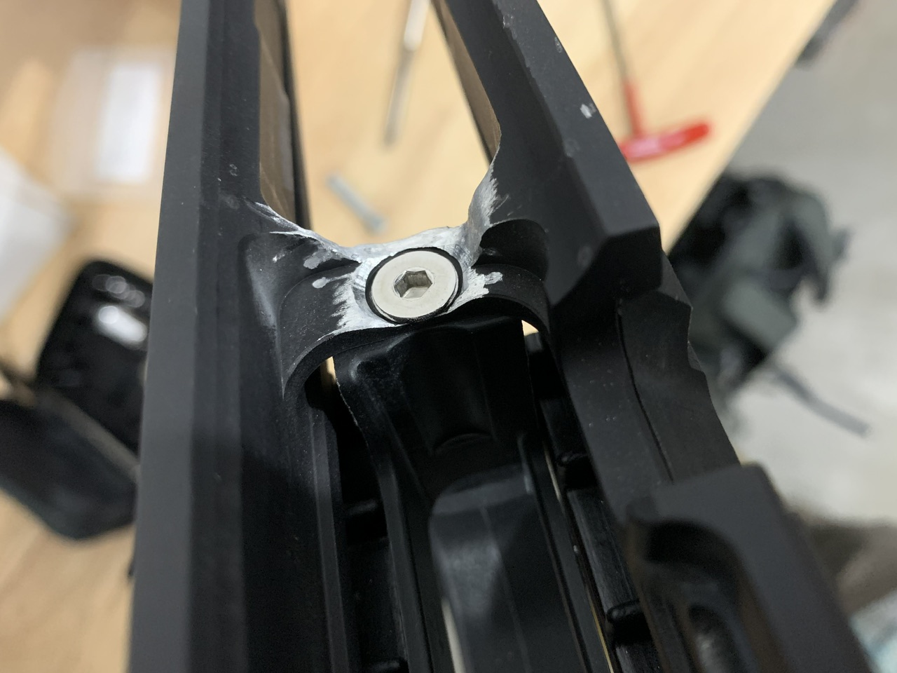

Ok, here’s the CDG + KRG build guide:
1) set up your trigger hanger and trigger as per Ted’s how-to video.
2) grind down the protruding front set screw of the trigger hanger until it is flush with the hanger itself. Set aside.
3) fire up your 7-axis Dremel mill and remove material in the chassis backbone to provide clearance for the forward end of the trigger hanger.

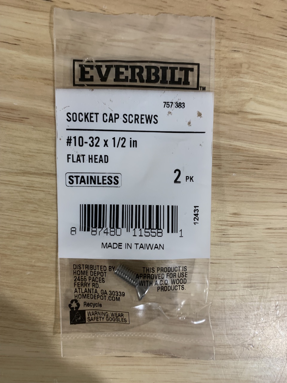

4) remove the trigger guard retaining screw, countersink the hole (lower the trigger guard so as not to fowl the brass threads), and replace with flat head screw.
5) verify fit of barreled action, torque action screws to spec, and rock on.
Build specs:
CDG, round knob, non-fluted bolt
PVA 6.5 CM 1-7.5 22” M24
PVA Jet Blast brake
KRG Whiskey3
AIAW mags
Steiner T6xi 3-18x56 MSR2
ARC MBrace 1.5” mount

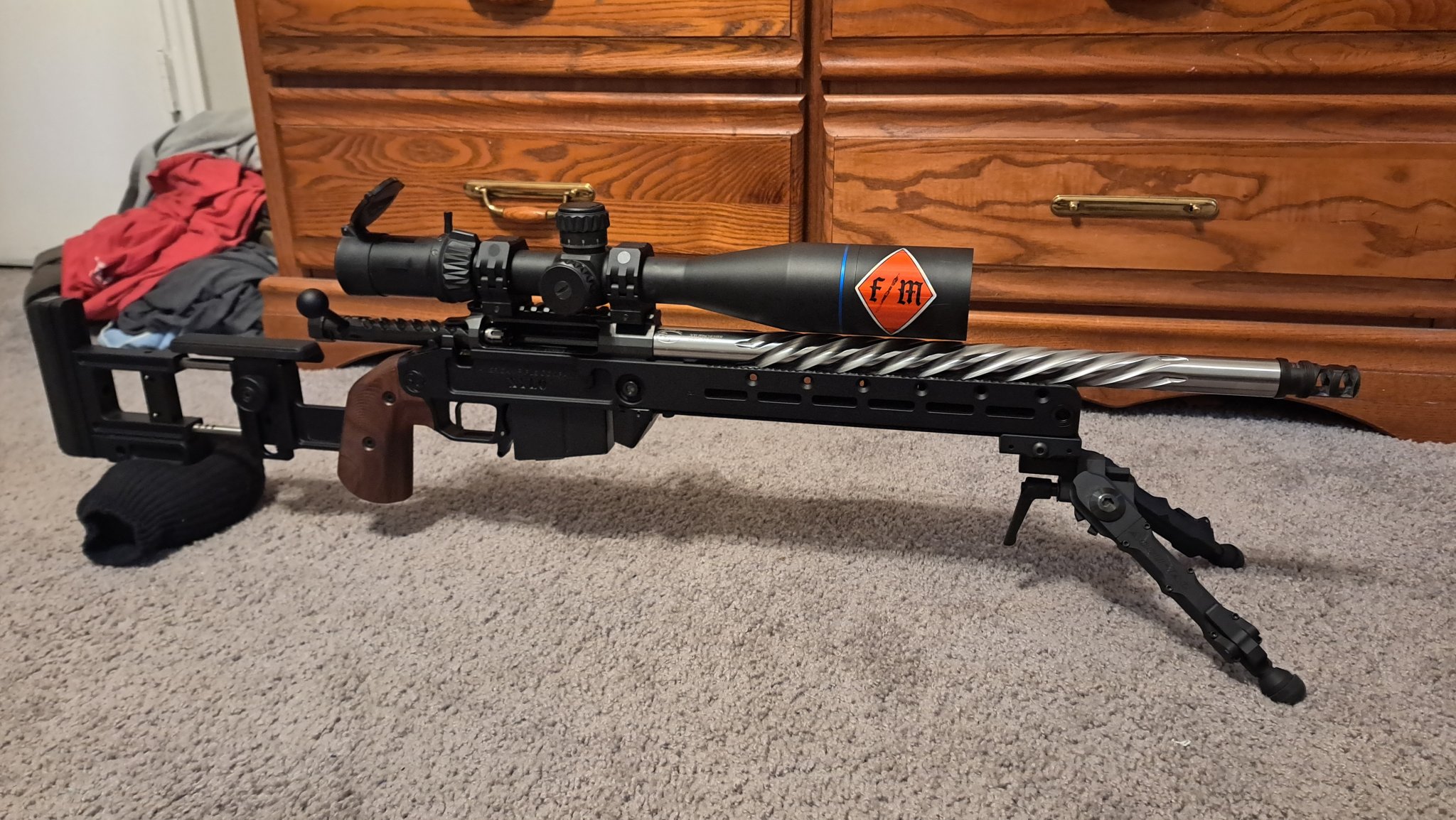

I’m ordering parts while waiting for my CDG LA to get here. Has anyone put a CDG in a KRG Bravo or MDT Oryx? Anyone see any issues with either of these?
I haven’t put one in a KRG, but others have talked about having to do some adjustments to accommodate the trigger hanger and the post right above your post said he had to do mods to his chassis. Also hit up @alpine_troop as well as he looks like he had to do mods to his as well…. I’m pretty sure it’s going to be the same across all KRG lines

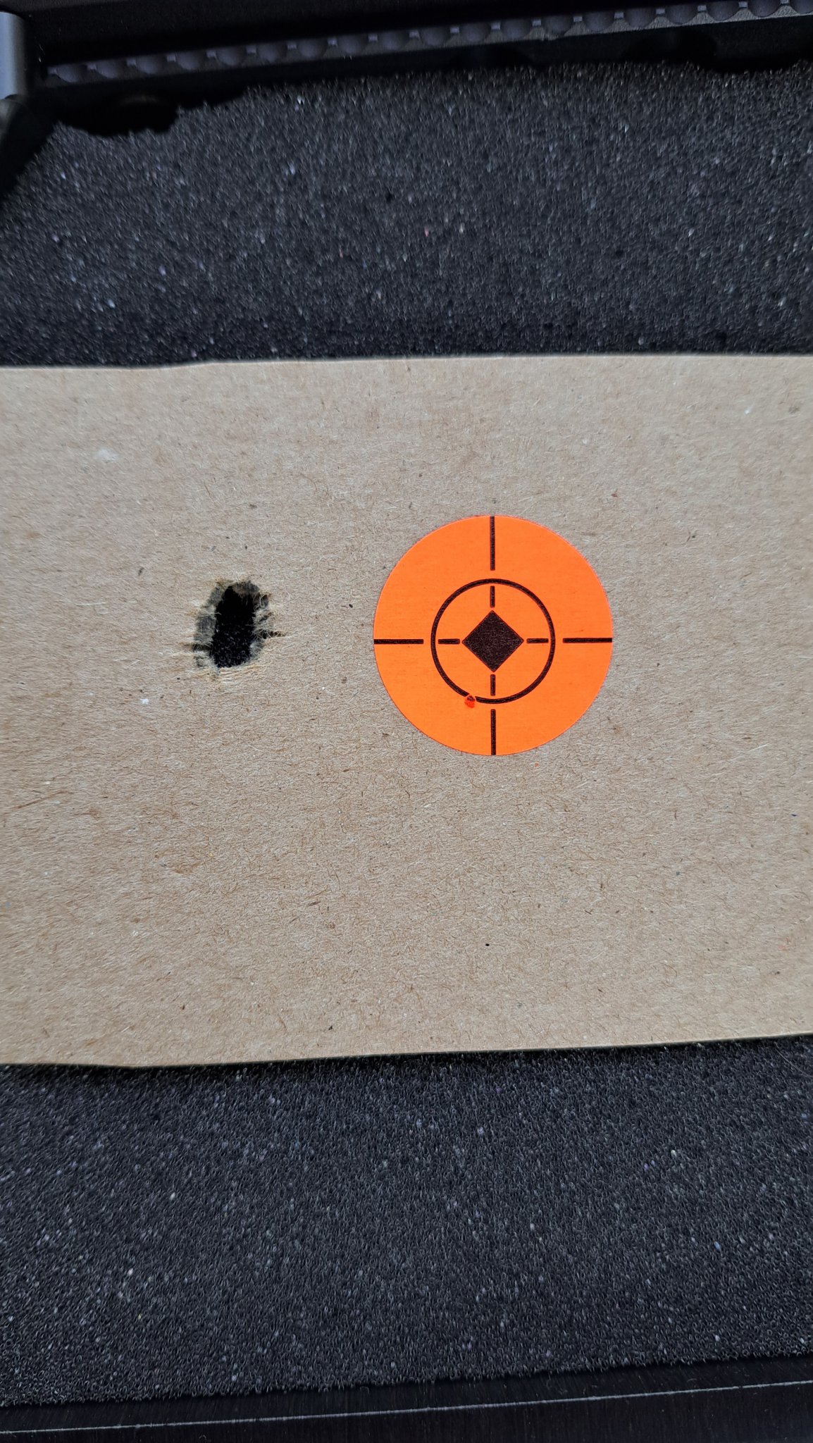

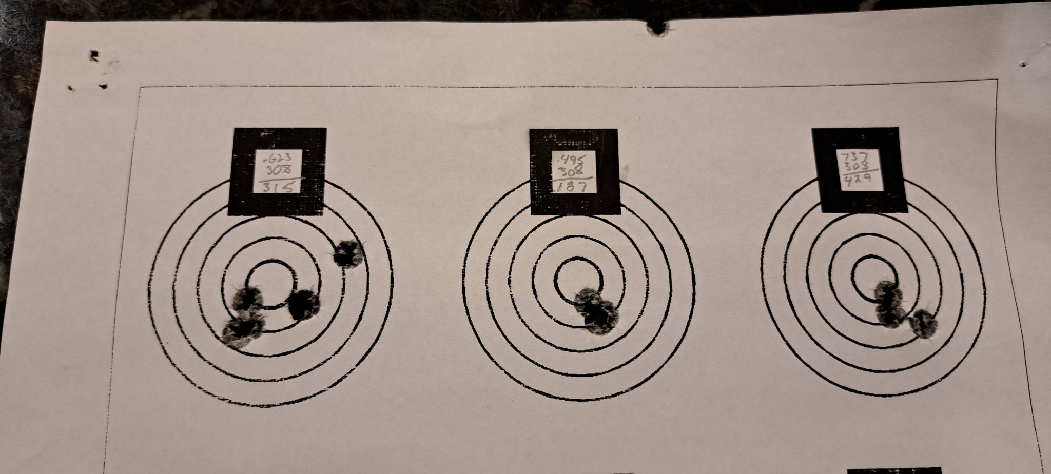

Took my CDG out to 100yards this past weekend. Stuck a 1/2" target sticker on some card stock. Very impressive group with factory ammo.
3 rounds of 168gr Sig Elite Marksman 308. Group size measured 0.372".
I am absolutely over the moon with this rifle.
Sadly I had my scope dialed for wind for a range day 2 weeks ago.
View attachment 8161997Took my CDG out to 100yards this past weekend. Stuck a 1/2" target sticker on some card stock. Very impressive group with factory ammo.
I’m bad about that, not resetting everything to zero when I’m done. My bad habit. 🤷🏻‍♂️

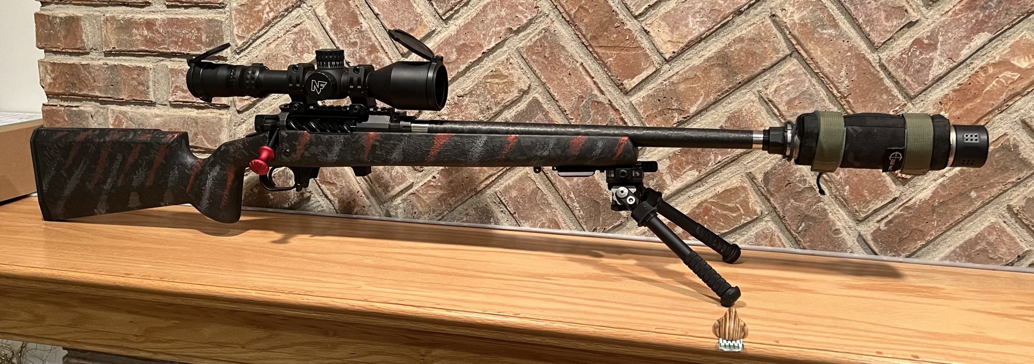

It should, probably only needs 1/8” or a 1/4” removed to completely clear it. That stock currently has an Archimedes bolted on to it but I wanted to see how the bloodshot forged pattern jived with the red bolt knob on the CDG.
