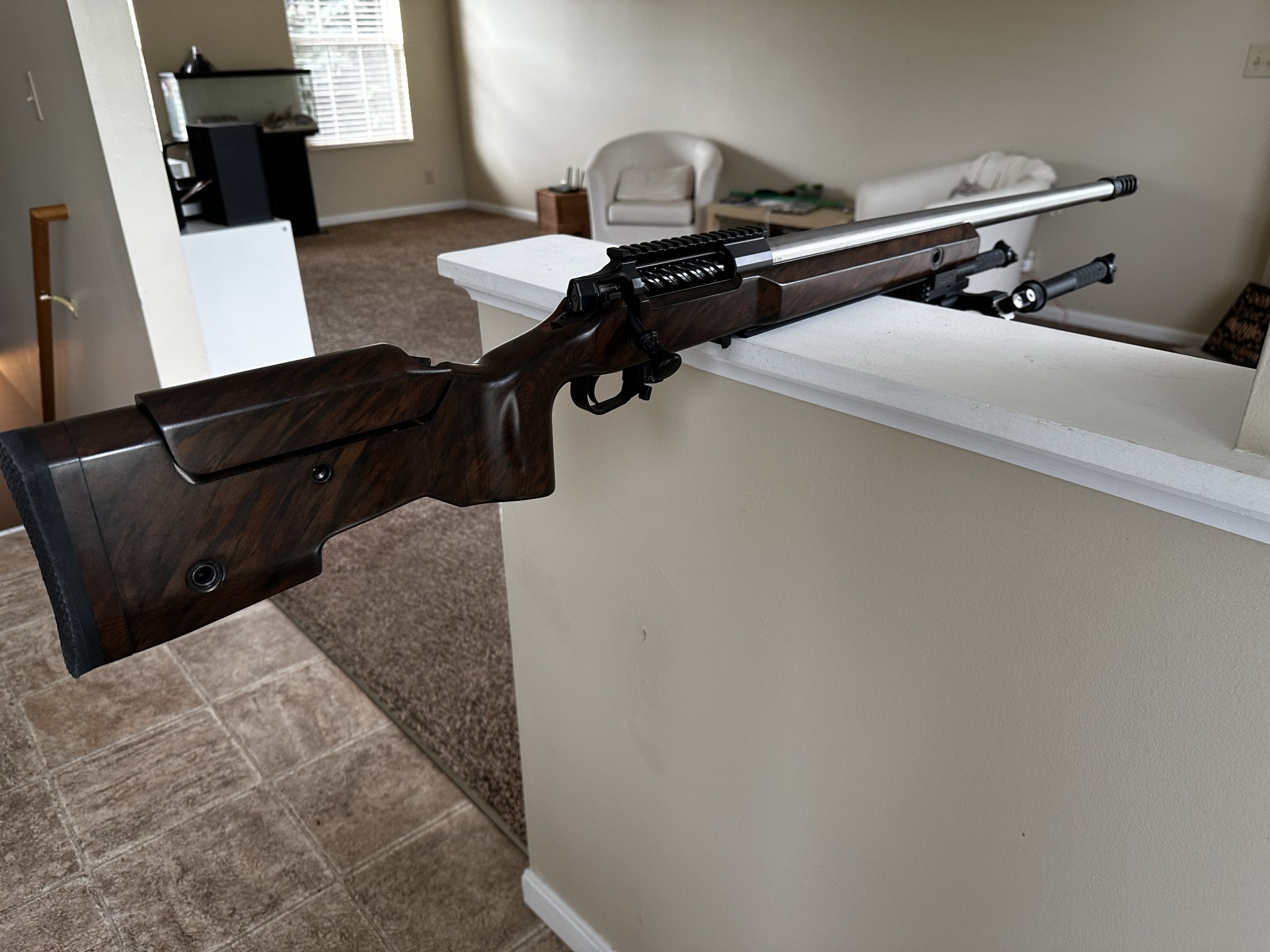

If you plan to run nothing but heavies, shoot in the winter at low elevation, I'd run the 7tw, and go 28", the velocity nodes for accuracy in my 28" barrels have been the same as my friends' 26" pipes, I just run it at lower psi, I like 28". As a reference, my lady also shoots a 6gt, 26" 7tw hawkhill marksman contour 237 bore. It shoots the best with 107smk at 2910-2920, also very well down around 2830.I'm at between 200- 400ft elevation. Next question, barrel length? 28" vs 26"?

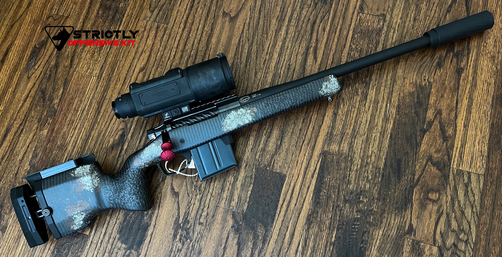

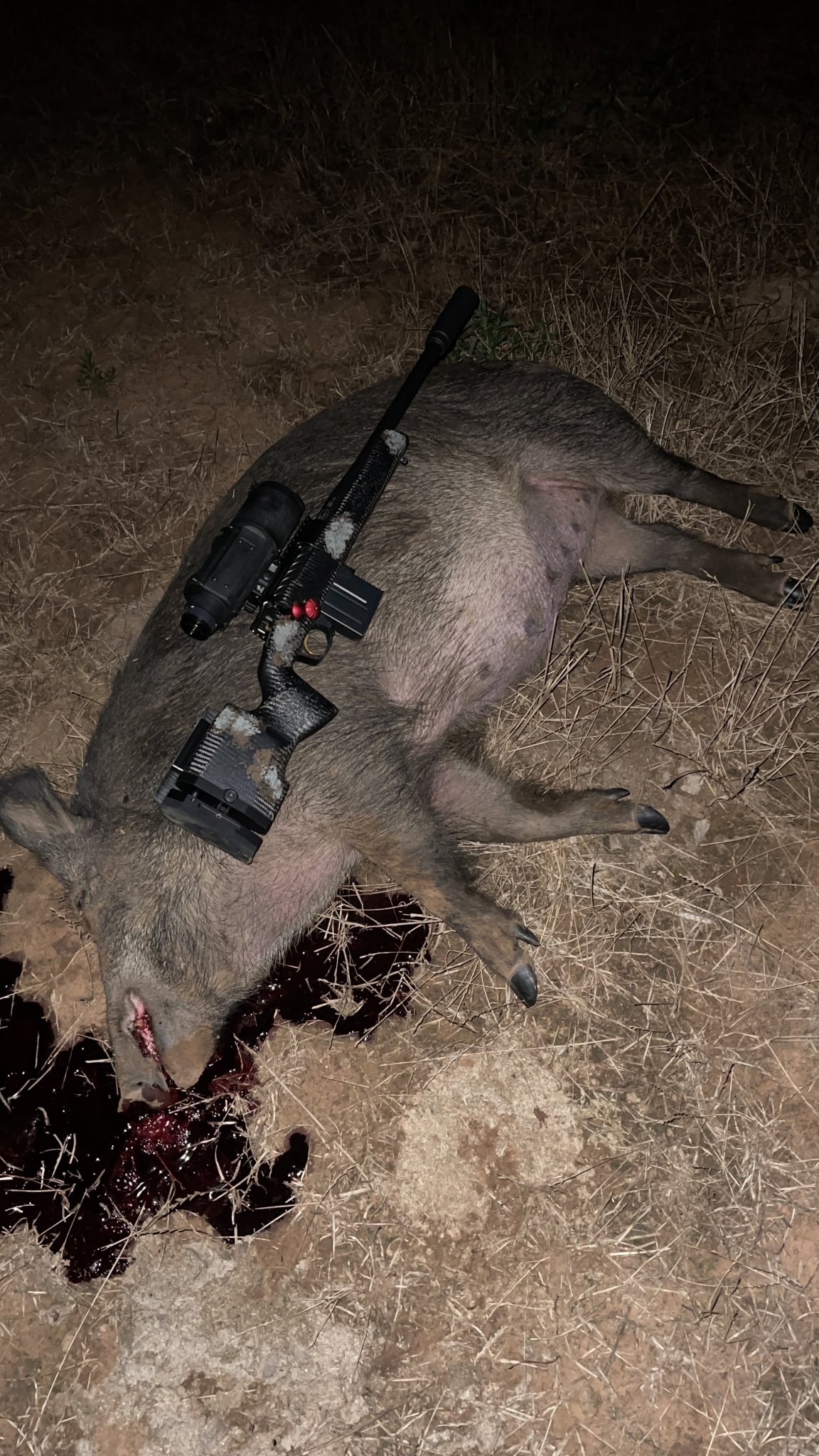

Holy crap that ejection port cut! I have a couple CDG getting barreled at the moment. They're gonna be in a chassis, but I never realized it was that much longer than standard rem700 inlet. Good looking rig!Rigged up for the hog killing fields.
Stock required bolt release and rear trigger hanger screw fitment. The 6mm ARC MDT mag required a little clearance and feed lip work in order to seat deep enough without bolt interference.
Think It'll fit a 7PRC?Holy crap that ejection port cut! I have a couple CDG getting barreled at the moment. They're gonna be in a chassis, but I never realized it was that much longer than standard rem700 inlet. Good looking rig!

No, the bolt is a ways ahead the ejection port cut when racked all the way back. I'm unsure of why they cut the action that far to the rear. Weight savings? Idk.Think It'll fit a 7PRC?

how you like the 6 arc?Rigged up for the hog killing fields.
Well shit, thats a bummer. How much modifying did you have to do for the bolt release and trigger hanger? I have a CS2 waiting for my barreled action to get back. Did you have to get the milling machine out or was it just a slight mod?Rigged up for the hog killing fields.
That's a little dandy!Rigged up for the hog killing fields.
Thanks! The 103s are deadly in the 6ARC. The CDG did great with all the dust and muck. I’m searching for failure which I think will be the TT trigger before the action. Either way, it’s so incredibly easy to take apart, when it fails in the field, I’ll have it up and running in minutes.That's a little dandy!

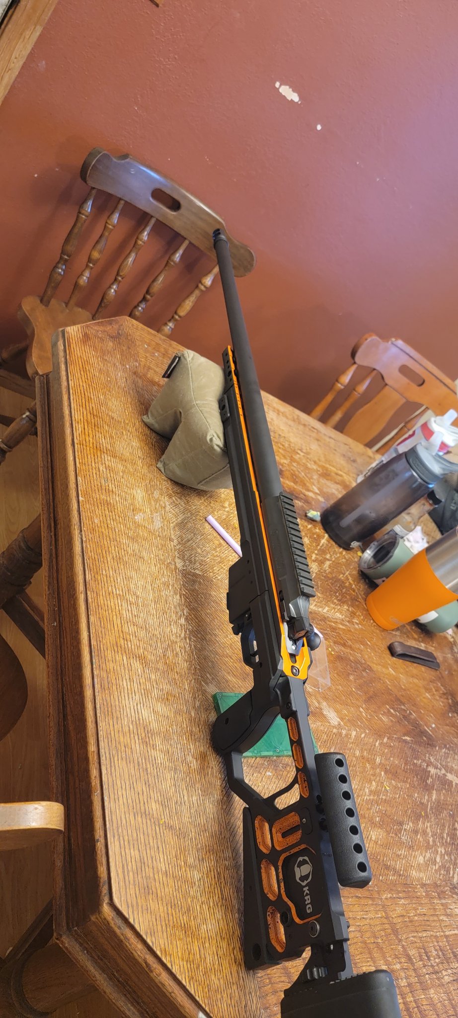

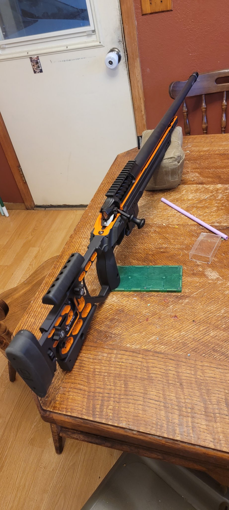

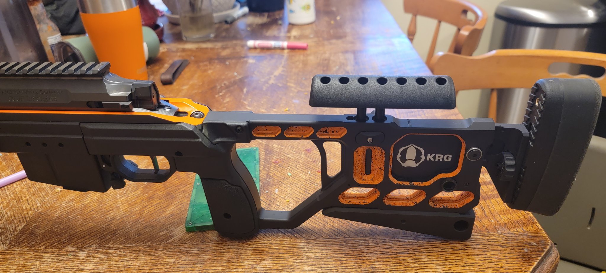

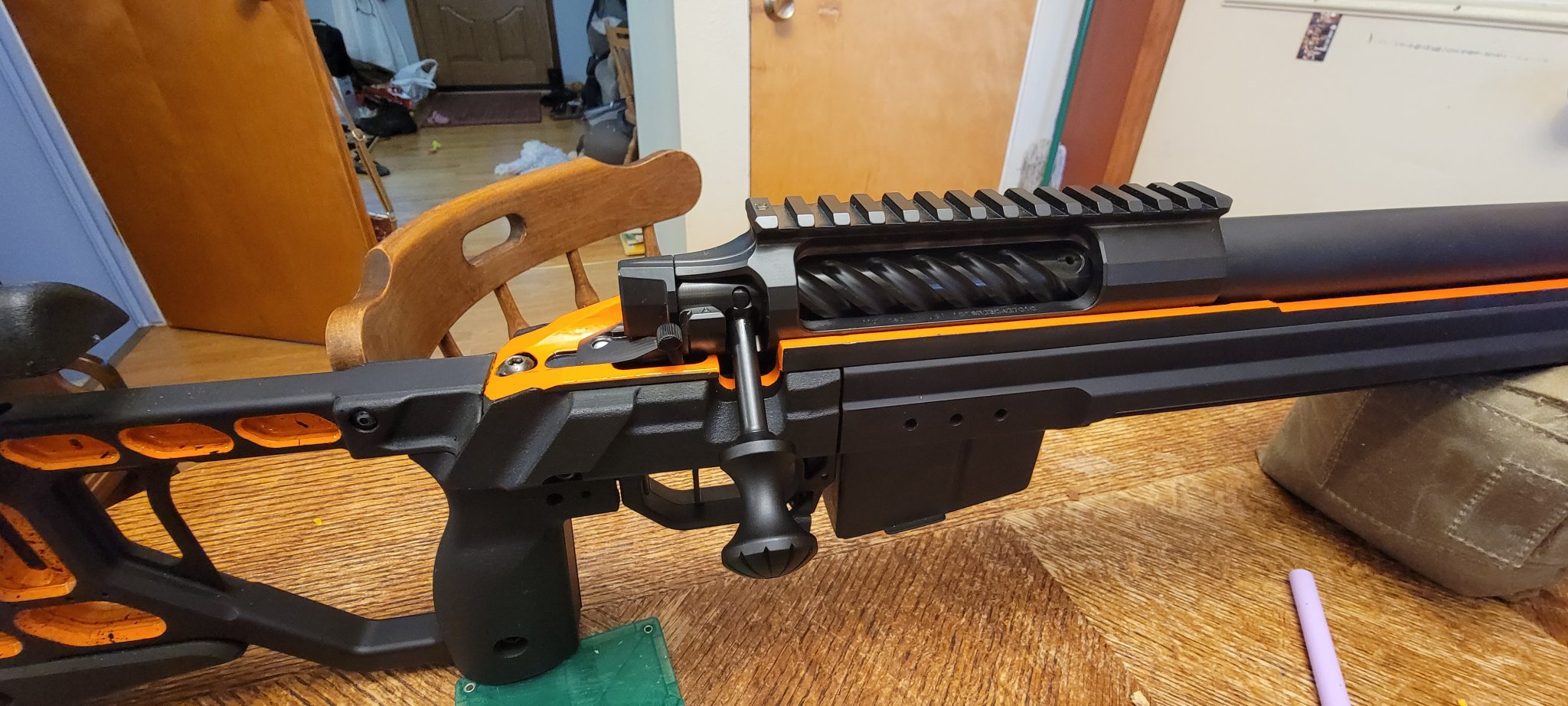

Mine is in an xrs. Fit right up with no mods.has anyone built one on a MDT XRS yet? I was looking at the bravo but I really don't want to have to modify the chassis to fit. I'm hoping its essentially the same inlet with all the MDT's and it would work the same as the HNT26, which look awesome by the way.
The mechanical ejector will throw brass into next week. I have to remind myself to slow down so it doesn't launch it. This action is so smooth I'm having to relearn how to operate with it, no big clanking noise when the bolt hits the end of travel. A couple of people questioned if I would really like the flexing bolt handle, I love it.The CRF is cool but the mechanical ejector is what separates it for me. I really can't see myself buying any action without it going forward.

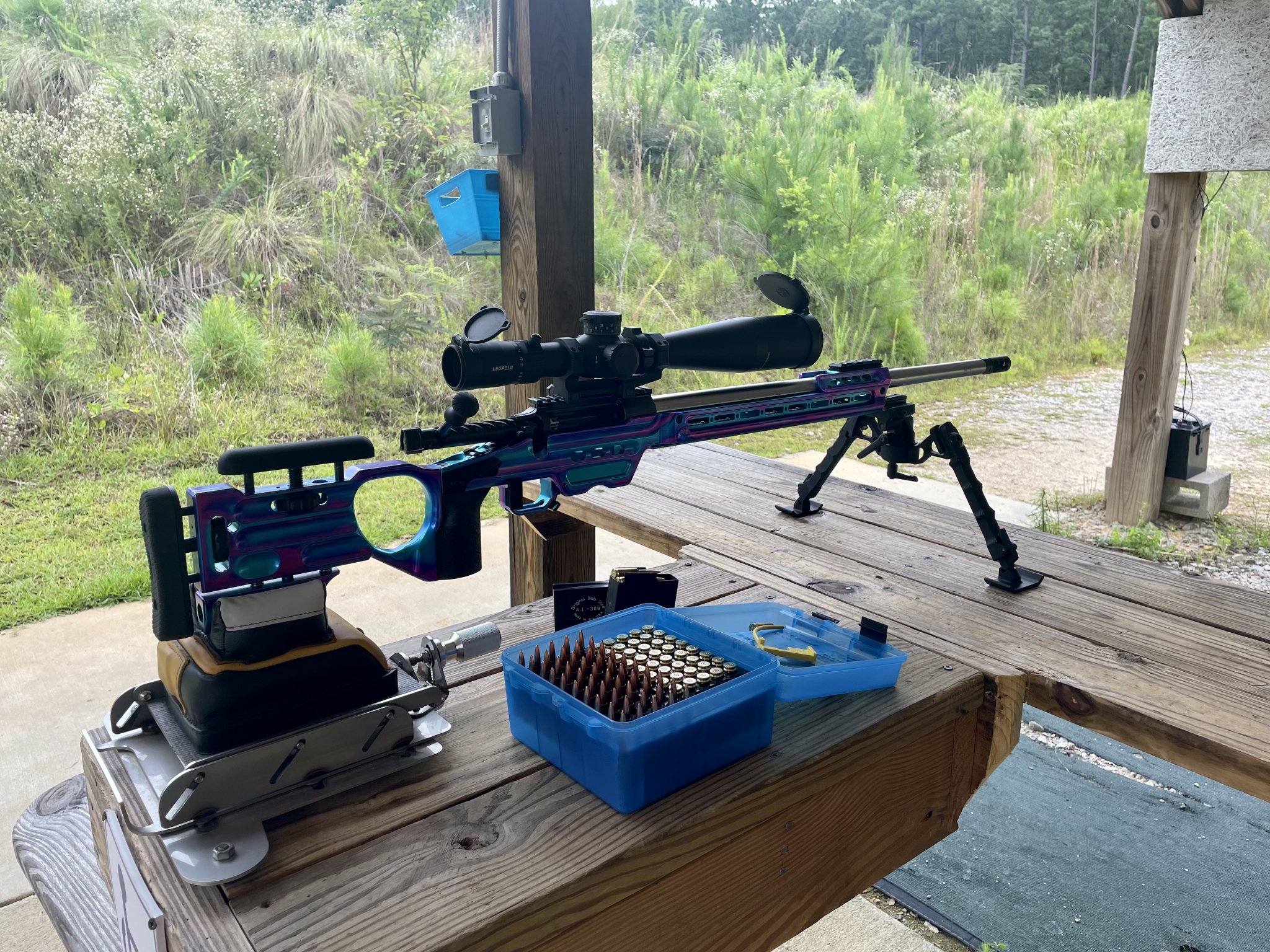

How does it feed with the bra rounds stuffed all the way to the back with no hrd kit? Just looked at ur mag and that appears to be your format.Here is my build:
CDG fixed bolt handle
26” PVA 6BRA
TT diamond
MPA Matrix Pro w/ anodizing from outlaw
Leupold MK5 in a badger one piece mount
