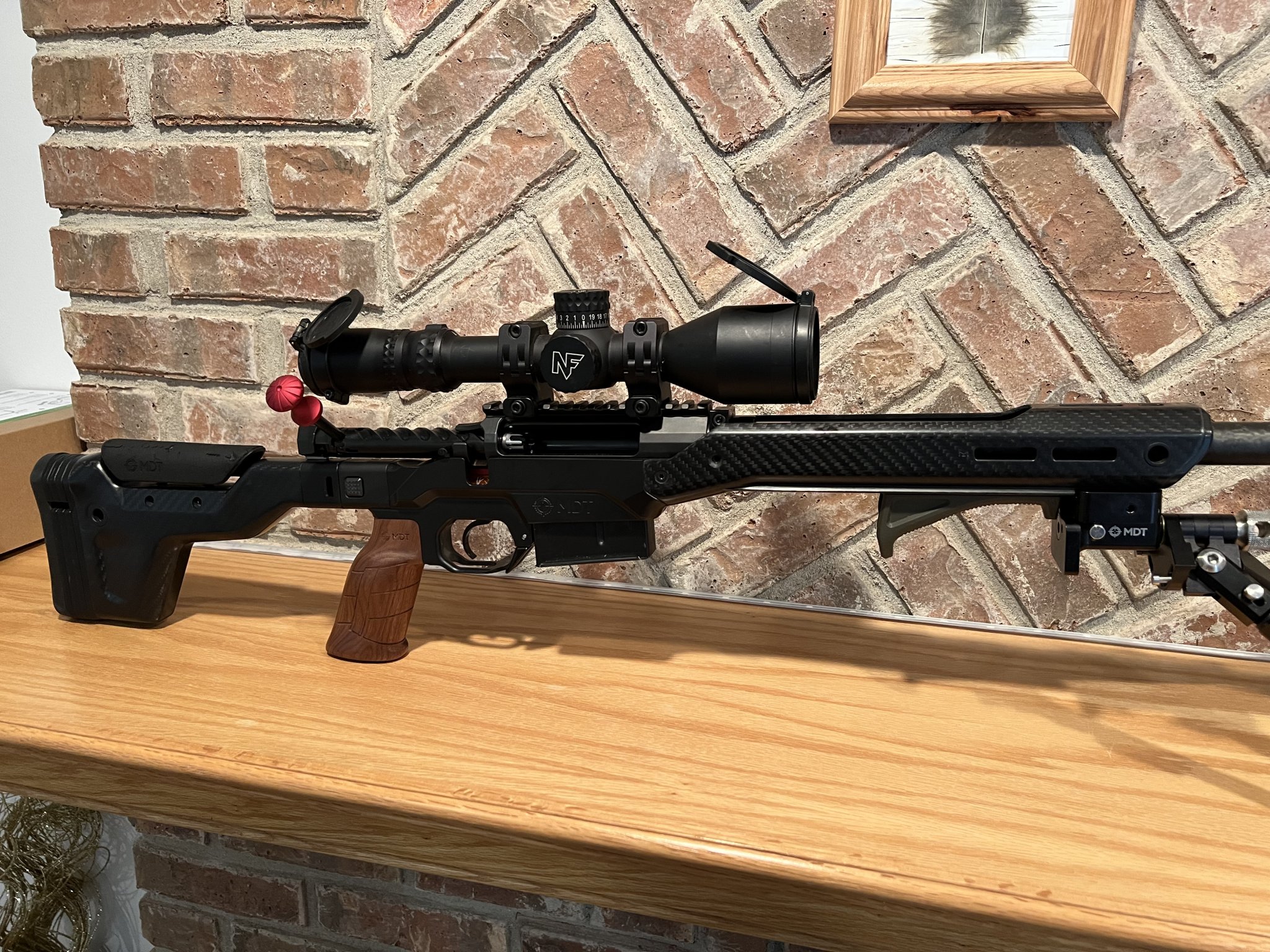

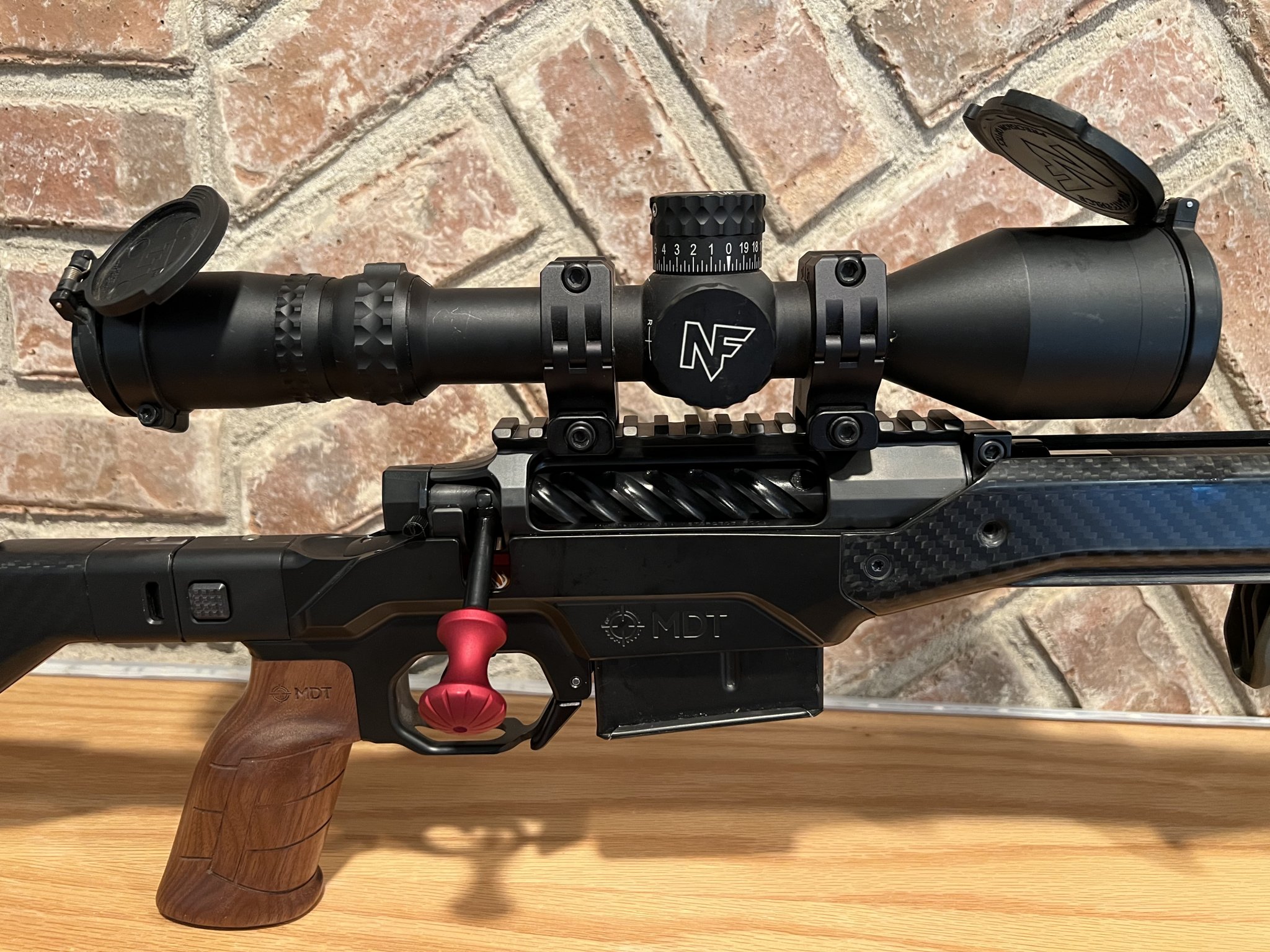

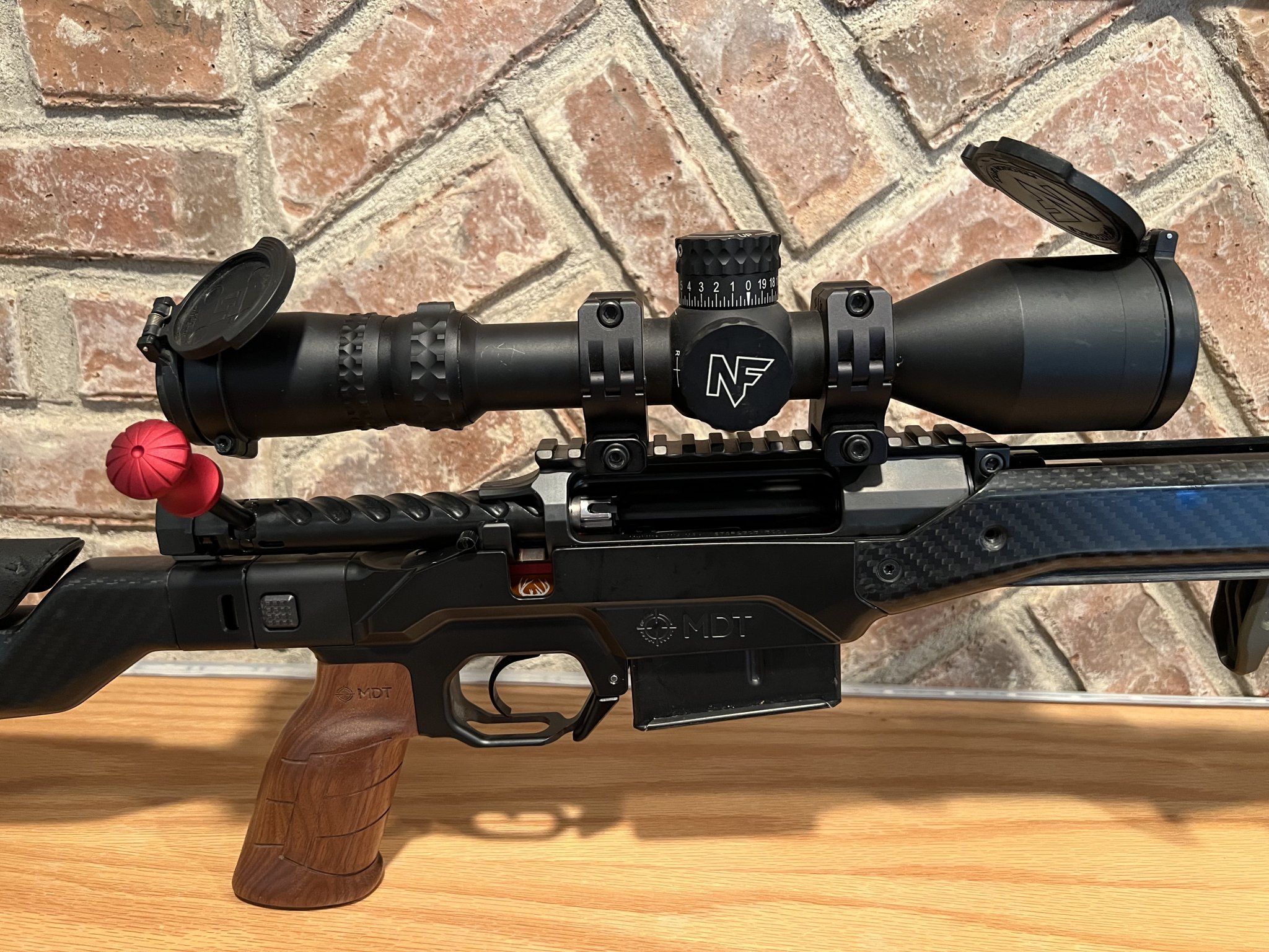

So I dropped it in my HNT chassis and I think I’m going to go that route.
One thing to note is that AICS mags will not lock without modifying the mag latch. I’m going to reach out and see if MDT has a shorter one and if not then I will file down the latch on the new chassis when I get it.

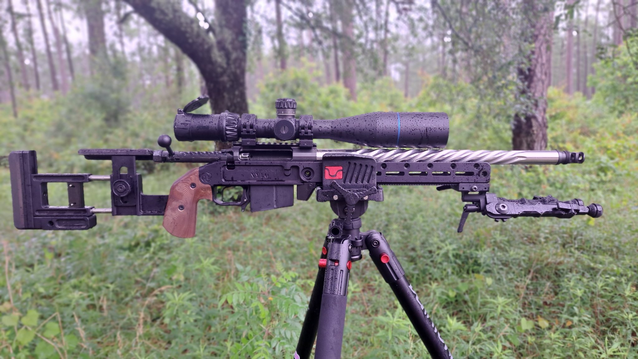

28” of 6GT
All my gt's have been 28" it works well, and balances the rifles great. I just had a gt barrel spun for my ai atx, going 30" hvy varm lol. Should run dtacs up around 3k pretty easily. Dtacs in my 28" at 2880 is a cupcake load. Very minimal if any expansion on lower portion of fired cases.

has anyone built one on a MDT XRS yet? I was looking at the bravo but I really don't want to have to modify the chassis to fit. I'm hoping its essentially the same inlet with all the MDT's and it would work the same as the HNT26, which look awesome by the way.
Drops in without modifications to my recent production XRS, but I didn’t check the whole of trigger hanger travel because I’m not tuning it again.

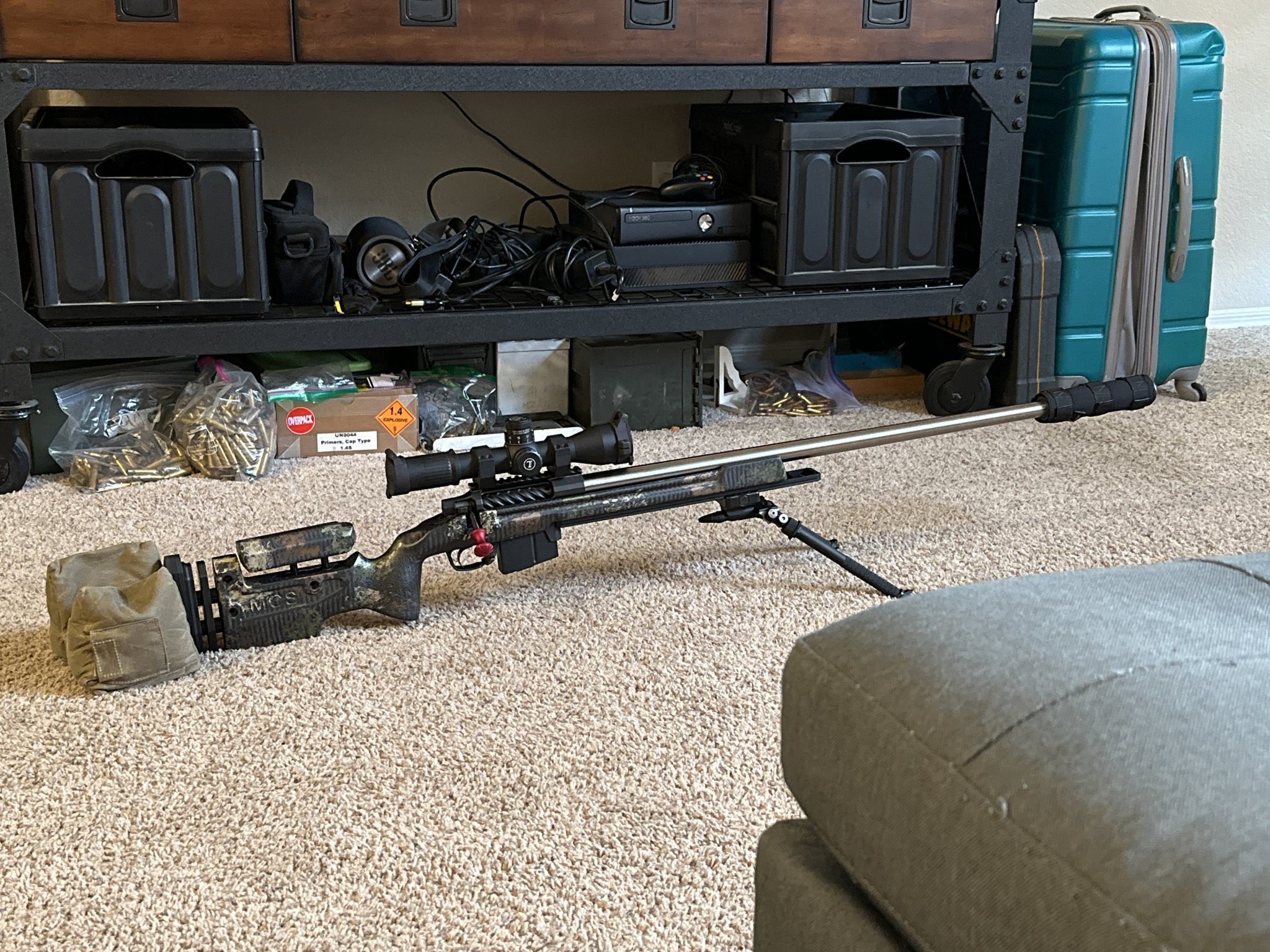

28” of 6GT
