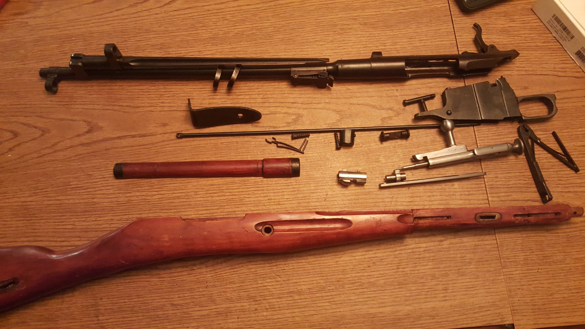

I'm thinking of replacing the stock on my M44 Mosin. After replacing the trigger with a Timney and working up handloads, the rifle shoots 1.25 moa 3-shot groups so I'm thinking it would be a decent pig gun. However I had to really hogout the old stock to make room for the safety so it's pretty thin in places and screws are shimmed.

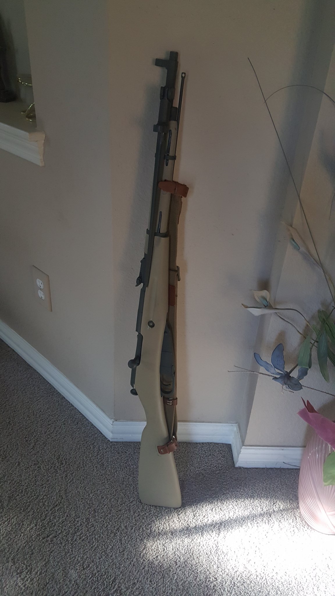

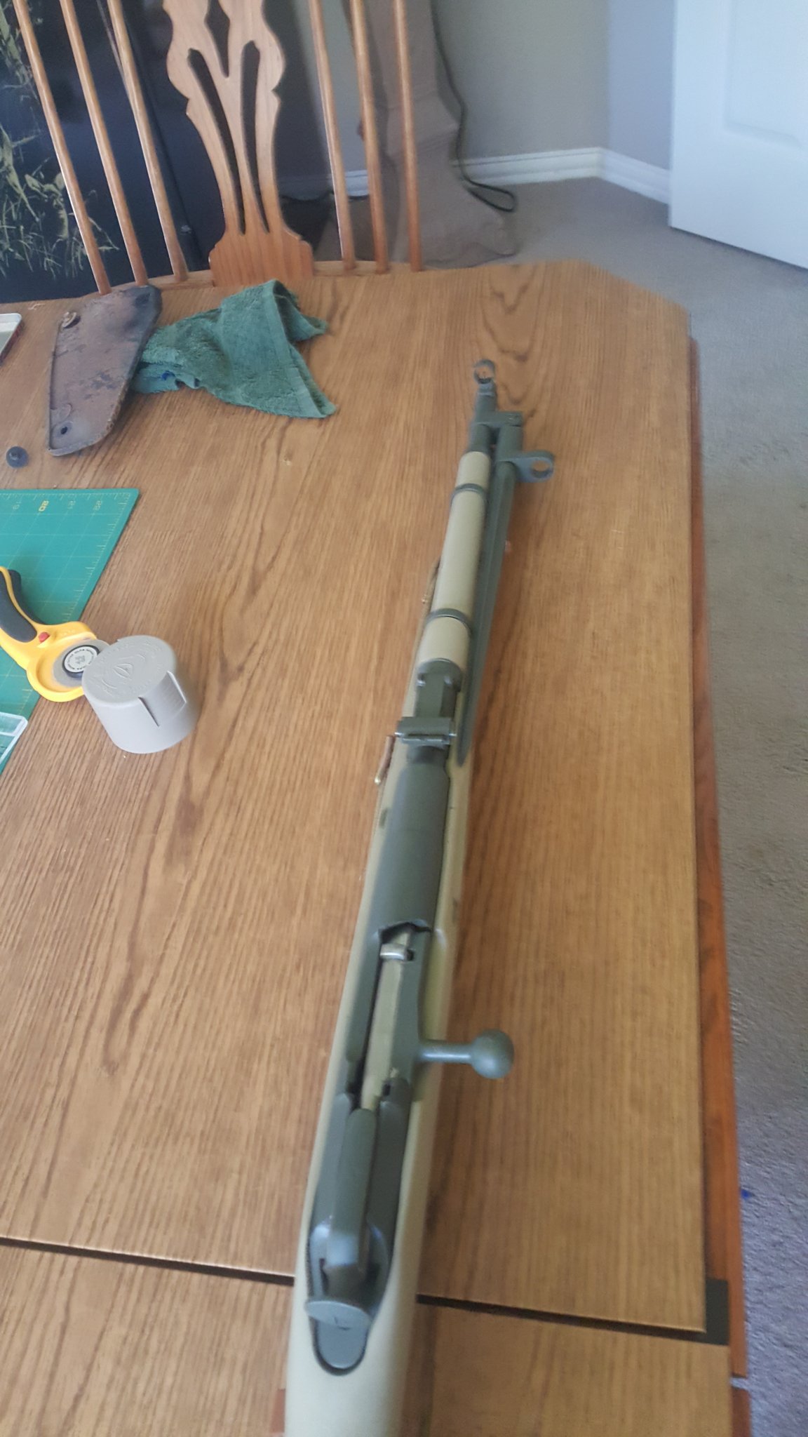

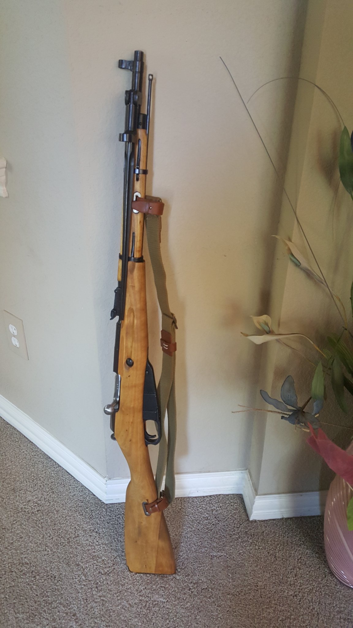

I have no complaints on the feel of the original stock it's just somewhat butchered on the inside after fitting the Timney with safety.
I refinished the stock years ago but the wood was to hard to take an oil finish so I rattle canned it and the rest of the rifle. Then I bought a spam can of corrosive Russian ammo and banged away. The trigger REALLY sucked so I changed it.
