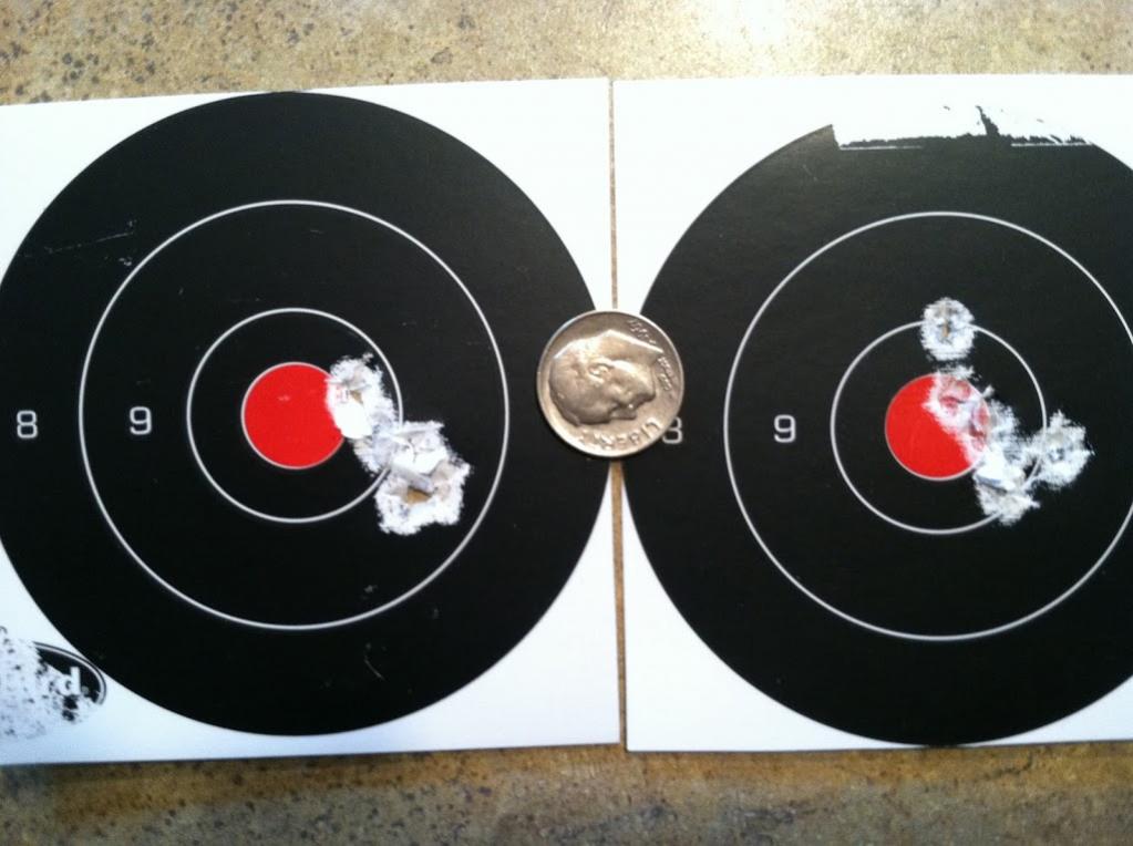

well i went ahead and got a crosman venom in .22 as my "introrifle", wood stock. definately needs a trigger job, the one in it is worse than i thought (5.25 lbs, more than .5" of creep even with the adjustment bottomed out, and not repeatable). more on it later after a 25 & 50 yd test. if all goes well there, i have to save up for one of those fancy PCP rigs, you guys got some interesting stuff, i think i'm hooked!
but just a blurb when it comes to pellets, looks like almost as important picking a rifle, finding the right pellet is crucial. even more finicky than rimfires and centerfires IMO, this thing took me to school today, and my shoulder and arm is starting to throb from cranking that barrel several hundred times!
for a minute i thought i'd be returning the rifle, as it looked like the groups where so scattered, even at 10 yards, that this whole thing was FUBAR and not worth pursuing further. then i switched pellet manufacturer, i realized the rifle was a keeper. then when i thought a particular pellet design is the best, a spoiler came along that made me think that not only the manufacturer and shape was the concern, but the weight of the pellet comes into play. further reasearch on air rifle forums said that the skirt design (bottom section of the pellet) and the cavity underneath it is a huge deal too. i imagine it's the same as boattails vs. flatbase, and so on.
hands down the best that worked for me were domed styled pellets. i had very little luck with the pointed design from 2 manufactures so i thought that the pointed design was something that i shouldn't consider for accuraccy, then the third manufacturer changed my mind. a shape that may not work in a certain weight may work in a different weight. choosing a pellet is as clear as mud, right?
along with the rifle i ordered sample or test packs (Gamo pellets, JSB pellets, Benjamin pellets) to try to weed out what the rifle likes. only fired at 10yds for today to get a clue at what i'm getting into. but after a 160 pellet break in (interesting how those groups shrink and the rifle gets quieter after some use) - i started to shoot for groups, 12 different styles and weights, 3 different manufactures. only at 10 yards, the longer 25 and 50 yd will determine "the one" for me to get in bulk:
tied in first at 10yds, well under .75":
JSB heavy (domed) 18.1 gr
JSB RS (domed) 13.4 gr
JSB Straton (pointed) 15.9 gr = the spoiler to the domed style results
Benjamin / Crosman (domed) 14.3 gr
Benjamin / Crosman (domed HPoint) 14.3 gr
2. Gamo hunter (domed) 15.4 gr 1.25"
3. Benjamin / Crosman Superpoint (pointed) 14.3 gr 1.5"
4. Benjamin / Crosman "destroyer" style 14.3 gr 1.75"
5. Gamo Master (pointed) 15.4 gr 2"
6. Gamo Magnum (pointed) 15.4 gr 2.25"
7. Gamo TS22 (semi pointed) 22 gr 3.25"
8. JSB Jmbo Monster (semi pointed) 25.3gr 4.5"
some of those groups are pretty big, especially for only 10yds - probably can throw a dart more accurately - that's how finicky the rifle to pellet matching is. although they wouldn't work in my rifle, in someone else's they may be "the one" (BTW i have about 1200 .22 pellets in different styles i will not be using from #2 down, shoot me a PM if interested in making a deal). i'm sure all those groups will shrink once a usable trigger is achieved, but for now i'm working with the horrible stock crosman trigger.
another thing i found curious is the heavier pellets shot WAAAAY higher than the lighter ones. 4" to 7" higher, i'd think they would be lower as they were so much heavier. the heavier the pellet, the quieter the rifle got and and softer the "recoil".
lots of lessons learned today!

the saga continues:
at 25yds, small differences in everything start showing up, breaking the "tie" for the pellets that worked well at 10yds. oddly, the "cheaper" Benjamin discovery / crosman premier pellets seemed to work the best (5 pellet group):
1. Benjamin / Crosman (domed HPoint) 14.3 gr .75" group .25" higher POI from 10yds (seemed to hold it's line the best with minimal adjustments from 10 to 25 yds)
