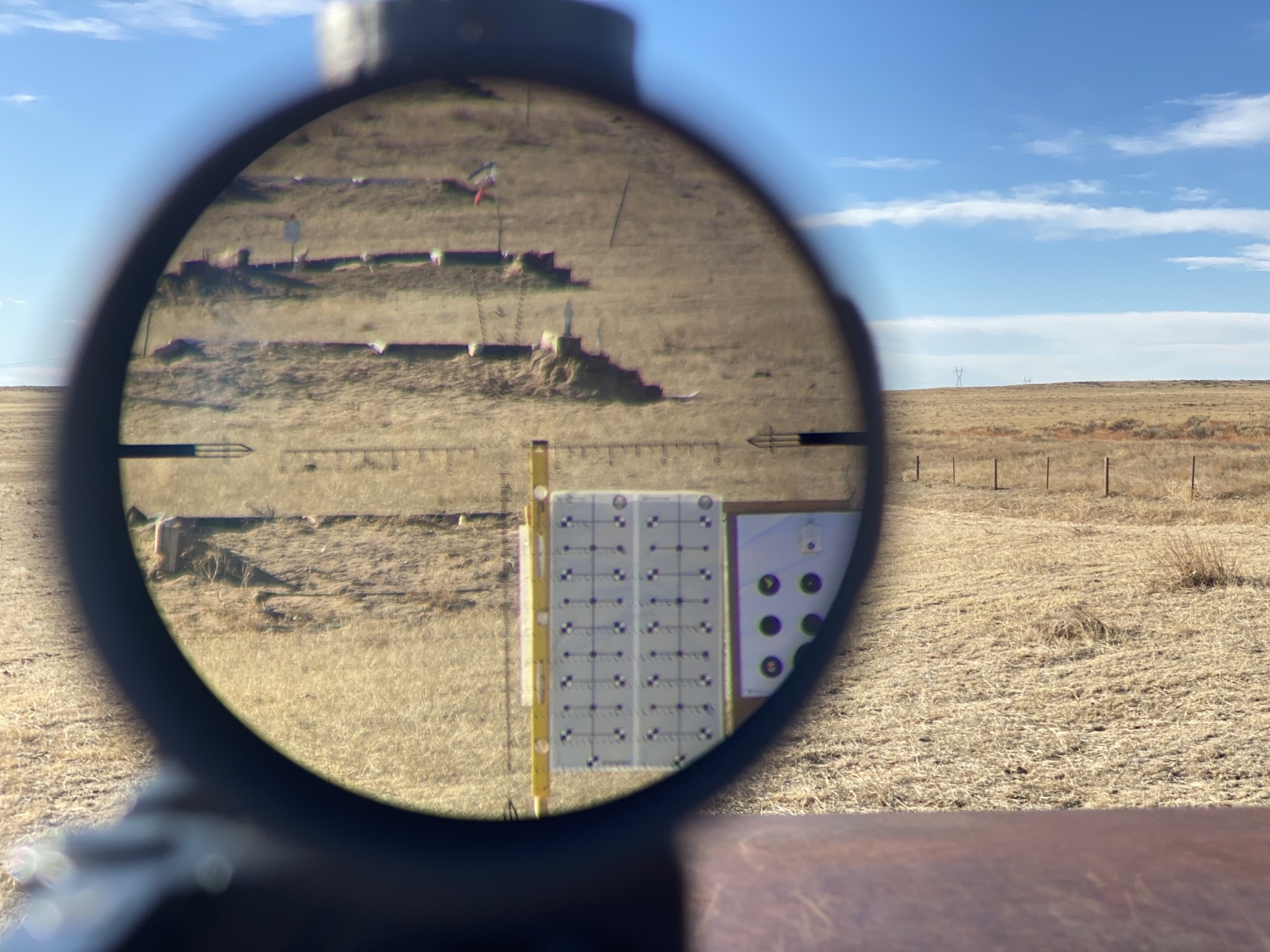

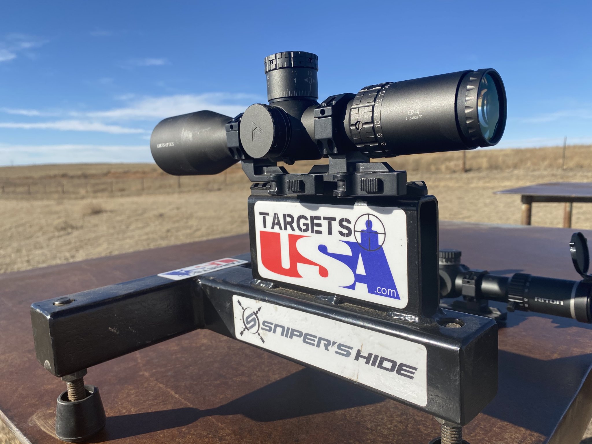

    No hype necessary, just a fact there is truth in advertising with somethings and testing this scope, it was clear to me it was tracking 100%. I tested it at 10 Mils and at 13.3 Mils on the 4ft Level pictured above.

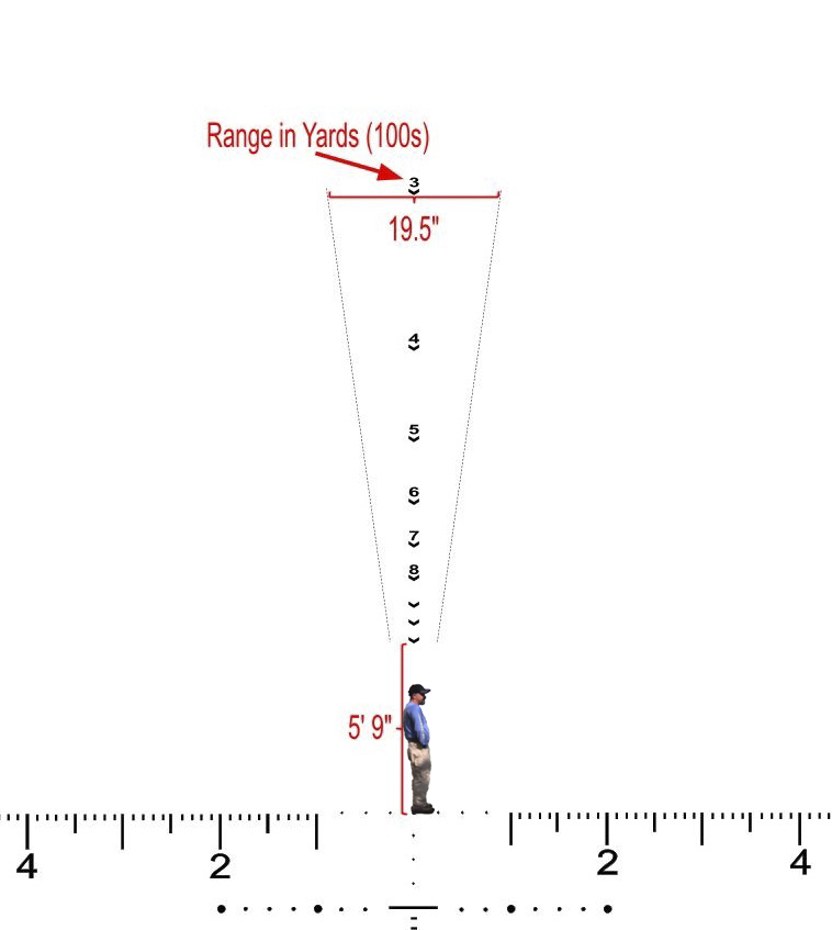

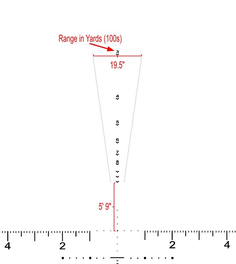

    WTF is up with that reticle?
    Are those upside down chevrons to show you where the aiming point is? they are certainly useless for holdunders, which, admittedly, you don't do too often. Gee, if they only blinked in order.
    They are also completely useless for measuring anything.
    I realize that trying to avoid patent infringement is a bit difficult, but I would rather have nothing above the POA instead of that abomination.
    It's a rapid ranging reticle
    It's not for holds, you put the target between the V and where it lines up is the range
    the Military still does reticle ranging and they have several RTE (rapid target engagement) variations on how to do it.
    But this just simple reticle ranging
    What is the subtension?

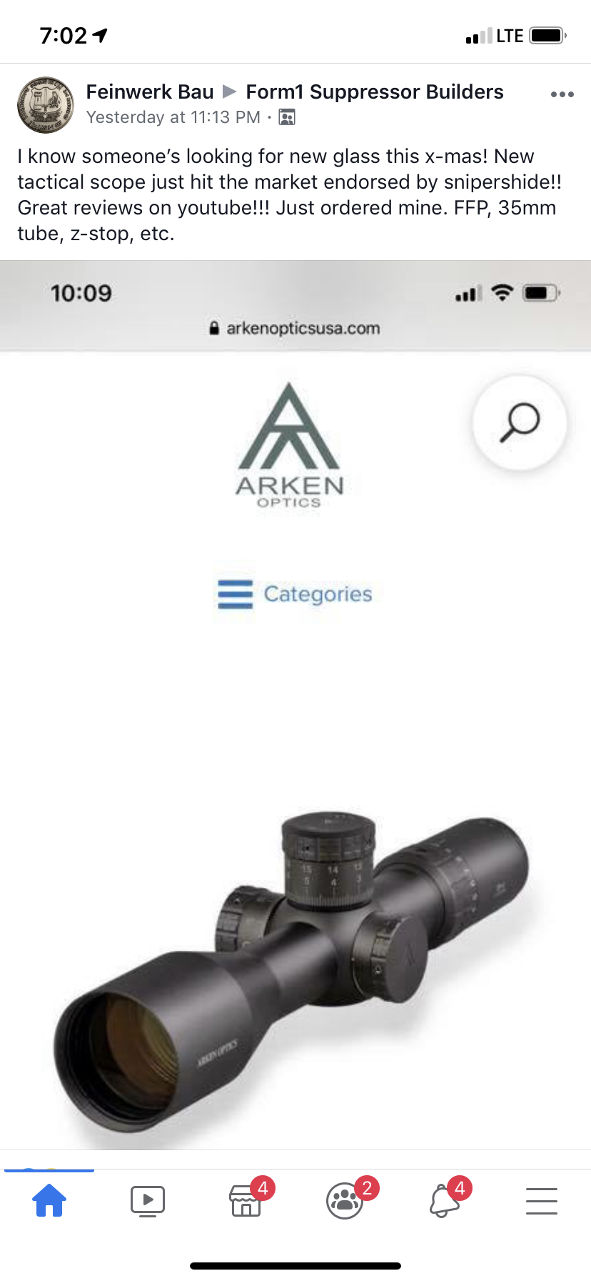

    Bit of a jump to say it tracked 100% to we or me endorsed it
    I reported a fact after a check of a single unit, yes it’s a great bang for the buck and it punches above its weigh class, but that said,
    I have no clue who that FB guy is and never added more than what you read here
    Stupid question but I see a lot of horizontal movement when you are dialing vertically. It appears to come back in line once you stop dialing but doesn't travel up and down in a straight line. Do you see this as an issue?
    You are looking too much into it,
    that is me moving the fixture because the one I am using has rubber feet.
    If you are really paying attention you see me checking parallax, moving it and letting it settle in, because, I AM MOVING IT
    The fixture is 27LBS, the new versions are 30BLBS and the feet were changed.
    My bench is also metal and concrete into the ground, if I lean on the table or touch it, the fixture will move.
    Stop trying to find an issue that doesn't exist, we ar moving the scope by turning the turret, you are gonna see movement.
