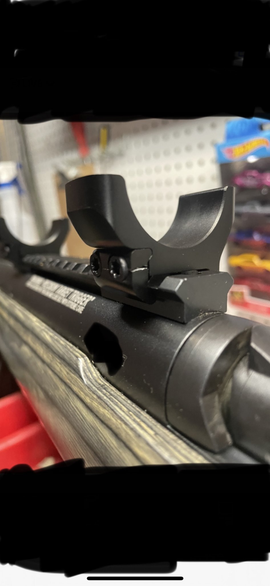

I just had two failures with the mount plate, I think it’s more of a design and material flaw. It’s a easy remedy, that if they fix, would be great rings. Just make the plate out of steel, like weaver, UTG pro, and several others. But I have two sets of broken rings. I warrantied one set, probably going to the other set, but I can’t put them on anything. I just lost confidence in them.View attachment 7800437
I'm honestly starting to wonder if it has something to do with your base, or if your torque wrench might be out of spec... Because You're the only one I've heard of having these issues. I just checked my .260 since it's up here beside me, and it's fine after hundreds of rounds and getting toted around without protection, and bouncing around in the backseat of the Jeep (not in a case). I don't know man. Wish I had an answer for you. 🤷🏼
What brand base is that? I run EGW HD bases on all my rifles.
Get refunds on them and get a couple sets of Seekins, or warranty them and try a different torque wrench... Maybe that will help?
I don’t know, it’s a Leupold mark 4 steel base, they’re pretty good quality. The first set I didn’t even get to a torque wrench when they snapped, I was maybe 10-15 in lbs with the supplied Allen wrench. The second set was on a Springfield saint AR i doubt it was out of spec, they cracked after torqued to spec and sat in the safe for about two weeks. The torque wrench is used for everything from transmission band adjustments to scope rings.
I’ve never had a single problem with it, or any other brand of rings.
There’s more people out there with the problem, just not on the hide apparently. But it’s a known problem, dealers are putting out mounting sequences to prevent it. That’s fine, and I went by that and the second set snapped anyway. I don’t need a mounting sequence for Seekins, Burris or Nightforce that’s currently being used. That’s the problem I have with them. If I got to baby them, I don’t want them.

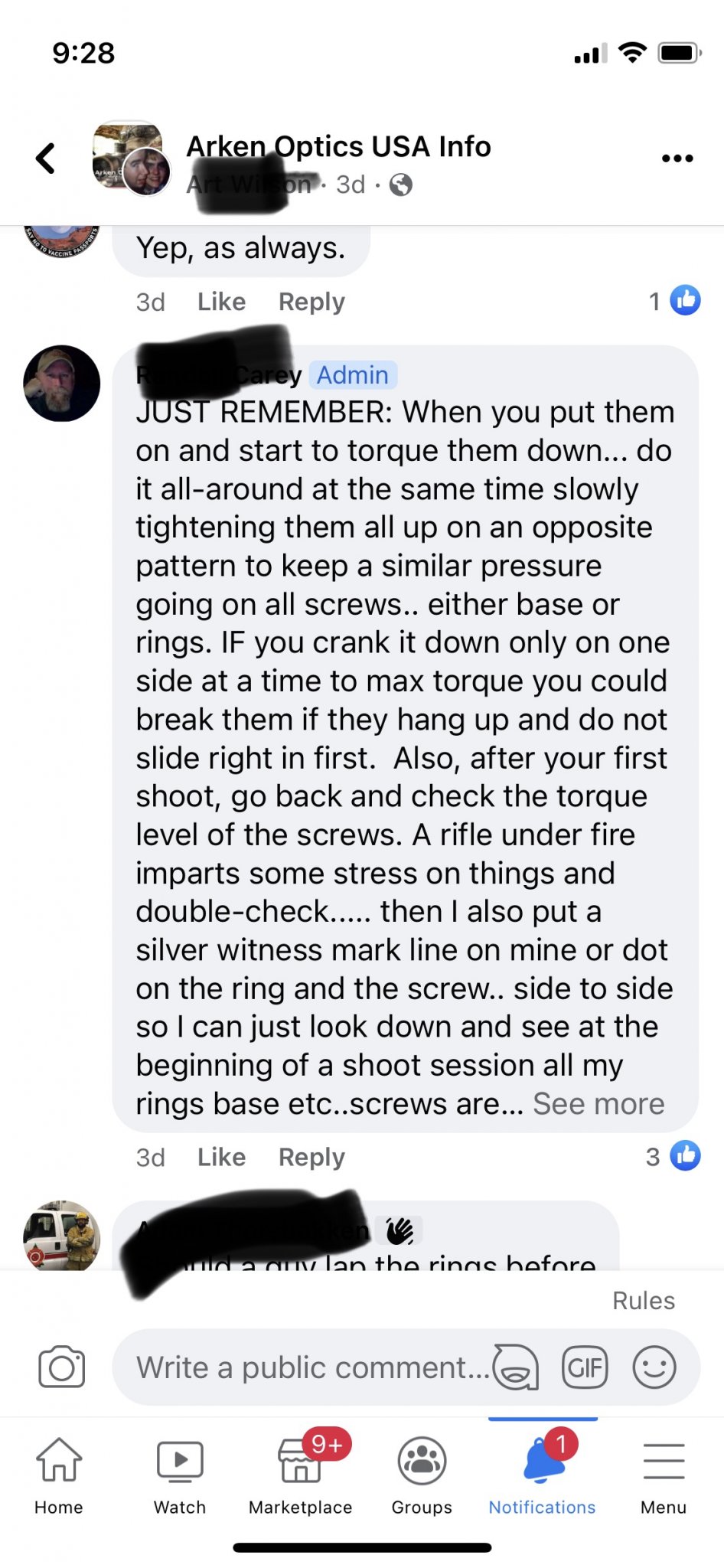

I'm going to grab my rings out of the parts drawer & crank them down on something & see if the hold. If something happens, I'd rather it be now than out in the field
Here’s a thread where a guy was asking if the rings were under lifetime warranty because his cracked. This is the response of a well known dealer, he’s even going as far as almost saying they even loosen up after a while. Two guys in that thread besides me had them break.

🤔 I wonder if it has to do with expansion rates being different between steel and aluminum...??? I read something about that MANY years ago, but haven't thought about it since... My bases are 7075, same as the rings, so they have identical allow expansion and contractions rates. I wonder if this could be your issue?
But you said the 2nd set was on an AR upper, which is aluminum... So, I don't know...
Just to clarify, you said you use on transmissions... You are using INCH-POUNDS and not ft. lbs. correct? 😂
Yes, transmission bands are always adjusted with in. lbs. that’s the reason I own that particular torque wrench, was for transmission bands initially. It just got carried over to the gun room after a while.
That expansion rate BS is just that. Nothing to do with it.

i didnt want to join this thread as it gets too spammy, but, i have to say i had this exact issue with the rings when i got my ep4 back when it first came out. they did replace it, and i did hear others having a similar issue back then. i have used the replaced rings on my ep5 and it did not do this. i got the replaced rings when the sh4 came out and they shipped it together but only recently mounted the new rings on the ep5.
As someone who's actually studied metallurgy (spent 20 years welding and doing custom metal fabrication), I can assure you that it's not BS... 2 dissimilar metals and alloys, even of the same base type have different expansion and contraction rates.
Now, in the gun world, is that going to be enough to matter when it comes to rings and bases being dissimilar? Probably not... Just saying that it's real.
Now, in the gun world, is that going to be enough to matter? Probably not... Just saying that it's real.
Well we are talking about the gun world and no it’s not going to be enough to matter at all. When I said BS I was talking about the gun world as that BS gets thrown around here a lot. I know it’s a thing but not in guns.
I've always tightened screws down in increments evenly. OCD? Meh, lol. I just put the Arken medium rings on a base I had. Started all with 10in/lb, 15, 20, 25 then 30. So far so good.....I'll drop them off the ground a few times tomorrow & see what happens.
