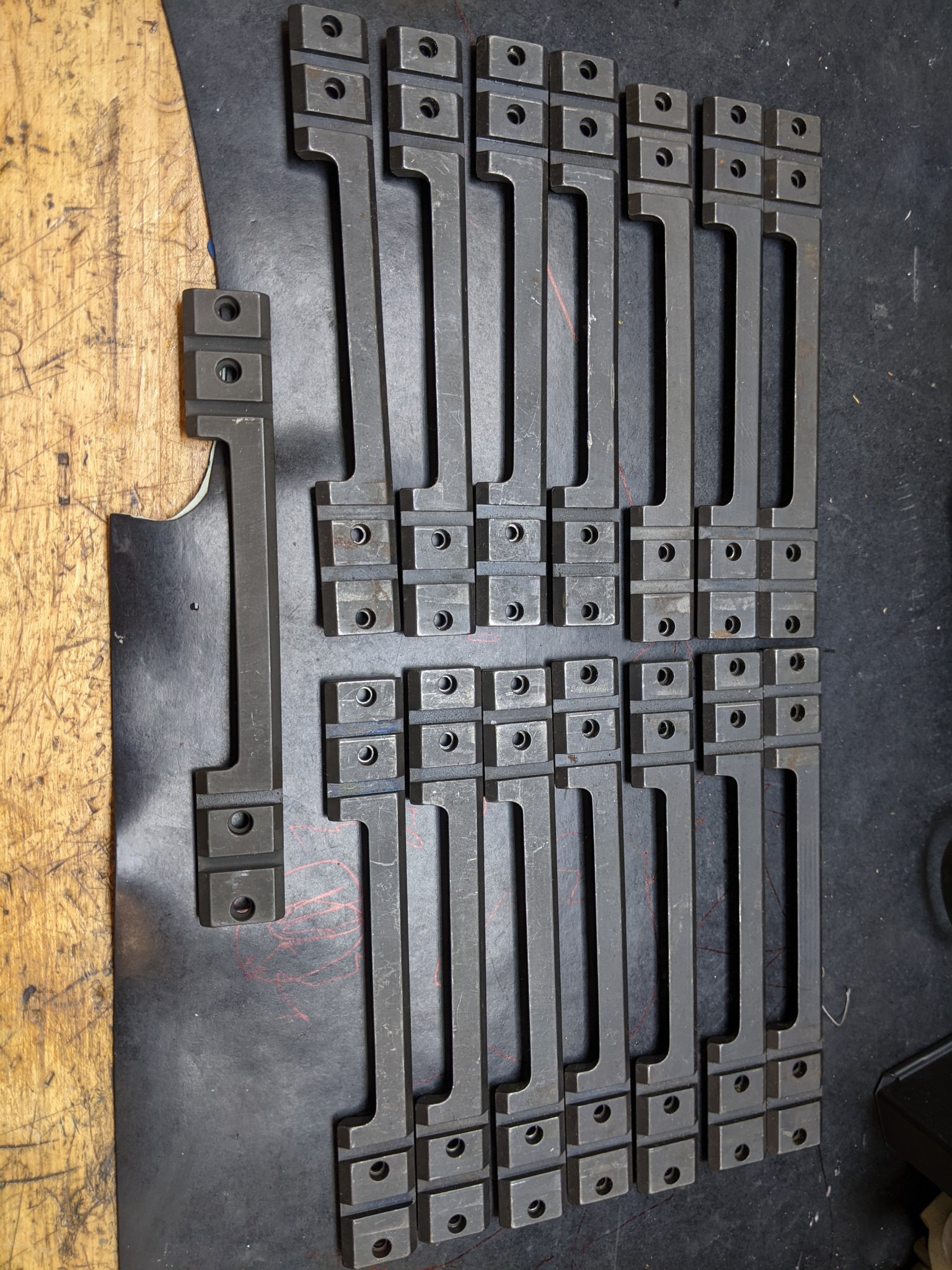

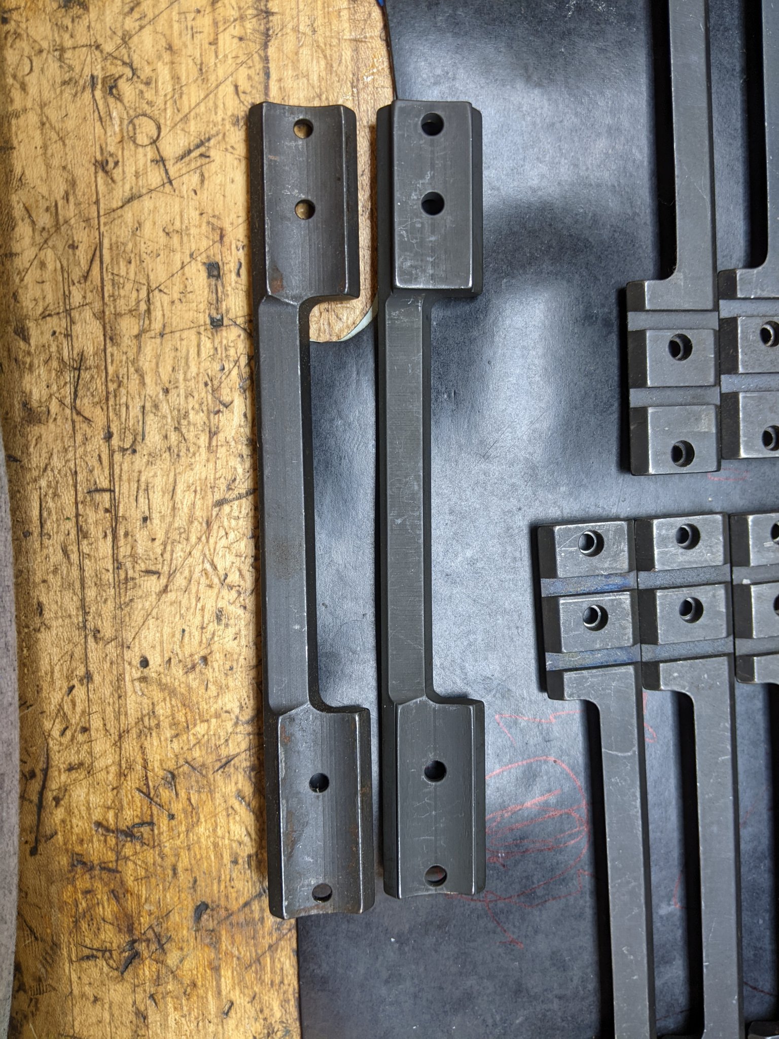

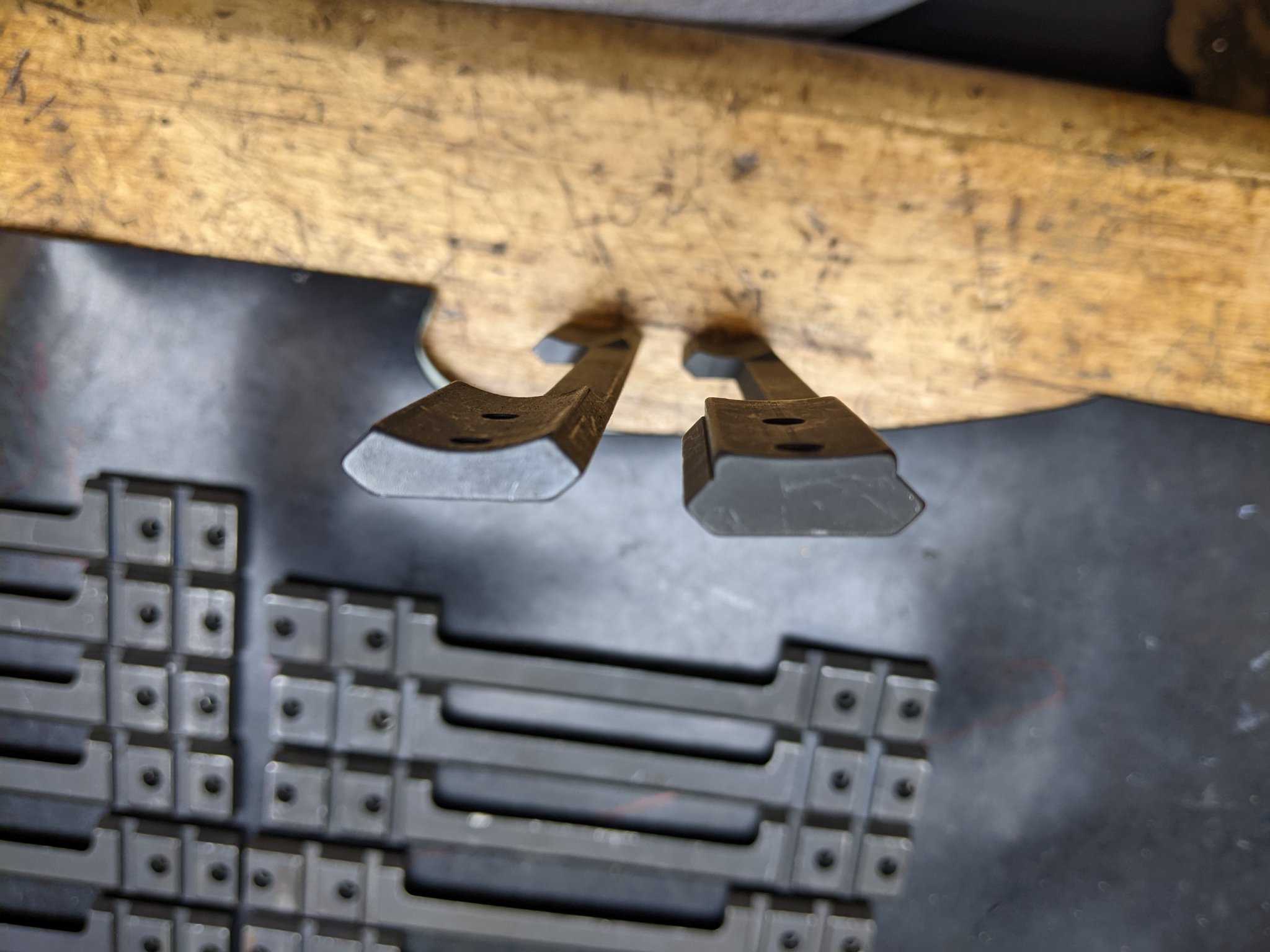

Also I was wondering if others had any reports that the latest batch of BO M24 marked mounts were narrower than the originals and weren't working for em.

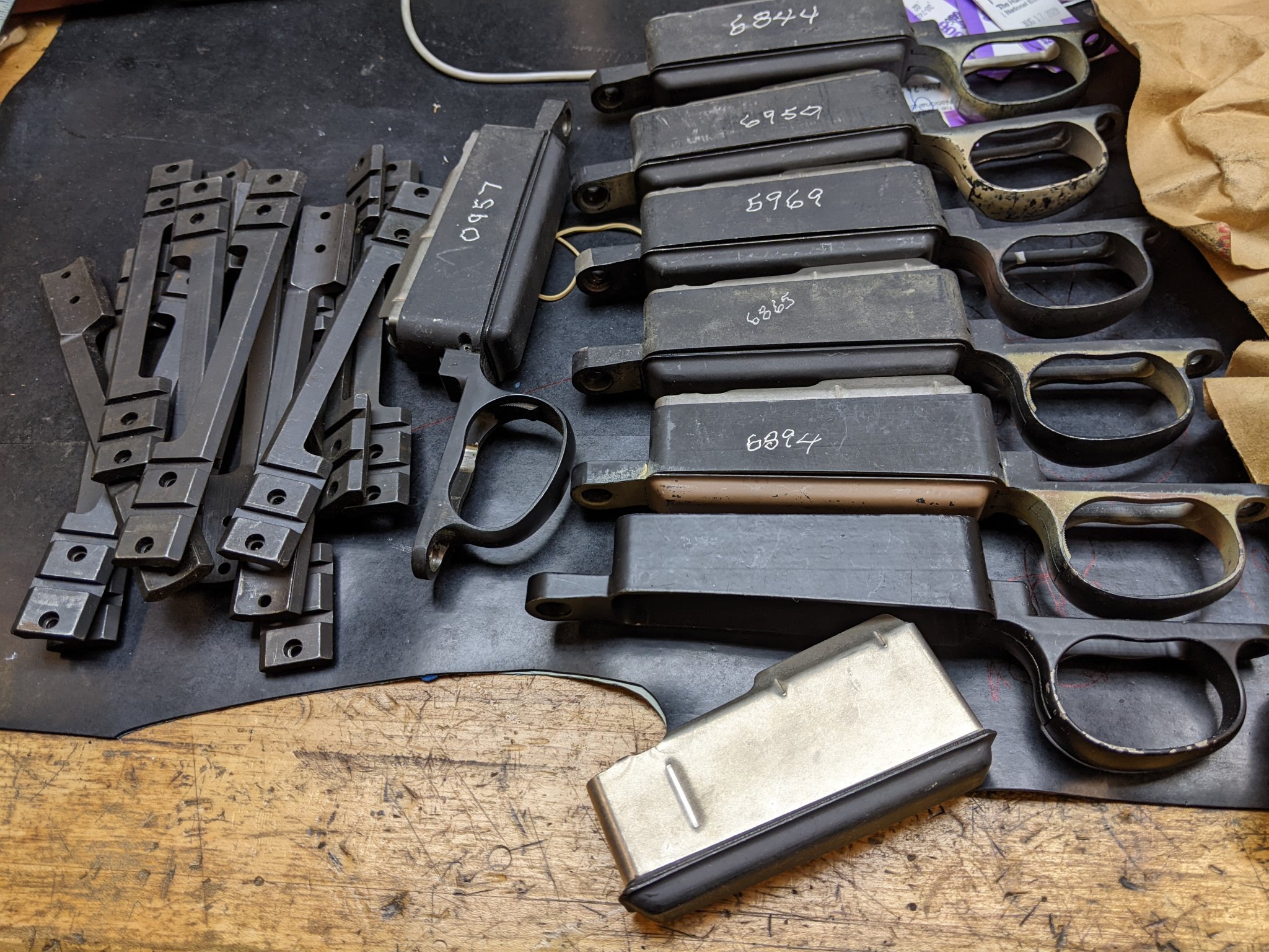

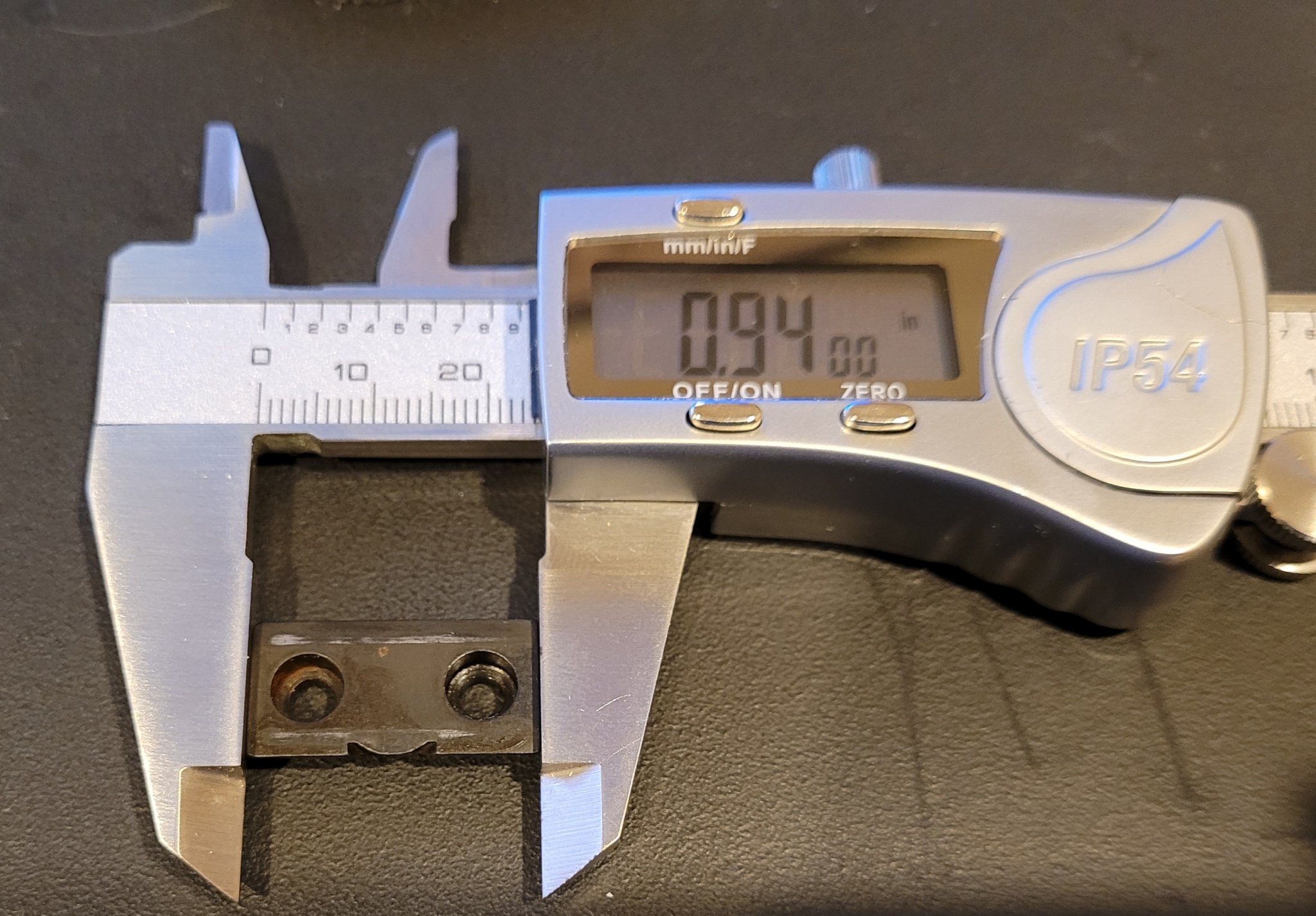

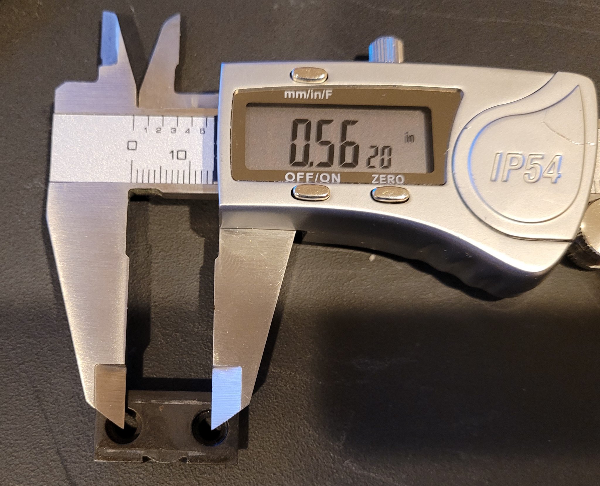

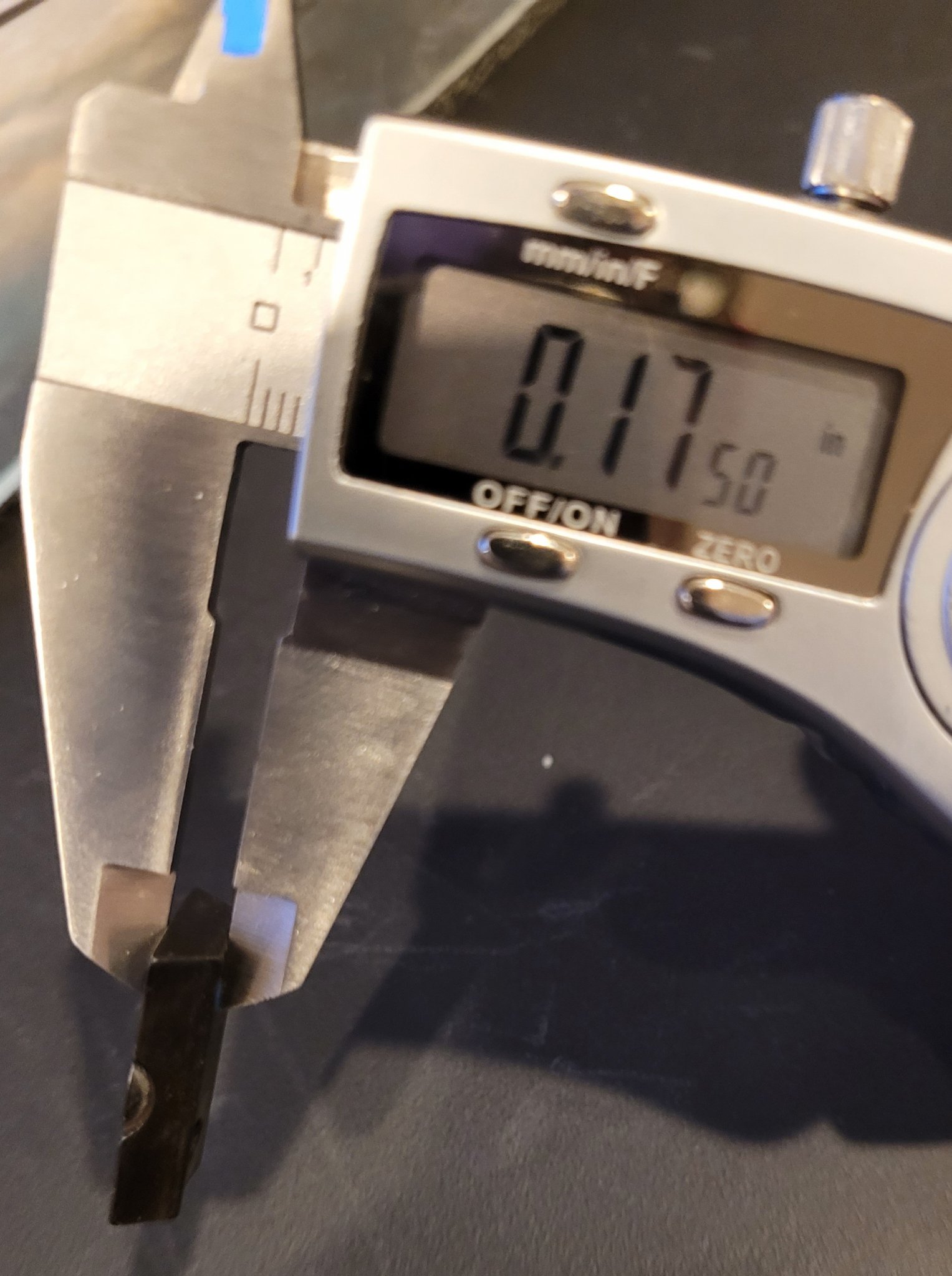

Unfortunately I can attest to this being true. At least it’s narrower than the 0.835” in the specifications sheet on their site. Looks like they are based on the narrower weaver dimensions. But normal picatinny rings clamp on fine, and even the older Leupold Ultra rings should as well.
Unfortunately, a set of original Ultra rings I have were previously over torqued, so the clamp feet that is pressed against the base when tightened down is slightly bent outward. This isn’t an issue if trying to use them on a picatinny rail, but with the weaver and Badger M24 marked SWS rails being narrower, they won’t lock down.
So if anyone has or knows of where to get the wider earlier/original or even take-off one-piece rail… 🙏
The rail pic is a bit of a teaser, I wish they were all m24 mounts, only the front one is a m24 mount, the rest are identical to the m24 rail except the rear mounting pad that attaches to the receiver bridge is made for a full round receiver, I believe that these are Leupold/Brookfield rails that were removed from long action m86 rifles, early mcmillan receivers are full round unlike the Remington. If anyone needs an ultra rare long action m86 scope rail I have plenty available lol. I was considering machining adapters to go in-between the rail and Remington receivers so they can be utilized.

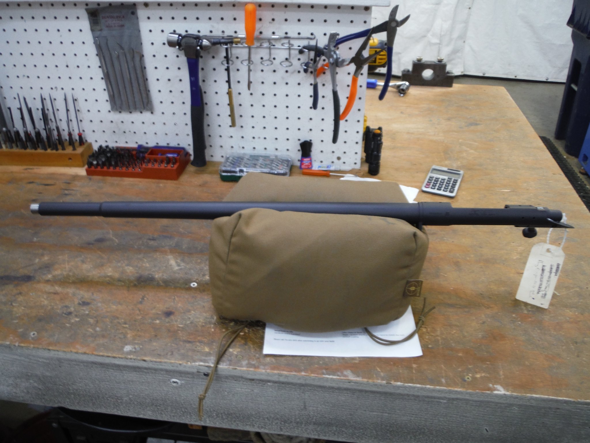

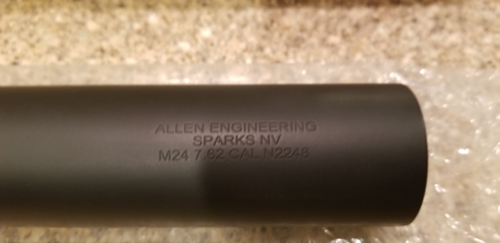

I'm building an M24A2'ish rifle from parts I had laying around, all I need is a barrel. The receiver is a Remington M24 "C" prefix with US stamped above the serial number. The NF scope and rings aren't correct, but I think they'll be perfect for the rifle. The Army went with the MARS rail on their A2's because the MIRS was less accurate in their testing. I decided to go with it because I already had it on hand and I don't feel like tracking down another rail. The stock is HS Precision, the bottom metal is Badger Ordnance and the trigger is a Remington M24.
I guess I need to find an Ops Inc 3rd Model or whatever silencer. Does anyone have one they'd like to sell?
I can confirm. I have two sets of ultra rings and neither of them will tighten fully on the badger rail.
I am also in search of an ultra rail.

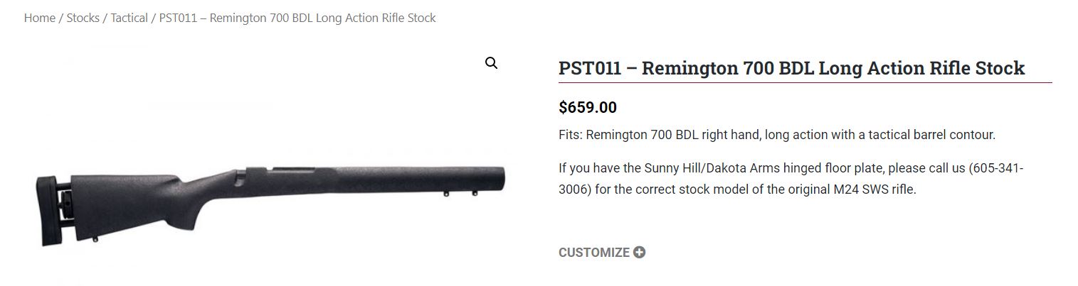

Since the Badger drop in DBM for the M24 stock is no longer available,. Is the M5 an option? I know it necessarily isn't correct, but top loading is a pita.
I was hoping all the M24 stuff that came to market recently would have brought more activity to this thread. Then we could've tried convincing Badger to do another run of DBMs.

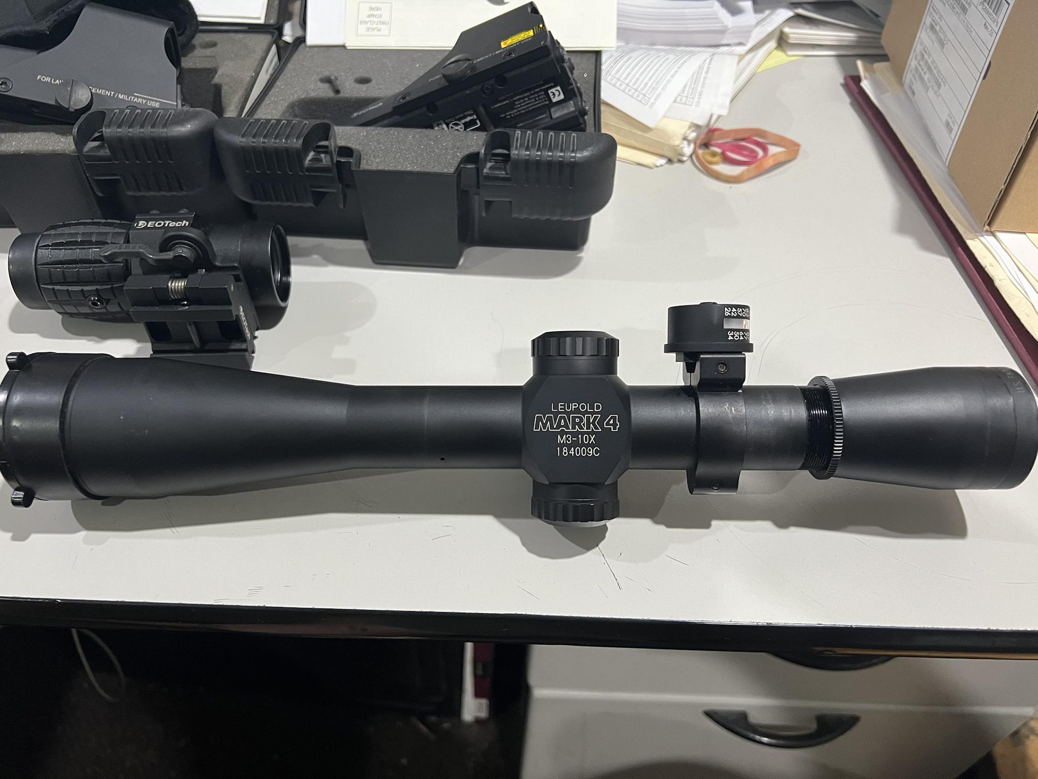

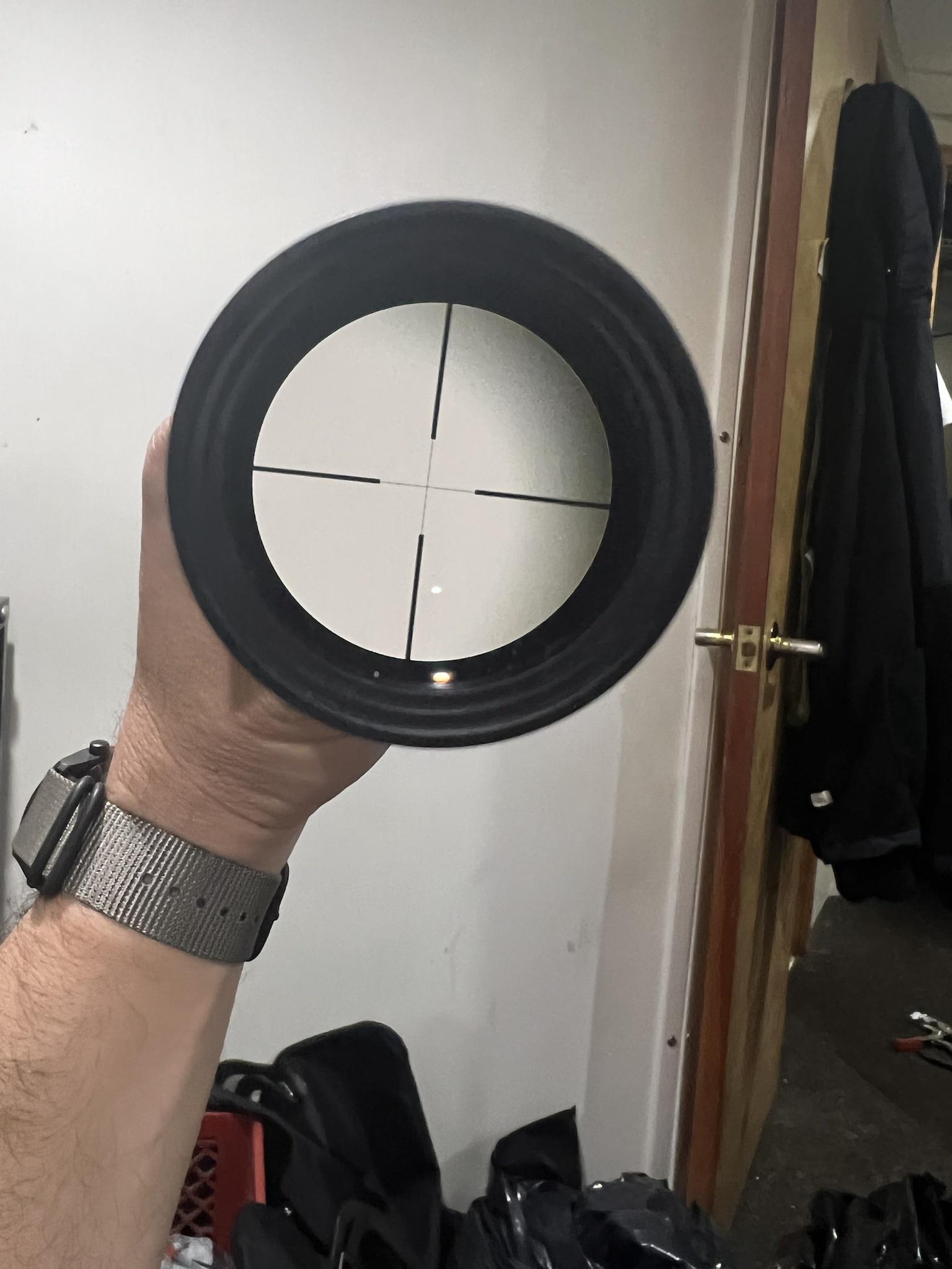

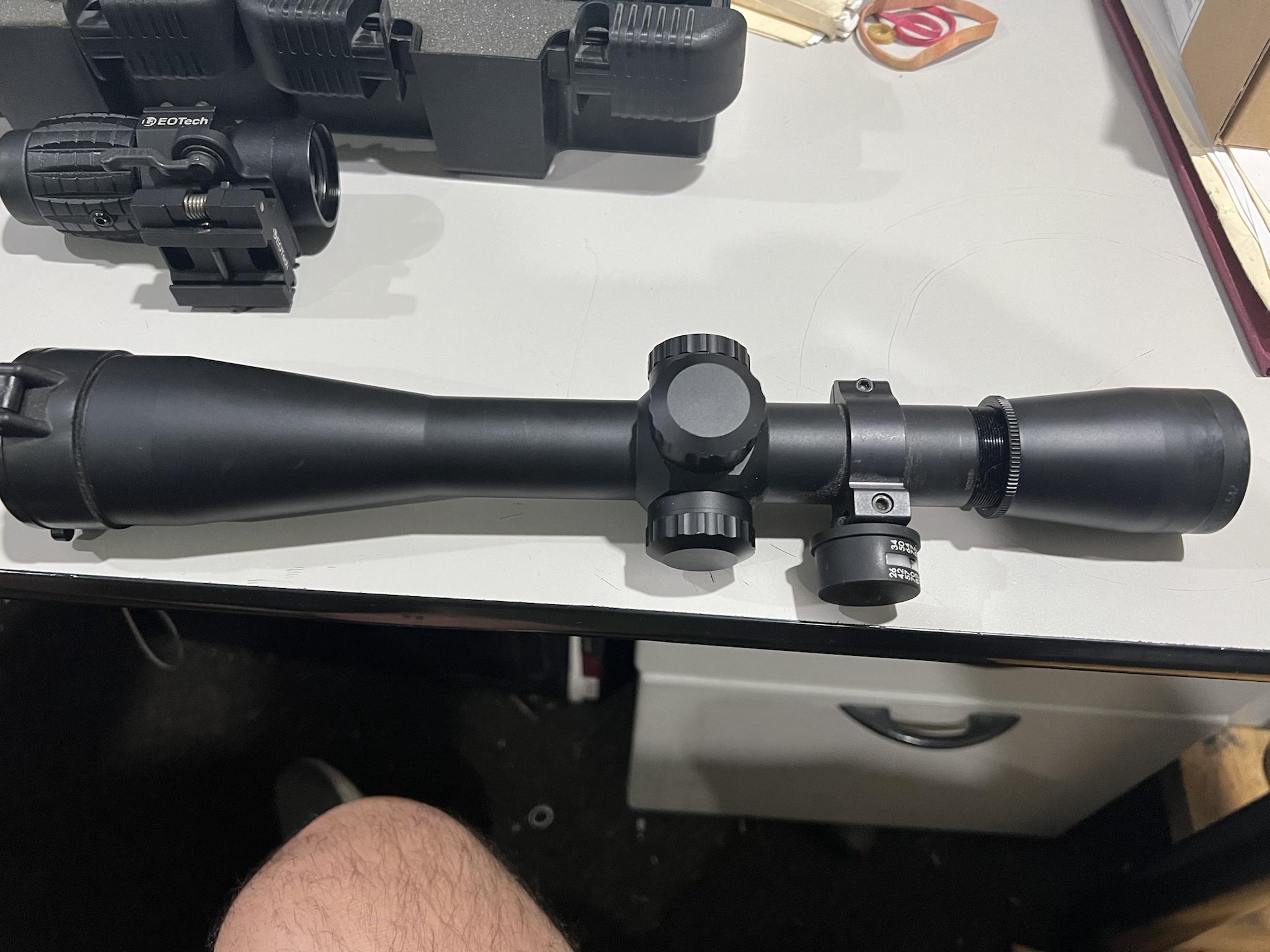

As far as the optic goes, the build post says:
Follow on contract scopes are marked
LEUPOLD
MARK 4
M3-10X
XXXXXXF
I'm looking at a C suffix serial number Mark 4 M3-10X, would that still be considered correct?
Have you asked them? I figured the thin Remington marked pad wouldn't be an option. I sure it could be unscrewed or peeled off and sanded thinner though, if one was so inclined.
I cant remember what I sold my 024 stock for. I think $700 with the bottom metal. It was an ASA model take-off though. I'm sure a M24R stock would bring a bit more.
Yes many have asked. Way back in this thread I believe.
ASA stock is the real deal. From what I’ve seen value would be good as any. It’s the same stock as all M24’s. There is nothing different on an ASA gun compared to any other M24 for the most part. I had not heard that ASA M24 not being the same as others.. I have an ASA and a Remy M24R. Serial numbers are the only difference and the stock is used issued.
The ASA stock I had didn't have the flat drop in the comb of the stock. I didnt even know it was a thing until Marco pointed it out to me when I was trying to trade him some stuff for it.
I dont know when, but at some point they did change slightly. I'm not arguing that it wouldnt be considered the real deal though.
The stock I had

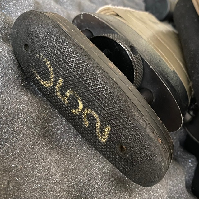

The M24 Rebuild that I have has some numbers written on the butt pad of the formerly issued stock. Does anyone know if this is common and if there is any significance to the numbers? Rack or team number perhaps?
Thanks in advance.
Sorry if this is already covered in this or some other thread, but I’m going to be lazy and avoid scanning through 24 pages of posts by asking here and now.
Thanks in advance.
Would it be the last 3 of the rifles serial number?
Team Number?
