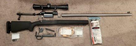

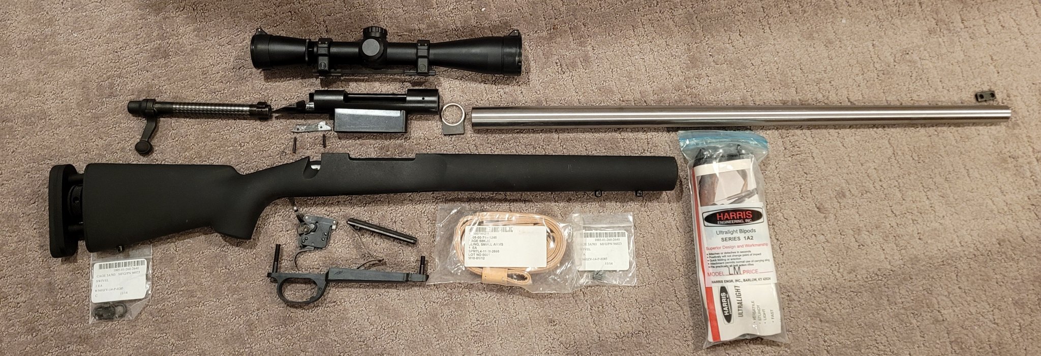

So, I have gotten a bunch of information from this thread for this build and figured I would ask all of your opinions, I have this "mini" m24 I put together from a remington defense barreled action I got earlier this year and am stuck on what optic to get, I was going to turn it into a m24a2 but I couldn't bring myself to turn down the barrel so getting a 7.62 rc2 for it. I've been torn between getting a medium or high mag mk4 or getting the correct scope for the mk12mod 1 and putting the mk5 3.6-18 on it since it already isnt "clone correct". Thoughts?
Reactions: ValveTech
It was already threaded from remington defense yes, but it doesn't have the turned down portion for the a2 suppressor. And it's a short action so still not technically correct, but has all of the proof marks from factory still so I want to keep it original
All parts acquired. Time to send this out to be built.

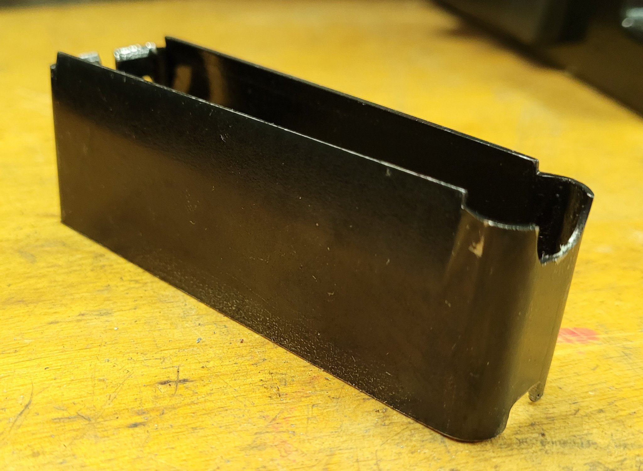

The ADL magazine box fitting was a pain. I ended up making a relief cut for the floor plate hinge. Not sure if it's correct, but it made repeated reassembly much easier.
How were the M24 magazine boxes coated?

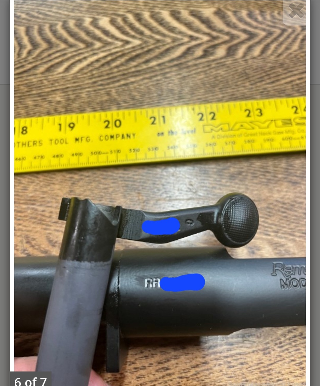

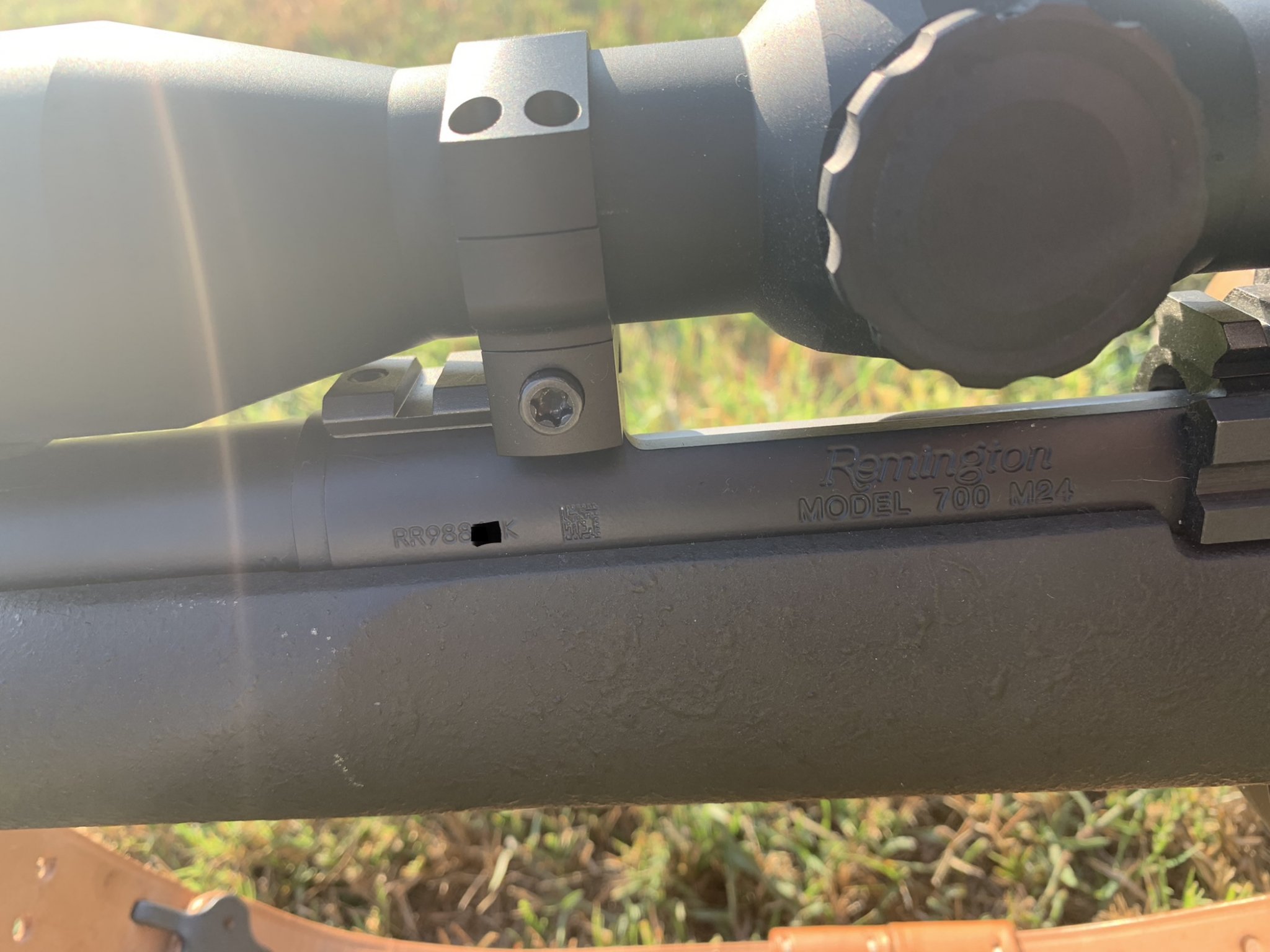

I bought my M24 from another member of this site. He said he purchased it from Arms Unlimited. Anyone know where they came from? Contract over run, commercial sales,etc? Or anyone know when they were built?
I bought my M24 from another member of this site. He said he purchased it from Arms Unlimited. Anyone know where they came from? Contract over run, commercial sales,etc? Or anyone know when they were built?View attachment 7912073
Remington may be able to help. Have you dated the receiver by the serial number? I'd guess police sale if Arm Unl was involved. Looks brand spanking new so it must have sit until a commercial sale...maybe?
You have to use the barrel to date the rifle. There should be two letters on the left side of the barrel, just ahead of the receiver. Use the code in the link.
The serial number helps too, but is not precise.
The RR prefix is a clear indicator that this rifle was built by Remington as part of the Re-Issue campaign. The barrel date code will likely put you into the 2013 or later time frame. I can't make out the 2 letters on the barrel from your picture but that will definitively tell you when it was built.
Barrel letters look like “WM”

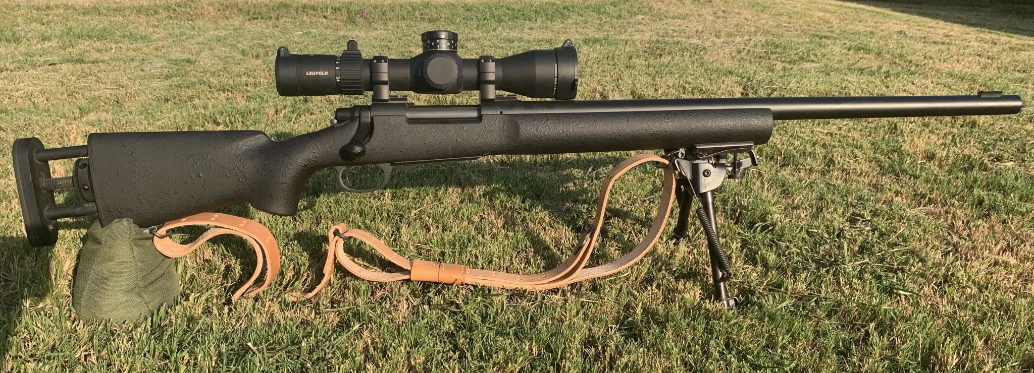

My first Re-Issue was a G built in 2010.
I'm sure mine is not "right", but I beleive it does take the top frog off the shoulder. I can double check this afternoon.
The sling looks nice on your M24.

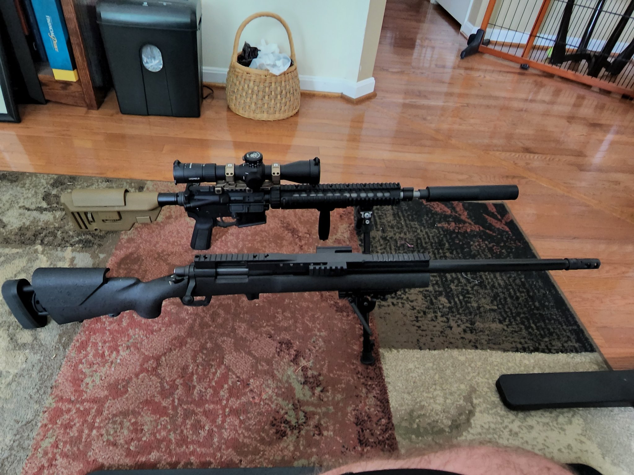

That's an awesome Mk13 build! I remember that stock, it's a very nice one with a lot of character! Ot looks like you still have the hang tag on the trigger guard, you can remove it, it's not original to the rifle. I added the to the stocks so that I'd have another place to see the serial number, instead of always having to look in the barrel channel.
Sorry for the side track everyone, just saw something awesome I wanted to comment on. Back to the M24 stuff, here's an extremely rare Talbot M24 QD mount (I only know of 2 of these mounts. I can't remember if I still have this one or if I sold it). It comes with 2 QD rails, 1 with the scope rings and 1 that's picatinny so that you can mount night vision or thermal. The respective mounts stay with their optics. Interesting concept, but it puts the shooter's head up way to high, literally a chin weld. It would be much bett with the M24A2 and it's adjustable cheekpiece.

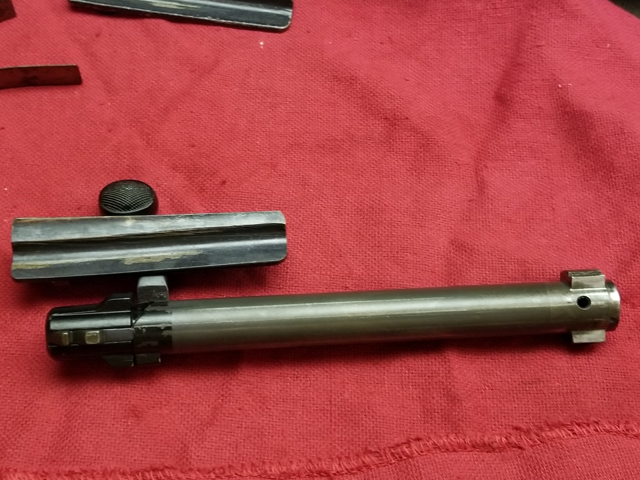

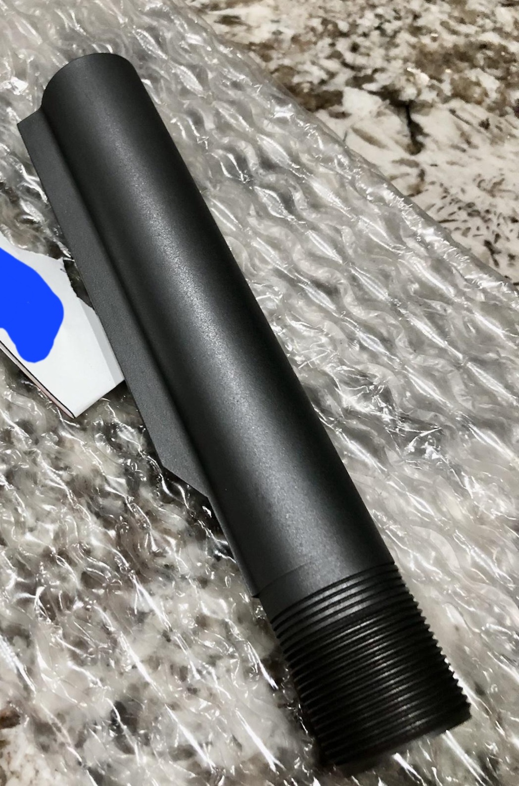

What type of finish is this,couldnt you just custom mix a batch of cerakote to get the color you want?
It's a dry film lube. At this point it's a question of do I want the correct color but wrong finish (cerakote) or do I want the correct finish but wrong color (Sandstrom #859-B26)? Unless I find someone with an old can of the B29 I am probably going to go with the correct B26 because for me for me for this project I want to experience Sandstrom finish and why it was used instead of something else. I am building an A2 from a C series U.S. stamped action, I am going for a rifle that would have been sent back to Remington for rework. If I change my mind I can always cerakote the bolt in the correct color. I am open to input for going cerakote from the start
I wouldnt Cerakote the bolt body unless you use something like Microslick, but that's also a deep black.
Sandstrom does make a gray colored #859 (they call it Urban Assault Gray) maybe that'll be closer to the old black color.
I did notice that some of the barreled M24 actions that hit the market this year have gray film lube on the bolts.
I must have glazed over that when I was looking. I will probably give that a try because in a lot of pictures I have looked that the original bolts do look more gray than black. Worse comes to worse I respray over it, it sticks to itself according to Sandstrom

Back to the DFL on the bolt, back in 88-89 it may have been more black than the gray of late.
My 1989 dated RR kit has followers that have a black/very dark gray DFL on them, I can only surmise that the bolts had the same coating.
Anyone with an original 1988 to early 90s M24 that can verify?
2007 E-Series bolt & follower. The location where "Rem-Tuff" proprietary powder coating has been applied on top of the Sandstrom dry film lubricant is visible.
I can not find any contractor documentation that superceded the original Sandstrom E-859-B29. A derivation of color change may not have needed approval?
So the entire bolt is Sandstorm coated, then Rem-tuff is applied to the bolt handle? Interesting way to do it.
