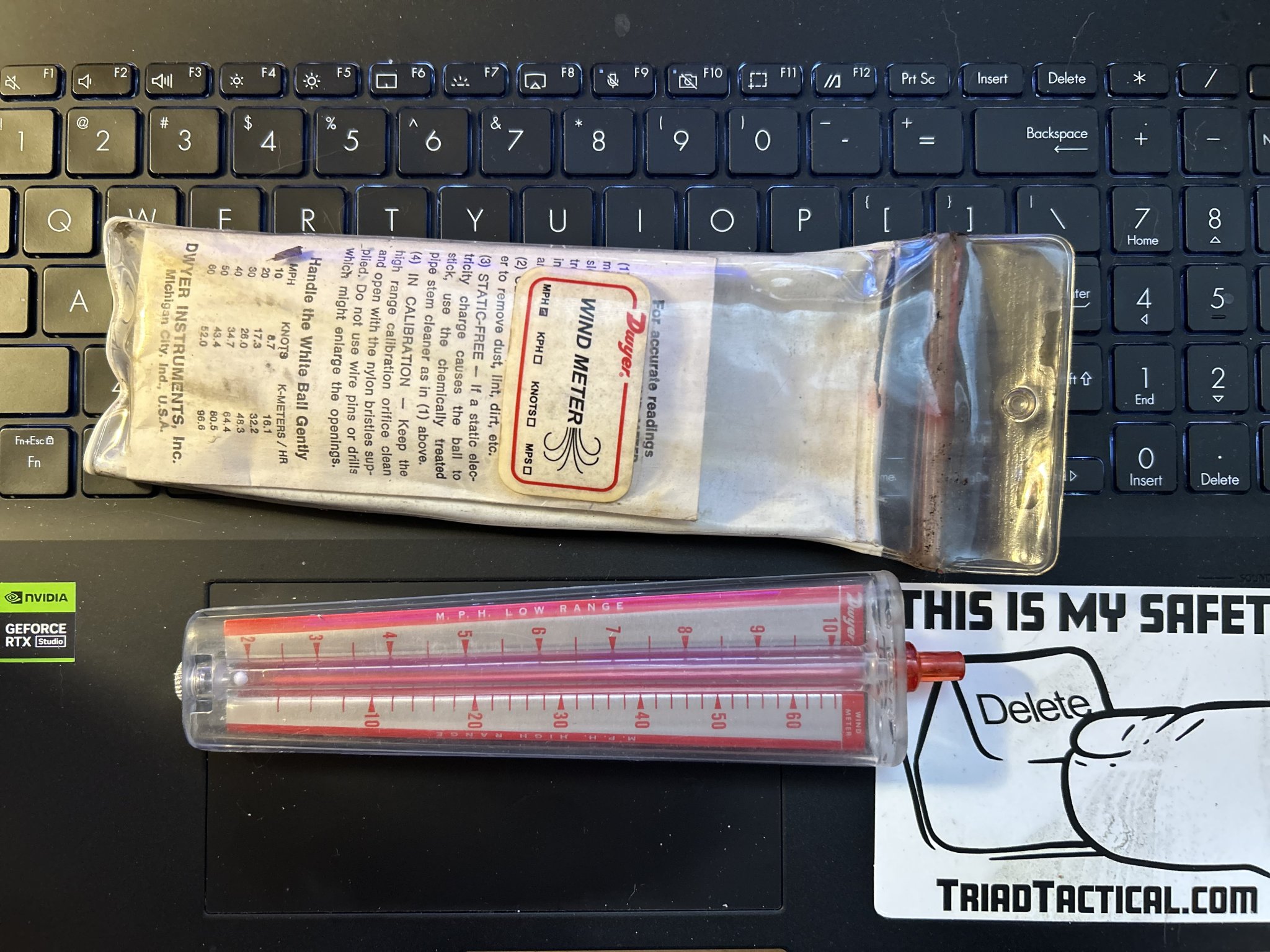

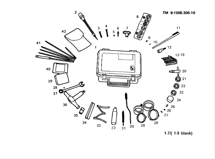

Anyone have info on the tools/parts/misc items kit?
There's a spot in the Hardigg case for a Pelican 1120. I've seen a few pics of what's inside the case.
Curious to see if anyone has a whole spare kit, or has a packing list, and I'll build my own.
You could make it authentic to how mine was issued with most of the contents missing. I don't think any of the three M24's in my platoon had completely stocked d boxes, even when we went to OEF.
Right. It's not very realistic for me to try and find all the little screws/bolts and whatnot.
I'll likely just get a case and fill it with the wrenches and cleaning tools. Everything that I can get practical use out of.
I'd hate to have had to sign a hand receipt if it included every last piece in it >.<

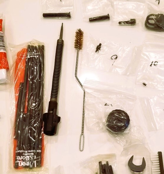

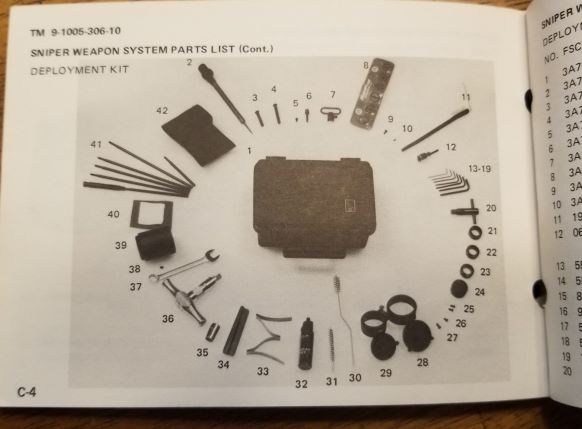

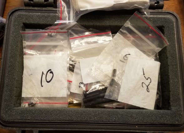

Yeah it will nearly impossible to gather up all the pieces as many of them are out of production. First off you'll want a Pelican 1100 not a 1120. They're out there on eBay every so often. The Cleaning Rod is a common M16 Cleaning Rod that was either painted black or DuraCoted. Same for the Toothbrush which was a standard M16 brush except that it was black, not painted but black plastic. The Oil Bottle was Breakfree. The Chamber Brush used to be available at Midway USA, Brownells and other places known as the Remington Chamber Cleaning Brush Remington 4, 7400 but I think they're gone now as well. It was an expendable item so they would have disappeared rather quickly in common use. Hope this helps some.
All the parts were in these little ziplock bags and hand numbered to correspond with the numbers in the TM.
This is a shot of the page from the original TM which was later converted to the sketch in the subsequent TMs.

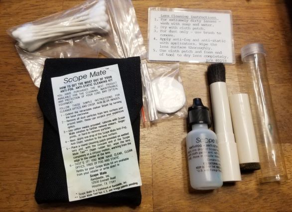

This is the Optics Cleaning Kit which is a real unicorn for certain.

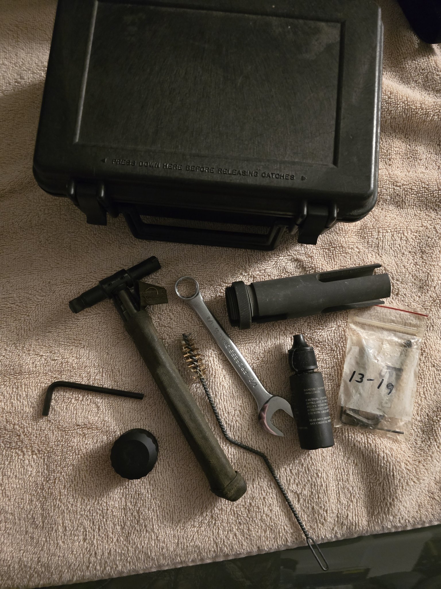

I originally planned on leaving my box empty. But then I came across 10 (of the 41 original items), in their numbered bags. So I now feel half obligated to get more parts =/

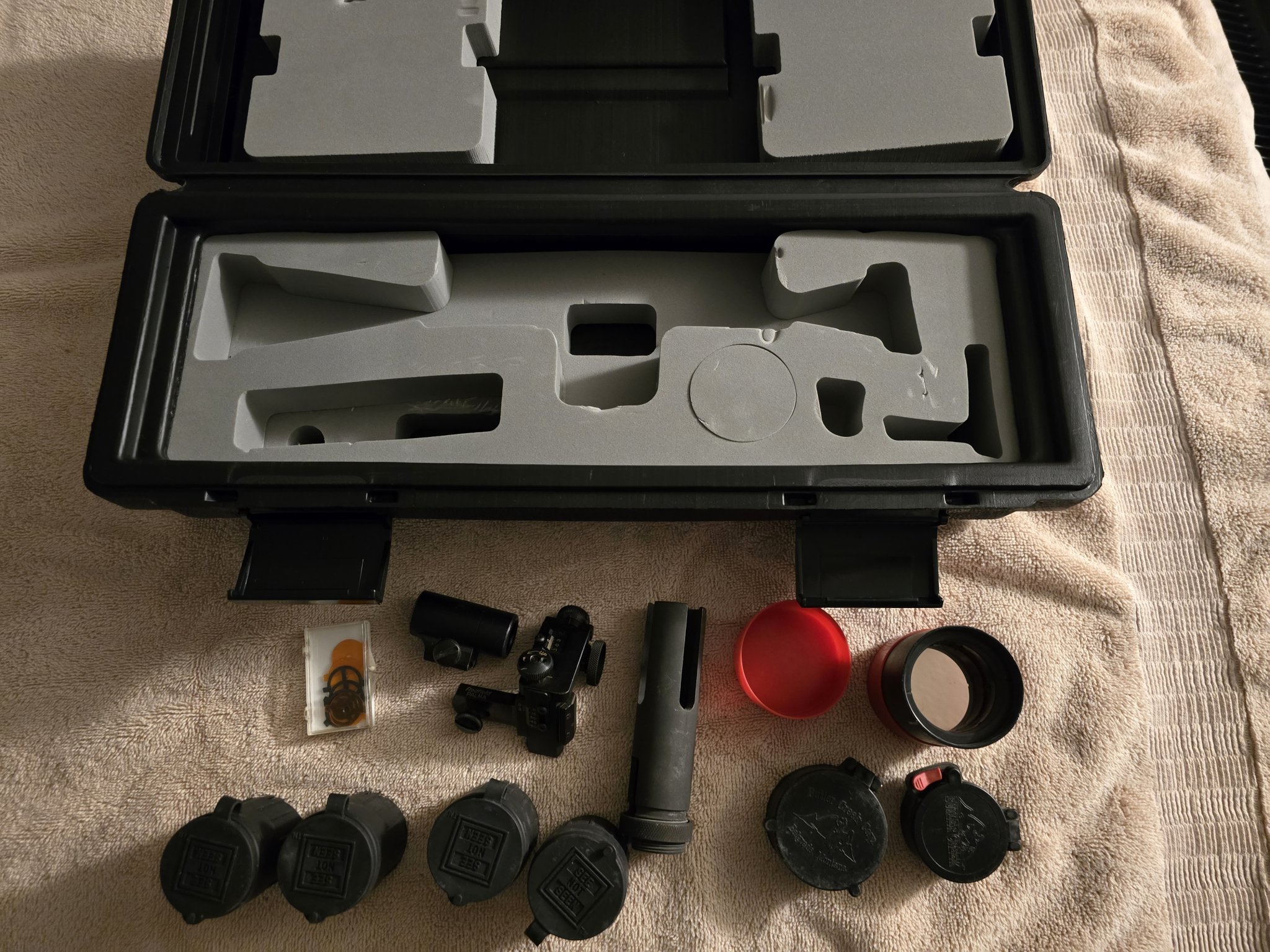

Friends, photo dump incoming.
I have finished (enough for me) my m24 day optics case and the tools/parts/accessories case. Both of which go in the Hardigg deployment case.

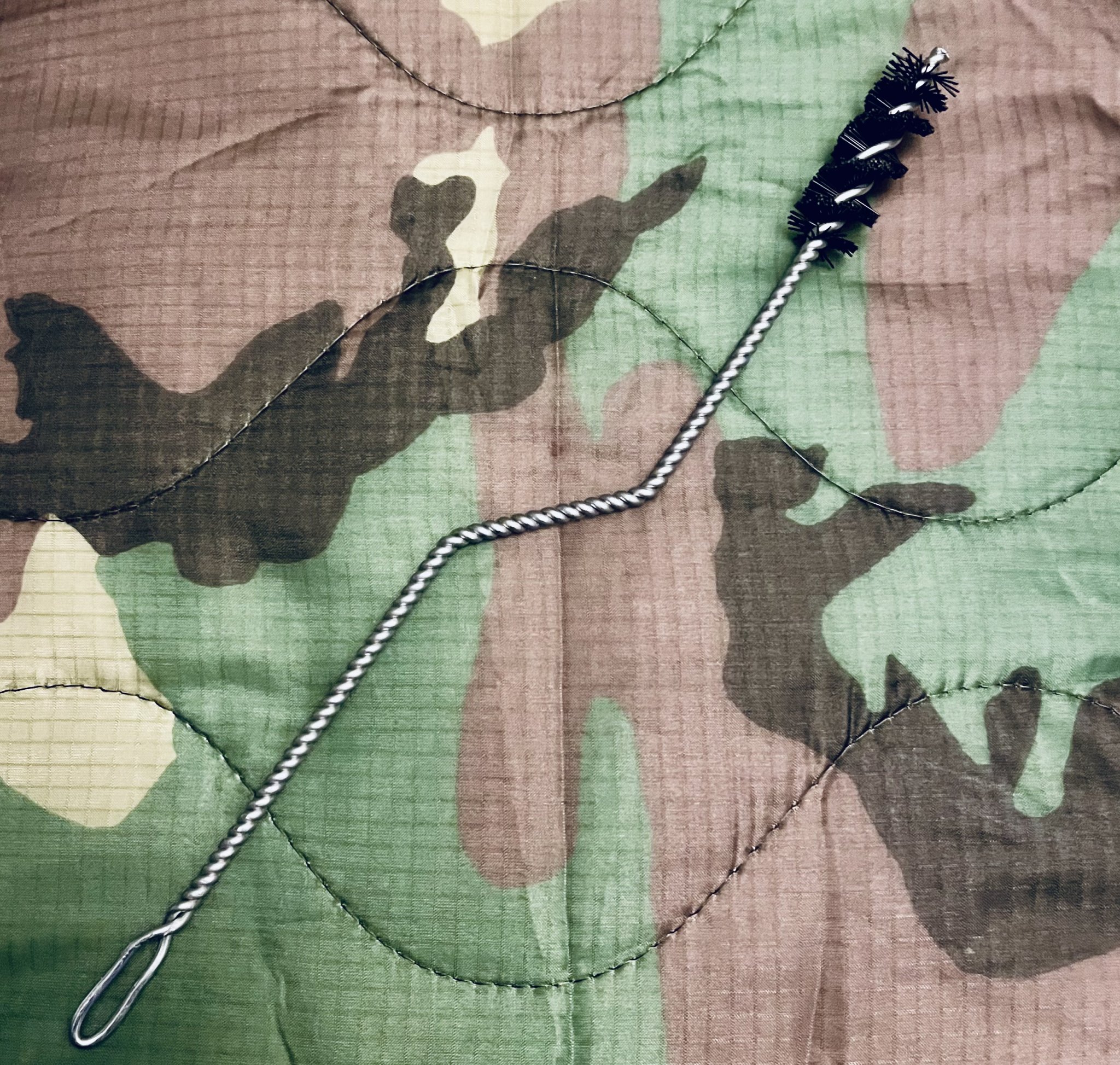

#30 Dog-leg cleaning brush

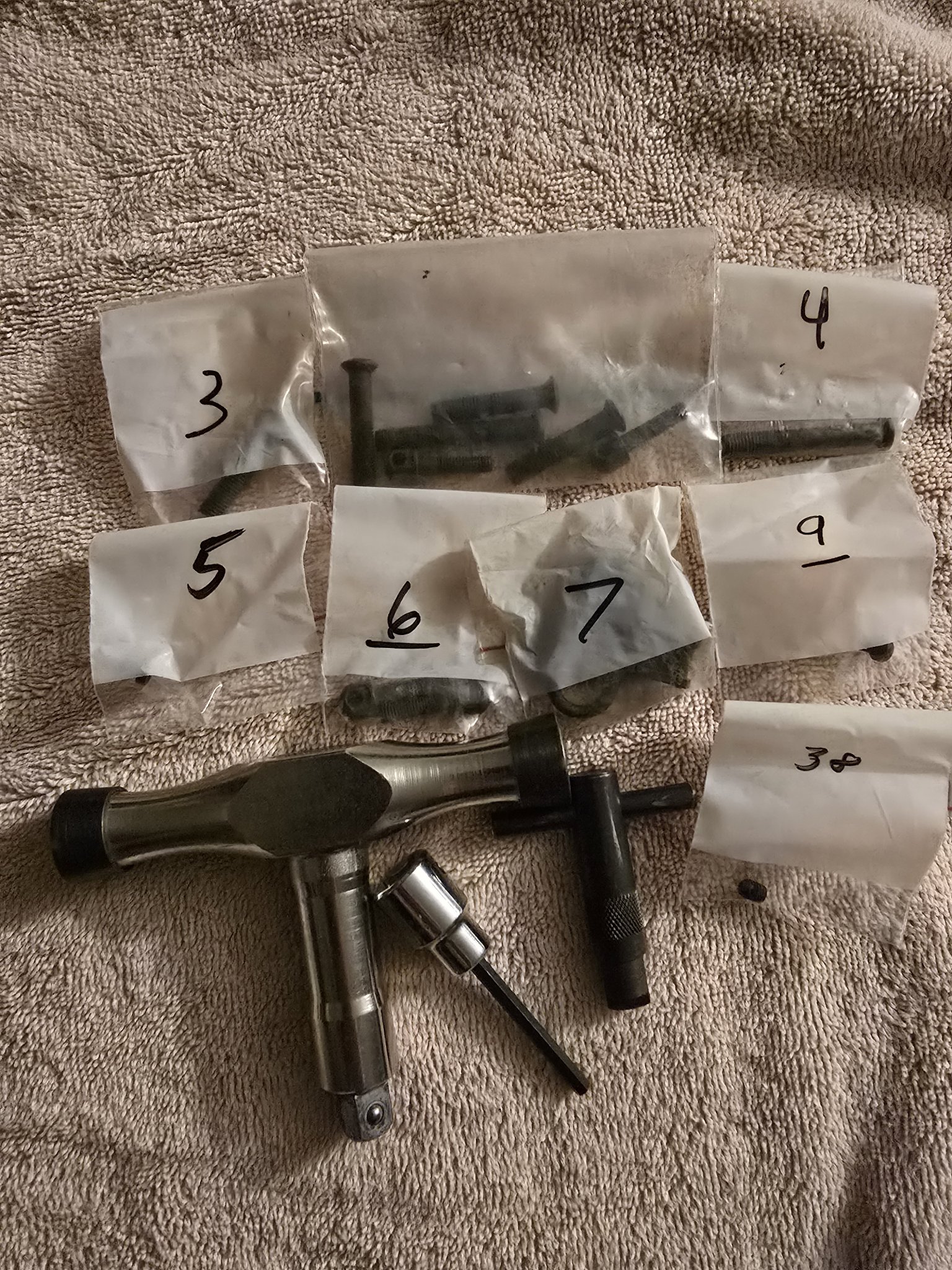

Numbered bags 3, 4, 5, 6, 7, 9, 38, (unlabeled bag that has what look like #6s and 3s/4s)
#36 Seekonk torgue wrench, 65inLBS
#35 socket with allen bit?
#20 T-handle combo wrench
NOS days optics case. Everything in here has been acquired from random places.
Apologies for the terrible picture, I can replace it if needed :)
Redfield front + Redfield Palma Rear irons, + little box of the (aperatures?) that came with them.
Flash hider + locking ring. Purchased from the awesome, previously mentioned, m24 armorer.
4x M24 binos ARD rubber caps (I believe)
2x butler creek caps. They came in my Hardigg case. (I think they're #28 and 29 from the list)
1x The EMA filter thingy. Also came in my Hardigg.

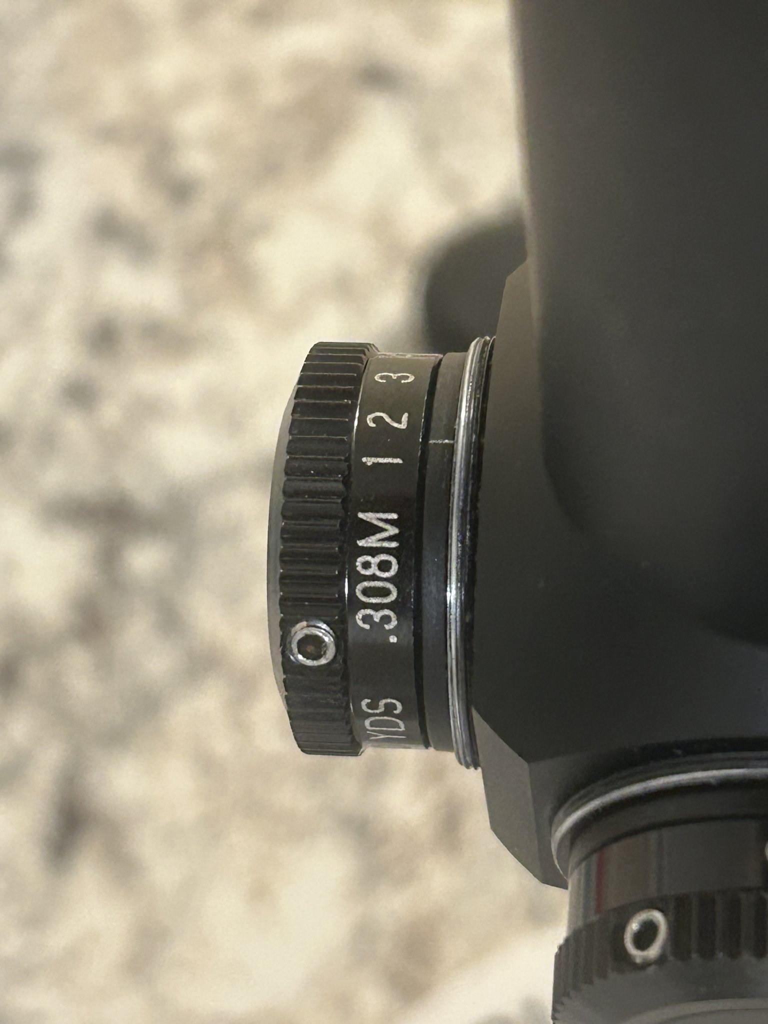

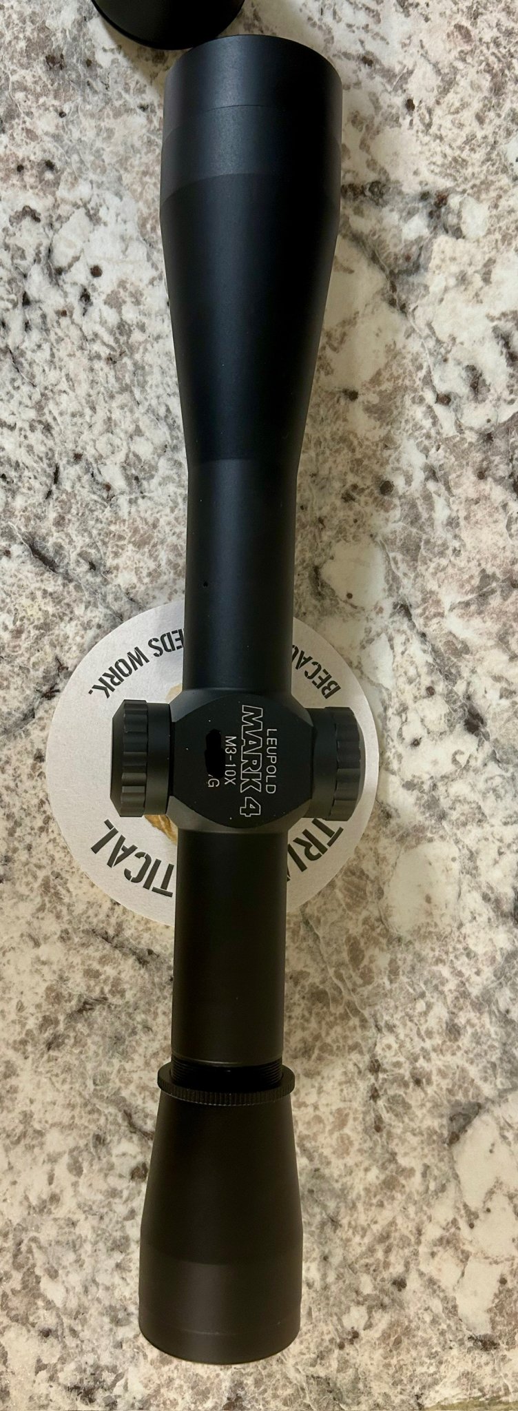

599+tax, got it for 525. I think I did well. 1999 vintage, has a mildot reticle, turrets are nice and tight with good solid clicks. Came with the sun shade. Dropping it on my m24 Sunday. Hopefully nothing is locked up…
Wow, nice swipe. You paid less than I did back in the 90's.
Leupold & Stevens will lifetime warranty those scopes unless it needs parts they no longer have in stock. Run it through a box test at your range to confirm its tracking correctly. And give L&S a call to ask if they can send you an owners manual. I just shipped them an old Vari-X II that developed mildew inside the front objective lens. Word is they just semd you a brand new scope thats comparable because the labor to rebuild costs them more

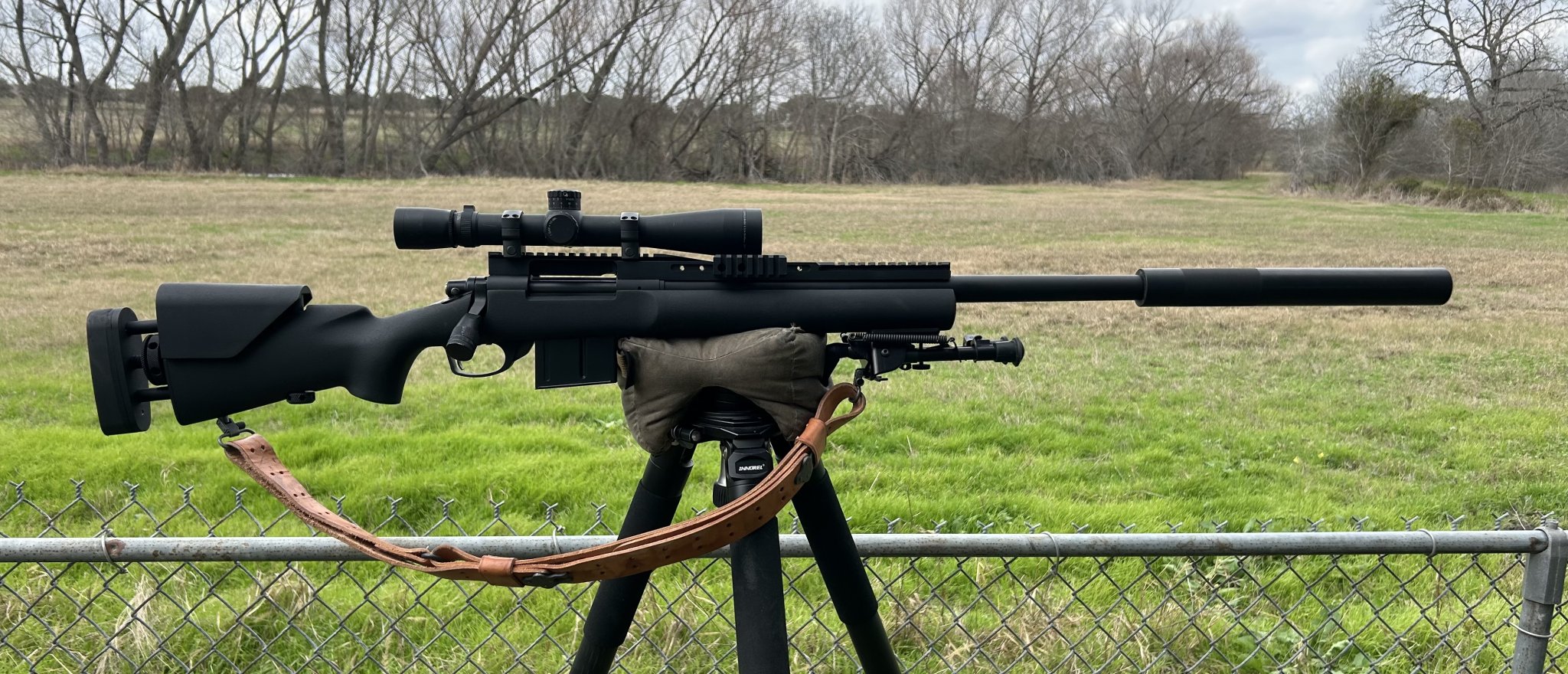

Back again friends!
Just picked up my GA Precision M24 (ordered December 2023).
Tossed all the required stuff on it: Eagle Industries cheekpad/ammo thingy, M1917 sling on M24 swivels, Harris 1A2 9-13” bipod, NSN packaged Leupold Mk4 rings, R suffix Leupold Mk4 fixed 10x mildot reticle, SIMRAD ring cap.
I'm still missing my rear irons base plate. Should have it this week.
(Yes I wish it was an original gun......but that's next on my buy-list!!)

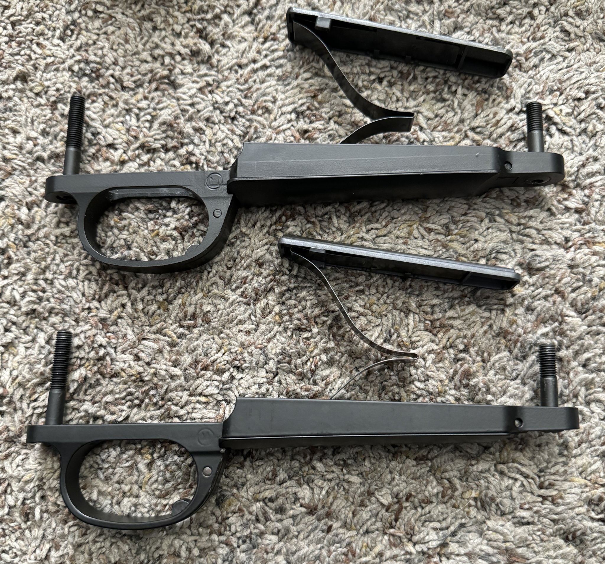

Thanks to all of the thread contributors for the good reads! I have a bottom metal question… I have 2 of these M24 takeoff Dakota bottom metals. I’m trying to figure out why one has H stamps in it and ultimately trying to figure out which one is older.

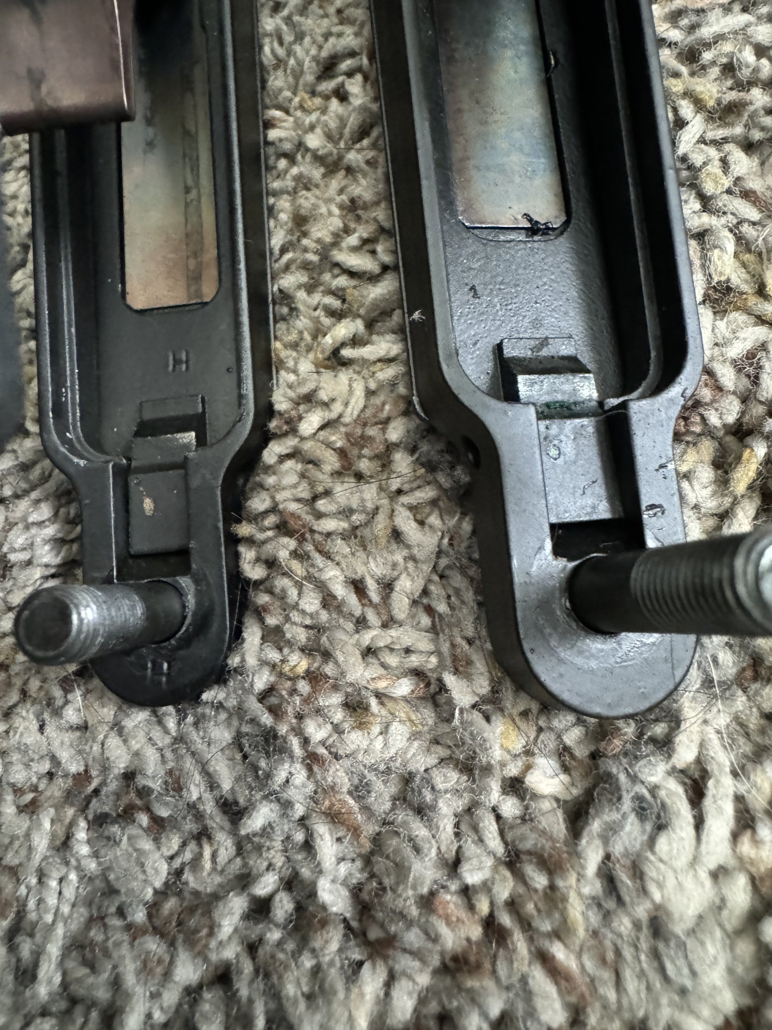

The one with H stamps (the bottom one of the side profile pic) came off a Remington rebuild gun from 2013-ish as an FYI and seems to have a thicker coating.
Two things I want to point your attention to:
1) is the low point of the center of the M in the magnaflux inspection stamp. The M on the H stamped bottom metal from the 2013 rebuild civilian gun is the same M on all of the Remington parts I have, bolts and barrels. The other is the outlier. Is it possible that’s an earlier part from Dakota? I don’t know the history of Dakota and it’s affiliation with Remington over the years so just a thought.
2) the H stamped bottom metal has a smooth floor plate release button (with an H stamped on it as well) whereas the other has some knurling…
