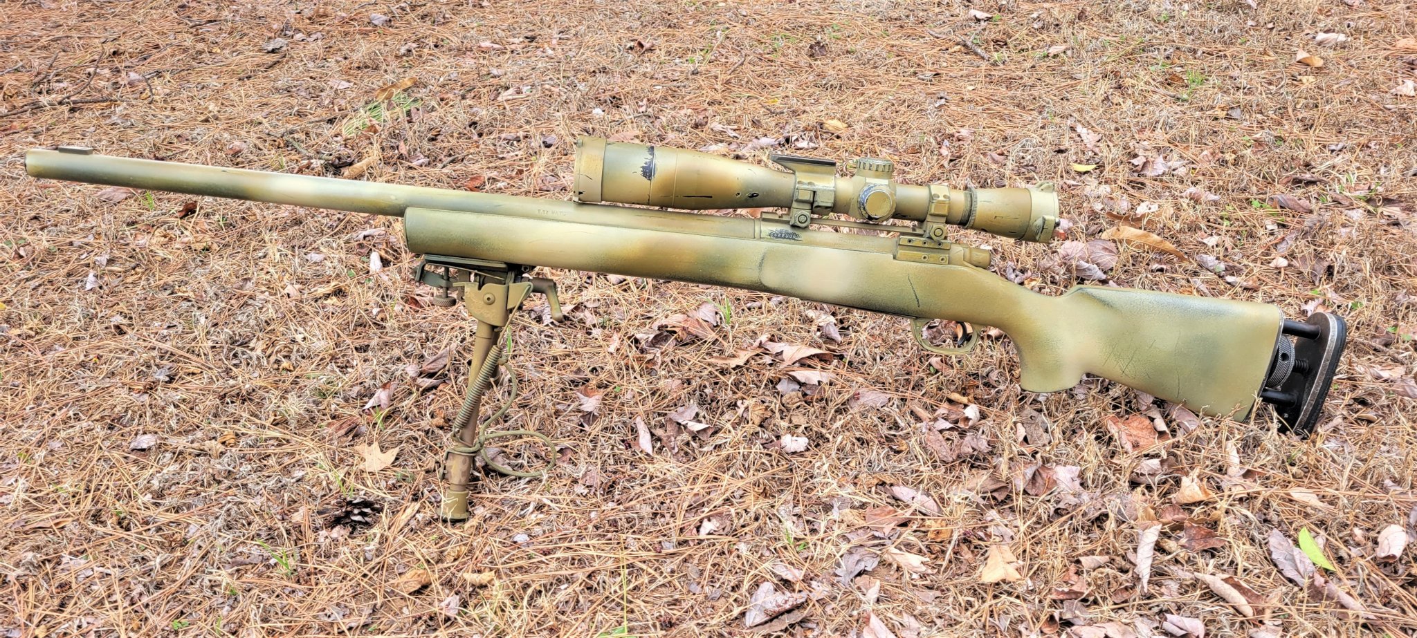

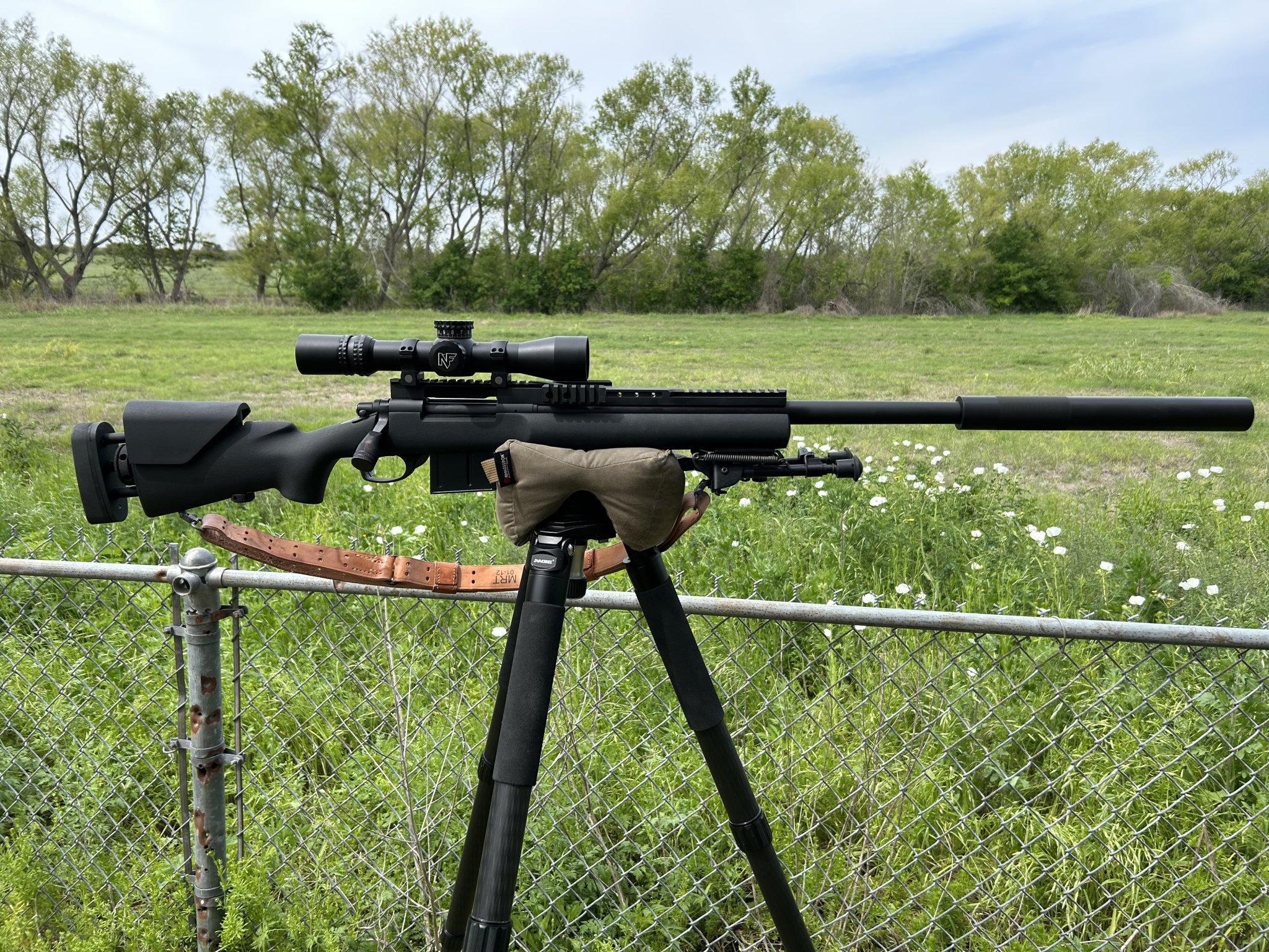

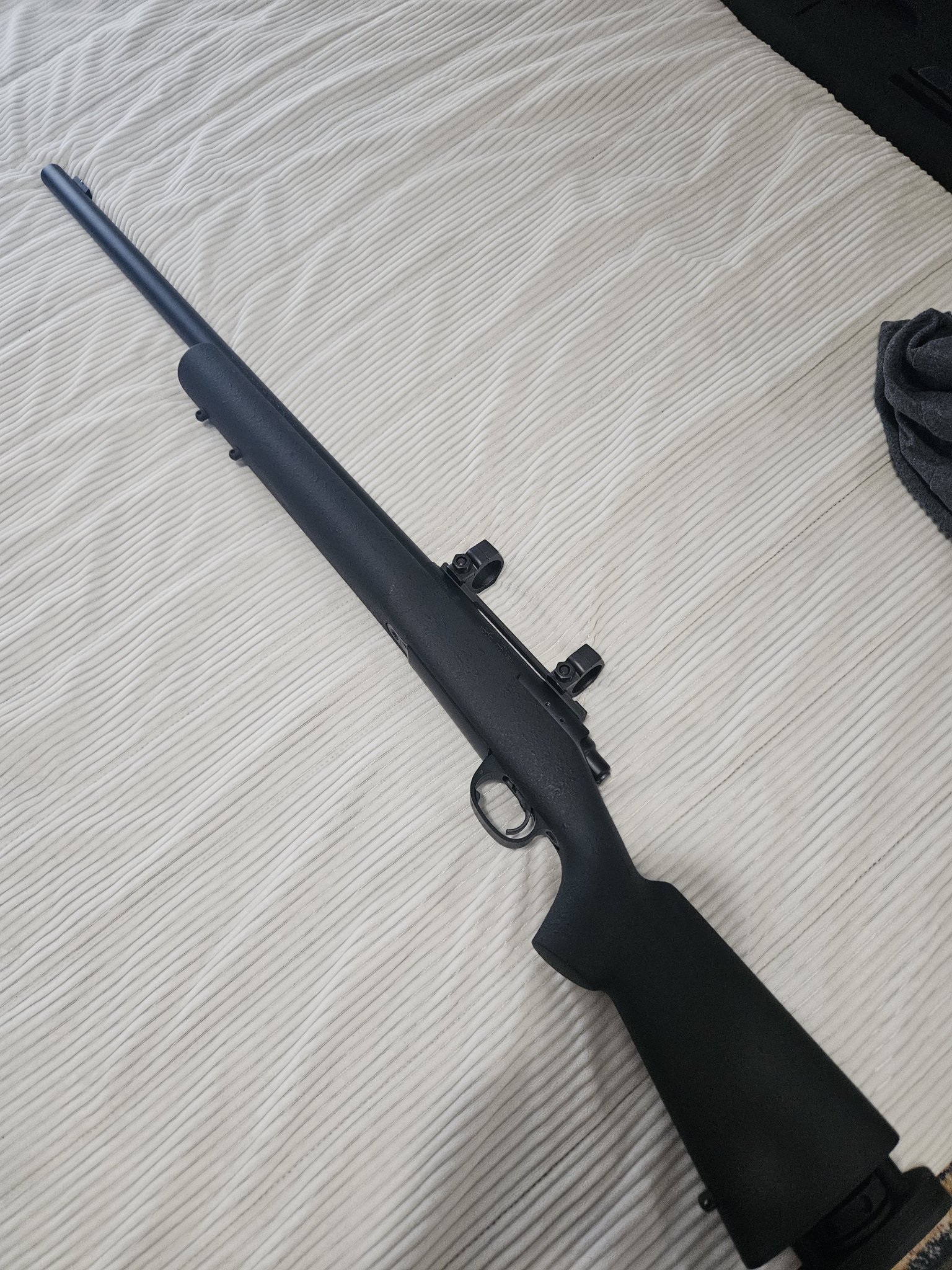

Not the best picture (been on the road a lot and haven't taken it outside, yet), but I finally got hands on the M24 I asked about a few pages back. It's in beautiful shape, RR prefix. I've got everything except a true Redfield rear sight base and correct L&S optic. I grabbed a rear sight base from Freelands in the meantime. Hopefully with this next work rotation I can grab one when they pop up on here.
I'm not 100% sure I'll end up keeping it. I need to finish getting my LO setup for USPSA as well as keeping money to get a business project off the ground.

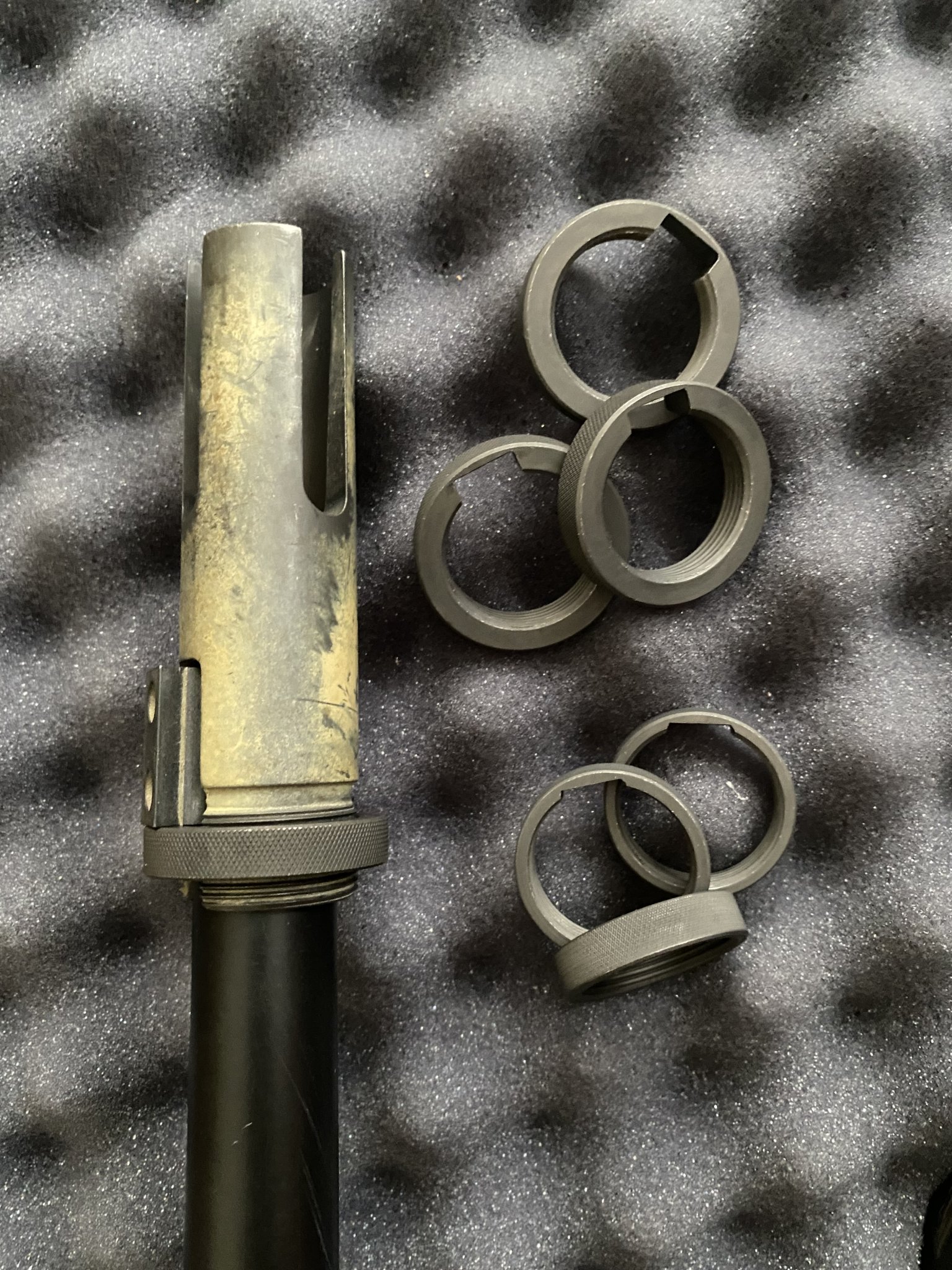

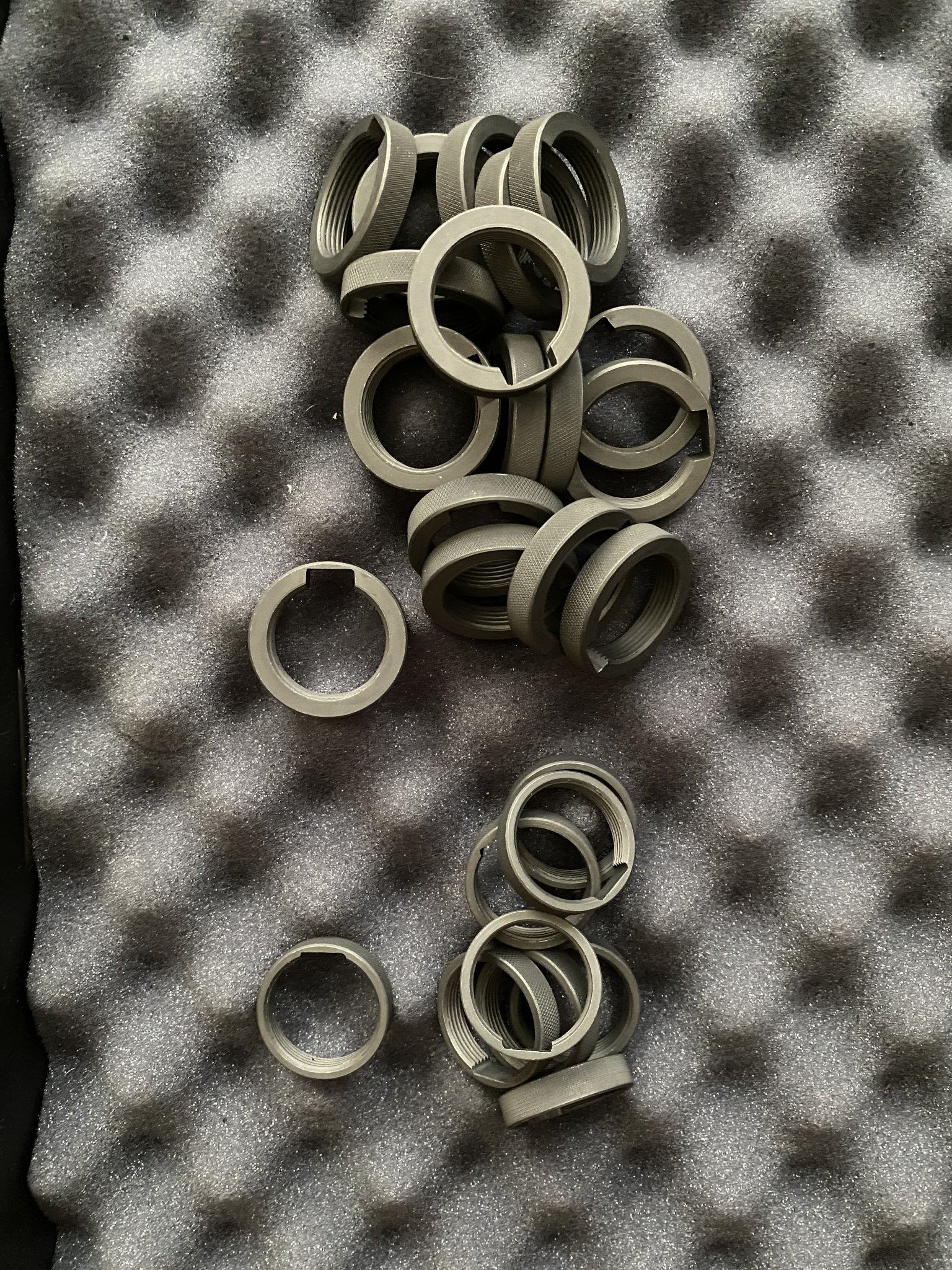

Anyone know where one can obtain the bigger lock ring for a M24 flash hider to use with barrels with the taller OK Weber front sight base? I managed to find a M24 flash hider, but it has the original lock ring for barrels with the shorter Remington/Redfield front sight bases. Thanks in advance.

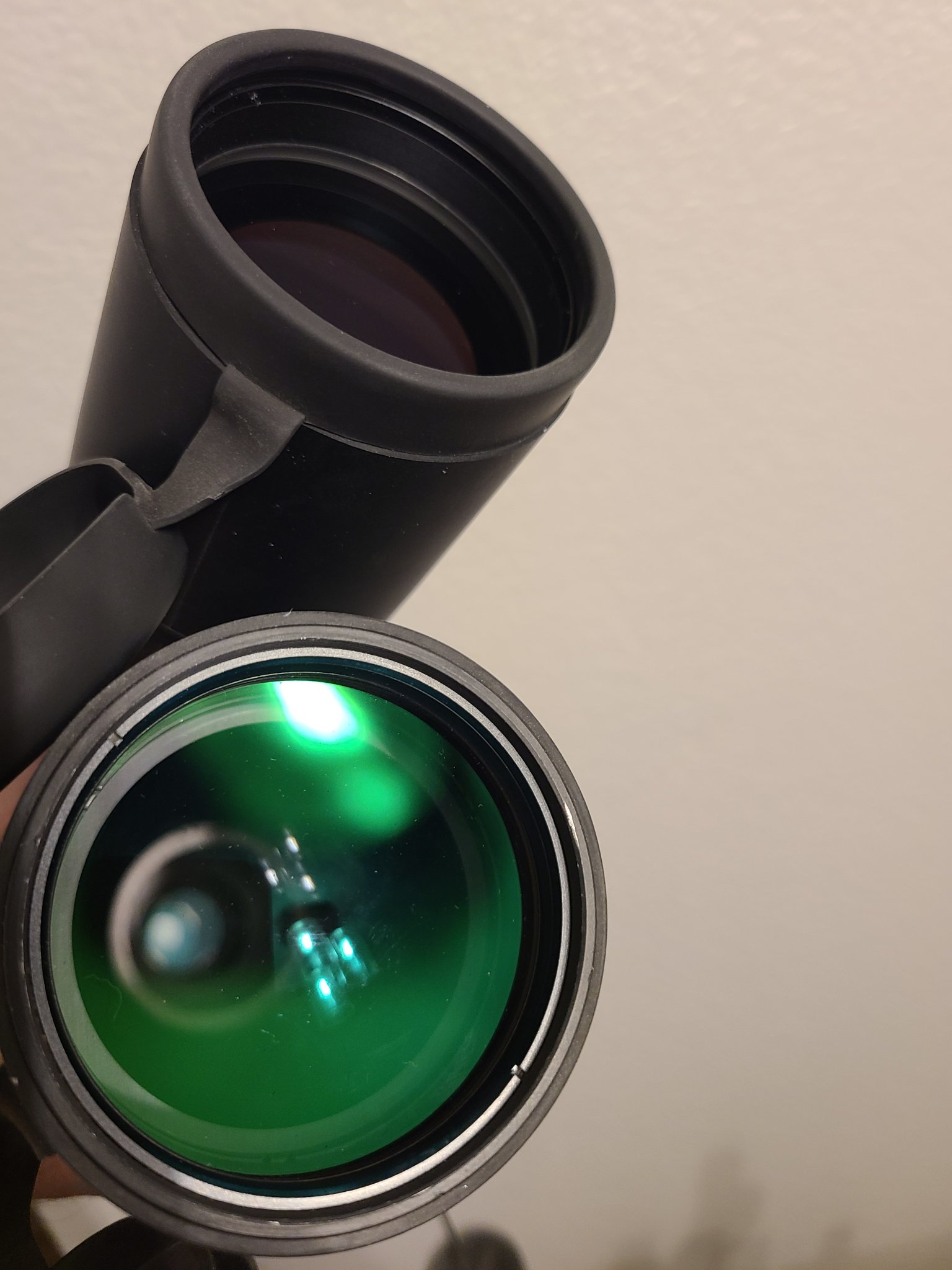

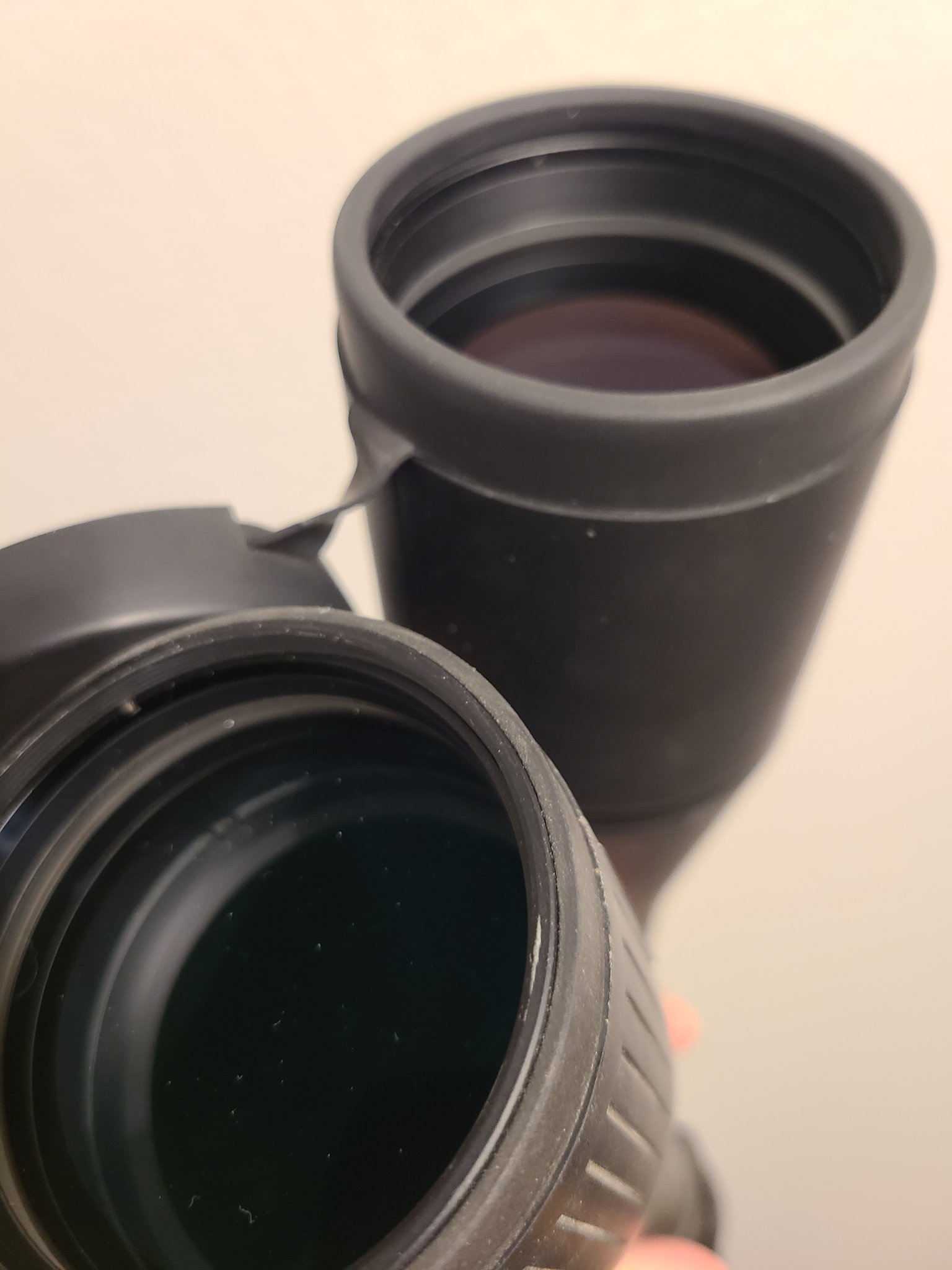

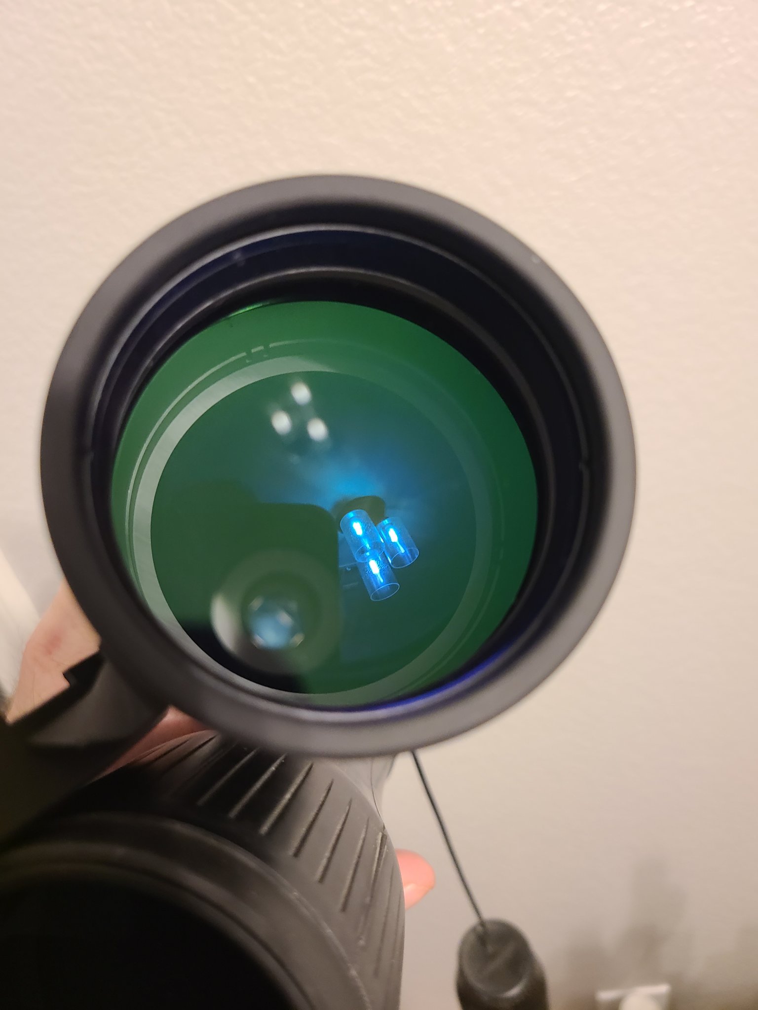

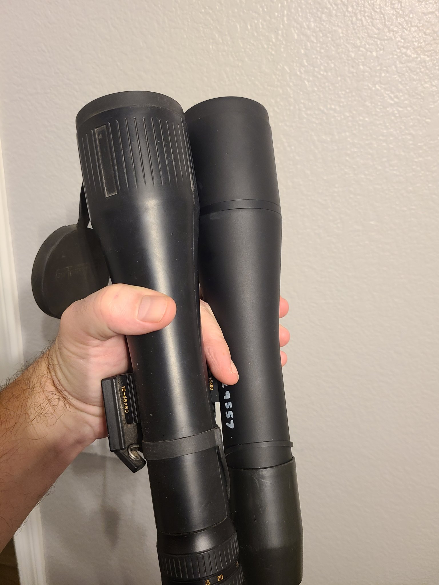

I am trying to find out eye relief distance, real and apparent FOVs of Leupold M3A optics. Could anyone assist me with that?
Since there're so many specialists (it seems) on the early deployment SWS in this thread, it seems to be the best place to ask, but correct me if I'm wrong.
Many thanks,

You know the funny thing about those flash hiders is that when we got them no one knew what they were because they came through the supply channel long after the guns were issued. It took some time and then someone figured it out. I ran all of our sniper training and was running a course and doing a night fire when someone attached one and used it. I was very impressed at how well they worked and I still have one to this day.
Oh and I should add that they didn't work when we got newer rifles with the RPA sights because the front sight block is much taller than the Redfield. I told the Sniper PM from Picatinny about it years later after I had retired and was working for RAC and he was completely unaware.

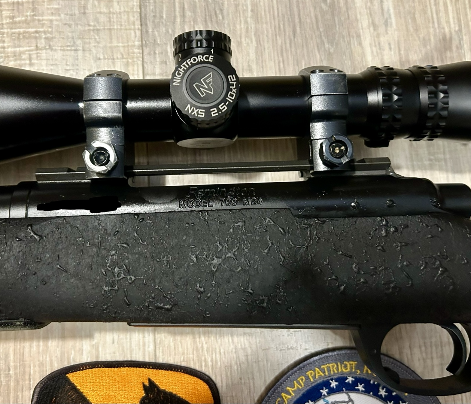

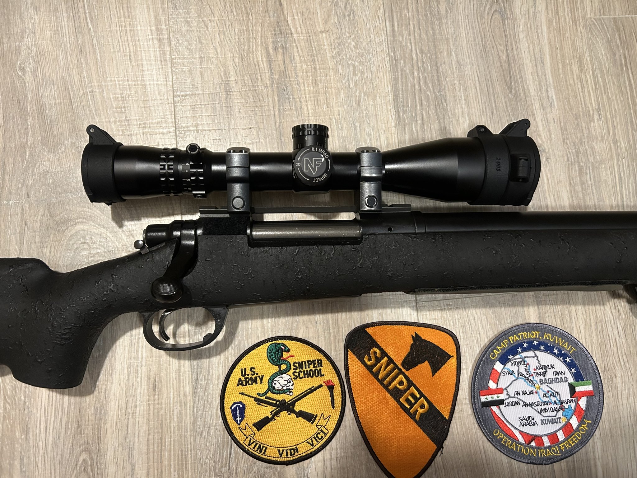

Shooter 24 is done enough, grabbed a badger 1 piece mount. ASA receiver/bolt (bought from a friend), M24 trigger, sunnyhill bottom metal, correct follower, ect. Has a douglas barrel, and a modern scope, shoots well…I keep thinking of selling to fund an A1 build but just like the simplicity of it..
View attachment 8513365View attachment 8513364View attachment 8513363View attachment 8513362
Great! I snagged one from Euro resale and can't wait to have it delivered! I am a big fan of the slim shape and simplicity of the original M24! I can build a much more modern and better tactical bolt action or PRS tack driver if I want modularity, but THE M24 is irreplaceable.

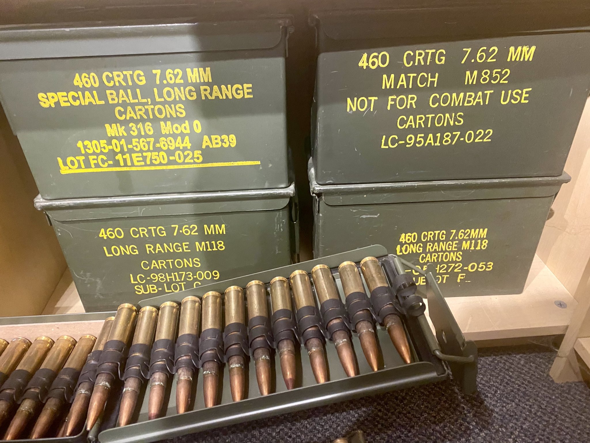

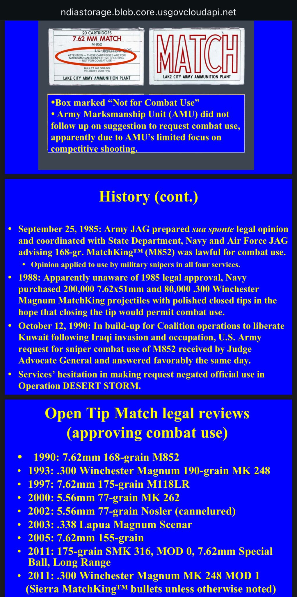

COL Hayes Parks' determination (as the DOD Staff Judge Advocate) that M852 (and Match King-type open-tip munitions) do NOT violate the Hague Conventions wasn't written until the late 1990s.
It wasn't the USAMU's failure to request approval for combat use (remember, the USAMU established the sniper mobile training teams that instructed in Vietnam, then post-war through 1987 when Fort Benning established the infantry's sniper school).
The Army's Tank Automotive and Armament Command solely (slowly) determines whether or not a weapon or ammunition item is designated and adopted as Army standard and safety approved -- one of the reasons USSOCOM uses the Navy's Surface Warfare Center at Crane for small arms and ammunition development, testing, and safety certification.
USSOCOM didn't exist in 1980-87 so all ammo development would have had to have gone (slowly) through Army.
Note Random Guy's slide above -- Mark 248, MK 262, MK316, and MK248 MOD 1 are Naval ammunition designations for ammo developed for SOCOM. I don't know if Barrett MK22 sniper ammo is "M" or "MK" designated.
The shorty SR-25K is a good possibility. I just never saw any documentation or drop charts for it prior to Radom Guys post. Still got half a box of them sitting from like 30+ years ago. Used to reload for my SIG PE-57 (semi StGw57) in 7.5 Swiss because it duplicated the Schweizer Armee standard round.
  • Love
Reactions: sinister

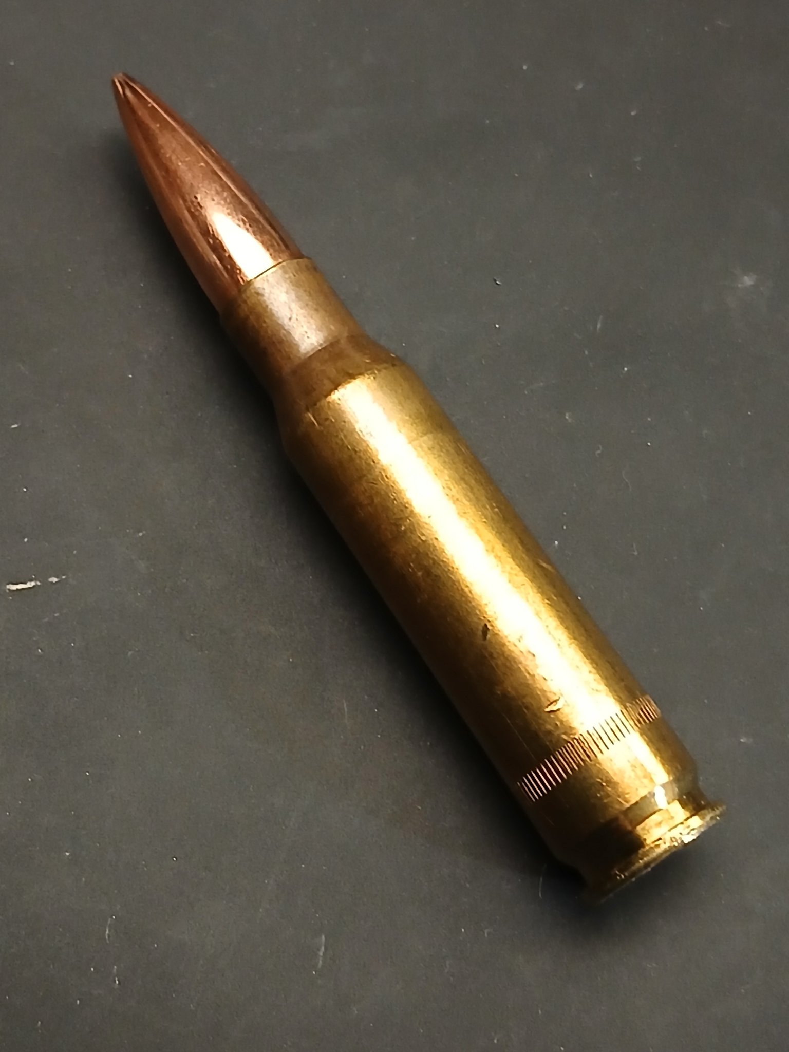

On 7 May 1980, the Special Match cartridge, PXR-6308 was type classified as limited procurement, and fabrication of the 200,000 round 1980 National Match lot was initiated. This lot, designated Lot LC-80F-300-S111 was delivered to Camp Perry on 10 July 1980, one week ahead of schedule.
…I was able to acquire one of the original boxes from that first batch of M852 back in 1980:

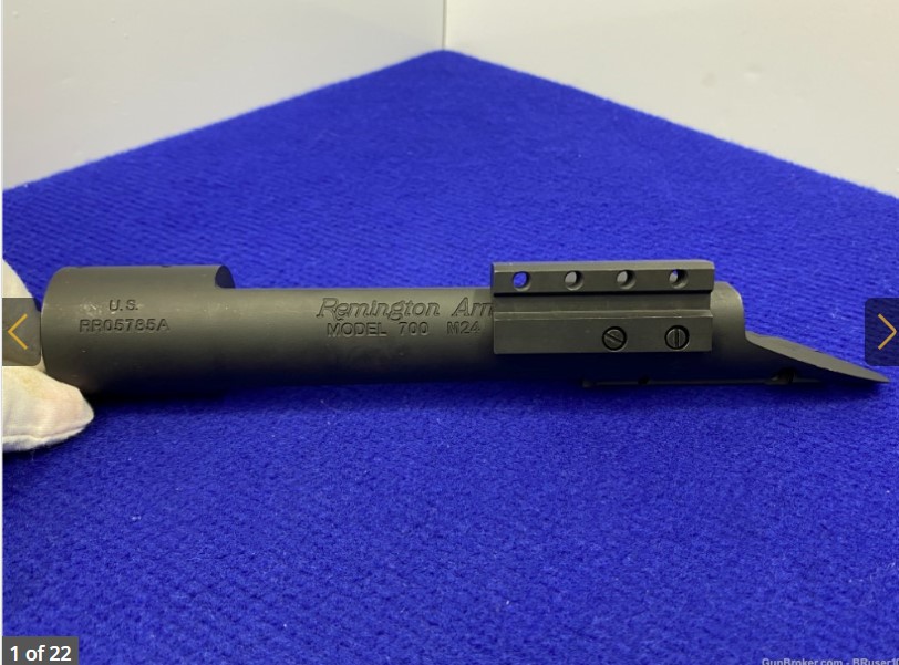

@Scopes ”fake”. It’s a Remington 700 receiver, but PTG has added the “M24” and as @Mister Ridge noted, added the “Arms” to avoid it being off center.
ETA: the seller can’t even make sense of their own description, Remington Arms marked receivers didn’t exist in 2020, yet they claim it’s pre-2020 stock.
And that Palma Mount isn't correct either with 4 holes on top.
