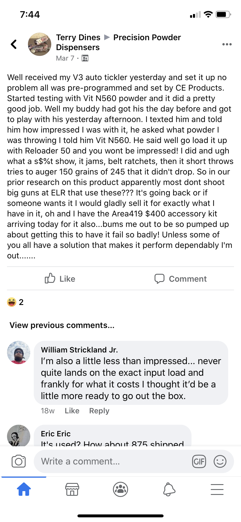

What powder were you throwing I follow a precision scale Facebook group and this negative Nancy was taking how he couldn’t throw N570 and how he was lied to and the autotrickler didn’t work as promised.
I was throwing N565...which is minutely...and I mean minutely smaller than N570. One kernal of N570 probably weighs 0.03gr....so if he can't get it to hit exactly on his target...gee..I wonder why? I got lucky and guestimated the angle of the trickler pretty quick...and I had a slight adjustment on the speed bar/switch on the rear.
What was his complaints?
I just went look to see exactly what his complaints were but he deleted the post but it was something about N570 gumming up the auto throw and that he couldn’t throw like 100 something grains.
Well....he may have a complaint on not being able to throw 100 grains....I was really far out on the adjuster to just throw 75.5....it may not be able to throw that much at one time...that is a hell of a lot of powder. But gumming up?....nonsense.

I found it

it was reloader 50 and he tried to dump 245 grains
When I get back from my matches...I'll play with RL-33 and RL-50 in it...see what I get...but I'm not silly enough to try and dump 245grains...it does come with manual manipulation of the throw. Maybe....just maybe...throw 80gr three times...and then trickle up
I was just curious because he was talking about shooting ELR and I now the 300 PRC is used for that and just wanted to see what you were throwing and if you had issues.

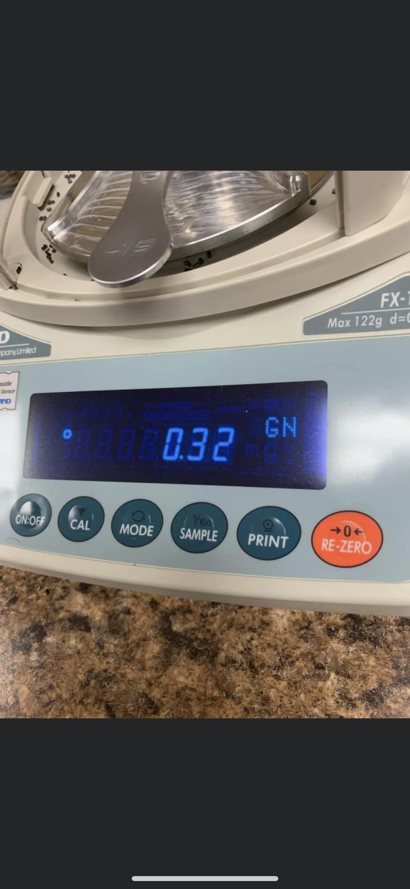

with varget one kernel is 0.02gr per the scale I have
Remember the scale is only accurate to .02 grains, so that kernel might weigh more or less. The scale is only going to show .00, .02, .04 etc. You would need a scale that goes out to .001 grains. It does however measure to .001 grams, so I wonder if converting our loads to grams would squeeze out that last little bit of accuracy? In the end I don’t think it matters and Adam put up a good article about .02 accuracy on his website. When I get mine it will be something I play with, because I’m a curiosity kills the cat type of person.
