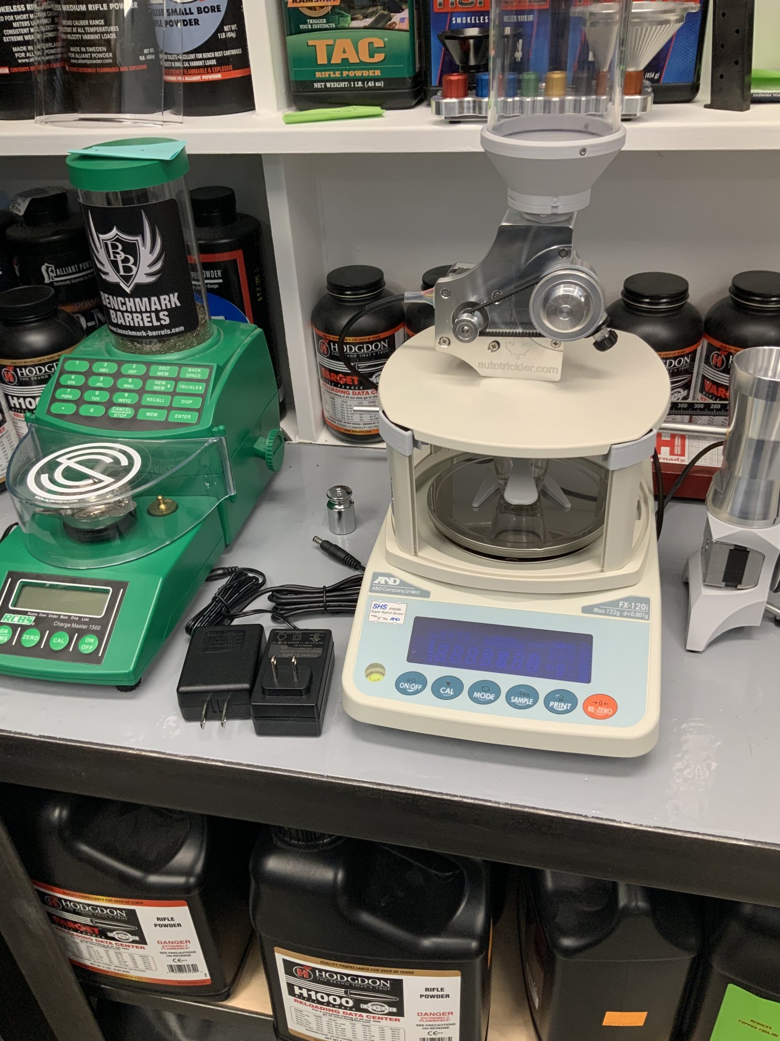

It's worth the wait. I've already loaded 500+ rounds with my AutotricklerV3....and man does it make me more confident in every shot I take. I can weigh down to the individual kernel of powder and my Standard Deviations (SD) are incredible now. An SD of 3.3 when using 78 grains of powder is....well to me....insane....on a 20 shot string.
I just loaded 100 rounds for a match this morning and I fought with my fucking Lyman Gen6 the whole damn time... your comment is reassuring. I should be paying the final tab hopefully next week.
I've read where some people had some issues...and when they posted pics...I did a face palm. I don't have a single kernel of powder go outside of the cup....and when I see 14 grains of powder all over the place...it makes me wonder just what in the hell these people are doing. It took about 5 mins to go from box to put together...and about another 5 mins to get my load dialed in via bluetooth and my phone.
I had a shooting buddy stop by the other day to drive me to the range...and I showed him the V3....he just shook his head and was like "Dammit man...you know I don't want to spend any more money!!" I just laughed...evil laugh with my fingers steepled....yes......

I got it with my V2. Honestly, the newer nozzle with the baffle 3D printed in it, does a better job. The 419 works on most powders with their addition of a baffle (it comes with it now), but with some powders (like 4350) kernels still splash out of the cup IME. I'd skip it now...

I got mine up and running a month or so ago, and have loaded as many or more. I had pretty good loads for existing guns, so I have not noticed any gains in accuracy down range. I have yet to load for my 7 saum, most cases i shoot are 40gr or less of powder, the saum may be the true test.
I did take possession of a new 6 BRA, so all load dev will be done with the V3, and so far it looks extremely good.
I need to figure out how to bluetooth it to my laptop though, I fat finger my phone too much, lol

Came with two power cords , what one y’all using. Outlet is 110/120 volt .
[/QUOTE]
Use the power cord with the sticker that says "use this power cord." The original one is not powerful enough. Use the one with the 90 degree plugs.
