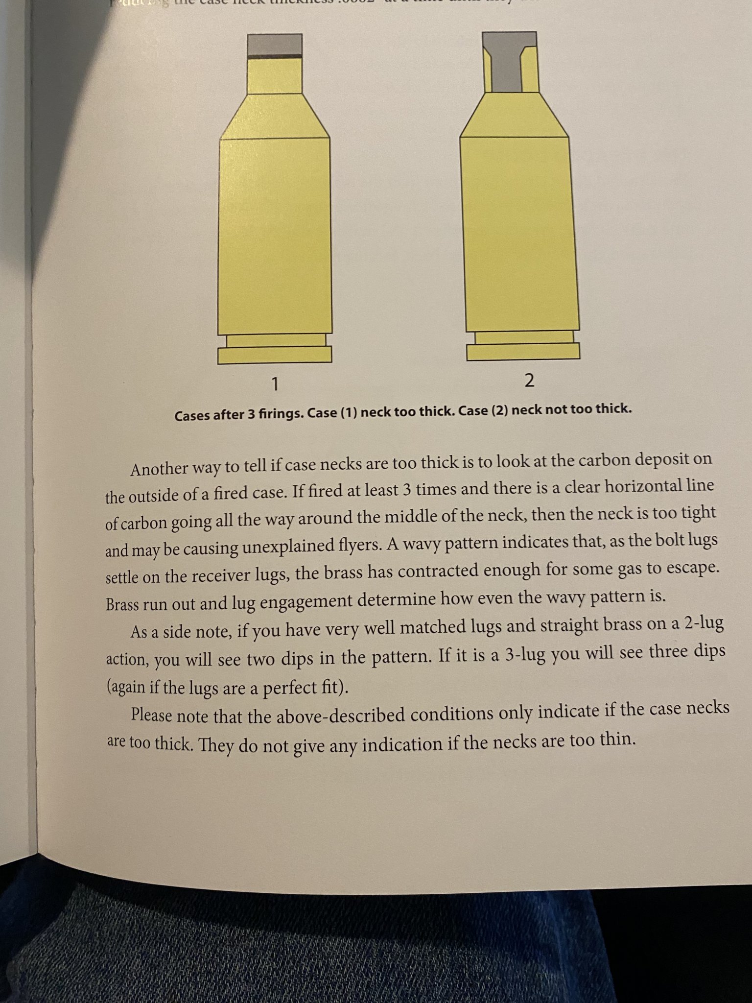

The “wavy marks“ that you describe on the case neck (many experienced comp reloaders refer to this as a carbon sine wave pattern) are normal and show that you have good clearance between the case neck and chamber. The sine wave shows that some of the gases escape into the chamber before the neck actually expands completely, sealing the chamber. This proves that you are getting a good bullet release. Tony Boyer describes this in his book, ”The Book of Rifle Accuracy,” on page 149:
Too much clearance between the case neck and chamber will show the black smudge line further down the neck all the way around and even as far down as the shoulder.

Jack Neary describes the wave pattern you are experiencing at the 13:50 min mark in this video:
I’m sorry but what he said is bullshit. I have had necks seal in a way where the carbon only went down half the neck and the clearance was .007”
Also, the carbon pattern does not reflect whether you have a two, three, or six lug bolt.
Reactions: MOUNTIC and kthomas
Ok, then I must have completely missed your point. I thought you were quoting my post, about powder weights, but posted about weighing loaded rounds. Could you please explain what you meant in a different or simpler manner so that I can follow along?
I wasn’t criticizing you. I was just saying. I should have replied differently. Sorry.
You missed the obvious point of my post. The OP was concerned that the wave patterns on his case necks may be responsible for his groups opening up. However, most experienced shooters know that this sine wave pattern on the necks indicates that you are getting a good bullet release. So that is not the issue causing his problem.
Now you may have results that are fine for you with .007“ neck clearance or a carbon ring on the neck but Neary and Boyer are describing the optimal case. A group that goes to shit for them is one that opens up from 0.10“ to 0.15.”
Regarding the issue of bolt lugs and the shape of the sine pattern on the neck, to me that is a minor issue for you to be pissing about. I can’t see a reason for the number of lugs to change the wave pattern but two BR Hall-of-Fame shooters agree there is a connection.

Page 136 from "Ammunition, Demystified" By Jeff Siewert goes into this. It is a dense read but worth picking up for anyone serious about the subject.
