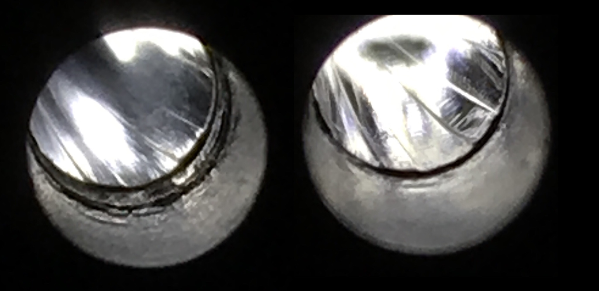

Not F-Class, but a brush never passed through my 6.5 CM barrel for the first 1800 rounds - till a carbon ring blew my first primer and busted a Jewell trigger. Always Wiped out patched out after every session.
Since then, I’ve rethunk my cleaning discipline and use a brass brush judiciously as well.
Ive not run onto this carbon ring yet on my centerfires. I have on my suppressed 22 (pictured). What caliber are you seeing this with?

Oops , got my glasses on. 6.5 CM. Thats what I was wondering about because I just switched from .308
I clean my chamber after every range session, but not my full bore, I've never gotten a carbon ring in my 6.5 and I think that may be why.
Yea well it seems like the 6.5 cm is prone to carbon rings so I’ll have to be on the lookout. I am wondering if there are other factors like powder choise etc. in play.
My .22 ruger mark II will stop going into battery around 150 rounds suppressed w/ Armscor because of the ring. It might just be the Armscor too. :unsure:
Reactions: JimLee
I have read posts from others that talk about certain powders causing carbon ring faster in their rifles. I only shoot H4350 in my 6.5 because it's the first I tried and I got an excellent load dev with it. I'm not sure if it's that or my cleaning regimen that has spared me. But since you know what to look for and will be on the lookout for it I dont think you'll have much problem dealing with it if you see it. Knowing it is happening in half the battle IMO.
