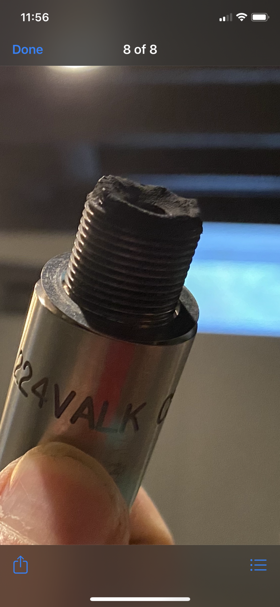

You guys have convinced me to take my 224-Valkyrie build out and keep shooting until it settles down ... or until I run out of ammo.
On my .224 I clean the crown every range session because under my break gets carbon build up and it will easily turn my 1/2 moa load into 1 1/2 moa . Using CFE223
You ever try running a couple dry patches? I wonder if I have the same thing going on under the QD for my suppressor. And maybe it doesn't even have much to do with the barrel.

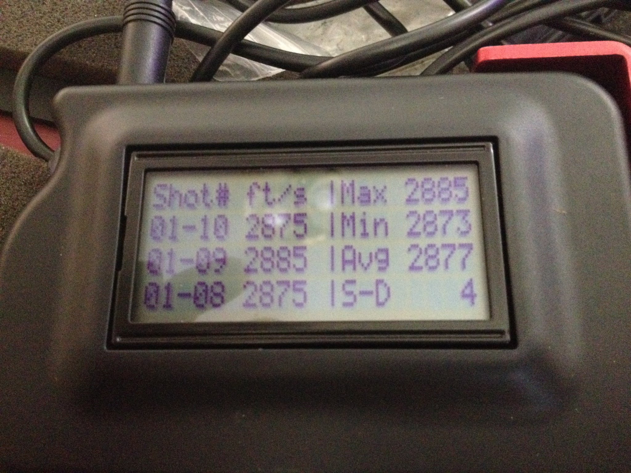

I have another barrel to check the ammo with. This is a LV contour to hunt with, but its showed promise as well as being a problem child. I guess I should stab another barrel on and check the ammo. I know the Criterion I have doesn't do this.
I’ll throw a few wet patches with old school windex but that’s it. This is 100 rounds. Nasty!
