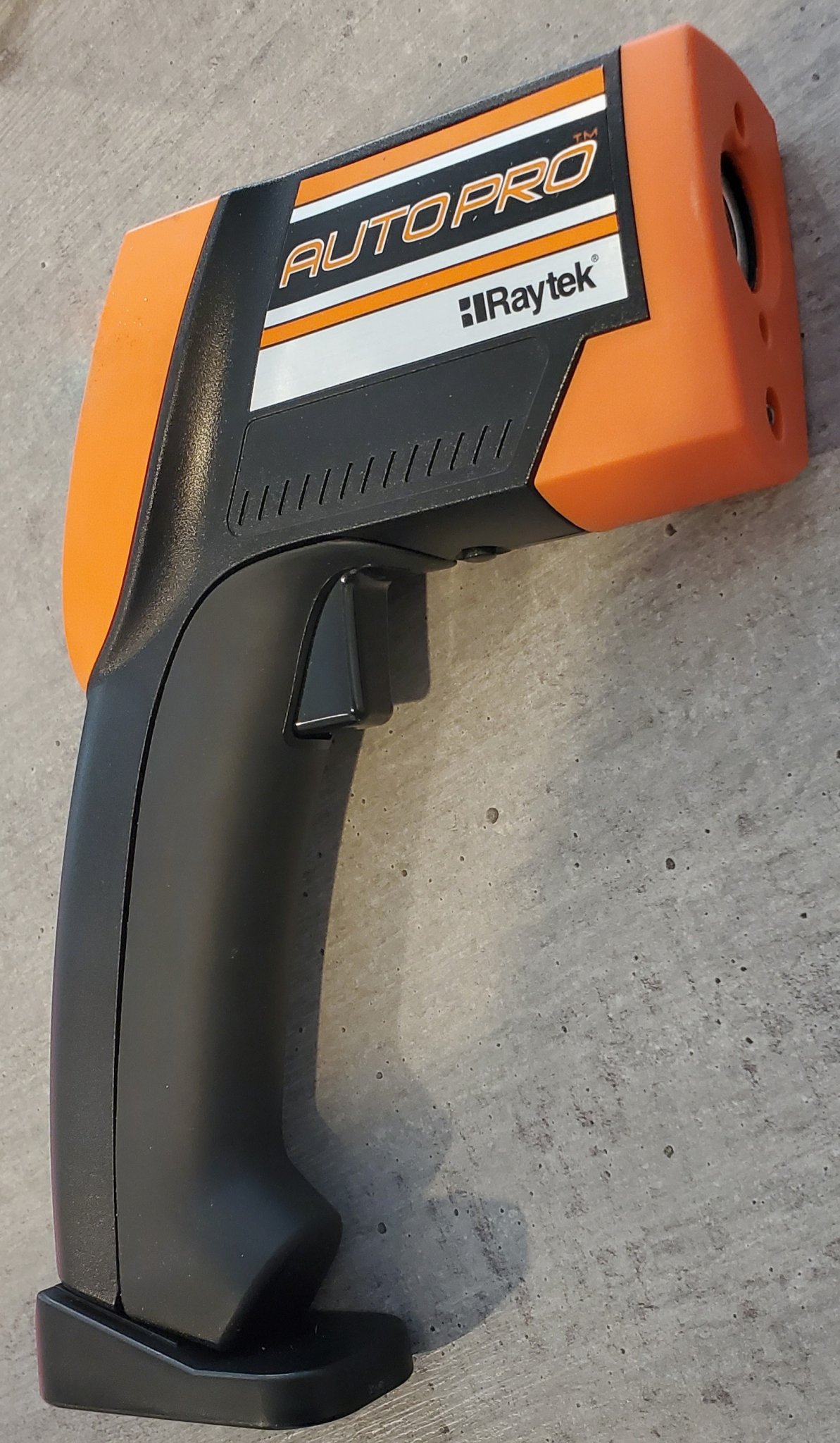

I plan to try my Raytek Autopro next time (used it to check engine temps in my aircooled cars). It will tell me the surface temperature of the barrel. Once I know what that is, I have to decide what is too hot and what is not. Is this a good idea and what is the acceptable temperature range? Thanks for your suggestions.
IR readings can change based on material, coatings, surface condition and ambient lighting. Just a word of caution that you probably won’t be getting an accurate number unless the barrel is bead blasted & flat black with the emissitivity set correctly for it.
