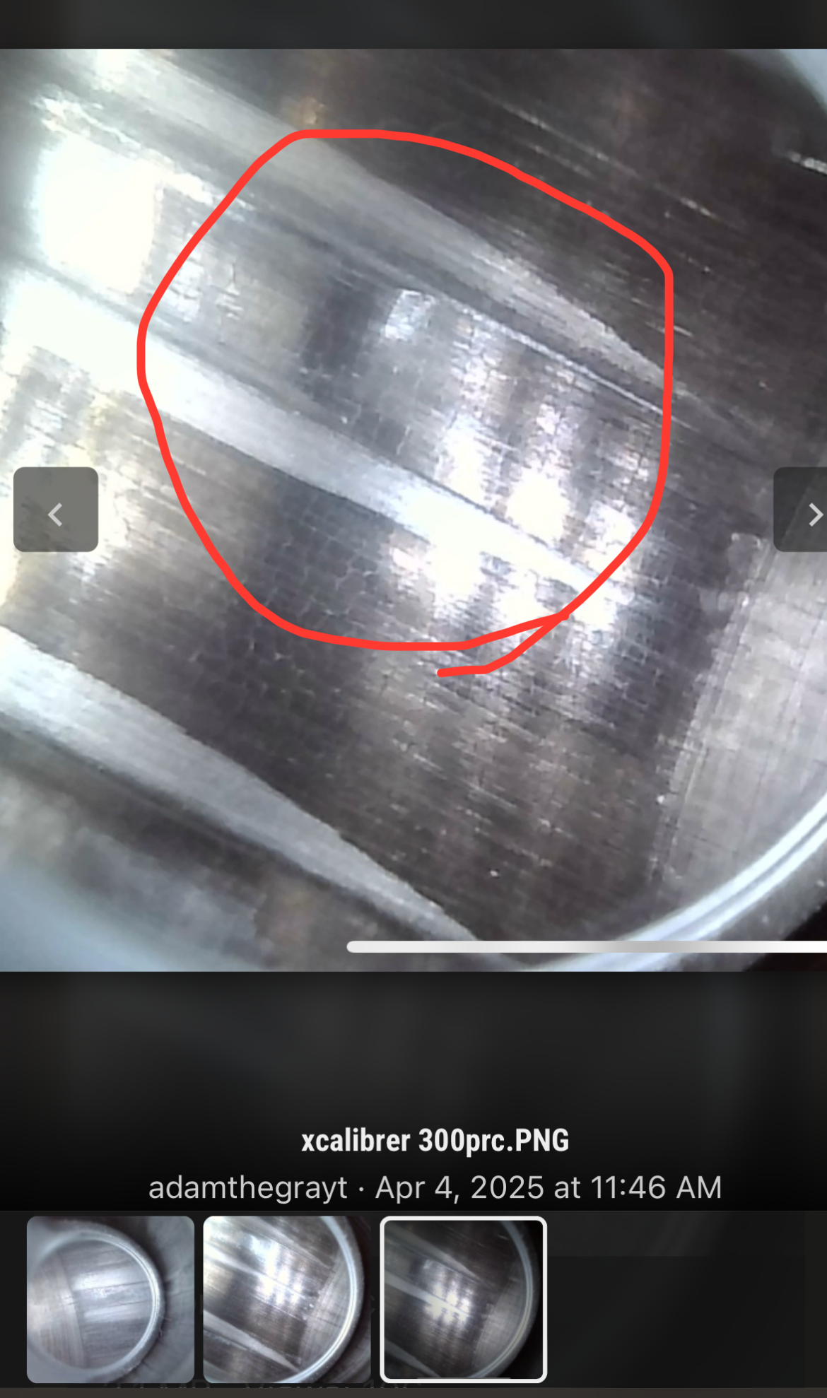

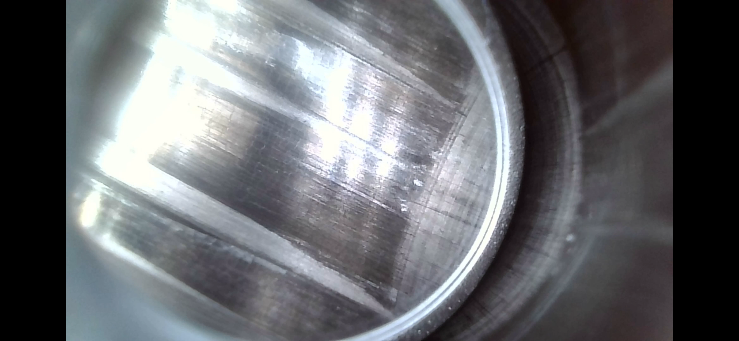

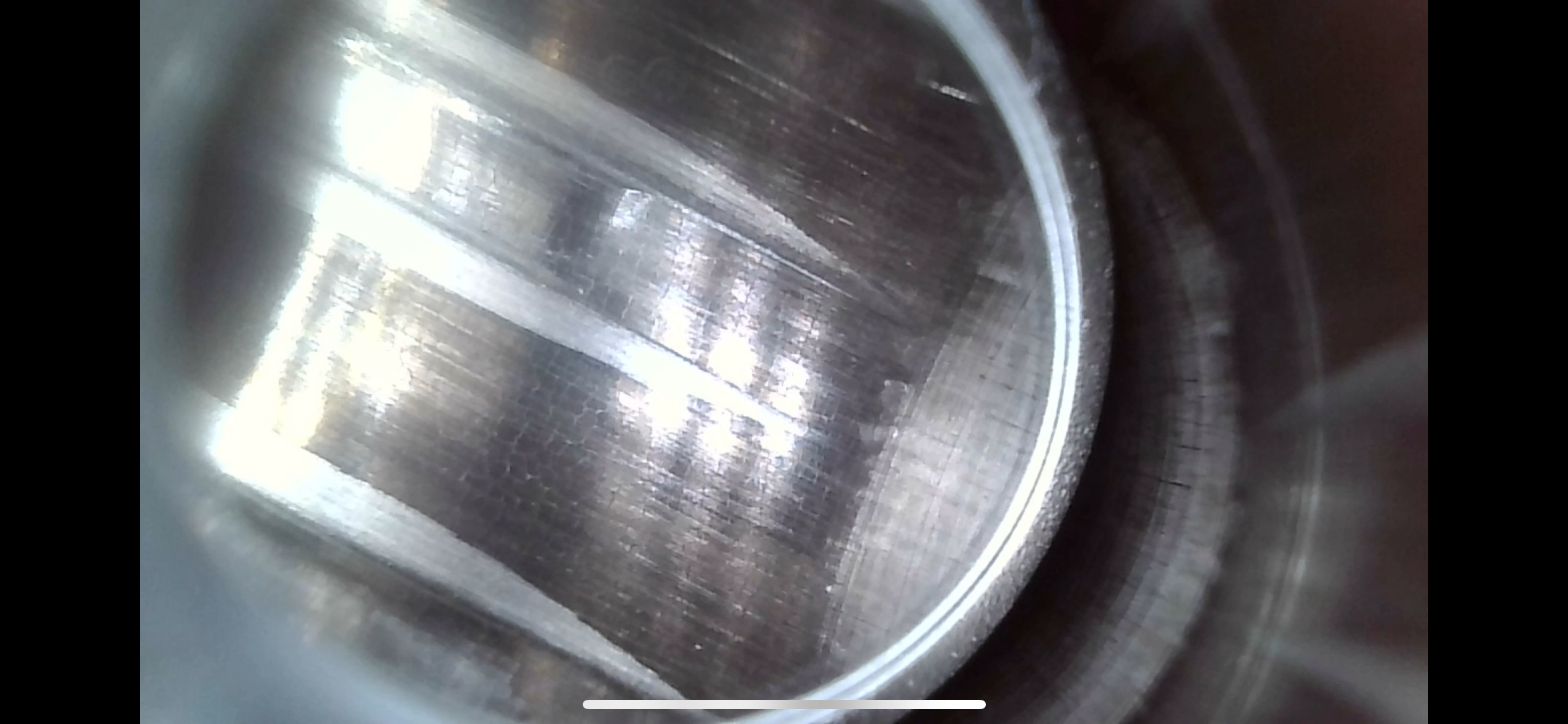

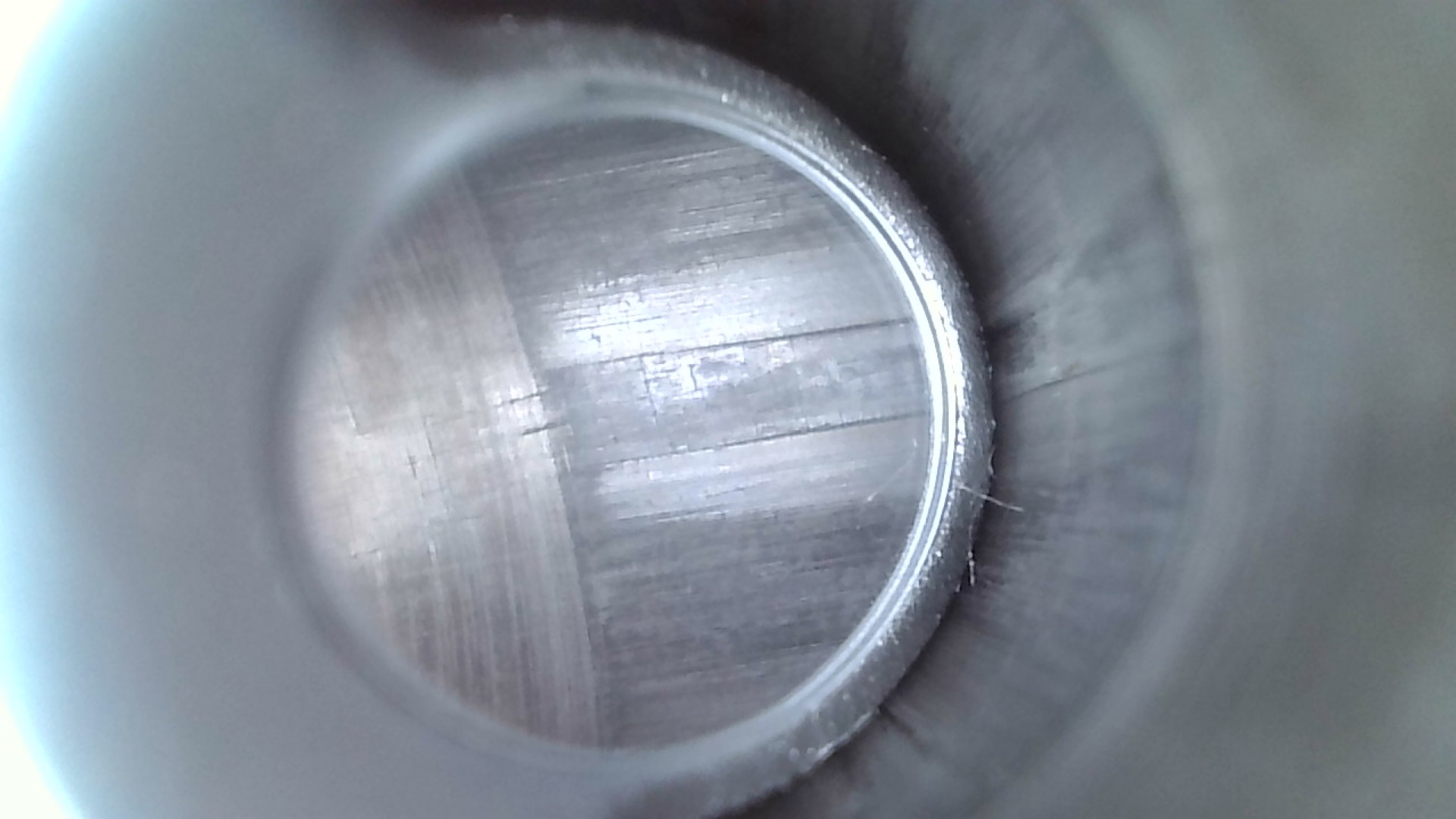

I finally got a bore scope and was pretty amazed at how poorly my throat looked. Does this look like normal throat wear? Or is this a possible manufacturing issue? Or a gunsmithing issue? There is about 450 rounds down the barrel and like I said, I didnt abuse it with excessive heat or hot loads. The gun has never shot well. Below is a image of the throat of the 300 prc. I will also include an image of the throat of my proof 6.5 prc barrel with 120 rounds down it for comparison. Thanks for the help.
The throat looks about the same all the way around. If it was cut non concentric to the bore- I would assume that one side of the throat would look different to the other side.
Im going to take the barrel off the action and test it for runout.

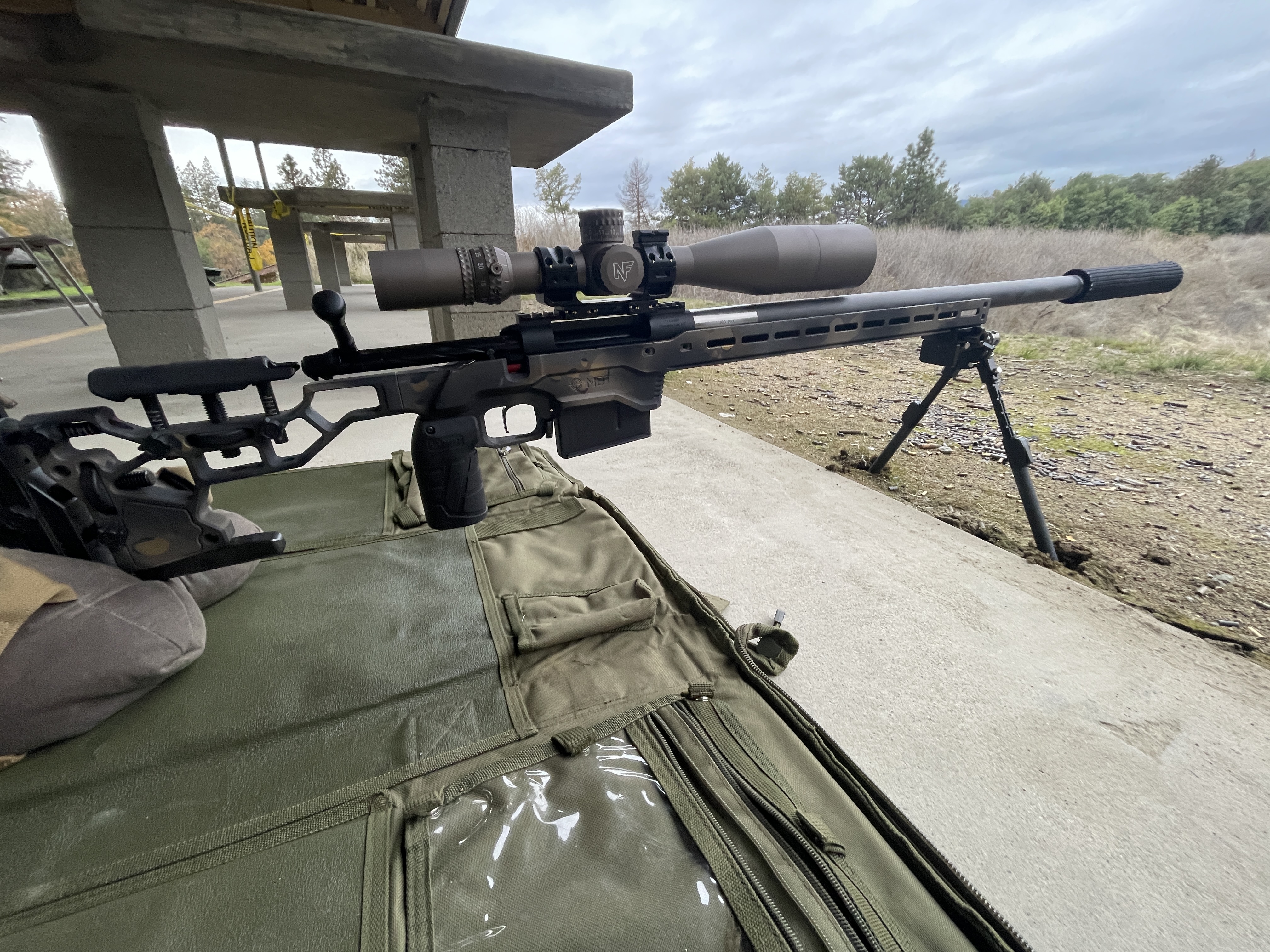

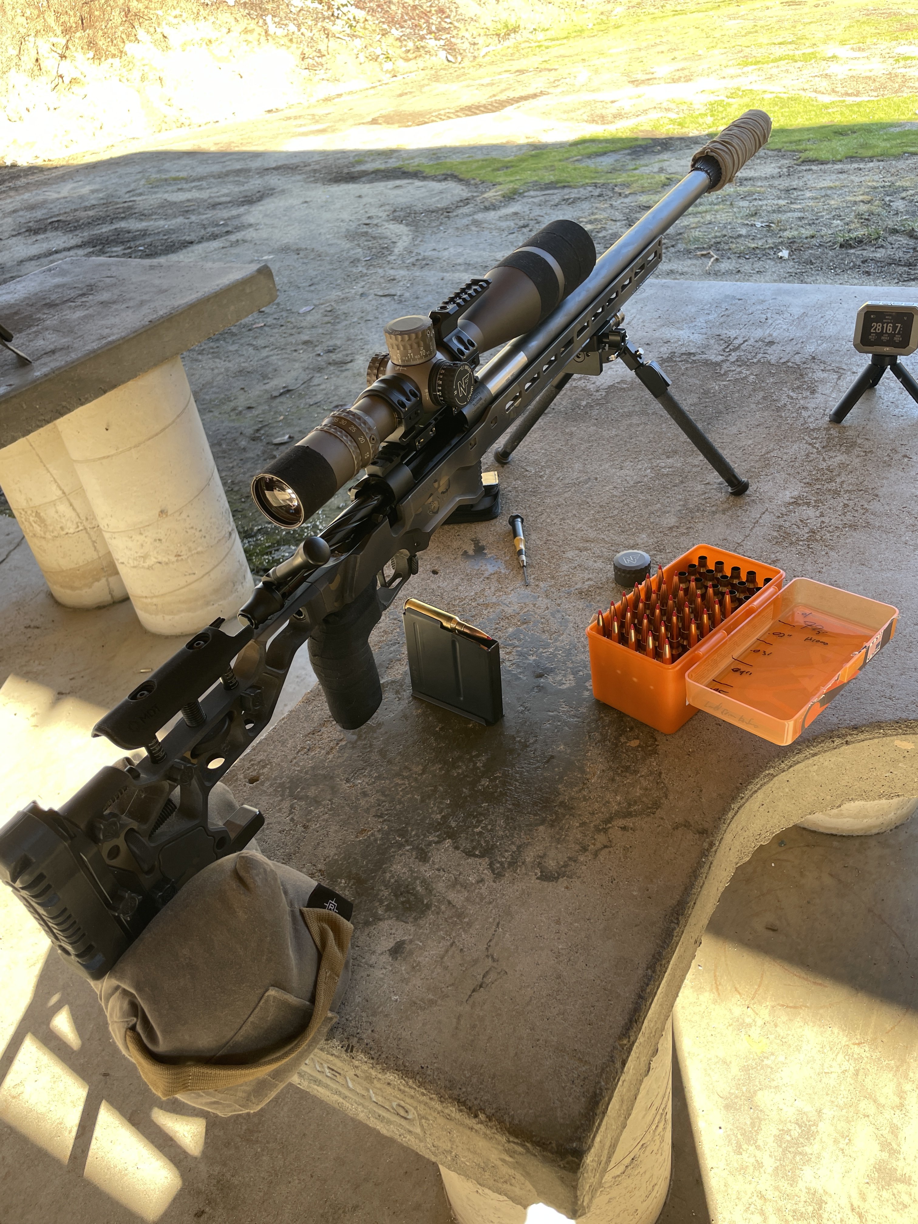

More rifle specs:
Nightforce 7-35 ATACR
Area419 match rings
Defiance Tenacity Action
TriggerTech Diamond Trigger
MDT Chassis and bipod
X-Caliber .30 cal barrel 1:8 5R 26" Heavy contour with their cryo treatment
Chambered by Trevor at Cold Barrel Precision in Medford, Oregon
CGS Hyperion Suppressor on their taper mount muzzle device.
Getting around 2830fps using a garmin chrono. This is from factory Hornady 225gr eldm. I also loaded 225gr Hornady in Hornady cases with 77gr of H1000- CCI magnim primers- with what I thought was about 0.020" of jump to the lands with the same velocity of 2830 fps.
Any other comments/ opinions are appreciated
Yes, it would. Between the shadows, glares, wear points and converging lines something looked off.

If the chamber/throat is not concentric to the bore you would see a difference were the lands

That third photo has me baffled, I've borescoped too many barrels to count and I can't tell what the fuck I'm looking at there.
The center land looks as I'd expect, but the ones on either side look "bellmouthed" which is impossible- as I look closer, it appears to be dark discoloration on either side of those lands. Possible hard carbon fouling there in the leade?
That looks like residual carbon to me.

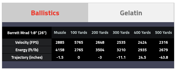

Also, Hornady site is not 100%, but their PDF for the 300 prc eldm does say "best terminal performance with 1:8", that still sounds a bit fast to me. I just not finding many posts anywhere where 225gr anything @ near 2800fps muzzle running fast 1:7 twist, I find a few 1:8, and lots of 1:9 1:10 and 1:12 setups. 1:7 @2800fps is spinning that 225gr at 288,000 rpm !
It aint right folks. It goes almost 2x faster at 100yds? Nice try Hornady. LOL.

Hornady specs are from a 26" 1:8 BARRET MRAD, not sure what rifling that is though.

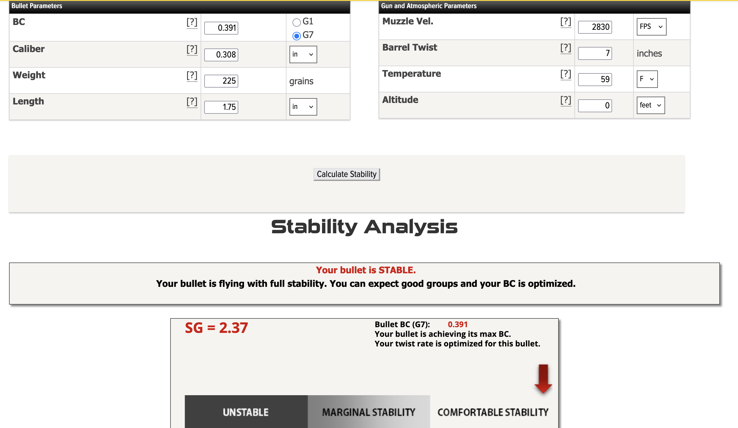

The bad magic number is 300KRPM. If you go to Berger site and enter the data for the ELDM...even 1:7 is stable. Caveat is I guesstemated the bullet length. I'd have to dig deep to find a Hornady bullet. At 300KRPM, jackets can start to fly off.
That specific Berger calculator is flawed, it's only good to tell you if you don't have enough twist, it DOES NOT tell you that you have too much twist. Put in their 300 230gr, fps 5000, twist of 1, it says you are good to go.... blahhahahaha, BS.

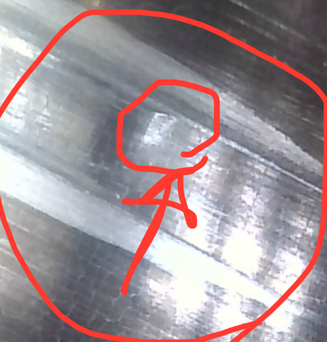

In the circled area the top edge of the land there's a deformation/ burr looking edge.
Thanks....but me?....I'm not seeing anything but erosion of the lands and fire cracking. Looks like on that part of the lead that the fire cracking has extended a bit into the land but isn't this as expected?
You need glasses then. This is a machining anomaly. Nothing to do with normal fire cracking.
Are you familiar with with machining?

Wannashootit's comment about the "bellmouthing" is the best description of what I was initially concerned with. Ive never seen the start of lands and gooves look like that- but thats why im here. Ill try to get some better pictures. The firecracking looks normal to me.

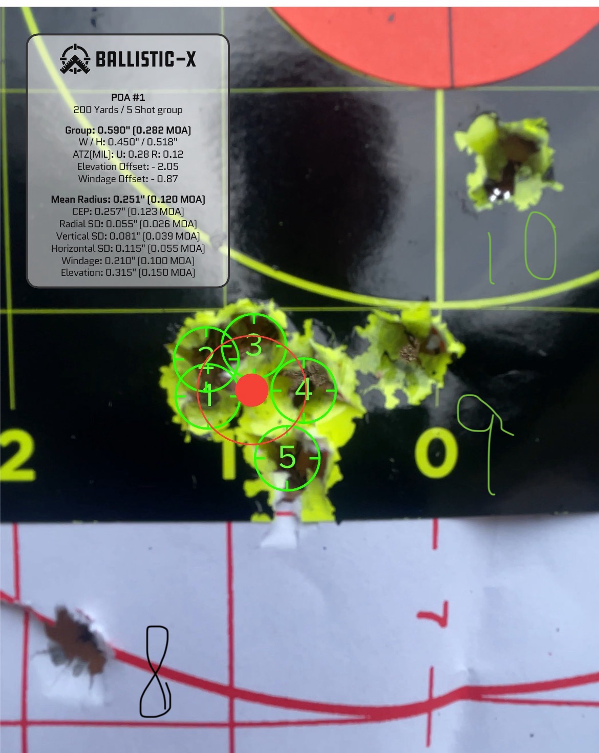

After thinking about it, this had been roughly my experience the whole time. I would get to the range and be pissed that my first rounds were so far off from where I thought I had it zeroed. I would go recheck all torque and go through my checklists and maybe adjust my scope. Then by the end of my range session, I would get a decent group (not where I wanted the group but a decent group) and get my hopes back up again. Then it would repeat at the next range session.
So I stopped changing anything and just shot at the same spot without changing zero. So far I have done 4 different range days and they are all the same. Pictures show the last range day with me numbering my shots 10. Then the next image is the group shot after 10 rounds. So in 4 different range days it has grouped way left and crept back to center after about 10 rounds. Same with a brake on it. It must be heat related IMO. Good grouping at rounds 11-15 and 16-20 but those group centers would be still slightly moving to the right.

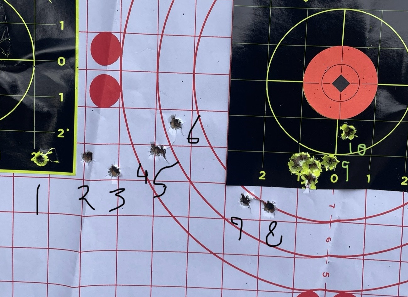

. When the gun is cold, the first shot is way left, like a mil at 200yards, roughly like 8-10 inches. Then, without changing my scope or my point of aim, the next round would be about an inch to the right of the last one. This would happen for about 10 rounds with each round moving about an inch to the right @ 200yards without changing my windage or changing my point of aim.I took the gun to Ernie at Gunner's in Brookings Oregon and he said he thinks that some barrels will get a stressor in the barrel at some point. That stressor when subjected to heat changes the point of impact. He said he has only seen it one other time with a name brand carbon barrel.
Yikes.
Cold AM morning, stick a laser bore sighter in the end when cold, move rifle so laser is on a target 200yds out. Every 30min spot the target and write down how the laser dot moved, as the day warms up keep documenting how the laser moved. Do not disturb the rifle during this time. You seem to say the barrel is moving as it warms, for what reasons are TBD. But if you are seeing laser move at all, then that suggests a tension issue in the barrel as temp changes. 1/1000th degree (angle) of barrel change is approx 1/8" at 200yds (check my math).
