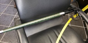

I have two myself. One for my Impact action and another on my Sig Cross rifle. Both green in color.

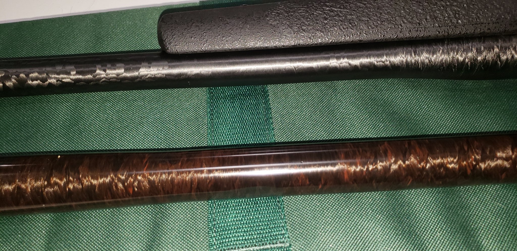

The green one is on my Impact action. The next picture is of a black and a red/brown one. Those two in the one picture got polished. In the sunlight or picture flash the color really stands out better.

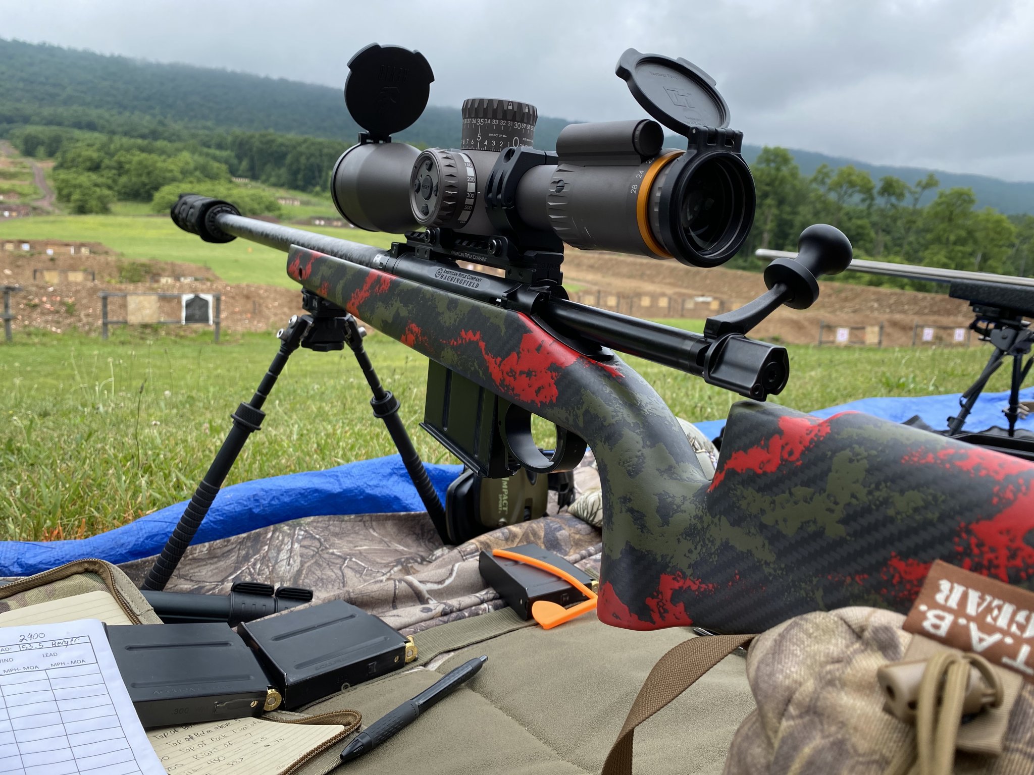

I’d go red. The green will be brighter than the OD green on your stock.
Mine:
