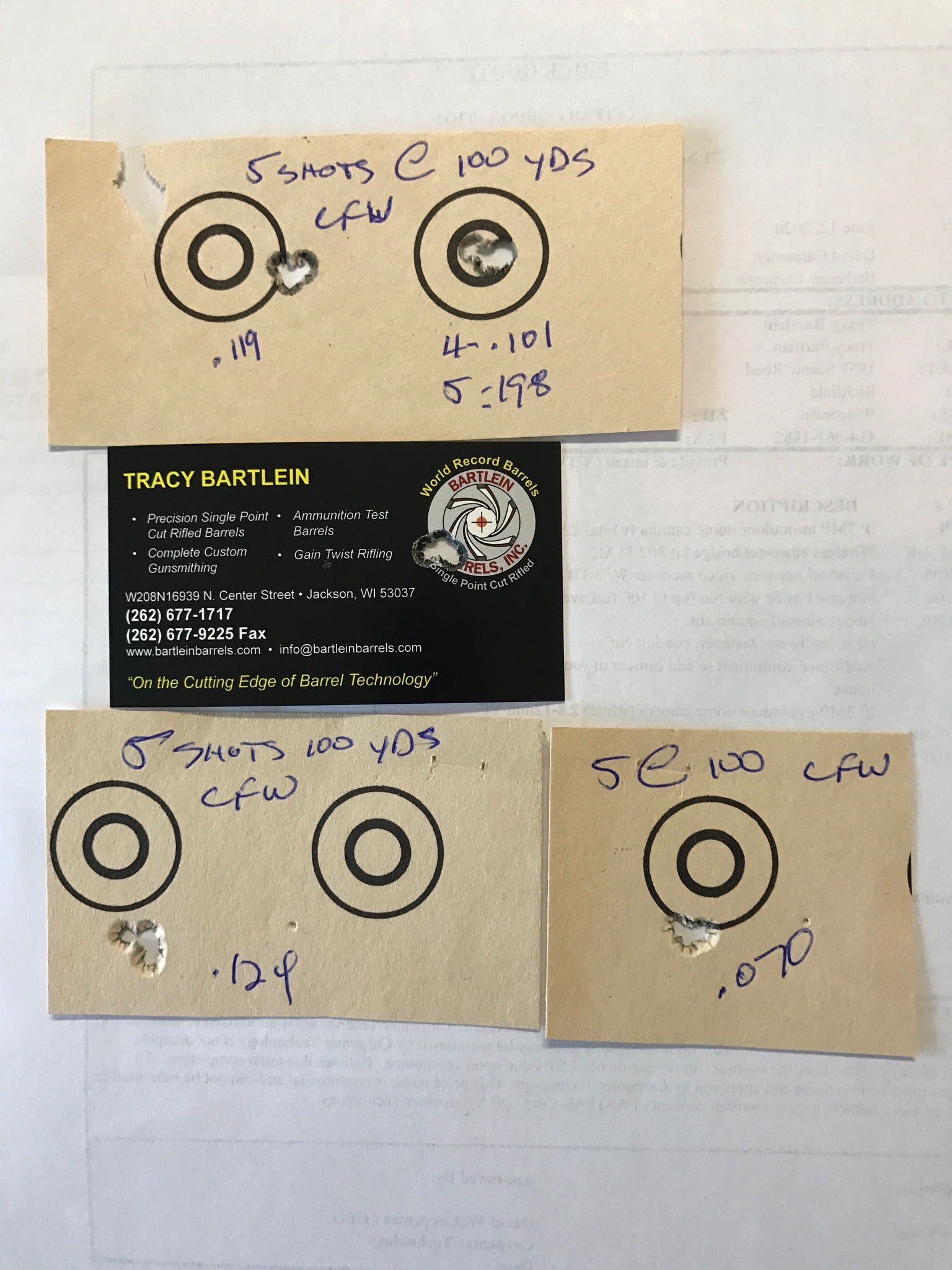

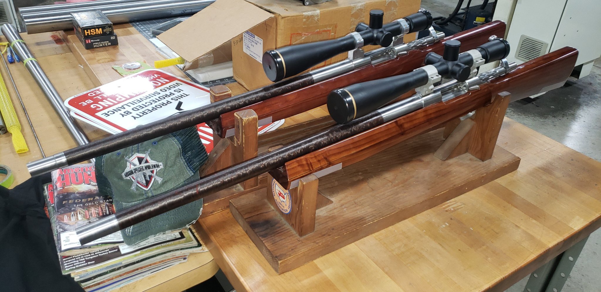

The only thing different is the material. We have already made several barrels out of the new material for carbon fiber wrapping.
We did make two barrels for Mark here in the office for his two LV benchguns in 6PPC. They shoot in the .1xx's and no issues.
