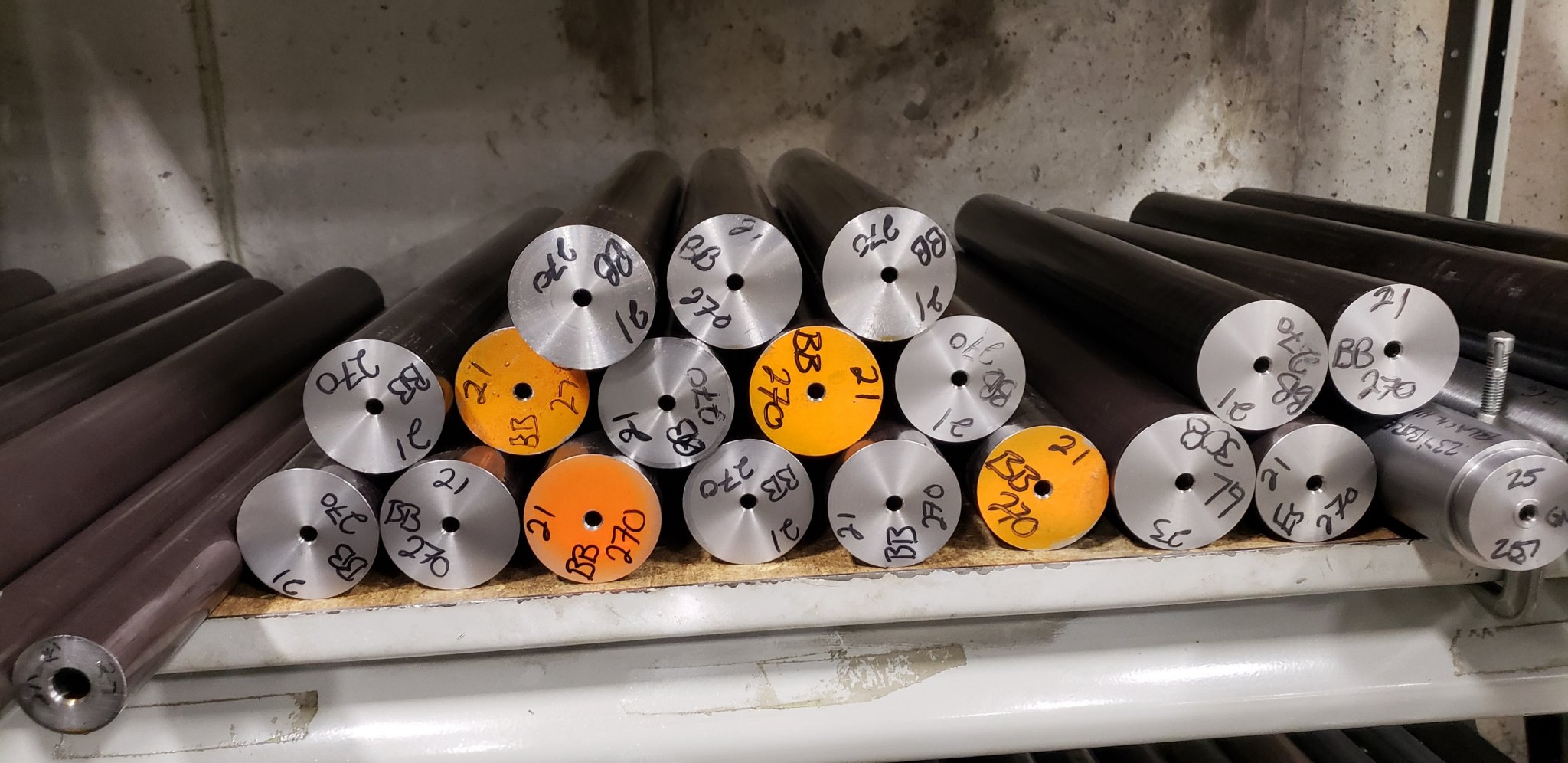

@Frank Green
Are these marked in any way to distinguish them from "regular" stainless? -- I'm guessing the blanks are marked but, is there any way to tell after they've been finished?
I seem to be constantly battling various entities about not sending me the right product, or otherwise delivering what they were supposed to. So I have concerns about ordering a barrel made out of this premium material, and having to trust that I'm actually getting what I paid for.

@Frank Green
I know that was going to come up at some point in time. When we cut the steel for the orders....the 400MOD material is getting spray painted on one end in orange. They also get marked BB at the same time. When the blank gets pulled for an order than the information and lot code gets put on the paperwork and the guy doing the turning after it's finished turned marks the barrel again and the order number and customers name in an industrial marker on the outside. After it's rifled the s/n information gets stamped on the the breech end and the order updated with the s/n at that time as well.
All of the blanks in the picture marked BB if you flip them around on the other end are also spray painted orange on the other end and marked BB as well on that end.
Standard 416 material doesn't get spray painted prior to doing any work to it for any orders.
So yes we don't want the stuff getting mixed up as well. It cost us more to get. So no matter how you look at it we need to keep it separated.
Later, Frank
