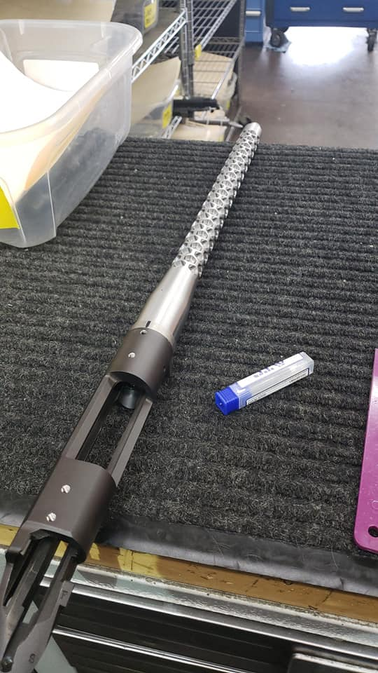

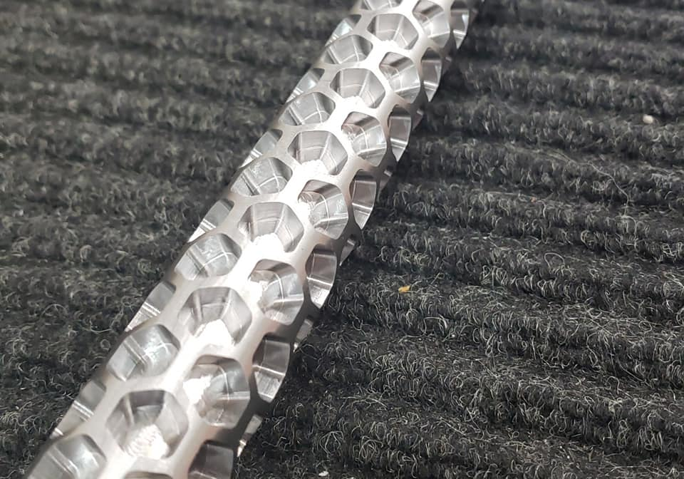

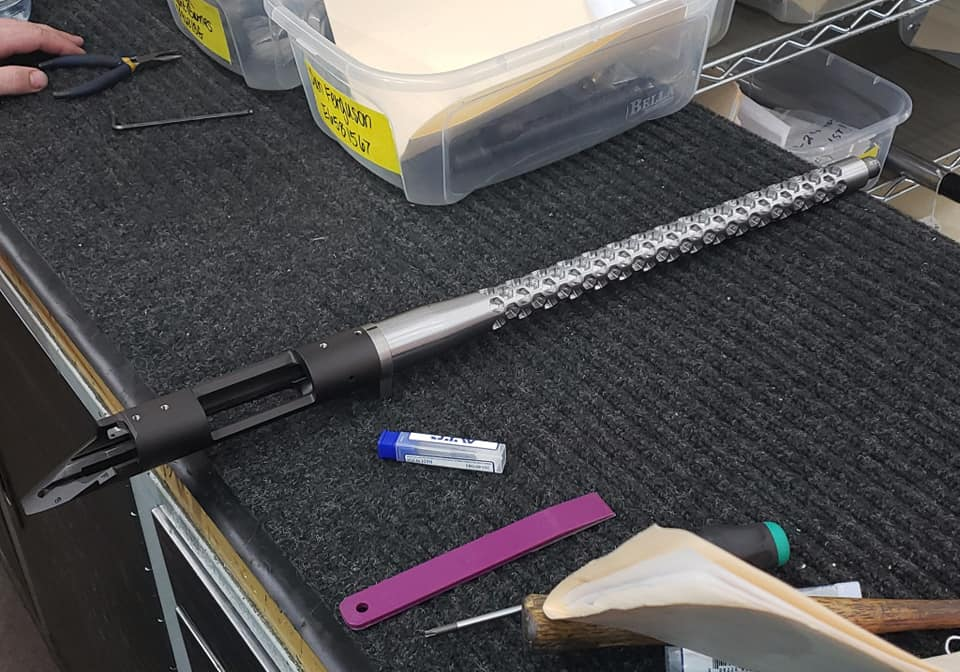

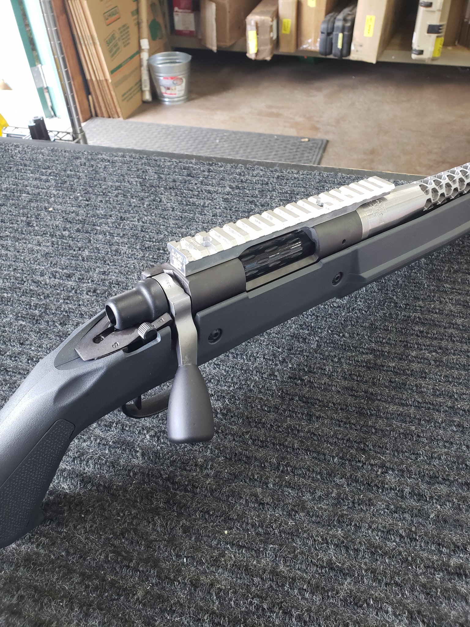

    We've taken on some contractual work where we'll be doing a pile of this for some folks. Hexagon fluting is nothing new and I make no claims as to whatever, lol.
    The one little difference here. From what I've seen online, the strategy is some X/Y pockets shaped in a hex. No real difference with ours except that the Y axis is now an A axis move. What this does is give the bottom of the pockets a radius. It makes the work appear as though the barrel has been "sleeved" by a really kinky pair of fishnet stockings. Instead of the features being straight walled, they actually grow in size as the distance from the floor increases.
    Nothing earth shattering, but it does change the appearance. The pockets also follow the diameter changes along the length of the contour so the wall thickness between bore/pocket follows the outside contour. In this case, it grows proportional towards the breech.
    Kinda neat. Certainly different from the other stuff we've done for the last ten years.
    We have this on the store now as well. The price isn't the cheapest. It's a solid hour of spindle time to do it this way. Weight reduction is fairly significant. On a 16" OEM Sendero contour barrel for the 300AAC BO we pulled 13ounces from the starting weight. (From 3lbs even to 2lbs, 2oz.) This is approaching a 30% reduction.
    Hope you all like it. Comments welcome.
    BeeHive fluting
    7094674
    7094675
    7094676
    i wonder how much irregular deflection occurs when it heats up, being that its a bolt gun not a AR
    looks really cool though, maybe get a paint job with several coats of fleck or pearl so the color changes with with the light and viewing angle
    It looks really interesting but I don't understand (emphasis on "I don't understand" meaning I have no expertise whatsoever in this field of endeavor) how that doesn't weaken the barrel, i.e., it look like it would make the barrel very, very thin in all those spots, isn't that a bad thing?
    Structurally the outer surface contributes most to the stiffness and is where the maximum strain occurs during bending or torsion of a bar/barrel. The inner axis or center does little during loading. Pocket type features will remove more material from closer to the central axis. Thus this method gives the best stiffness for weight. Additionally the form maintains a better level of torsional stiffness than straight flutes. Not exactly important for a 300 BLK but has merit for the big calibers, 338 Lapua and above. Only proviso is that the bottom corners must be radiused to reduce the stress raisers
    Absolutely beautiful work!
    Beautiful work! I'm curious about burrs and how you remove them. I'm assuming you're using a tool in the mill for that purpose since doing it by hand would be too time consuming to even consider.
    That's awesome.
    Like others said above the shape is naturally very rigid, and radiused pockets will help will managing stress points. I want a 16" 308 barrel that looks like that! Just wish I could get it with a matching suppressor!
    Could this be practical for a 6.5 Grendel AR15?
    Heat rejection plus really reduced weight; I think this could be a real winner, especially for folks who don't mind spending a bit more large for their AR-15 builds. Type-2 bolts.

    I am curious about a before and after accuacy test. That's a non-trivial about of work done to a finished barrrel.

    A long AXMC barrel would look great finished out like that. I'm assuming if you were doing a 29" or so heavy barrel the 30% weight savings would be quite substantial.

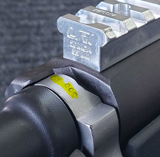

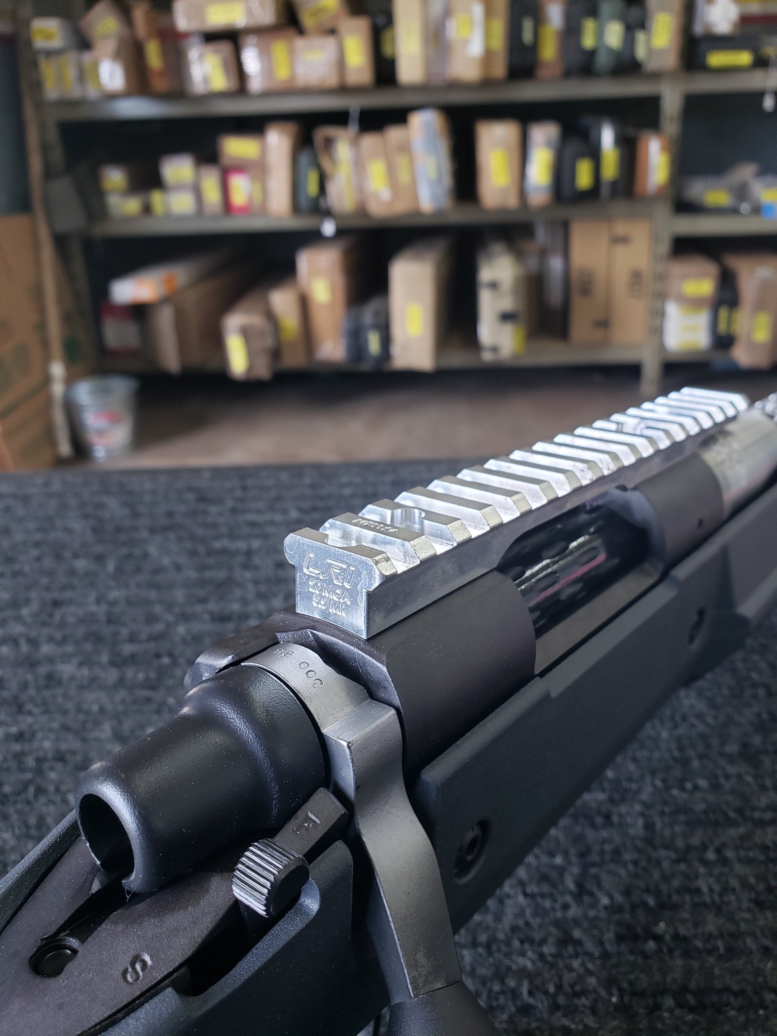

    One question, on the bolt handle it is imprinted with 300bo? Whats that all about, slow switch barrel and keeping bolt and barrel matched? Or was it already there and nothing to do with you?
    7095201
    All on a magpul hunter- The fluting alone costs more than the stock! :ROFLMAO:
    Something the AAC boys do I guess. I'd of engraved it on the 4th axis. I can't stamp stuff for shit. :)

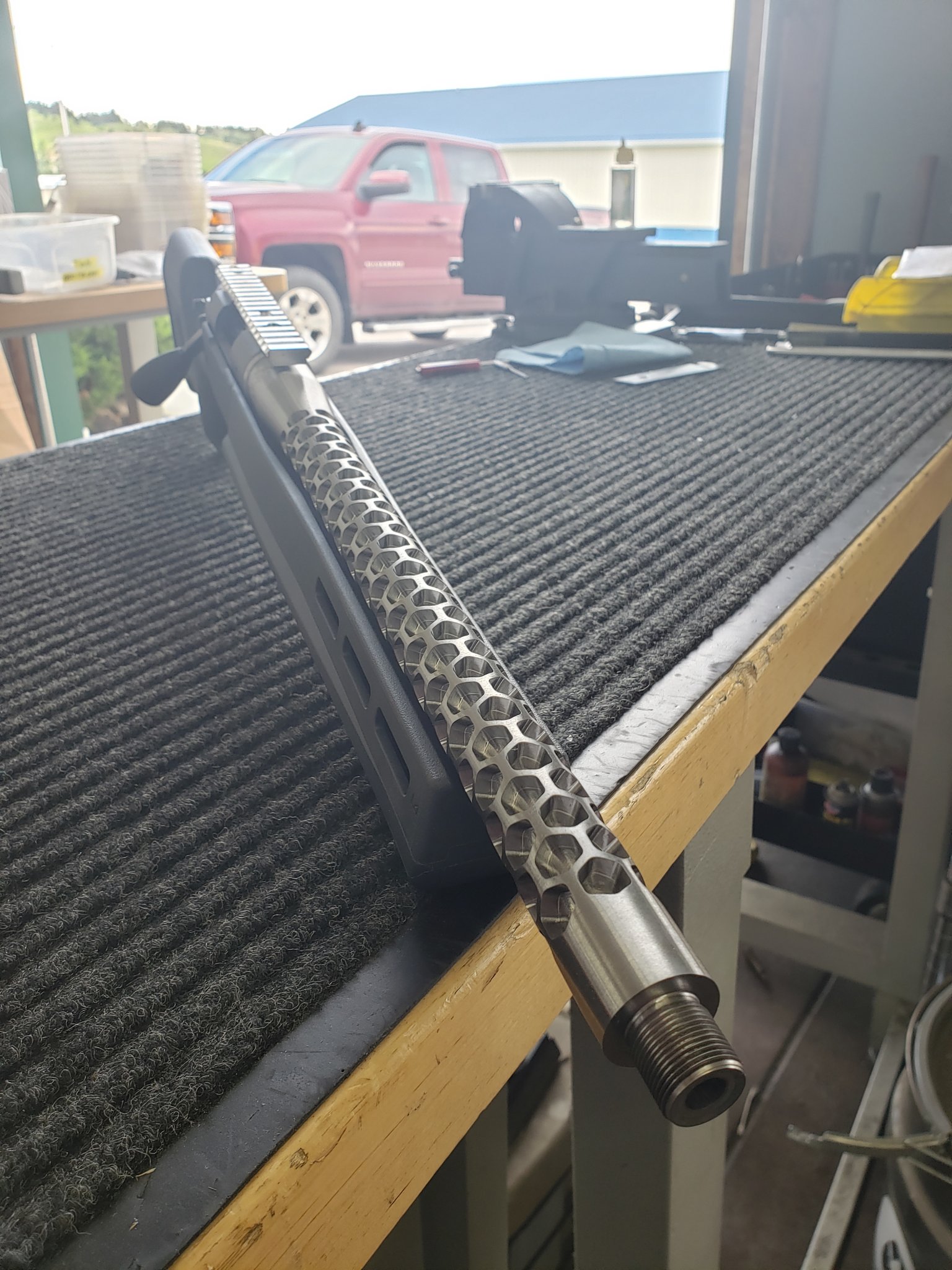

    I neglected to mention, we actually turned this into a 308 Winchester at the request of the owner. Kalyb opened up the bolt to a .480 with dual ejectors and our M16 extractor upgrade. So, it'll have a bit more snort while still being very handy in a pickup with a can on it.
    Regarding how a gun gets set up, here's my thoughts:
    The rational I use often in conversation is a bag of golf clubs. While you could put with a wood if you had to, they all have a specific purpose. No different here.
    The client sheeted this rifle very specifically. We were asked to do this type of cosmetic work to the barrel. He gave me some artistic "leash" to explore some ideas. That's what we see here. Simple X/Y moves are kinda boring imo. - Far more interesting to wrap the tool path around the A axis so that the finished piece looks a little more "cerebral."
    Programming really isn't that big of a deal. I dove in deep with the new 5 axis machine earlier this year. Part of that investment included a $25,000.00 upgrade in software. Very powerful shit that makes this a whole lot easier to do. The biggest bang for me is the simulator. One that actually animates the entire process inside the machine work environment as you would see it in real life. Down to the bolts that hold the fixtures. A tremendous amount of work to set up initially, but now that we have it and its vetted, life got a whole lot better for doing stuff like this.
    Translated tool paths make this pretty fast and we've worked out an incremental/local subroutine using macro variables since so that we can apply it to most any contour. The real "work" was coming up with a simple and elegant means of supporting the barrel while doing all this. Dumb, simple stuff is what I like and once I reminded myself of that, it's become a whole lot easier to do.
    The cost is spindle time. I can flute 20-30 bolts in the time it takes to do one barrel like this. We may end up moving this onto the Kitamura for the production run. Least that way were not tying up our "swiss army knife" machine that does a ton of work for us.
