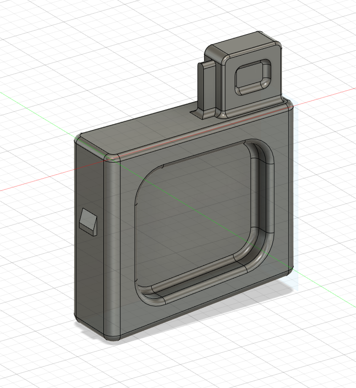

Forgot to add a feature to protect the extractors... Rev 1.1 is on the printer...
Do you plan on selling these? I'm in for one if you do.

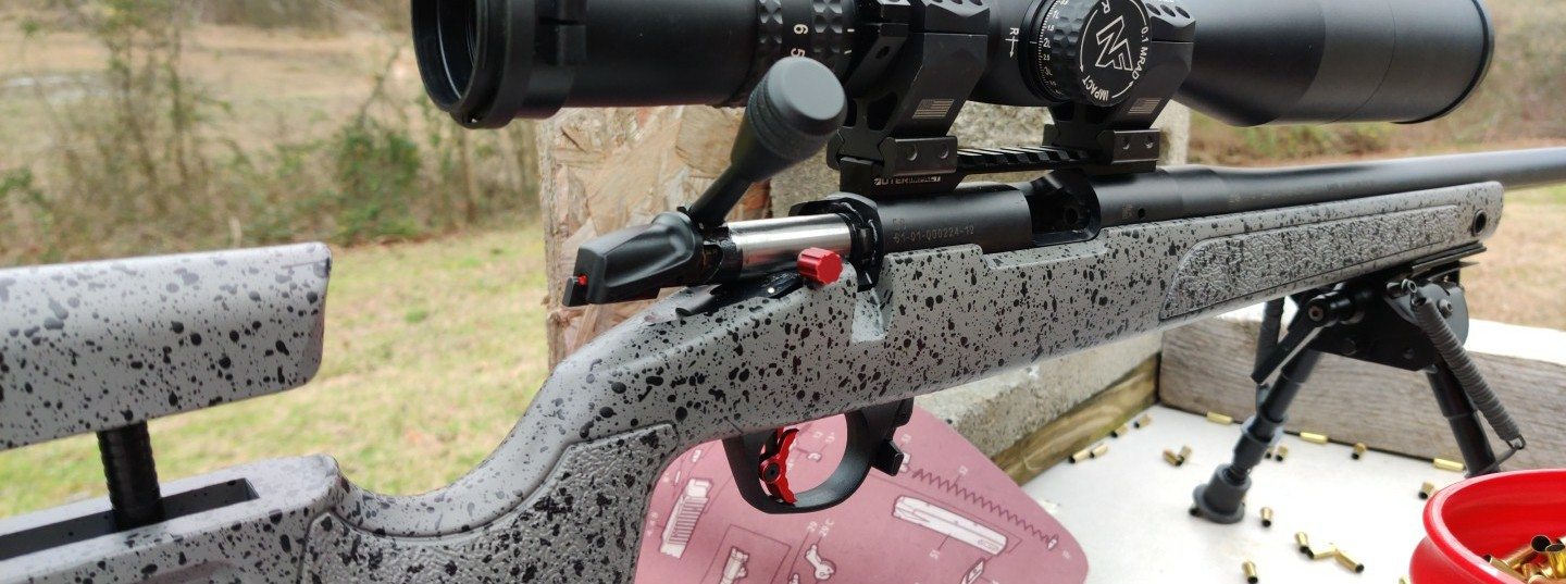

I picked up a B14R (2 actually) in the middle of February after reading
Kisssofdeath's great range reports as well as posts from others with great info. You guys are an incredible info resource. I just wanted to say Thanks.
So far the weak link has been me, the rifle is amazing (except for the trigger).
I just put a Jewell trigger in mine and swapped out a Leupold VariXII for a new Athlon Midas tac 5-25, hopefully, get to test it out at the range tomorrow.

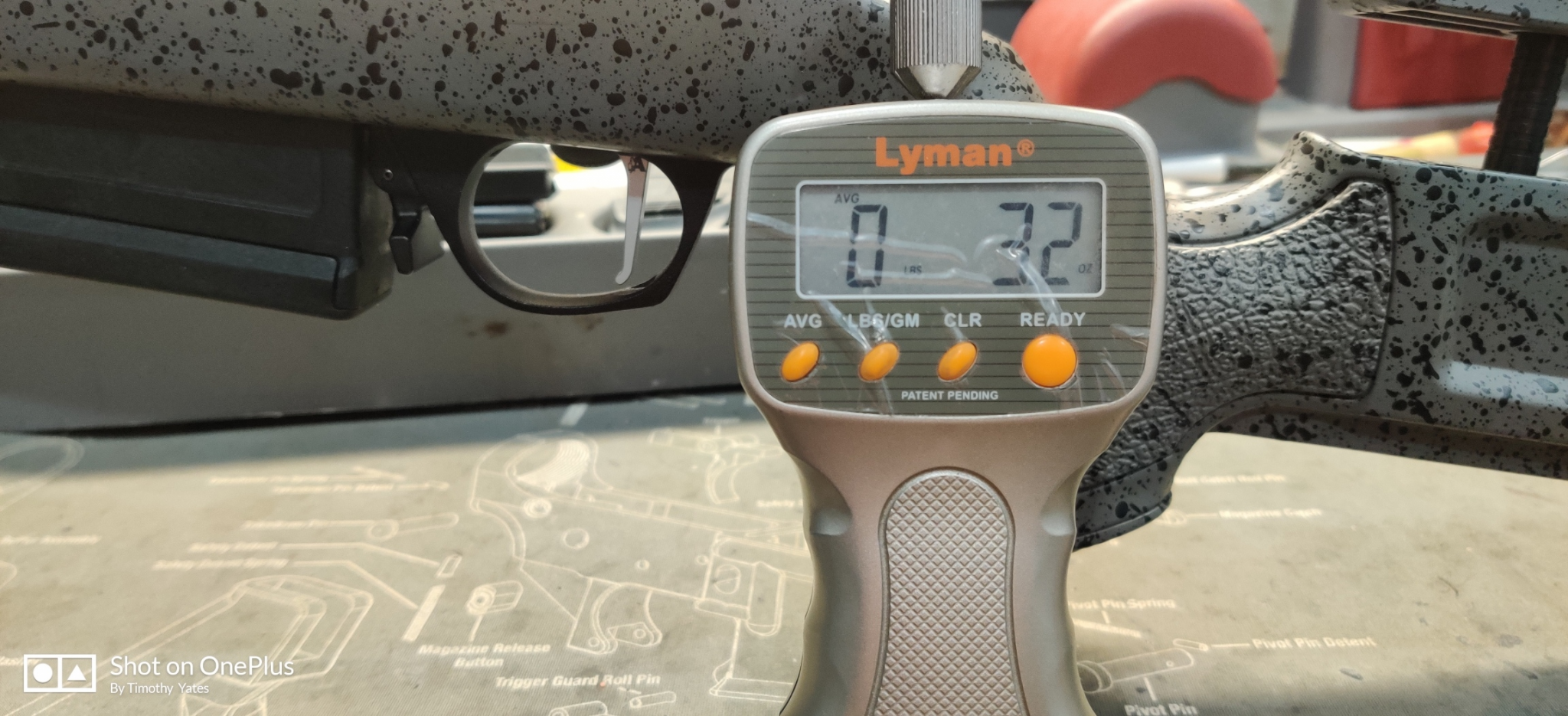

Her is a trigger update.
Got my Bix TacSport PRO back today. I have installed but but not shot it yet. After I got it adjusted, my average of 5 pulls are as shown. The highest pull was 3.4 oz and the lowest was 2.9 oz. No creep from what I can feel. I do prefer the Bix over the Elf. Also included are a couple of shots from a few days back showing the Elftmann. I have the round trigger shoe on because Elftmann forgot to send me the flat trigger shoe.

The trigger is a Bix'n Andy TacSport PRO Single Stage. Over time it developed a very small about of creep. I sent it back to Bullet Central for inspection. After receiving it back this is the first time I shot with it. I can still detect a very very small amount of creep and it's maybe 10% of the time. Much better than before and I would say most people wouldn't notice it.

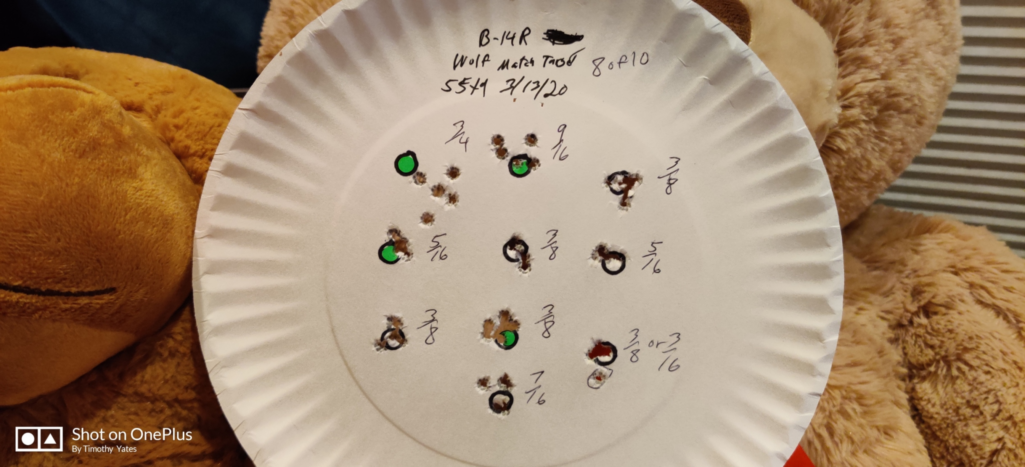

Well, today with the B-14R, I shot four 5-shot groups with the Wolf Match Target like shown above that were 5/16", 1/4", 5/16" and 3/8". All groups were shot with the Sparrow, unlike above. Tomorrow I'll take the plunge and invest in a case of that lot number.
Nice! I ordered some sk rifle, LR rifle match, ND lapua centerX hoping to find something that it likes. I have zero match ammo locally. Thats the "Sparrow" you refer to? Supessor?
Until shooting the Wolf my top three ammo types were Center-x, Lapua Pistol King and SK Rifle Match. Great thing about the Wolf is a case only cost $571 shipped. I can only hope the seller still has that lot number.

The last 12 5-round groups I've shot with the B-14R, using the Wolf MT has averaged .33". That is consistent enough for me to spend $571 on a case of it and shoot in nothing but the B-14R. That will last me a very very long time shooting it out of one gun.

I put a Jewell HVR trigger in mine and had an issue that cocking was smooth but if the bolt was already cocked and you cycled it, it would bind considerably. I backed off the firing pin/spring/gas hood assembly one turn and it seemed to solve the problem, but obviously my firing pin strikes are lighter than they were. Any ideas on what would cause the binding only when cocked?

All groups were 5-shots groups of ammo at 50 and 100 yards - YMMV
I am impressed with the B-14R performance considering its price point.
