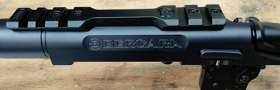

Had some time to play with my new BMR.
Took off the picatinny rail. Screws were modestly tight, I'd guess around 15 inch/lbs. The rail is cast alloy. I checked (measure, measure measure/math, math, math) it at exactly 30 MOA as advertised.

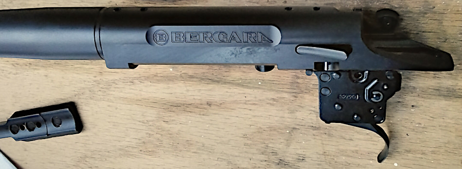

Removing the action from the stock I found the front action screw to be very tight. Greater than 60 inch pounds. The rear action screw was barely hand tight.
The trigger is identical to the one from my B14R.

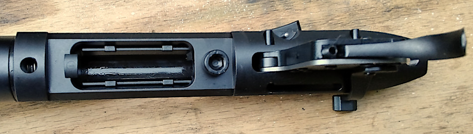

The bottom is relieved where the magazine inserts. You can see through the hole that the barrel is threaded into the action with a surprisingly coarse thread for such a dainty rifle.

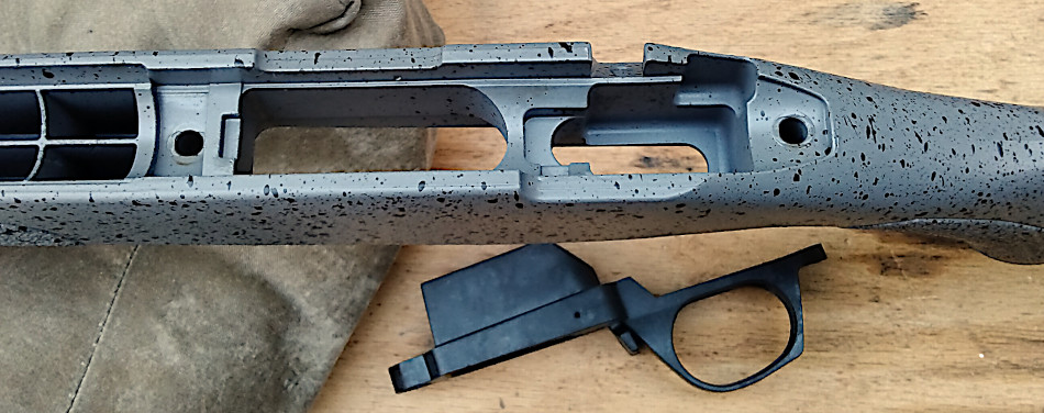

A view of the stock with the typical Bergara spatter pattern. The bottom metal is, of course, plastic.
