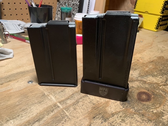

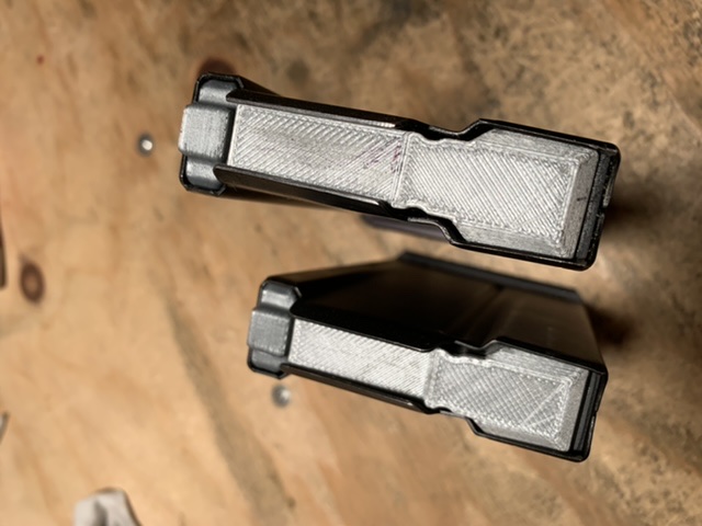

My problem with Dasher is that you can't use a aics mag without mods. 6x47 is also what my friends are using
like Dthomas said...drop in a primal rights BR mag kit and done...add an MPA+4 and you have a 15 round mag

You posted a picture of a mag with a MPA +4 earlier. Do those have the spacer block built in to them? I have an older+2 with a small wooden block epoxied into it to extend the PR spacer because it's not long enough to extend into the bumper. And I have an Altus "BR" +2 that has the spacer extension machined in.
i bought an extra kit and cut the spacer to fit in +4...6BR and BRX both run flawless as fast as you can run the bolt.
