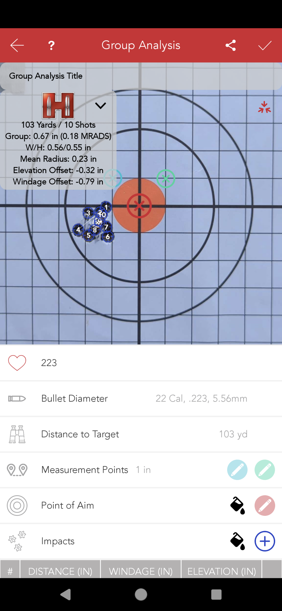

I know you said wanting to go lighter but my remmy 700 223 loves the 73gr eldm. Factory hornady white box first test held 0.67 for a 10 shot. I now load them to AR mag length, jump to lands is unknown, at 2750 with whatever powder and they hammer!
