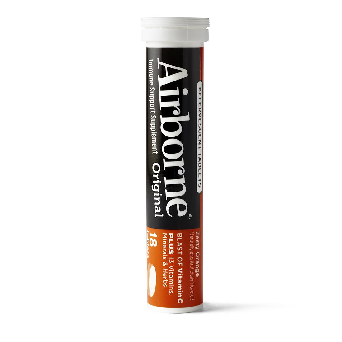

For those with aluminum cans, fill it with Bore Tech carbon remover and let it soak over night. Mine came clean with a rag wipe after that. Like NIB clean...
Those airborne tubes -
They fit my sparrow core perfectly and I just fill it with Boretech Carbon Remover.
