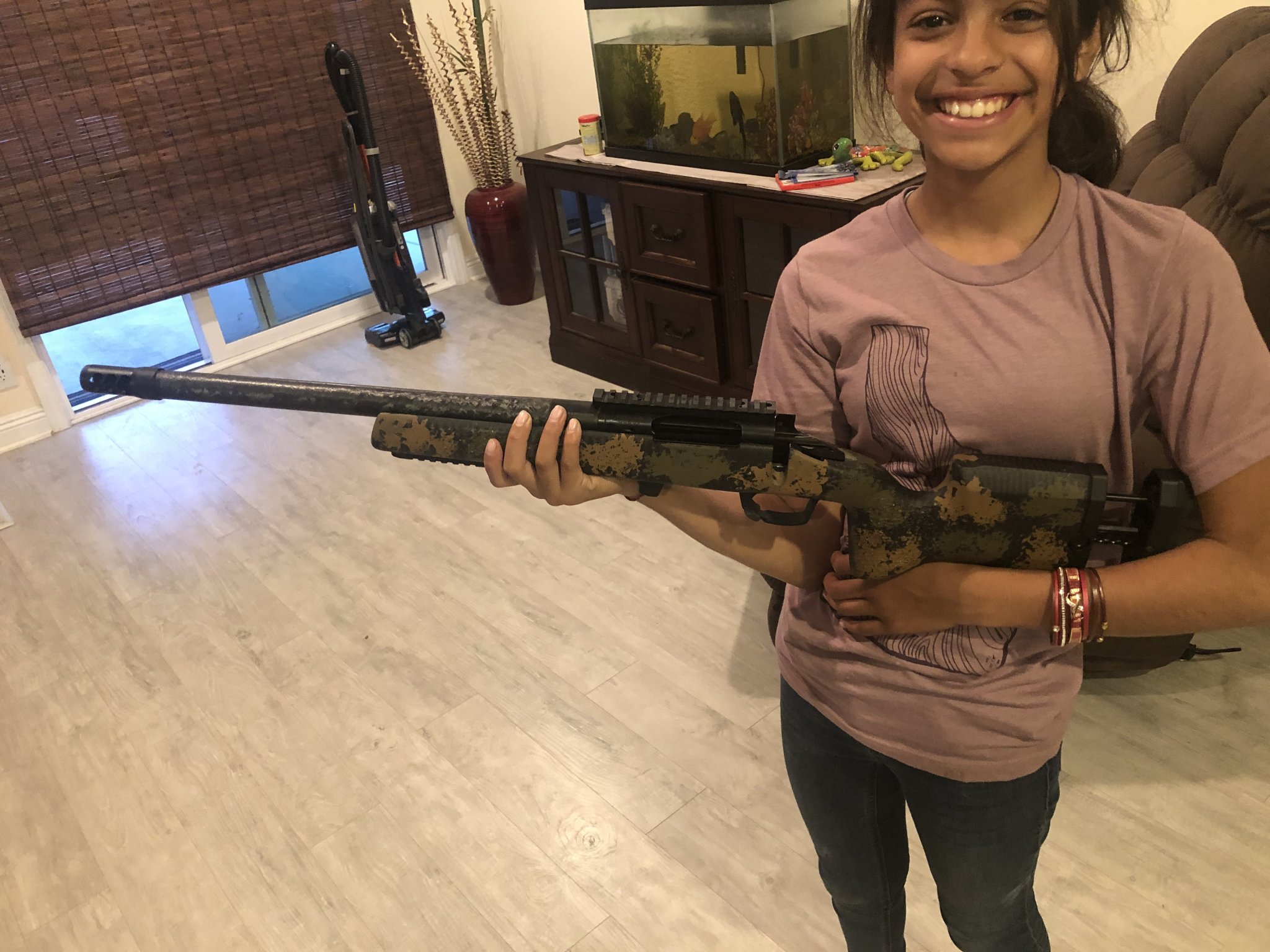

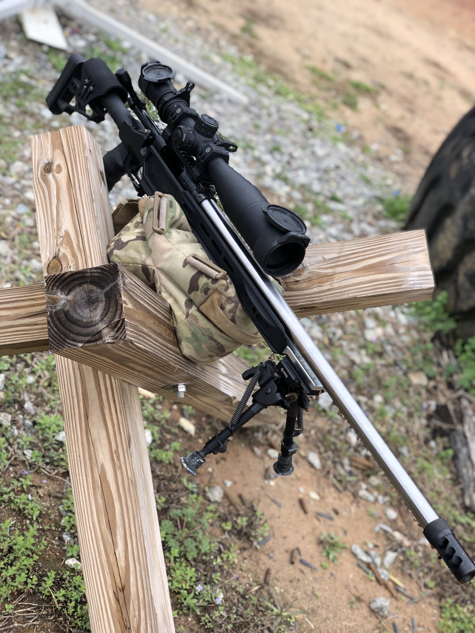

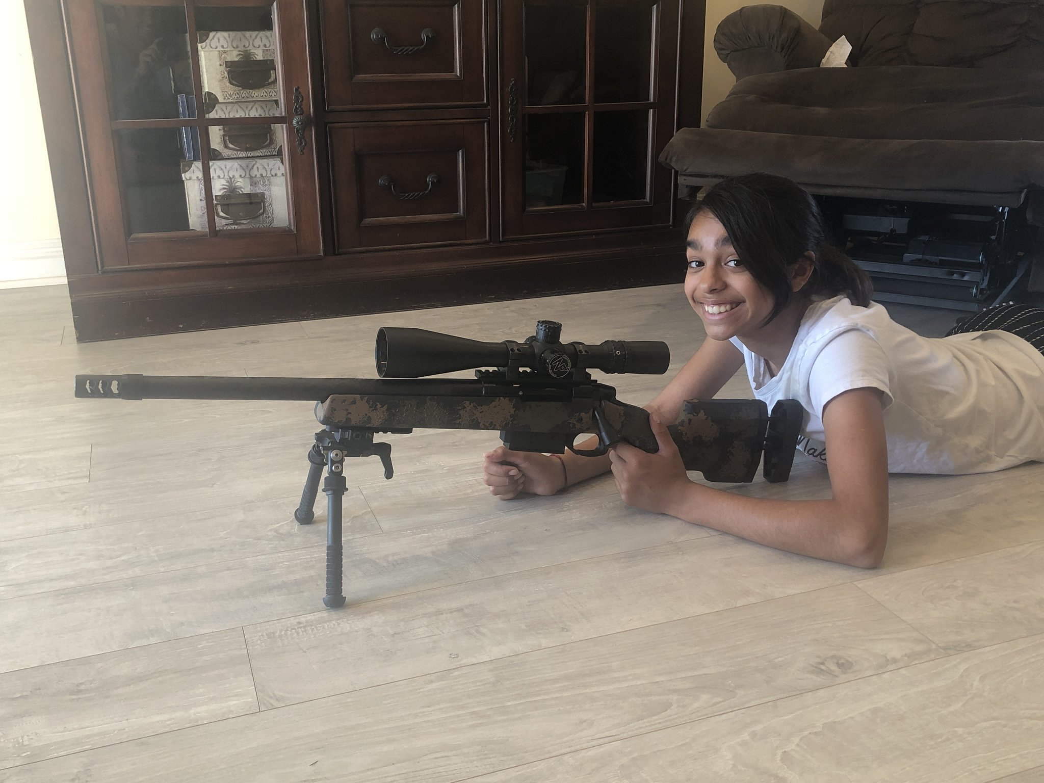

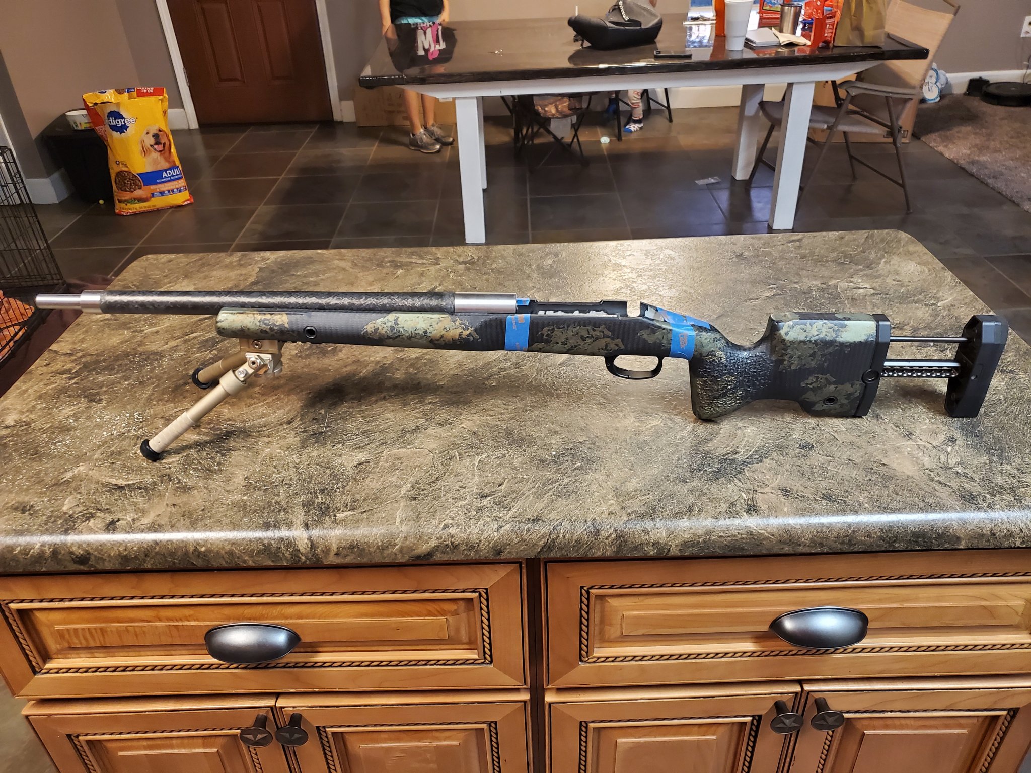

Just got this put together yesterday. Built it up for my 12 year old daughter as a hunting / range gun.
Bighorn Origin LH
16.5” Proof Sendero 1:8 chambered by Ern @ Altus Shooting in 6.5 CM. Muzzle threaded 5/8x24
Trigger Tech Special
Manners MCS-CS LH Carbon Fill with mini chasis
Area 419 Hellfire Brake
Atlas Cal Bipod
NF 3.5-15x50
Badger Rings
Also have a SS 224 Valk Prefit for training. Rifle fits her perfect with plenty of room to grow.
Bighorn Origin LH
Atlas Cal Bipod
NF 3.5-15x50
Badger Rings
View attachment 7141451View attachment 7141452
This is an awesome build! Props to you for getting/keeping your kid involved!!
I need to try to save up to do something like this for my wife. She is pretty small frame, and the package you put together here looks perfect for someone her size.
Reactions: HogsLife
Thank you bro. Yeah, I got tired of buying her rifles that she put grew and being she’s a lefty, I didn’t want to buy multiple rifles for different things. So I went with this set up. I also got all the bolt-heads from 223 - short mag.
Originally I was planning on a 6CM Proof CF Barrel for hunting but she got an elk tag this year so I decided to go with the 6.5CM instead. I also have the Mag Bolt Head so when she gets a little bigger she can run a 6.5PRC for larger game.
Figured Make the rifle as light as I could with the Carbon Stock and Barrel so she could hunt with it, and if she needs to add weight for comp / range shooting she can run a heavy contour SS Barrel to add the weight.
This will be the last rifle I build her but should fill all her needs for hunting etc and it’s not something she will out grow. I’m happy with how it fits her and so is she. I define ty recommend this build dude! You won’t be disappointed

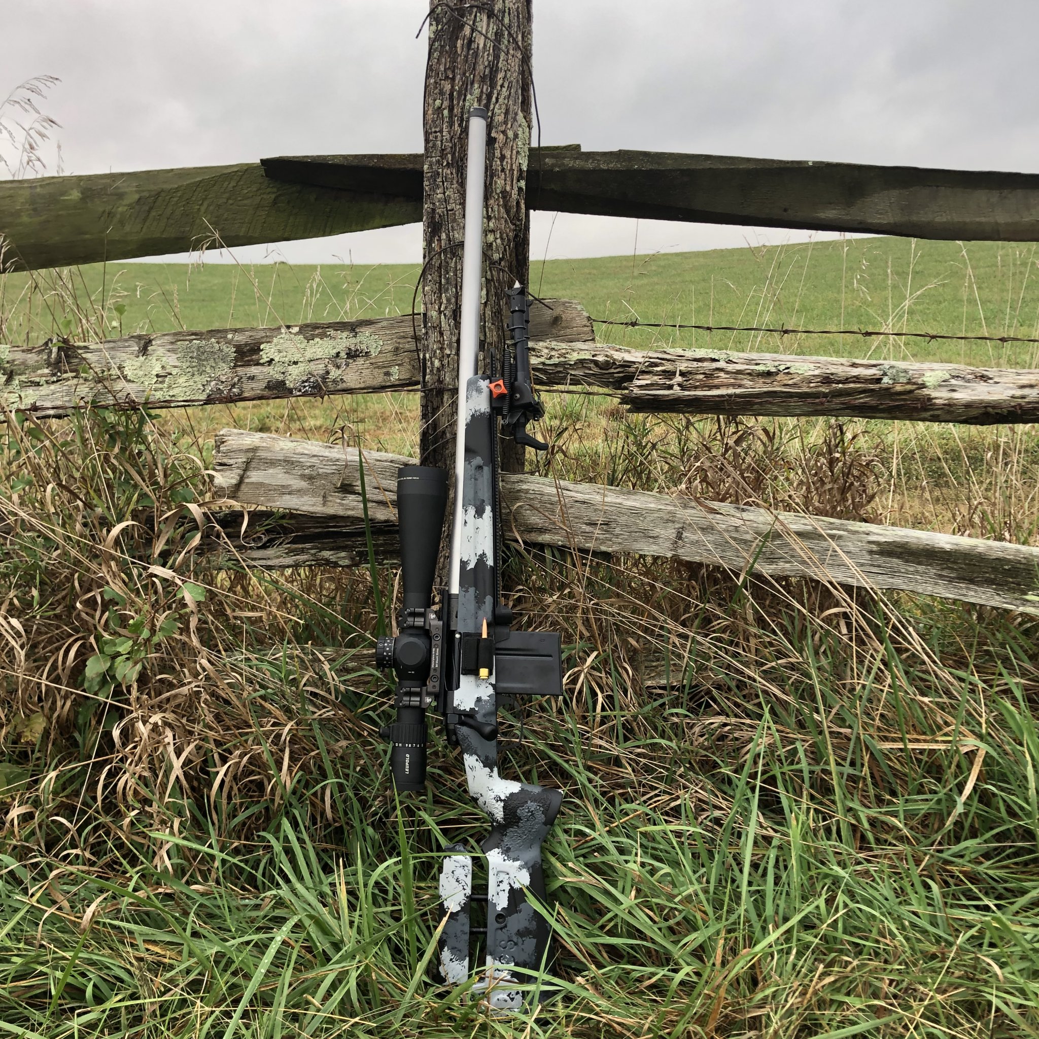

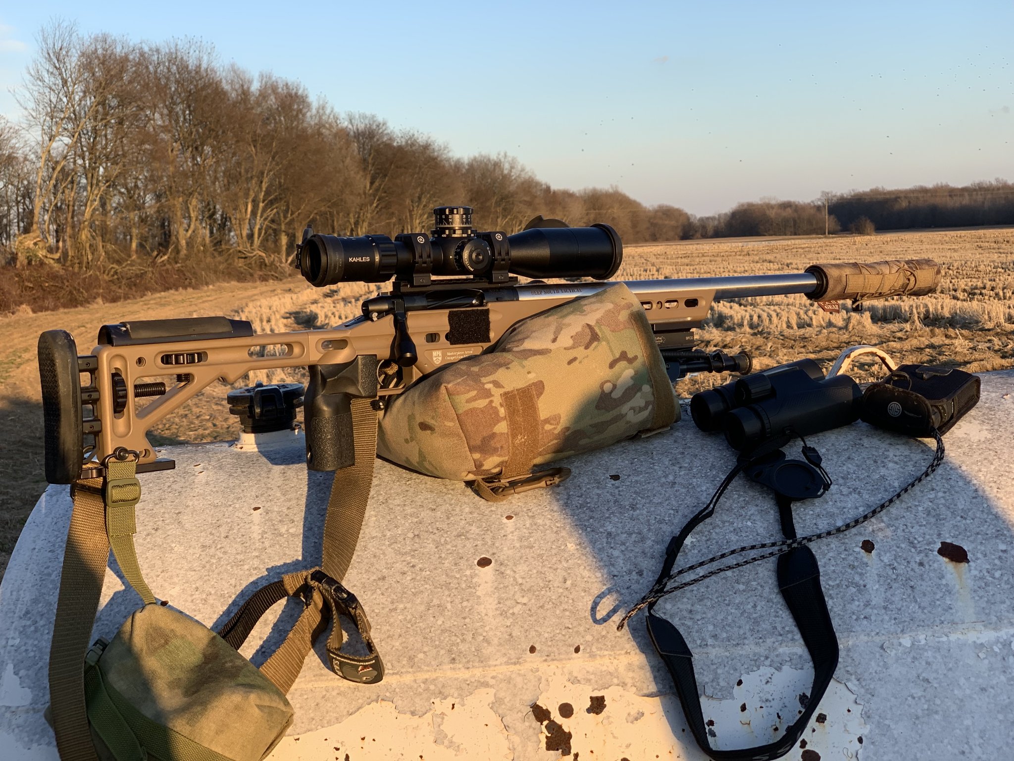

My Bighorn Origin build is still waiting for all the parts to arrive.
6.5PRC
Origin LA Mag
Bartlein 8T Varmint - 26" w/SPR BugNut treatment
McMillan Game Hunter
TriggerTech
Yes - LA Mag. No sense being hamstrung on magazine length. Learned my lesson on the first 6-5284 I built on a 700 SA. Did some testing with the 6.5PRC in a LA mag just to see how it would feed. Let's just say it fed like chit thru a goose - no hiccups what-so-ever.

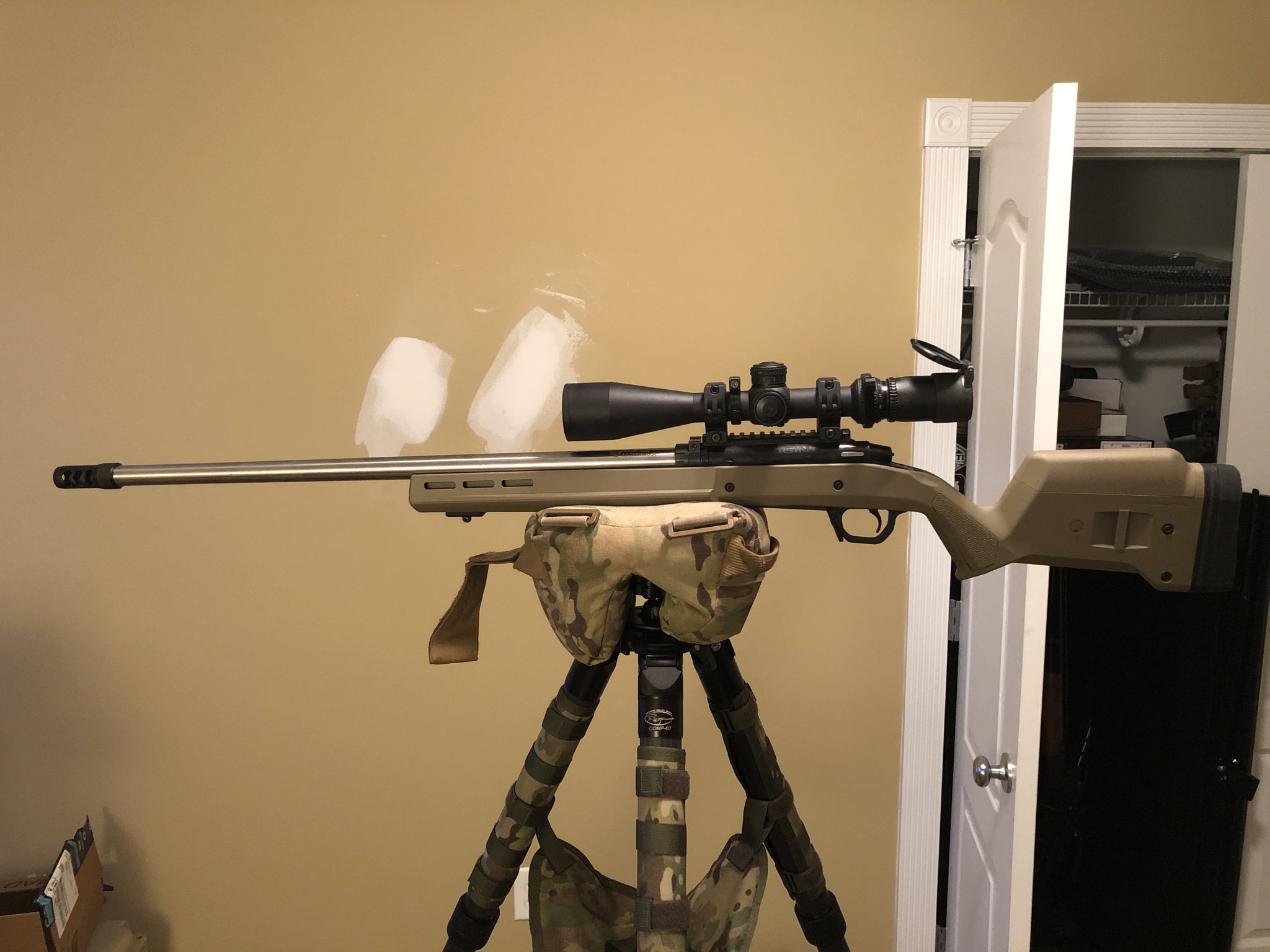

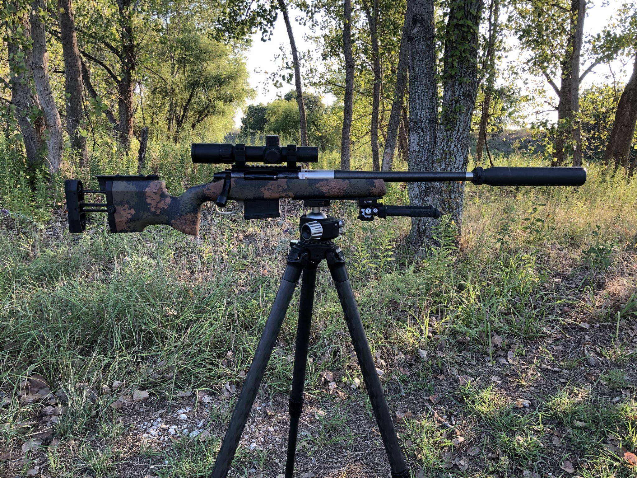

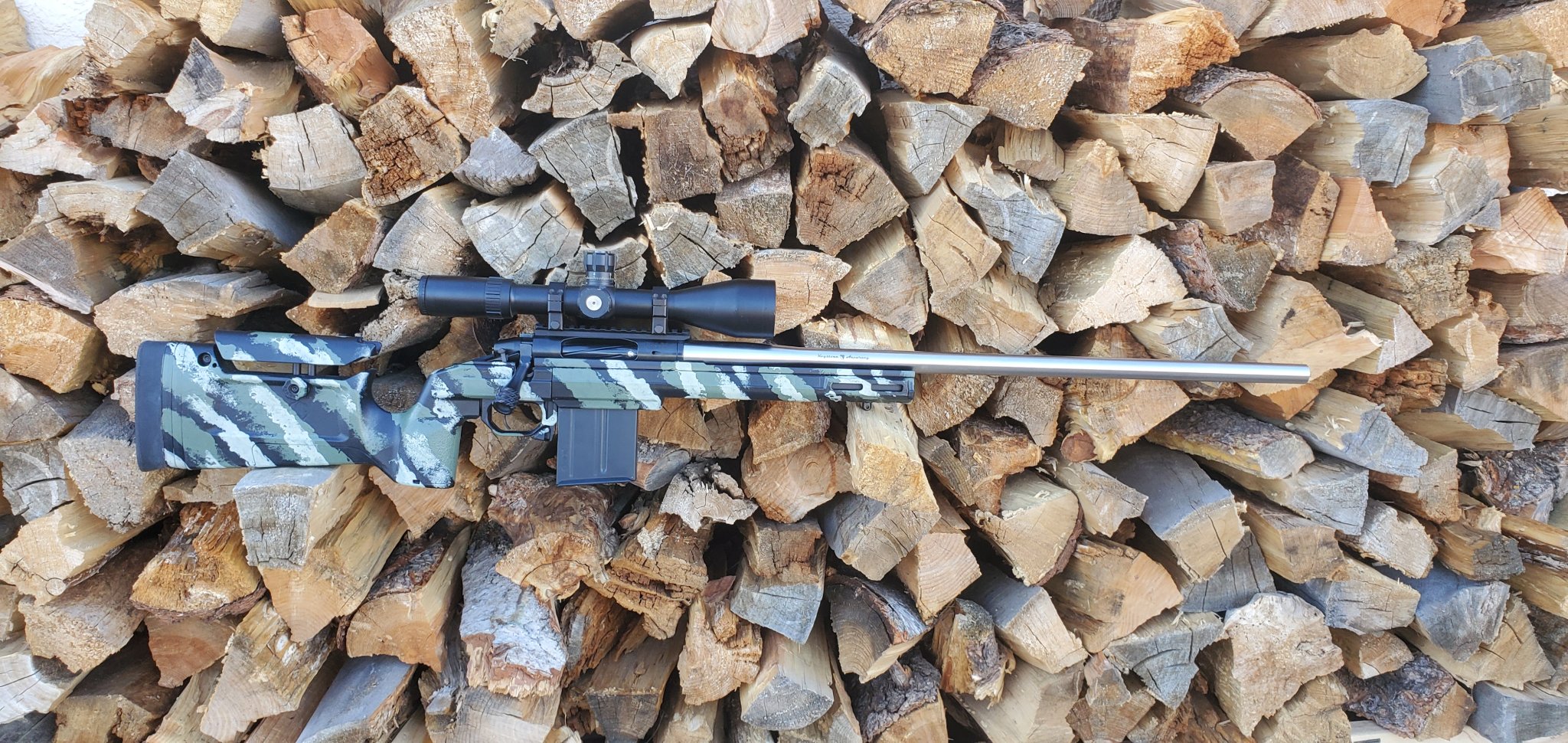

Before everything fell to shit for me I had all of the bits wrapped for this one so I stuck it together.
A&O in Mound City, MO spun up the Green Mountain blank, .243 Winchester with a 1:7.5 twist. Set at 16.5” in an HS Precision inlet for bottom metal. Trigger is a TT Primary. Just going to be a super simple field rifle.

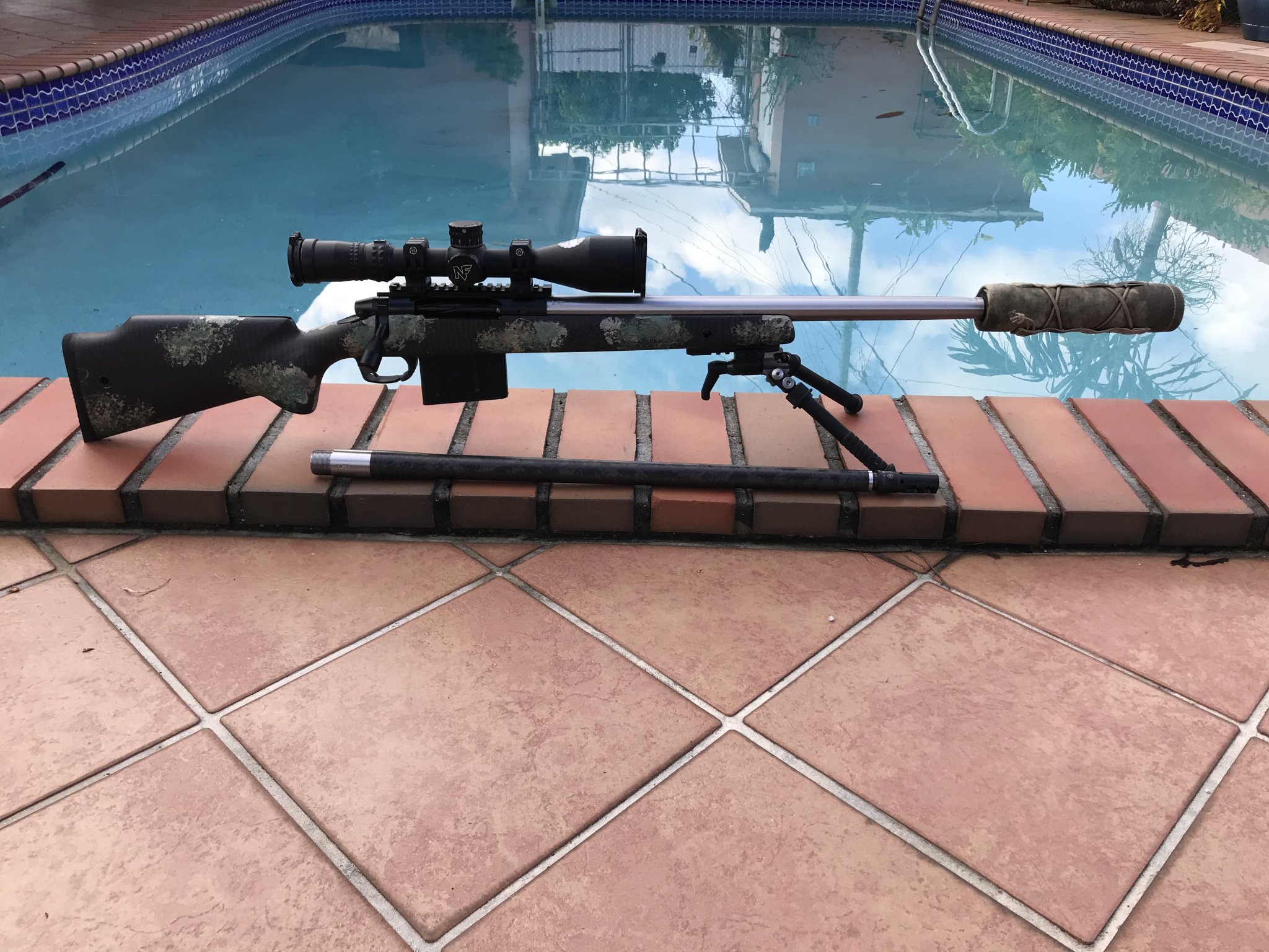

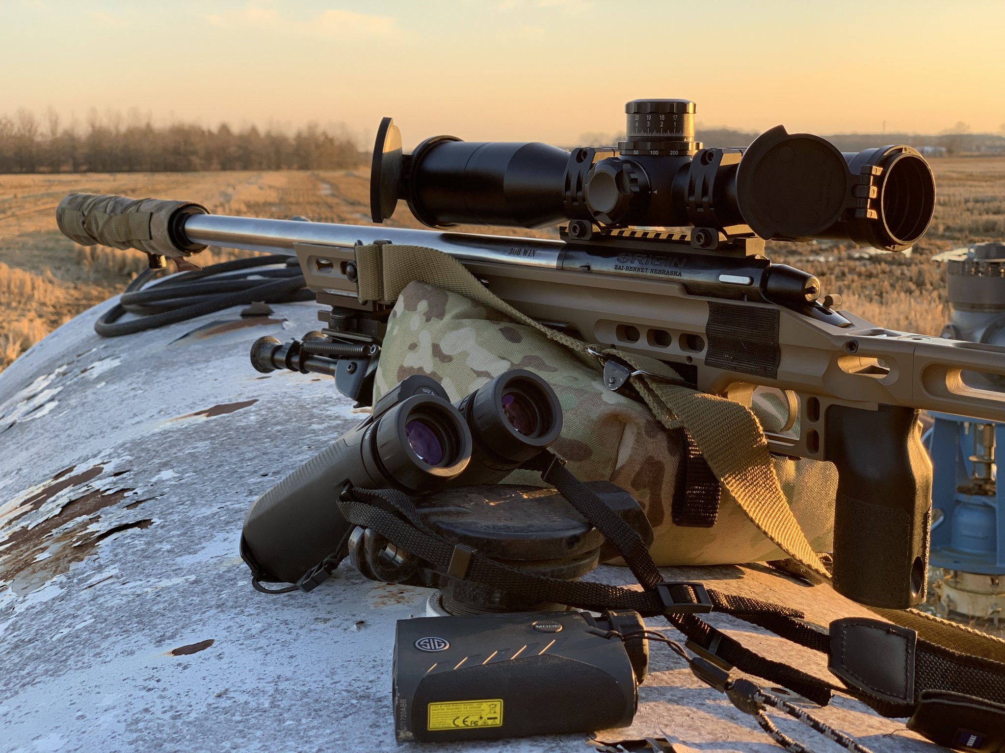

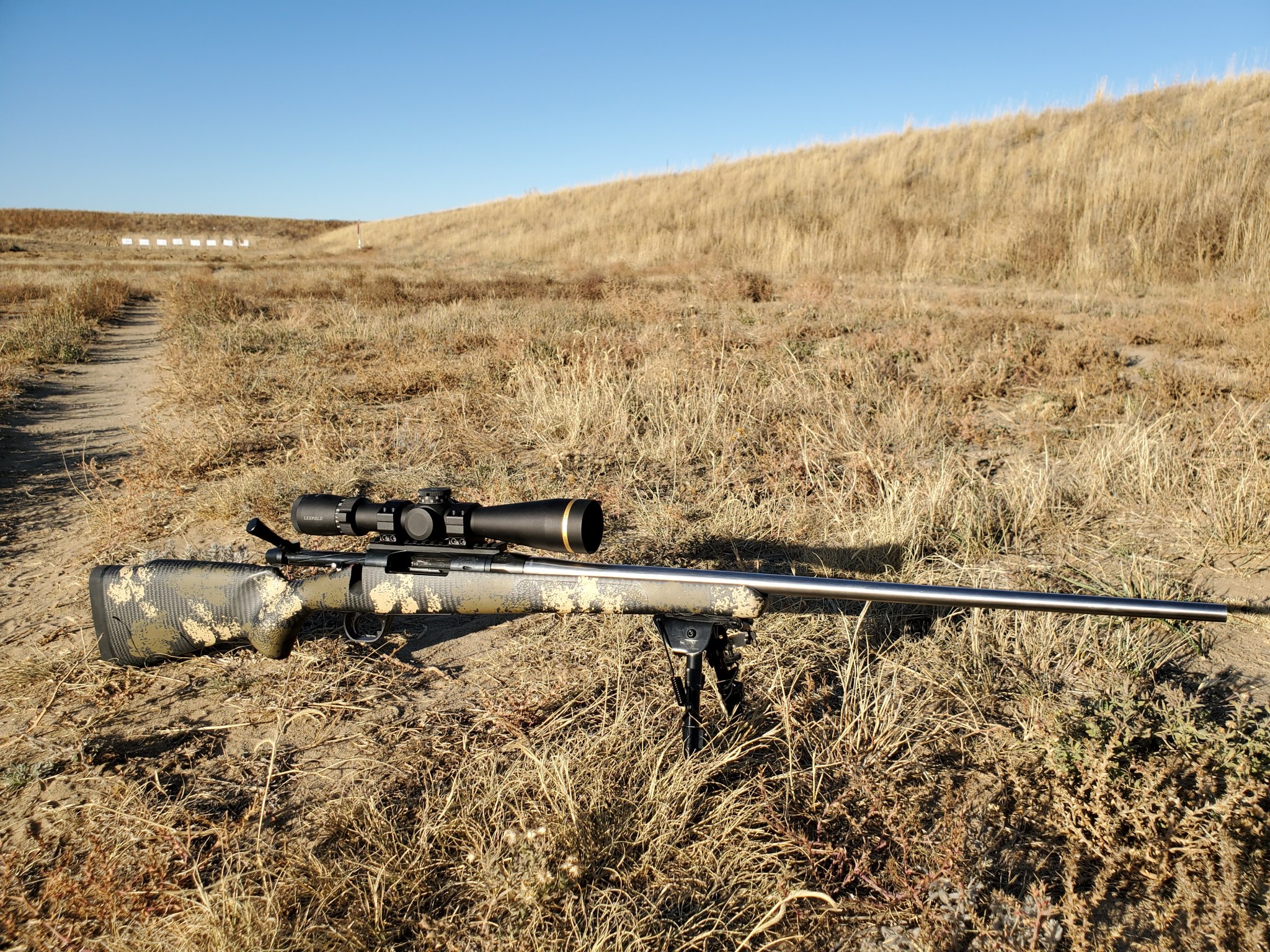

Wanted to post up on one of my two origins. This one is setup for hunting.
PVA Rock Creek #2 26 inch PRC
Geiselle trigger
Manners EH6
Wyatt's extended mag
Hawkins BDL floorplate
Seekins 30mm low rings
Leupold VX-5HD 3-15x44

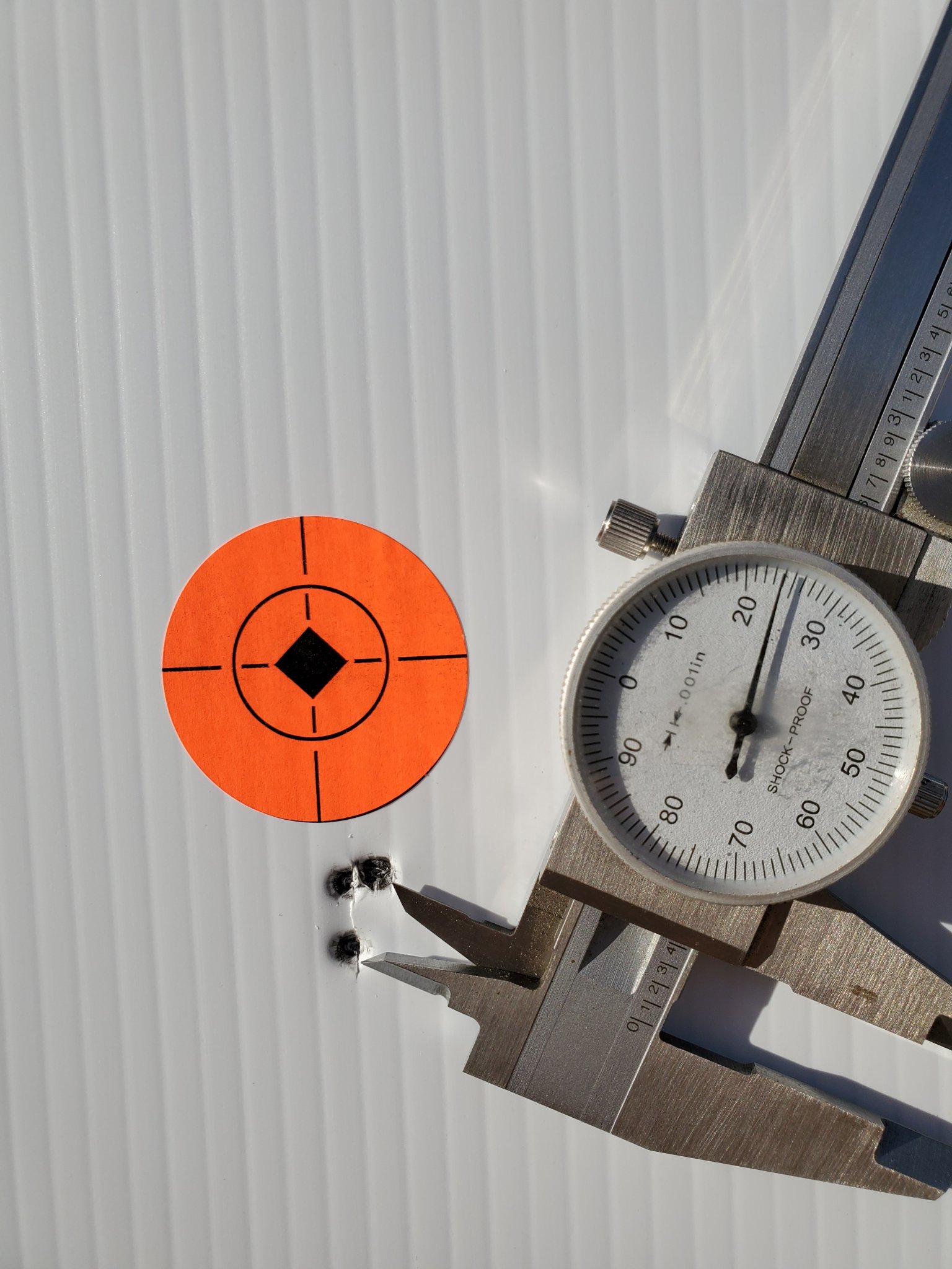

Gun weighs 8 pounds scoped without bipod. Checked zero today at 200 yards. Running 140 accubonds over H1000, 3035 fps. As for how it shoots, see my zero check below. At most 5 seconds between the shots and a light contour. Couldn't be happier.

Who opened up your action for the wyatts extended?
MHSA did it since they're local. They did an ok job, but I had to go in with a file and clean up the back end as the rounds were catching on where they had cut instead of the feed rails. They had cut for the box but didn't punch all the way through to the raceway, if that makes sense. Wasn't a big deal, but it is one of the things Wyatt goes over in his how to video for the extended boxes. Otherwise it was easy, didn't even have to touch the bolt stop.
I don't have anyone local so I may see what LRI has to say. I'm sure they would do it right....and relatively quickly. I'm ready to get this build done.

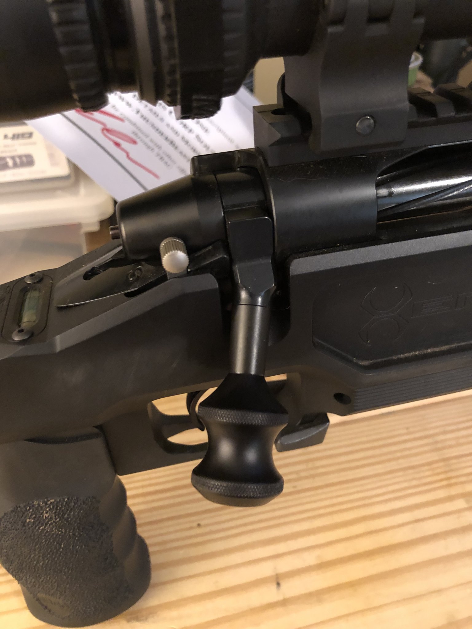

I have an origin along with a tl3 and the origin feels just as solidly built as the tl3. It’s hard to beat the feel of a DLC bolt head on a nitrided body riding in a nitrided receiver, now throw on an area 419 bolt hand extension/bolt knob and it’s a dream.

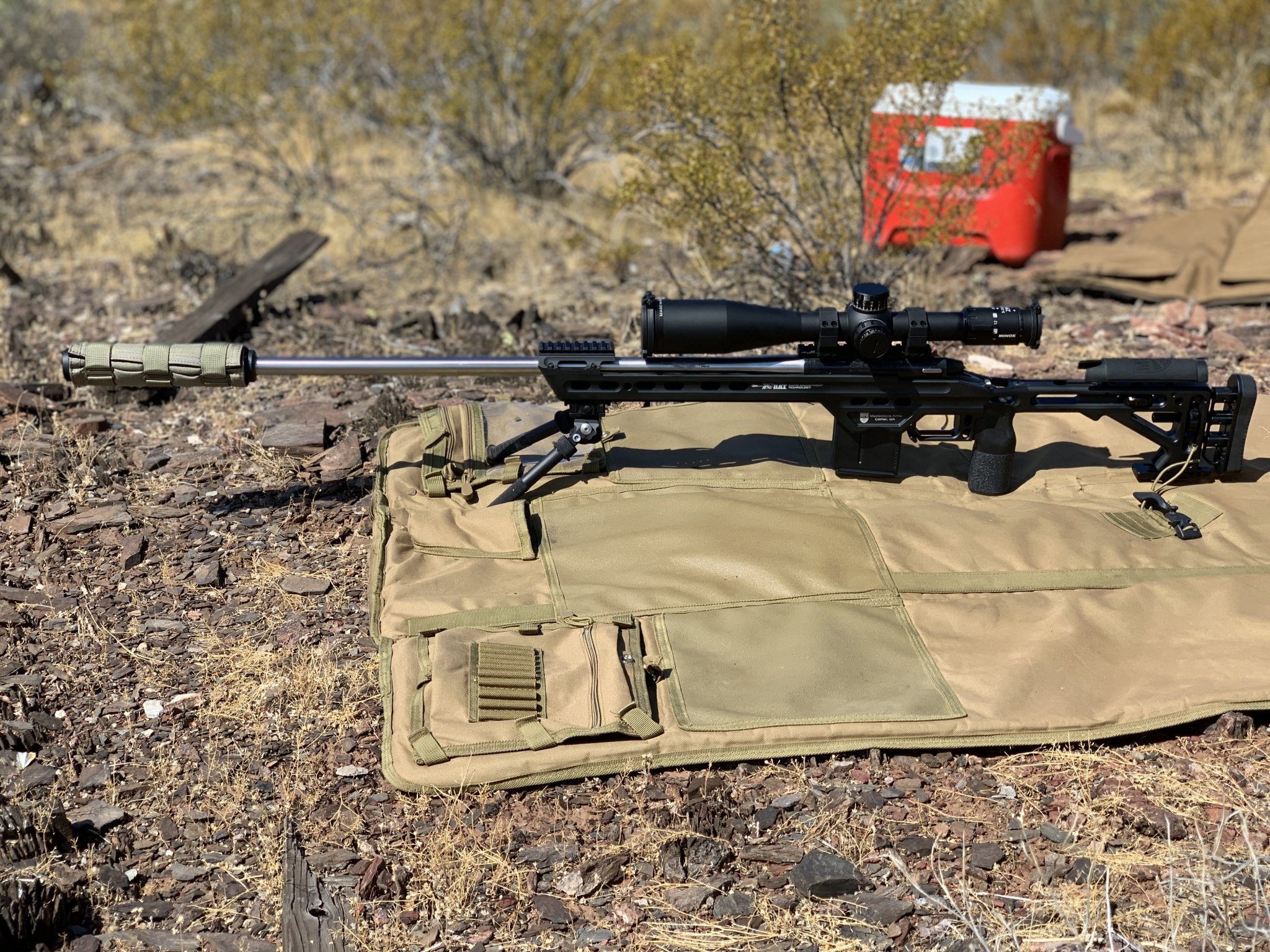

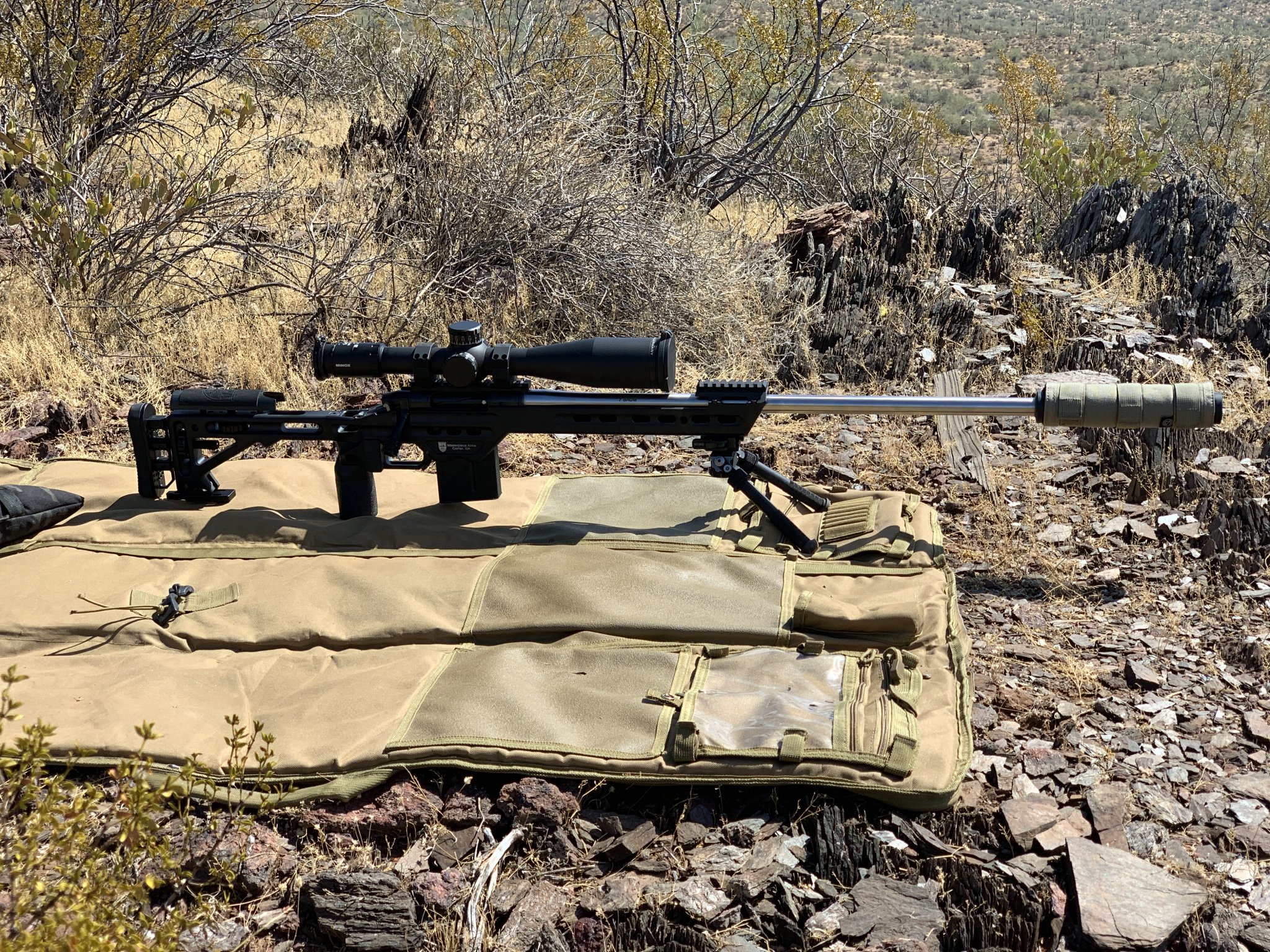

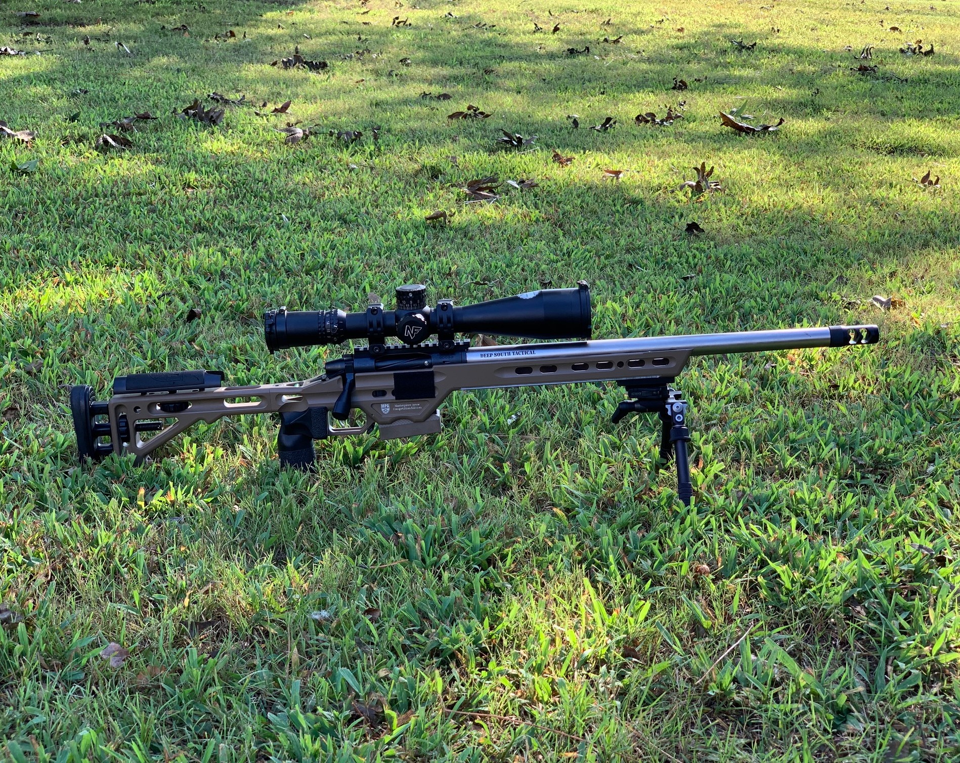

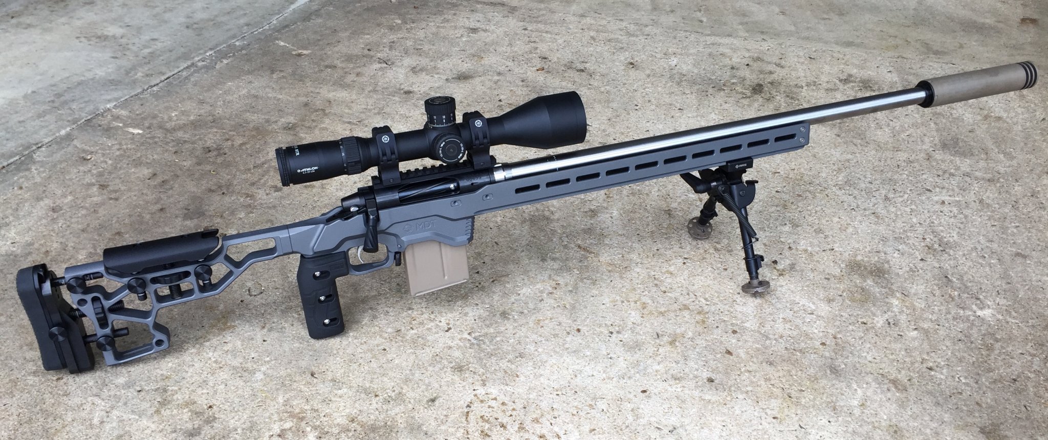

Following protocol I can see so I’ll state the obvious lol
Bighorn Origin (duh)
26” Criterion 6 dasher 7 twist mtu
Bix tac sport pro single stage
MDT acc
Aics+pva kit
ARC M10s
Athlon Cronus btr
419 mount plus omega

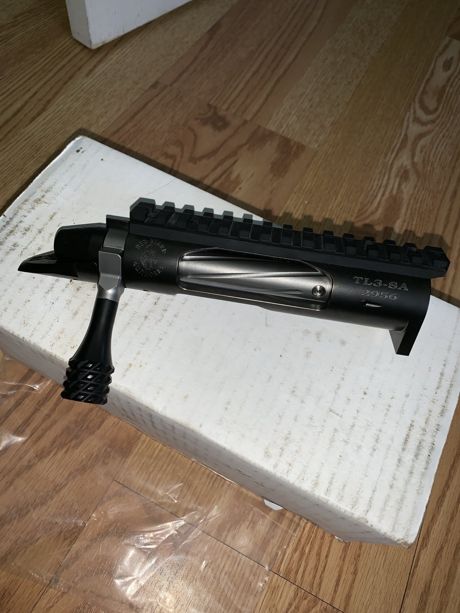

Planning my Origin build now in 223AI. Trying to decide what knob to get with it and noticed you're one of the few people I've seen run the spiral. It's between that or the helical diamond. Any regrets getting the smaller spiral?
Love your set up.
None at all, I had a minicyclone from pro precision rifles on my rem 700 223 and loved it so when I saw it was an option for the origin I jumped on it.
