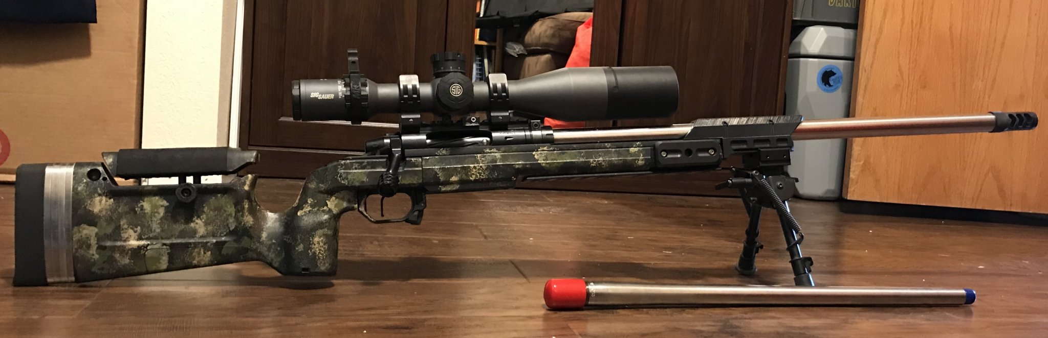

Origins SA W/ standard & 224v boltface
Krg Bravo
Trigger Tech Diamond
Sig Tango 6 5-30x56 Dev-L MRAD
ARC M10
ARC Barloc
419 Hellfire
Cheapskate precision - night vision bridge
6.5CM NSS 1-7.5 26in MTU
224valkyrie X-caliber 1-7 21in medium Palma

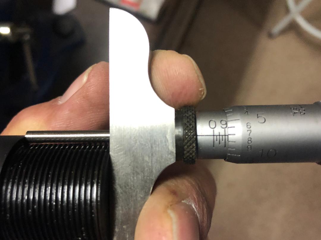

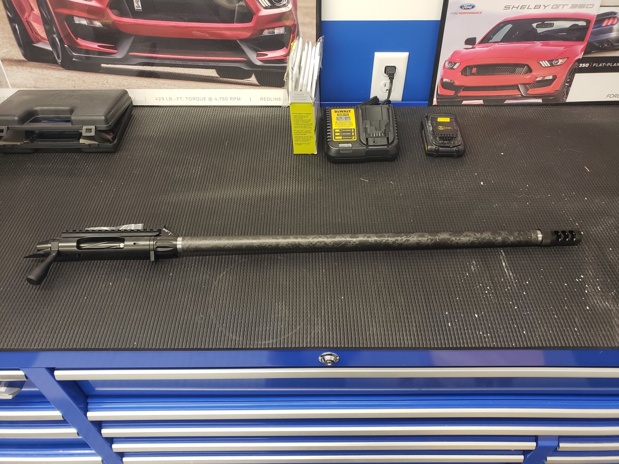

Anyone run in to an origin not being able to close the bolt (without any gauge in chamber) on a barrel? Recently got a new shouldered barrel that was ordered for Origin. Torqued it to 45 lb-ft. Now the bolt will not fully close on the action. It's almost like it has a no-go gauge in there but there isn't any gauge at all. The smith will take it back to look at it but I'm wondering if there are any measurements I can take or other things I can look at to get better idea on if issue is the barrel or the action. Ideas?
Was it cut for a Origin or a TL3 to use the Hunts recoil lug? What’s the thickness of your lug? .150” or .250”
Is the barreled action on a stock? If so, the front screw might be too long and hitting bolt lug. If not, sounds like tenon is too long on barrel and the bolt face is making contact with it. Can you see any marks on bolt head or tenon face?
No, It was just the barreled action. I installed barrels on a short action Origin and a long action Origin last night. Tested both before install on stock as that was suggested to me previously.
Long action was a 300PRC proof prefit and worked great. Had go and no-go gauges and no issues with it. It did hit issues in its stock, an EH1A, where manners didn’t cut bolt handle channel enough for tactical knob but they sent me UPS tag to return stock and barreled action and they’ll fix it.
The 6.5PRC custom barrel does seem to either have issue with tenon or the action itself being out of spec. Anyone know expected distance from shoulder to chamber end of barrel?
I haven’t yet taken the barrel back off to look for impact marks. Will do so tonight.
I thought I wouldn’t need a 6.5PRC set of gauges since it was a shouldered barrel but now I’m wondering if I trust the barrel enough even if claimed to be fixed. May have to get some for it.
No, It was just the barreled action. I a short action Origin and a long action Origin last night. Tested both before install on stock as that was suggested to me previously.
A quick measurement with what I had handy come out to around .882"

Barrel tenon length should be 0.8900" +.0000" / -.0100" per our print.

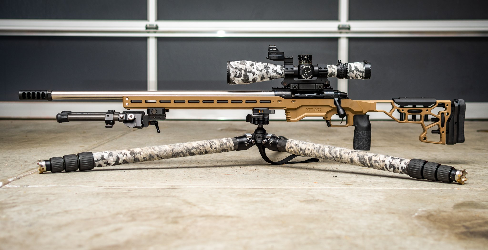

Origin action (obviously)
X-caliber Savage pre fit
6.5 Creedmoor 24 inch MTU
MDT Oryx chassis
Triggertech Primary
Area 419 Hellfire
Arken EP4 4-16

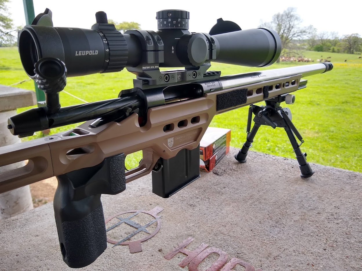

Tried to throw a build together that was affordable but still decent quality. 50 rounds down the pipe so far and already around a half inch at 100 fireforming brass. Probably will upgrade trigger to a TT Special as I have one on another rifle and it definitely is worth it over the primary. Action has been great, however my bolt lift is pretty heavy (almost but not quite Savage heavy) so I’m afraid there might be a little bit of timing weirdness going on. Bolt close has been very effortless and smooth. Any advice regarding the lift would be appreciated. Otherwise very happy with the build so far and look forward to unlocking its full potential going forward.
How do you like the Oryx? Looks nice.
So far pretty good. I like the weight balance on it a lot and it looks pretty good. I have to say I’m probably a little partial to my KRG bravos for the price but that might change a little over time. Probably will be changing grip out pretty soon for something more vertical.
Reactions: 223Pete
How do you like the arken?
Clarity and overall glass quality is excellent. Limited tracking so far seems pretty good. The turrets have a little bit of weird over travel between clicks but it’s not hard to feel what’s happening. The zoom and parallax adjustments are super tight but I’m sure that’ll get better with time. Only serious complaint is that the reticle is way too fine. In sunlight it’s not too bad but if you’re shooting low light or something with a dark backdrop it gets kinda hard to see the center aiming point. Solid scope for the price though.
