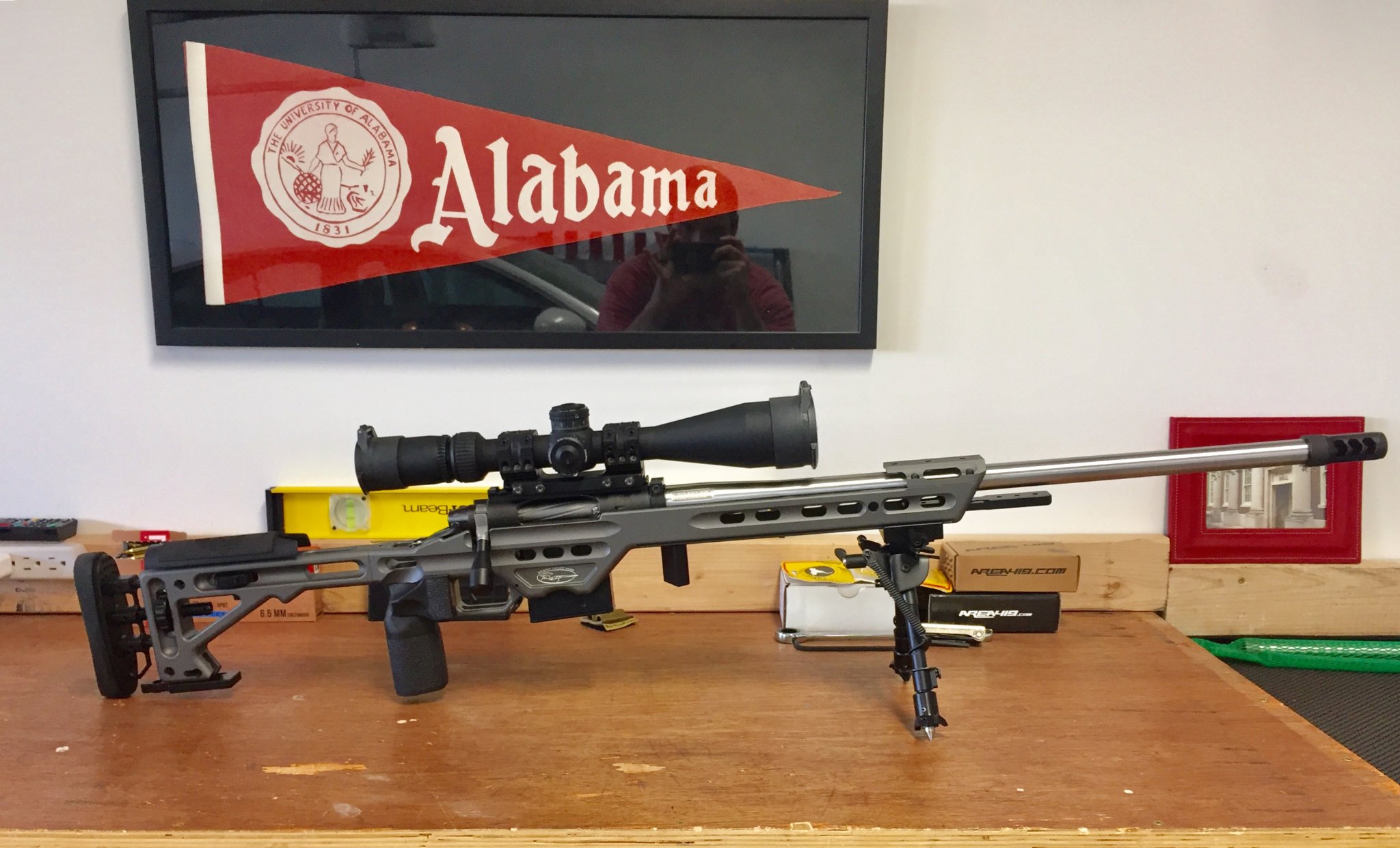

Finally finished!! (but not really)
TL3 Long Action, DLC from bighorn
Proof Sendaro 26" 28 nosler throated for 195 berger
KRG Bravo (place holder for now, stole it off another rifle. Manners EH1 was ordered 2 months ago)
Timney Calvin Elite 2 stage
ARC Rings
Vortex AMG
YHM Nitro can
(I apologize for the miserable camera phone skills)
I got her in my hands and will be shooting 6.5 and 5.56 tomorrow. I am really digging the shouldered BarLoc system. I’ll report more tomorrow. I would like to thank Jeremey and Josh @bohem at PVA for making this happen. I really appreciate their efforts in making this happen in such a tight timeline.
Obligatory picture:

What height spuhr and what color MPA is that? I went with tungsten hoping it would be a little darker.
Reactions: ackleyfan
Do you have a picture?
Best i could get with my phone.

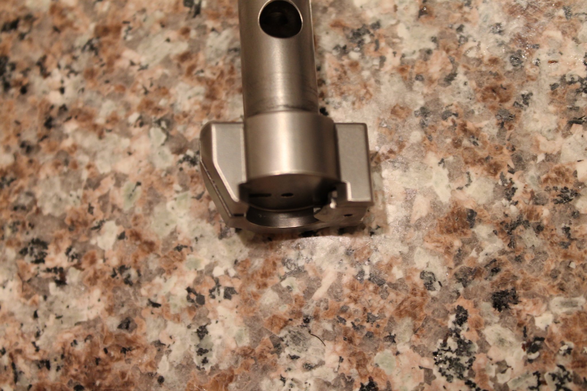

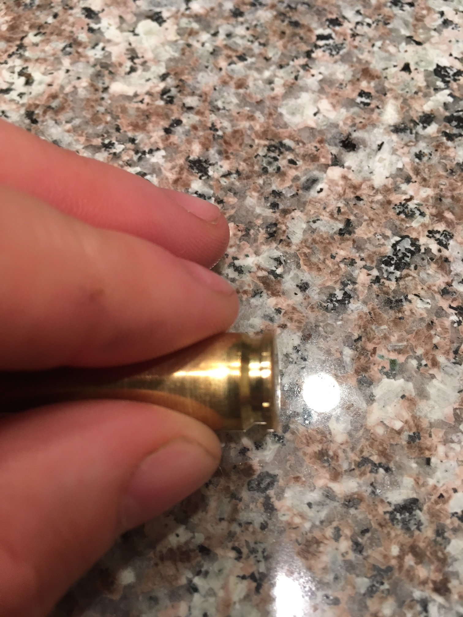

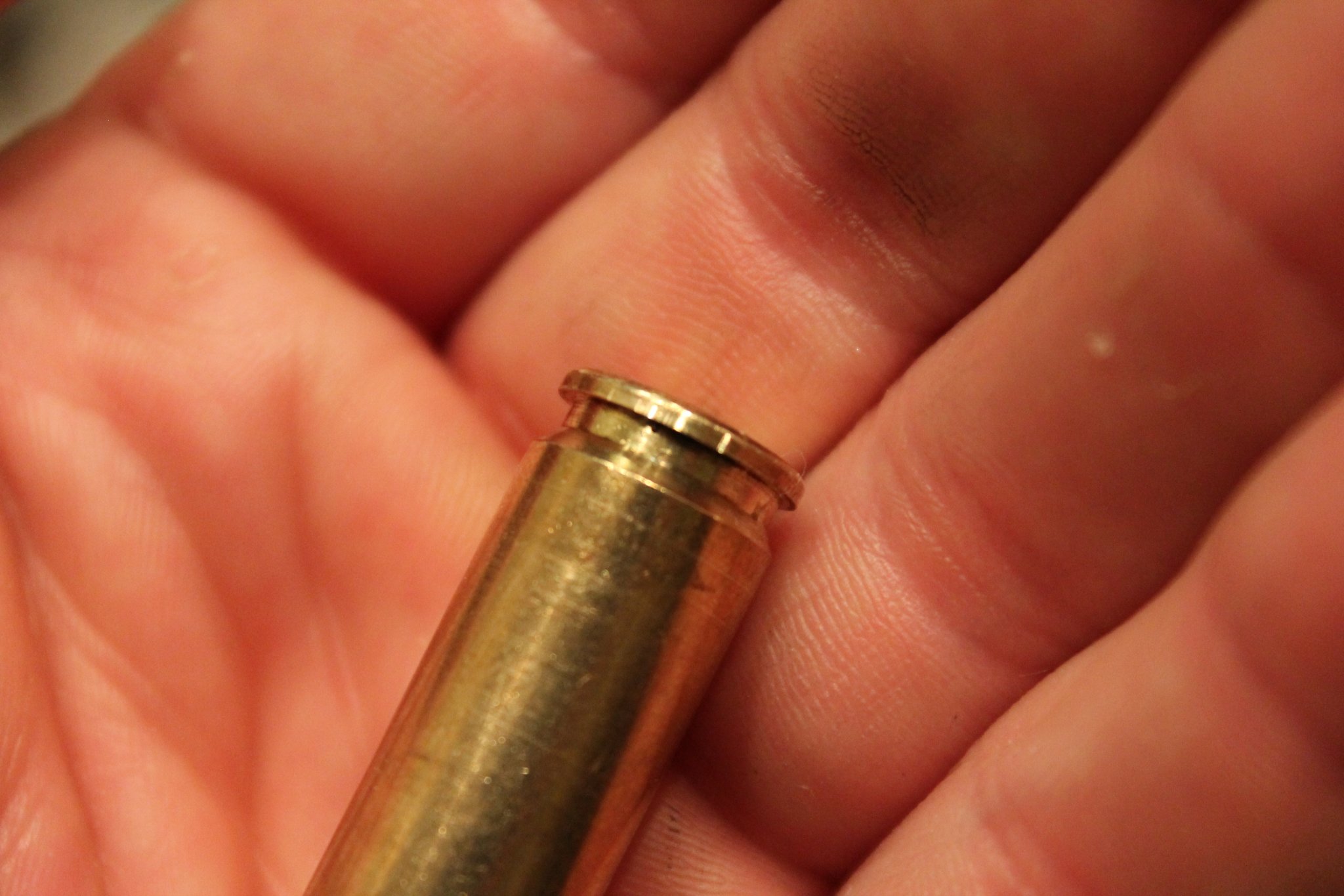

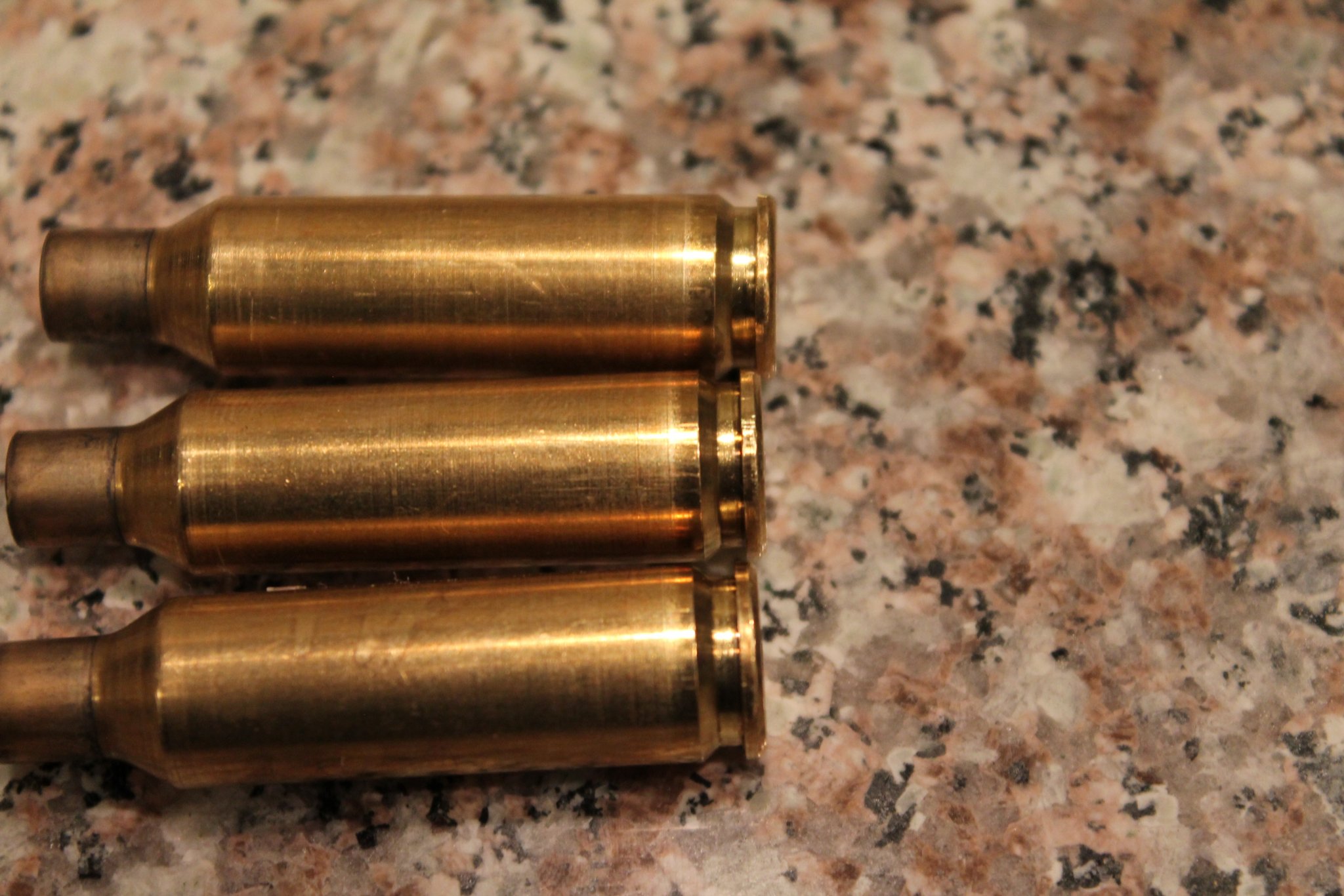

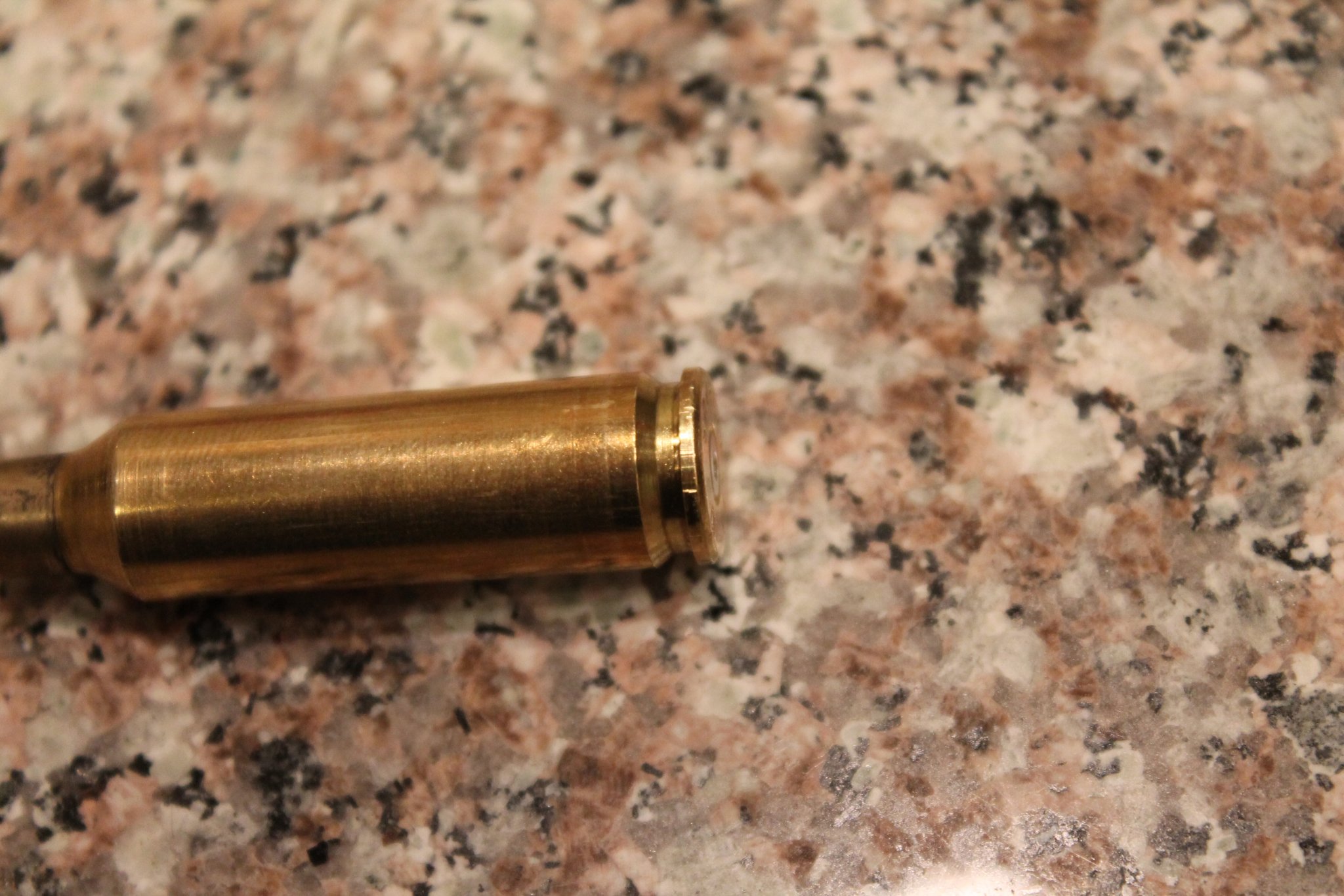

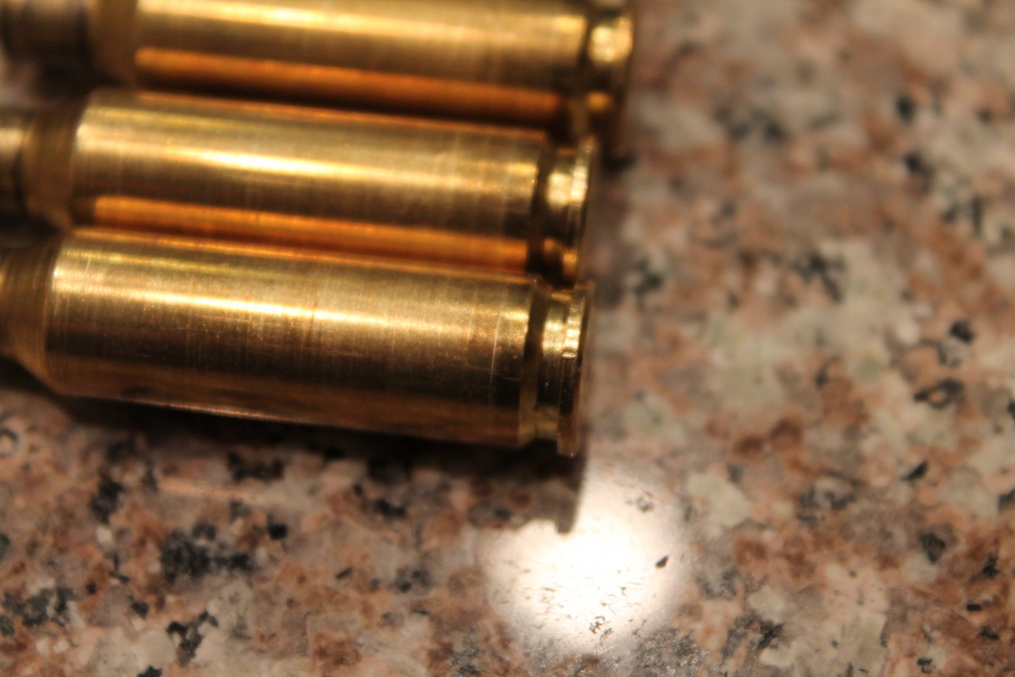

Anyone had there TL3 shave off some of their brass whilst extracting? Like there is a burr butting into the side of the rim of the cartridge and peeling back a layer.
Yep.. pretty common on mine (6 dasher). I believe it's the mechanical extractor cut out in the boltface that does it.
Was pretty annoying.. I've since moved to another action for my high volume shooing.
I assume it’s an issue because i don’t recall experiencing this at all with dads SR3. Wonder if i should take sand paper to it or give bighorn a call? I’m about to send the receiver in for DLC regardless
I never did call them on it.. let me know what you find out
Will do. Just slid the 2-lug action wrench in there, mechanical ejector was in the way. Do they make an action wrench to facilitate the mechanical ejector or do i just have to take it out?
I have Bighorn's action wrench that has a cutout for the ejector, not sure if they ever update their website to show they are in stock or not, you could just give them a call.
Also, I can't really see what your talking about with the brass shaving because your pictures aren't focused. Any chance you could get one in focus, maybe from more distance? I am curious to see for myself what you are experiencing.
Also saw mention of a regular 2-lug action wrench not worrying because of the mechanical ejector? So do i need to send the 2-lug action wrench i got from OTM back? I haven't seen the Bighorn action wrench in stock in forever.
If you could get some better pictures of what is going on, we will be able to work with you. We have had a case before similar to what you are experiencing, and I believe it was an ejector slot issue. It's hard to see in your picture, but it could also be an extractor issue. Any chance you head spaced this yourself? Just trying to get an idea of what could be happening.

Oh, and the "shaving brass" thing ?..........Remove the extractor from the bolt, use crocus cloth and Scotchbrite and deburr the inside edges of it. I had the same problem. When I first noticed it, I put one of my fired pieces of .223 brass into a Wilson case gauge. Wouldn't go all the way in......:unsure:. I looked closely and founds burrs on the neck side of the rim, which were large enough to keep the case from going all the way into the gauge. Lightly sanded down the burrs on the "test piece" of brass and it dropped right into the gauge, properly. To me, a very minor detail, easily fixed.

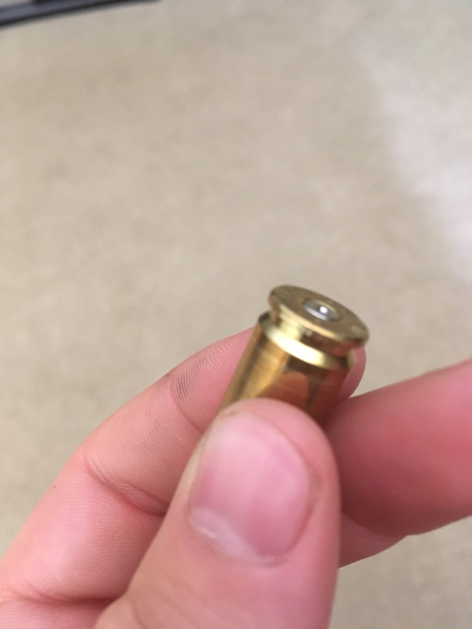

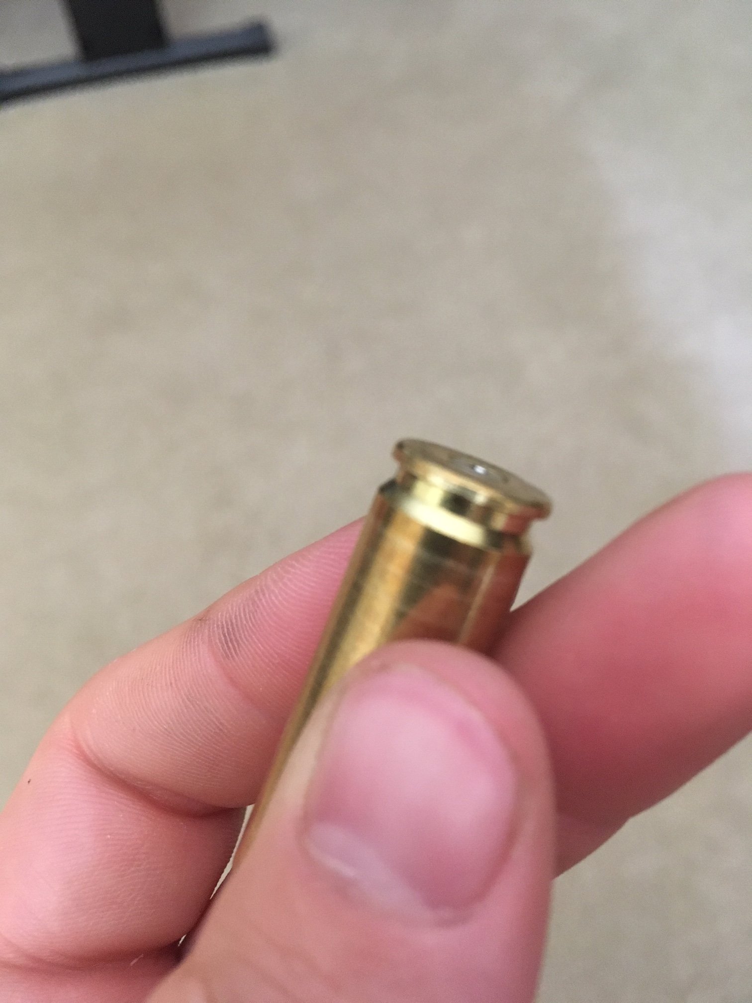

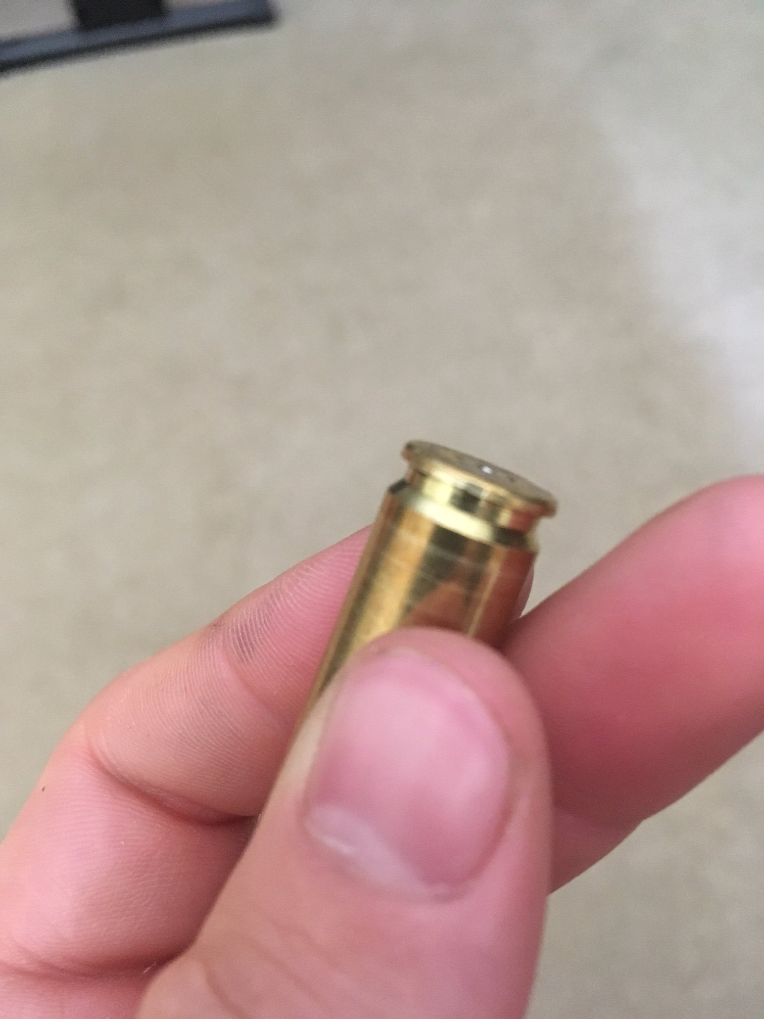

I'm going to find a better camera, phone couldn't get it. It's just a sliver of brass shaved off the rim.

Is it difficult to take the extractor out to see if there is a burr under it? Seems like it's happening upon extraction after firing. I'm going to look at our SAUM brass now but i don't ever recall having this issue with the SR3, could just be a small burr or maybe a piece of brass is lodged up under there?

To remove the extractor, you need a small pin or punch to press the detent and spring down to slide the extractor out. It slides easiest from outside to inside the bolt face for removal. Keep your hand over the extractor once it moves out of the way because the detent and spring have a tendency to fly away if you don't.

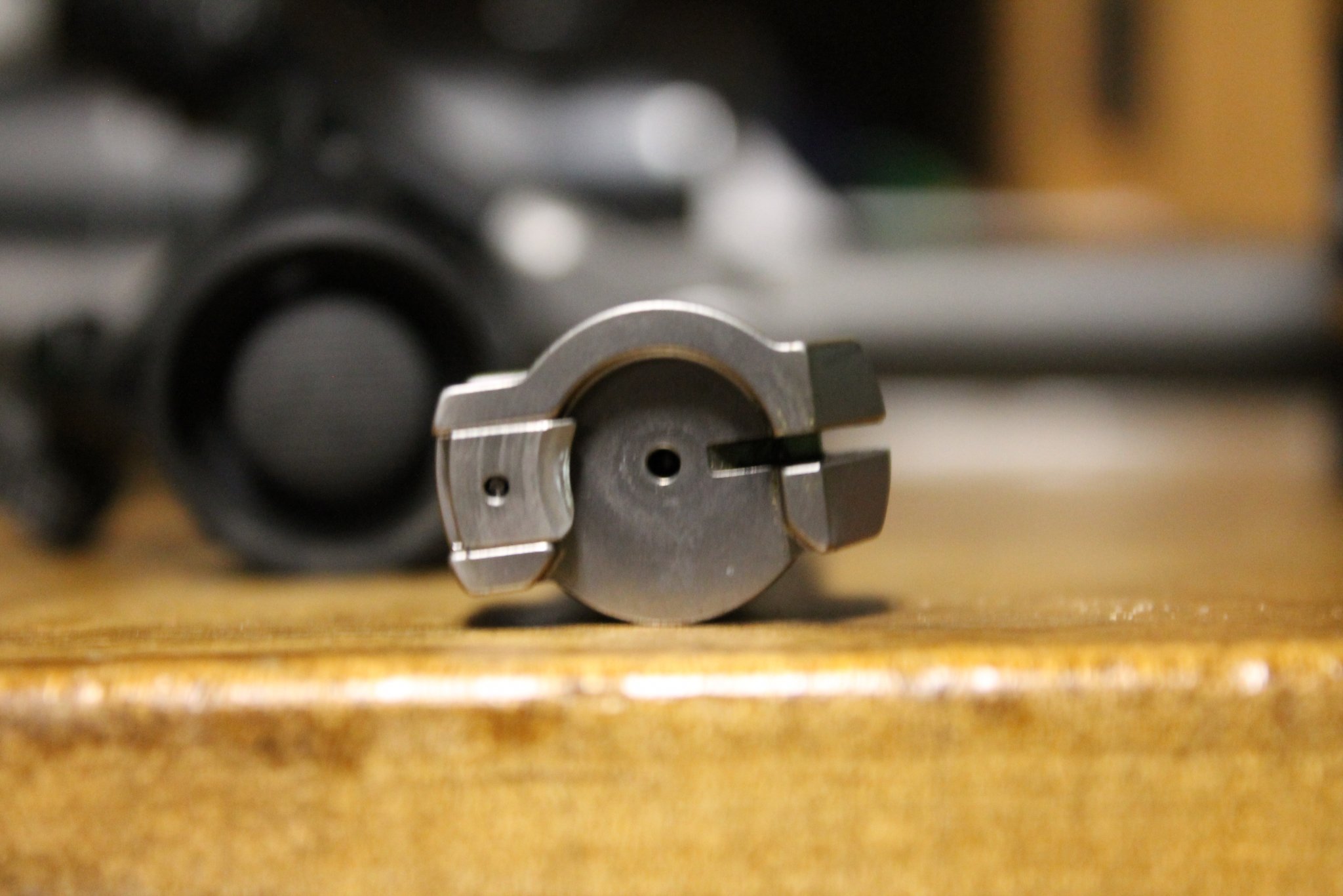

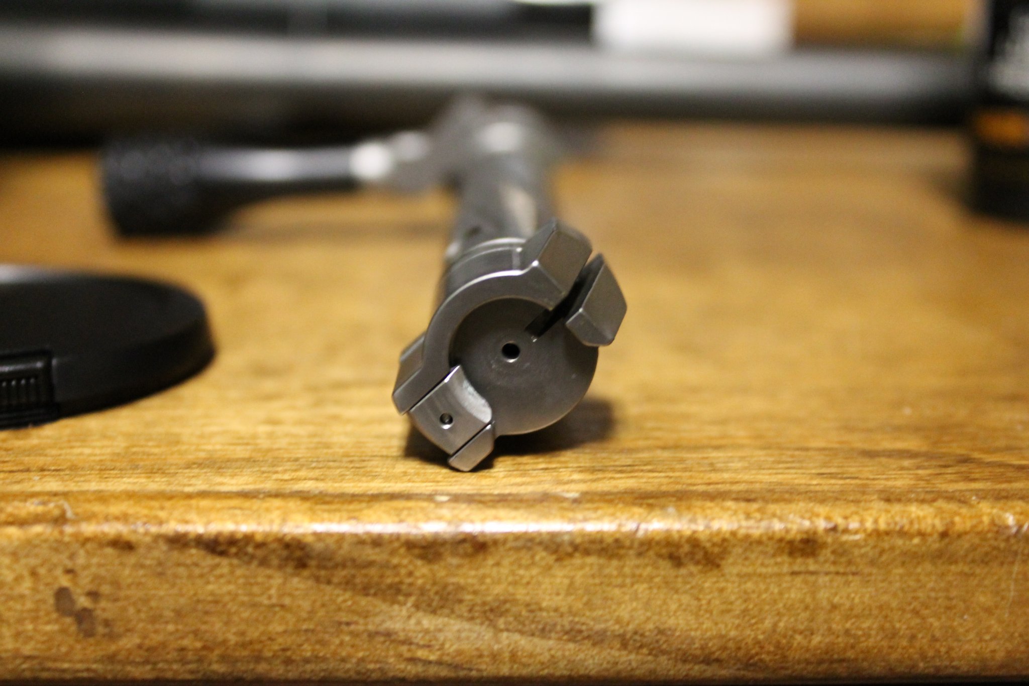

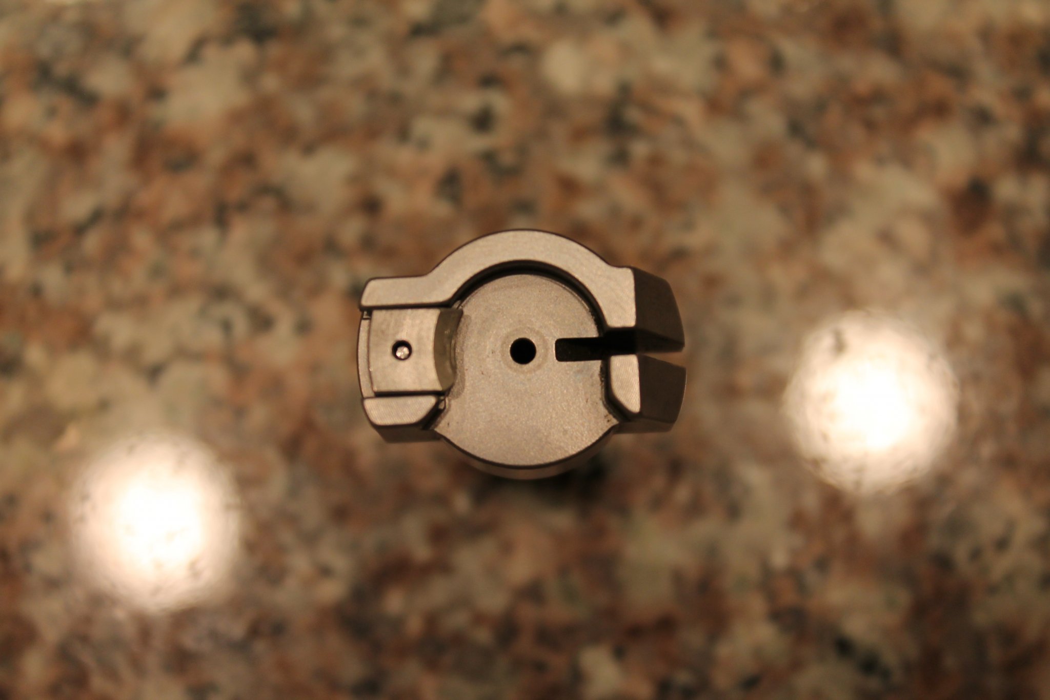

Ok, one more thing..could you take a picture of your bolt face as well? It's one of two things and I've got a decent idea on what it is but seeing the bolt face will make that prediction much easier to confirm.
Thanks - Ray
Sure. Think it's pressure? I'm not immune to the fact that i'm running a stout charge with my 6.5x47, though it's often a norm among many 6.5x47 shooters, could just be the brass flow in bolt face under the extractor?
It's what I thought...your extractor is bad. It appears that at some point the bolt was closed over a head space gauge. The extractors are not hardened so gauges have to be slipped under the extractor when used or the extractor needs to be removed before you use a head space gauge. I'll get a new one in the mail for you today.
Thanks - Ray
Thanks - Ray
I can't believe i didn't think about that. I have a video of the smith doing just that when he tried to match my chamber to my Tempest. I was freaking out when he did so but didn't notice anything upon originally using the action. Which admittedly my Tempest falls on a no go with minimal to no effort, which i attribute to it being disassembled by three different people after it's chambering. Though they're both very close, within 1-3 thou as i use the same sizing die for both chambers.
Thank you Ray, i really appreciate it. Holler at me if there is anything i need to pay.
