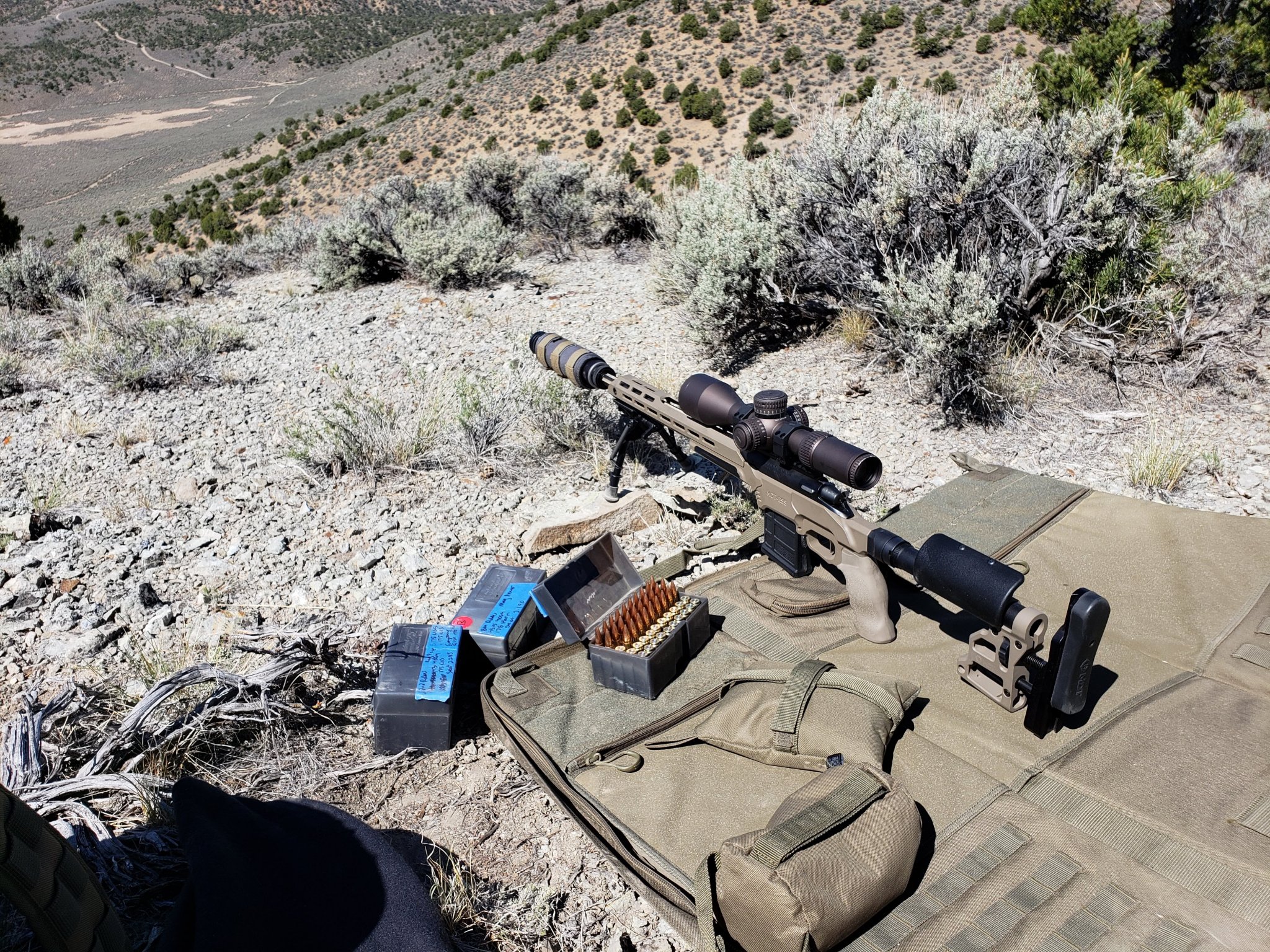

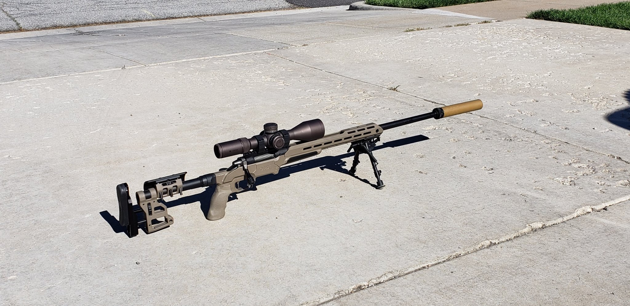

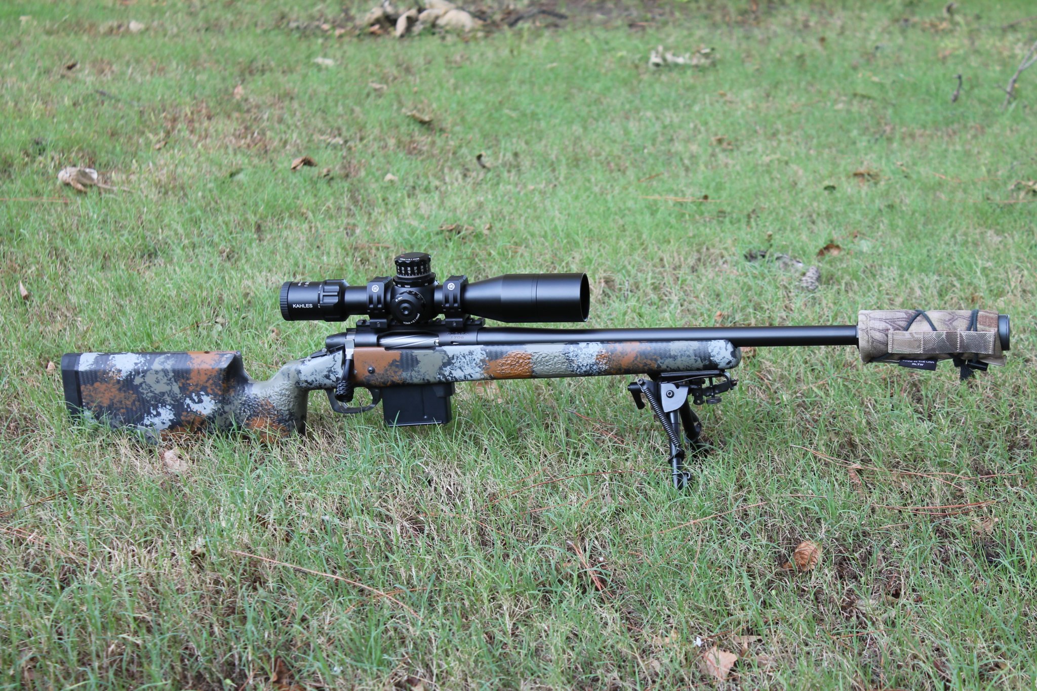

Thanks to everyone in this thread! It helped me acquire everything I needed to put this together with no headaches. I slowly gathered parts and assembled it in about 15 minutes. Very easy build. I'm still waiting on my optic and rings to arrive from Vortex...looks like it might be another month or two. This is my first custom rifle and I am excited to see how well it will perform. My current Remington 700 5R in 308 will need a new barrel soon and I wanted something to shoot while that is being done.
I learned a few things and I probably will change the barrel contour when this one is shot out. I am not competing so the weight doesn't bother me too much at this point. It might once I start hauling it around to go shoot at some of my long range spots.
TL-3 SA with Factory DLC coating
Bartlein 1:8 M40 contour finished at 26" (Prefit done by Southern Precision Rifles)
Manners T4A in GAP with carbon shell and mini chassis
6.5 CM
Heathen Brake
Trigger Tech trigger

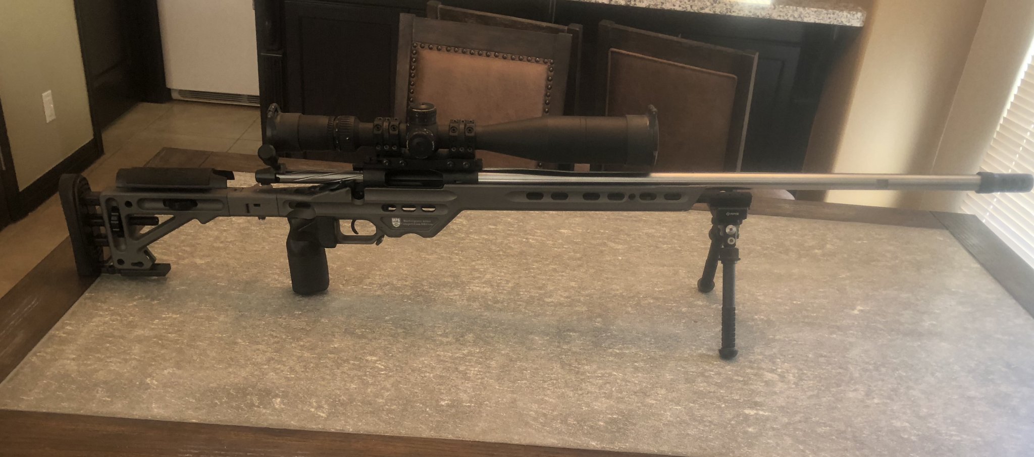

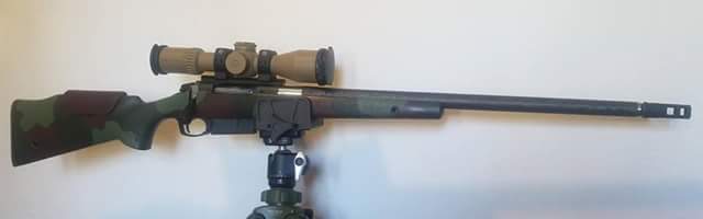

My dream hunting rifle...
Patriot Valley Arms full build
6.5 Gap4s

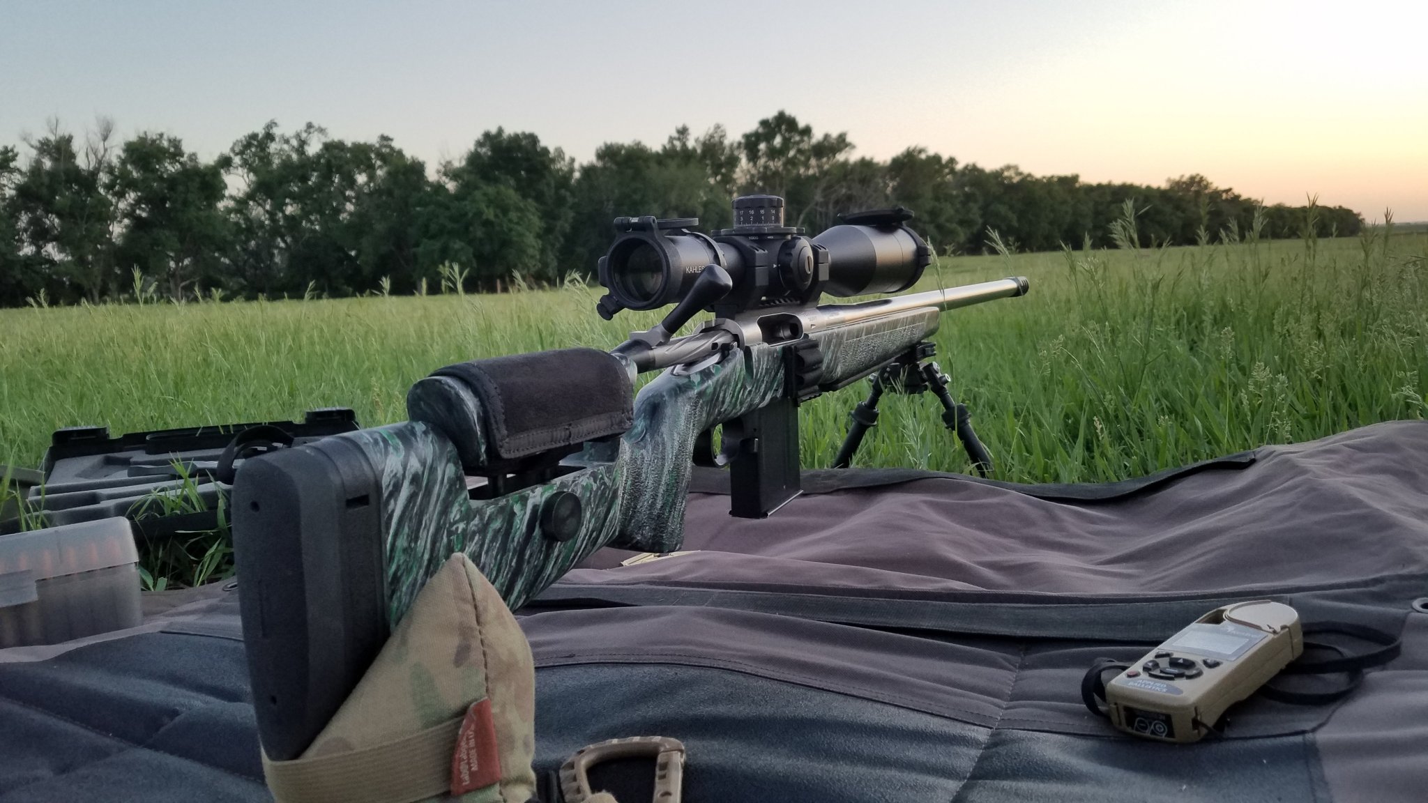

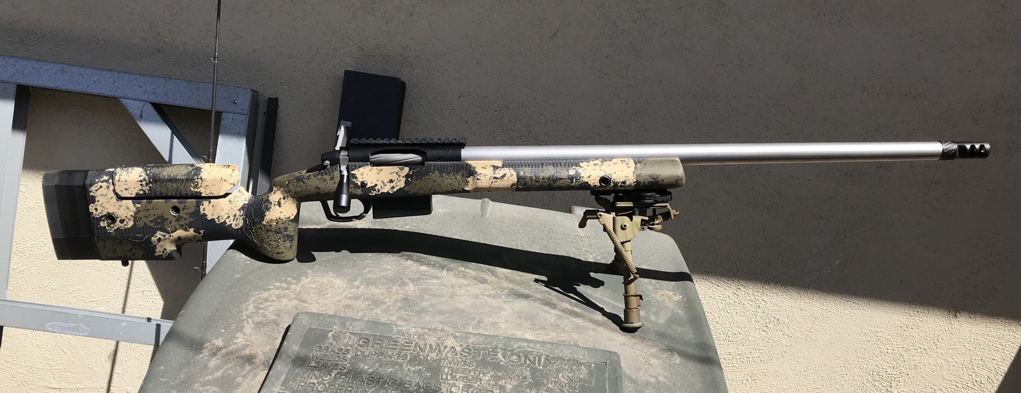

Bighorn TL3 DLC
24" Proof Sendero 1-8" w/Surefire MB
Mcmillan HTG M40A1 forest camo
Badger M5 enhanced bm
Timney CE 2 stage
S&B 5-20 US MSR in .94" ARC M10
