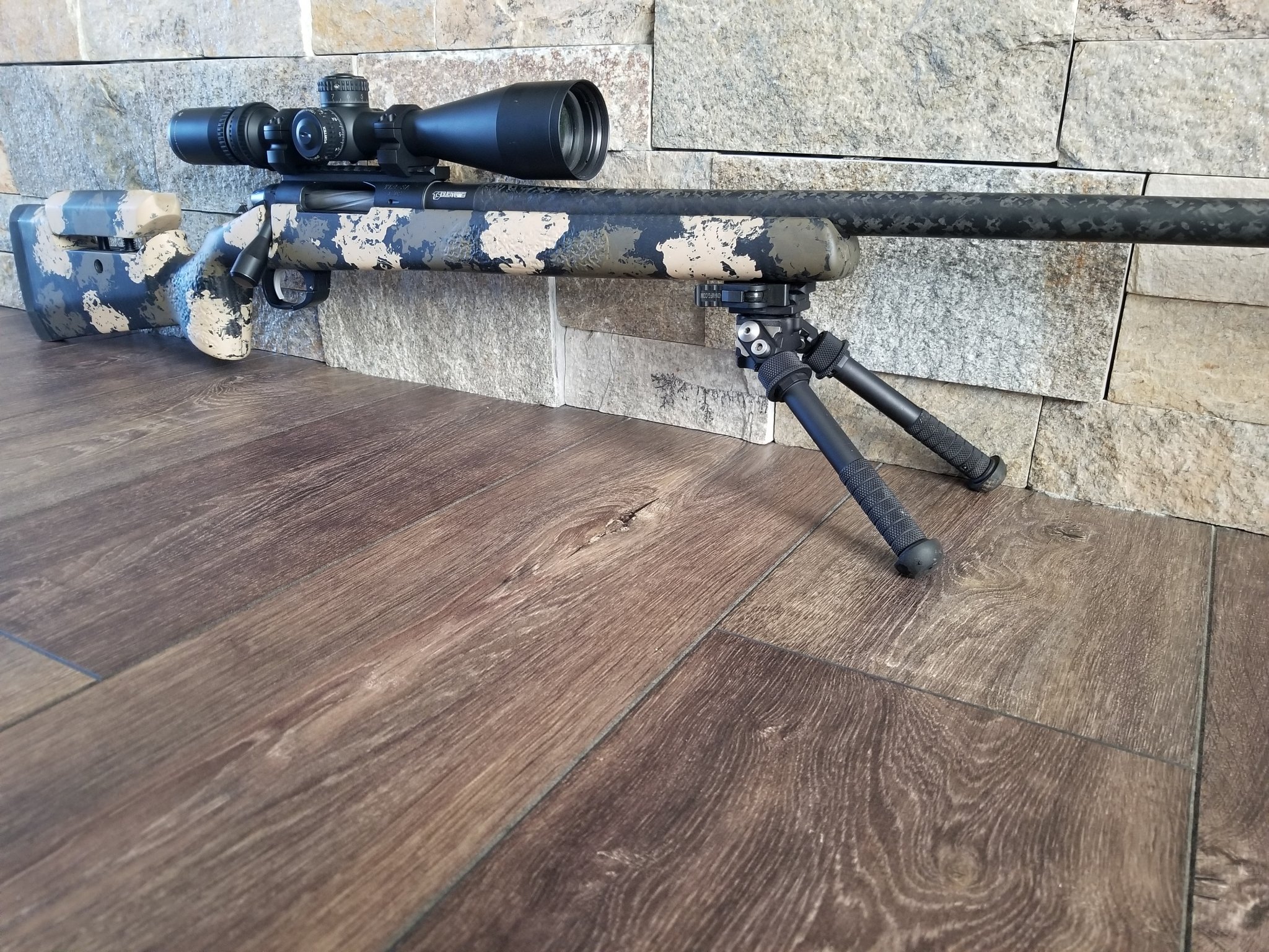

Well, first rifle build is done. I got a little loose Friday and ordered a new Kahles 525, so just have the mount situation left to get figured out.
It’s in 6.5x47 and I’ll start off with the RDF, just since I have so many of them on hand.
Lots of help/advice on this site, whether on this build process, reloading, or general questions.
Padom, Sheldon N, SuperSneakySniper, JLR, Reubenski (still looking for someone doing shouldered profits that will do wrench flats)
Started here:
Ended here:

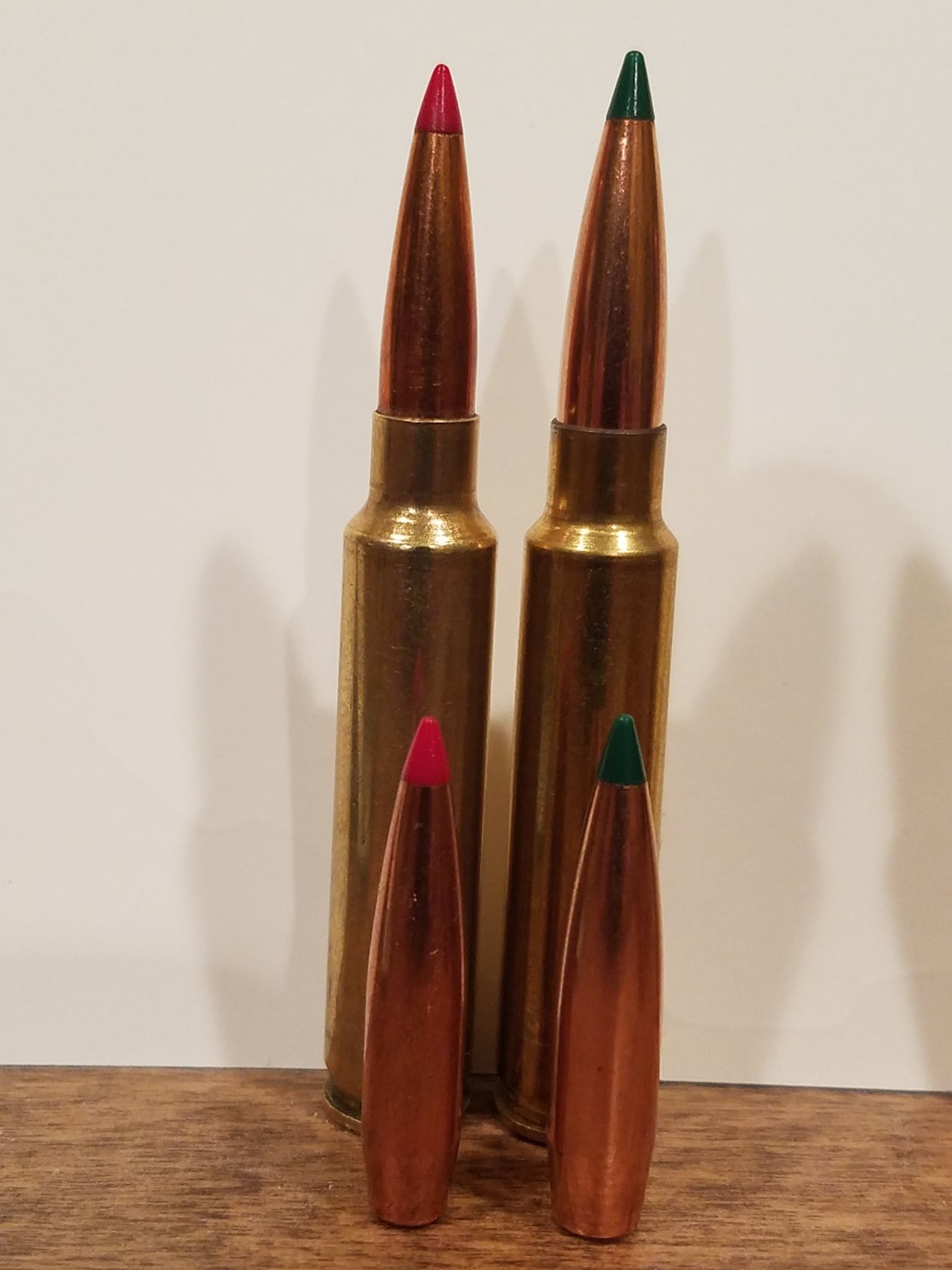

I'm at three actions and seven chambered barrels, with three blanks waiting for a reamer. There is a dedicated comp rifle, a backup that's a bit lighter which serves the role of a 'tweener, and a sporter weight rifle for hunting.
Kids and I really enjoy the 223AI and so I figured what the Hell. I am able to use my Redding 223AI dies with a diff bushing. The kids have fireformed some brass with 87gr vmax, but have not gotten to any load testing yet. Throat was set up for the 95gr TMK.
