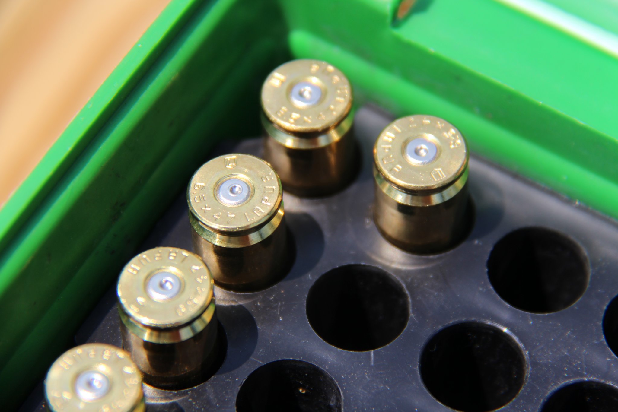

My Dasher is done! I have formed 50 pieces of brass so far. A bunch to go.

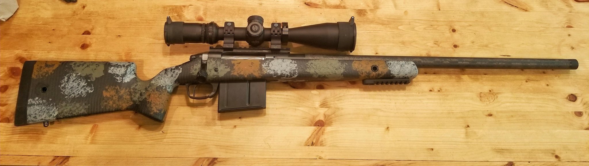

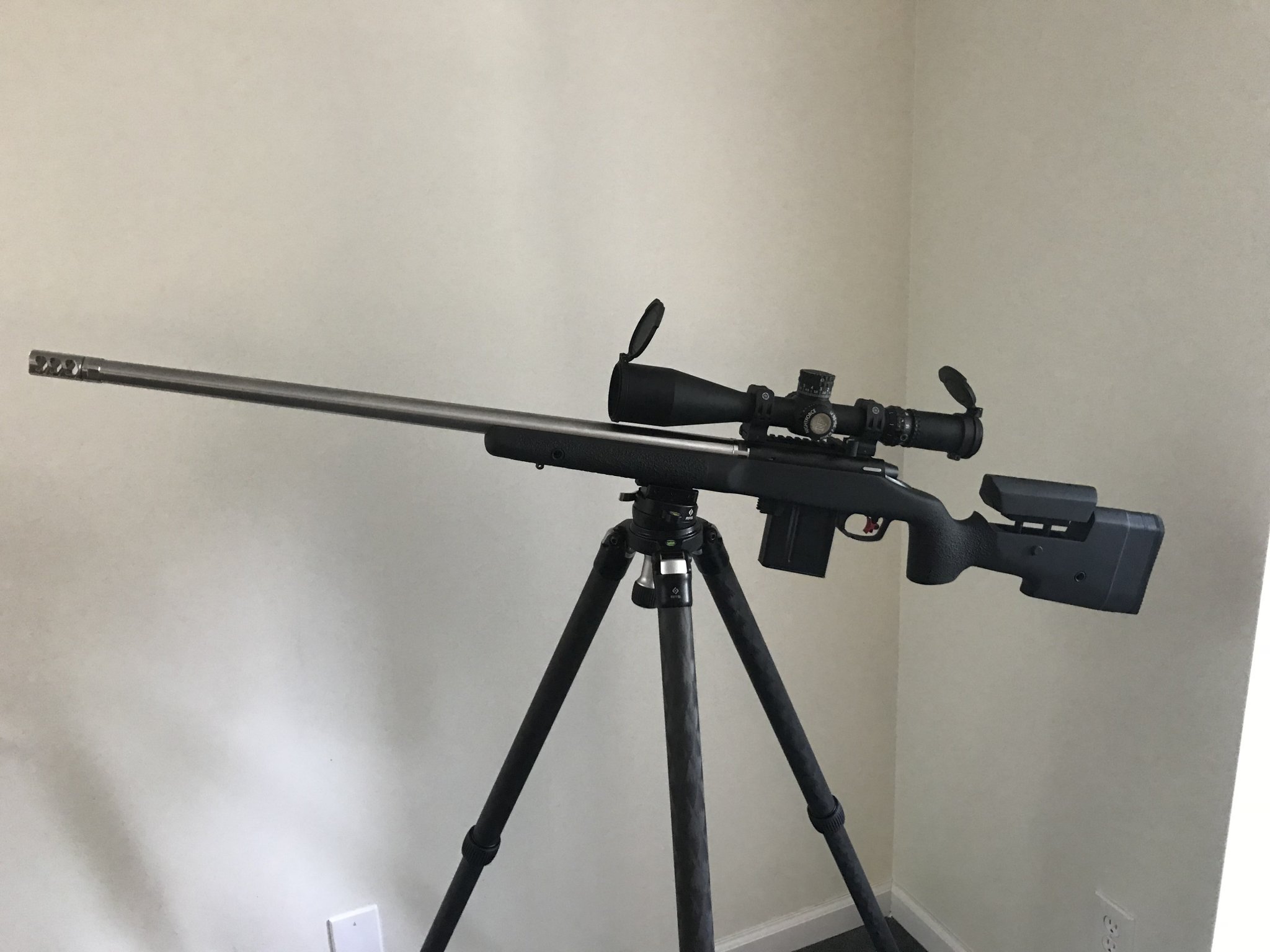

Well, after getting tired of the Manners wait and building around the MPA, got the call that my Manners was ready a few days after putting the rifle together. Switched it out before ever even firing with the MPA :rolleyes:. Now sits in a T2A-gap with mini-chassis and 419 Arca rail. The Kahles 525 and MPA scope mount are new as well. Pretty pumped about this setup.

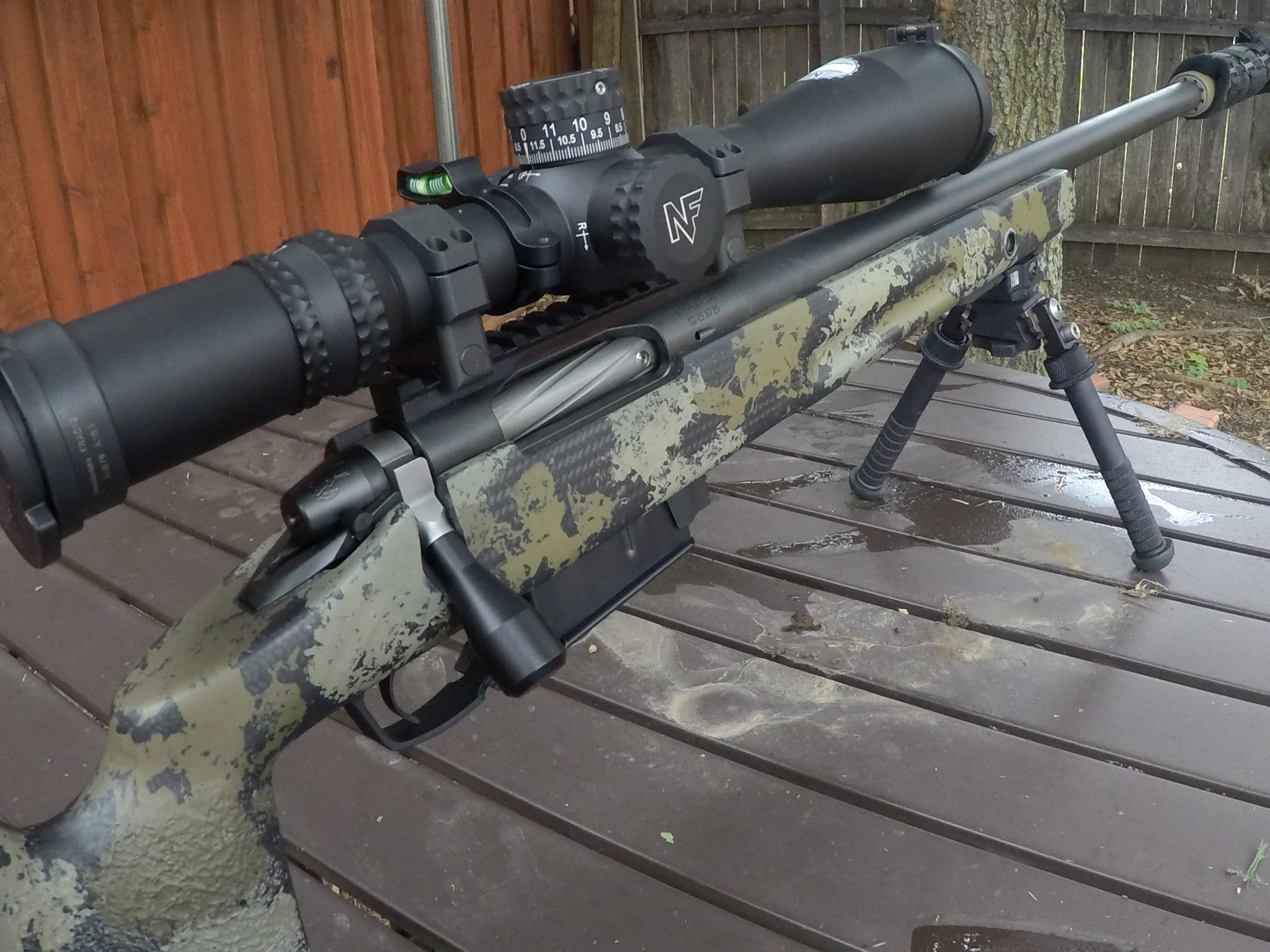

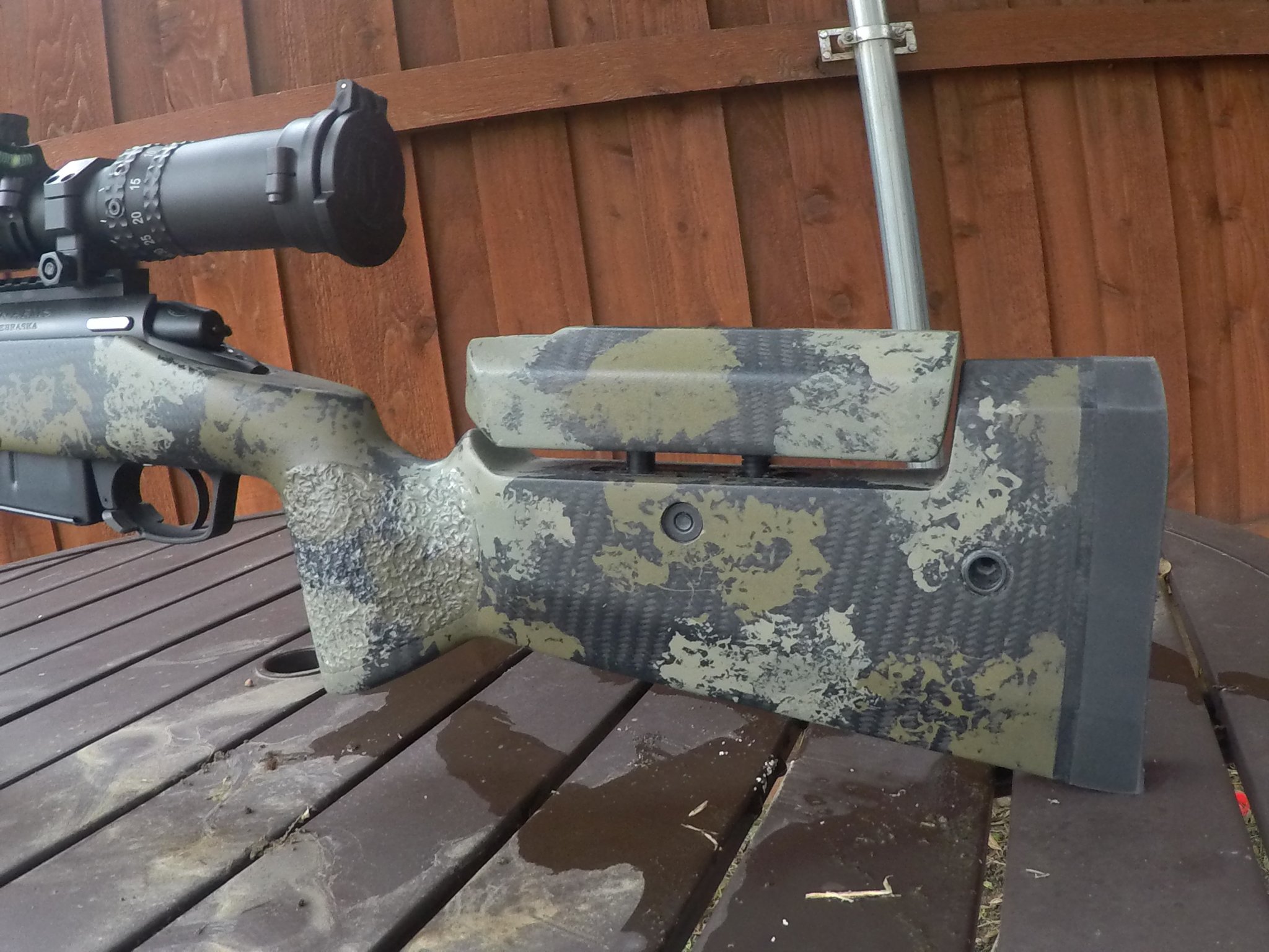

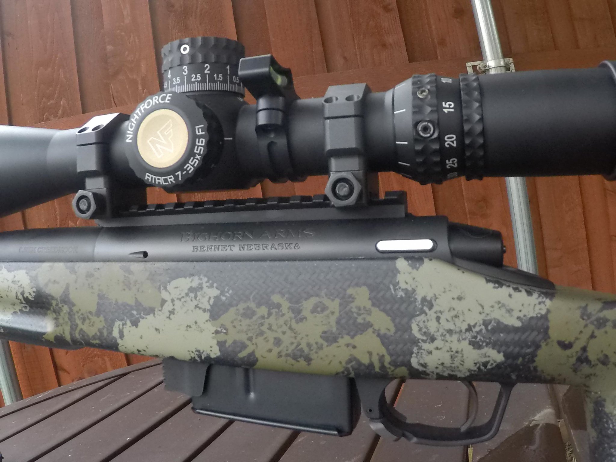

Just need to glass bed and it will be done . Manners et6a in Swamp, Bighorn TL3 Dlc coated , trigger tech , badger m5 enhanced , Bartlein Heavy Palma finished at 24" chambered in 6.5 Creedmoor ( chambered by Spartan Precsion ) , Badger rings, Nightforce ATACR 7-35 tremor 3, Accuracy 1st bubble level ..

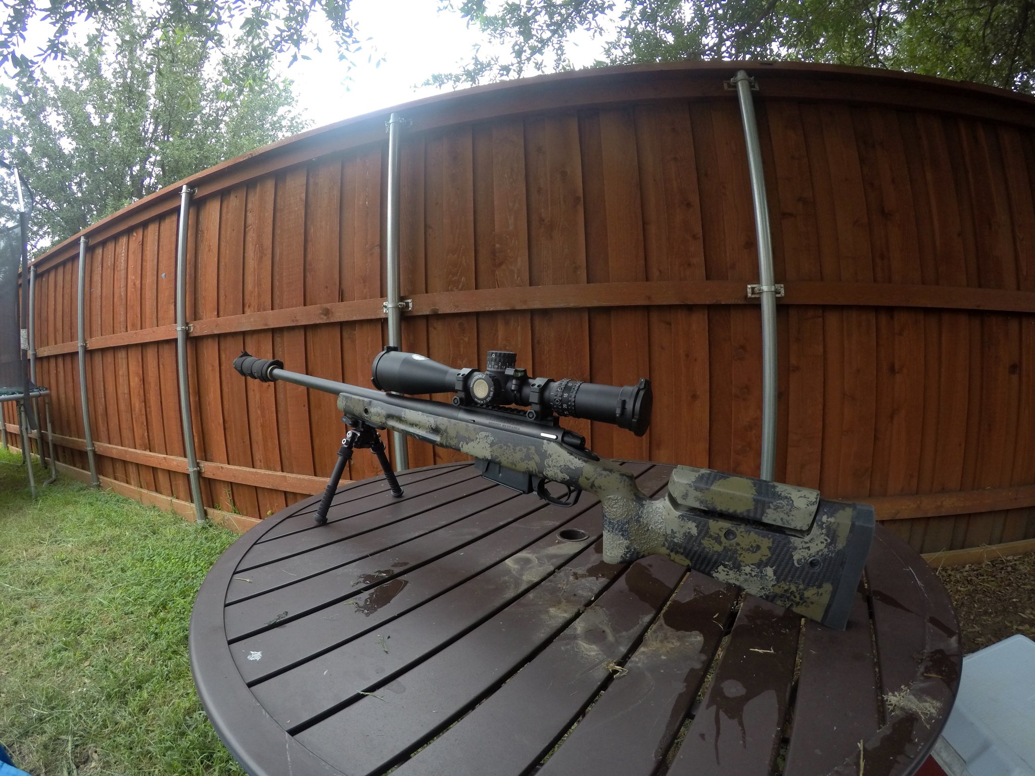

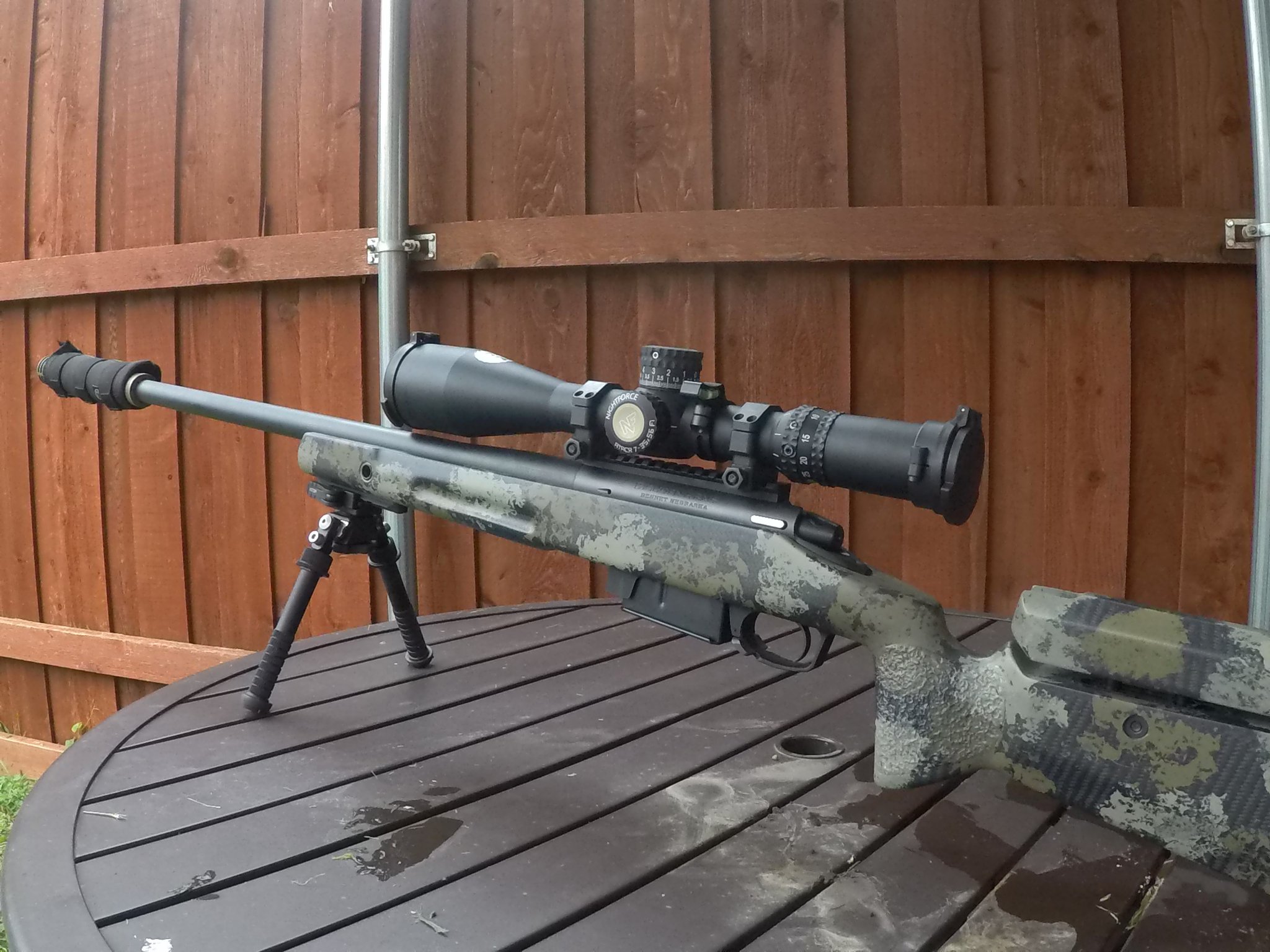

Upgraded my KRG Bravo to a Manners EH-1! This is my first Manners stock, it's impressive. It was a full custom order so it took about 5 months, but totally worth it!!
Also, do Manners stocks that have the mini chassis come with a magazine? I got the CIP length mini chassis, didn't order a magazine, but it came with a CIP length AICS mag!!
TL3 Long action
Manners EH1 with CIP length mini chassis
Proof 26" 28 Nosler
AMG in ARC rings.
TL3 Long action
Proof 26" 28 Nosler
AMG in ARC rings.
She’s beautiful! I like that a lot. What does it weigh as pictured?

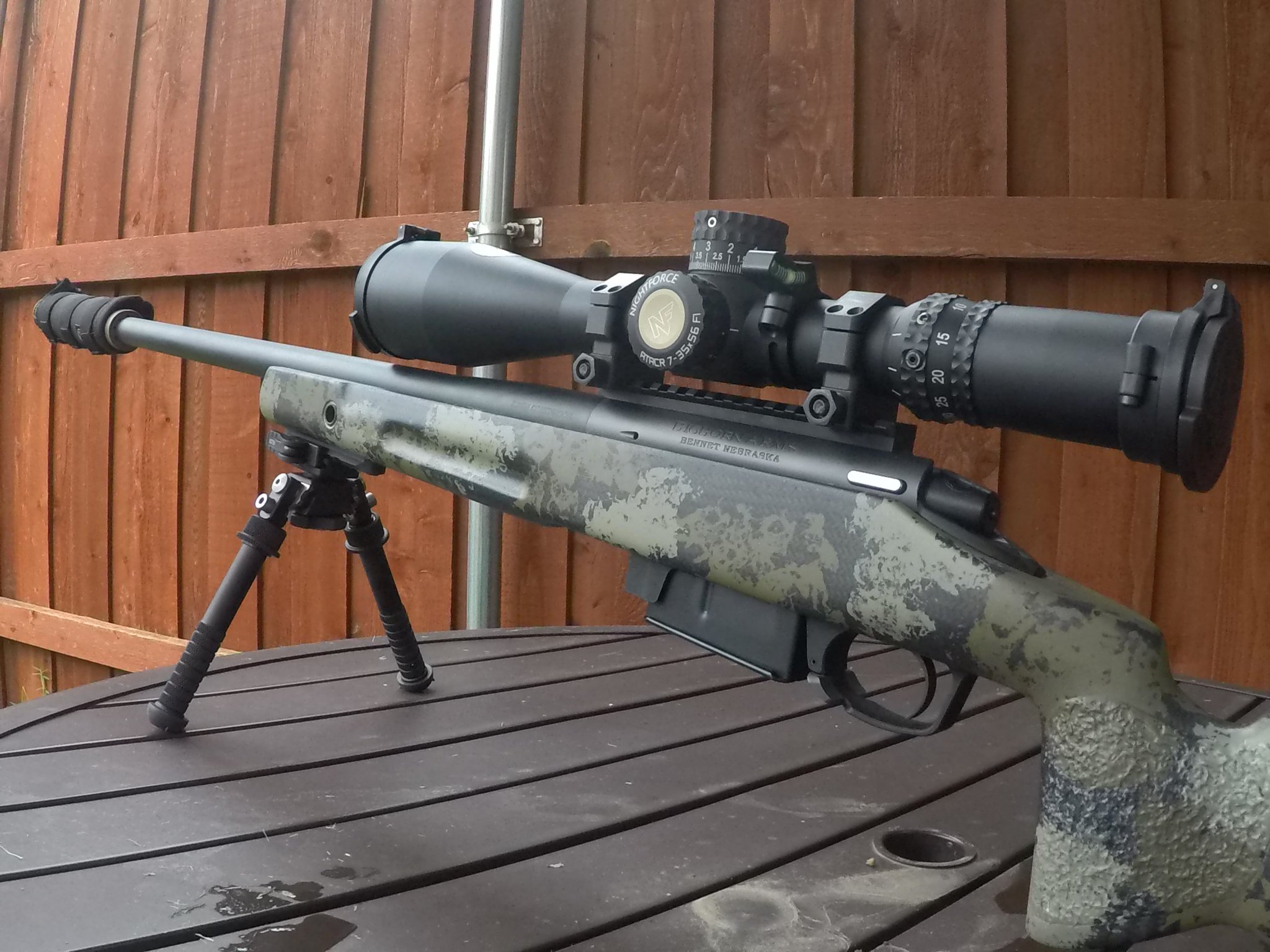

TL3 Long action
Proof 26" 28 Nosler
AMG in ARC rings.
Great looking rifle! What is the name of the camo scheme you have on there?
